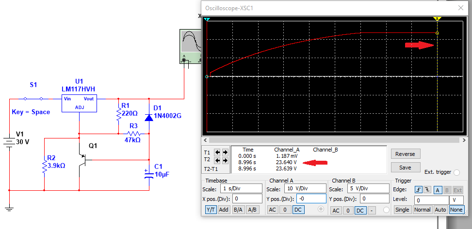

Jackinnj, What simulation are you using?
Eliminate the burp/oink -- Slow start for Pearl -- just do the reverse with an LM337 for the negative rail:
Thanks - I'd have to see this drawn on the Pearl 2 schematic to understand what you're doing. Are you just replacing L2 with an adjustable regulator?

LM317/337 start off with better PSRR and lower noise than those designated U1, U2 in the schematic, and LM7924 can be difficult to source.
Initially, Q1 is "on", shorting R2. Capacitor C1 is charged by R1 - R3 over time, eventually turning Q1 "off".
If using an LM317/337 you should hang a 100uF aluminum electrolytic cap on the output "for stability reasons", and you can put 10uF across R2 which lowers the noise considerably.
