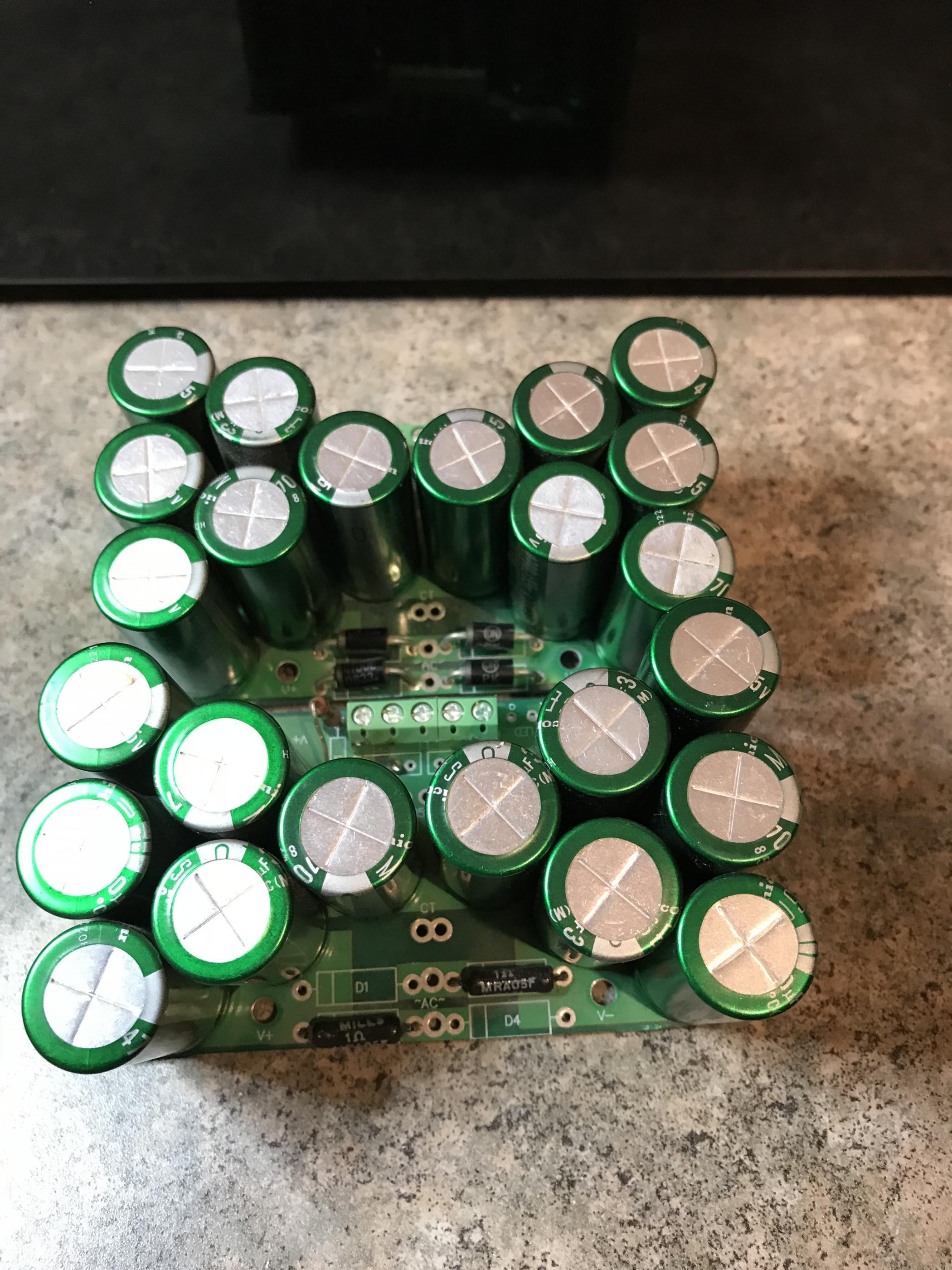

(24) 4700uf caps? That's enough for a really, really big power amp. 😀 Wayne would approve - look at an inside photo of any of the XP phonostages. TONS of capacitance.

It is from SKA Audio - Greg Ball. It looks like his website is gone now. I bought these awhile ago. They were for one of his class A amplifier builds. I am just repurposing them for this Pearl 2 build. see attached pics.

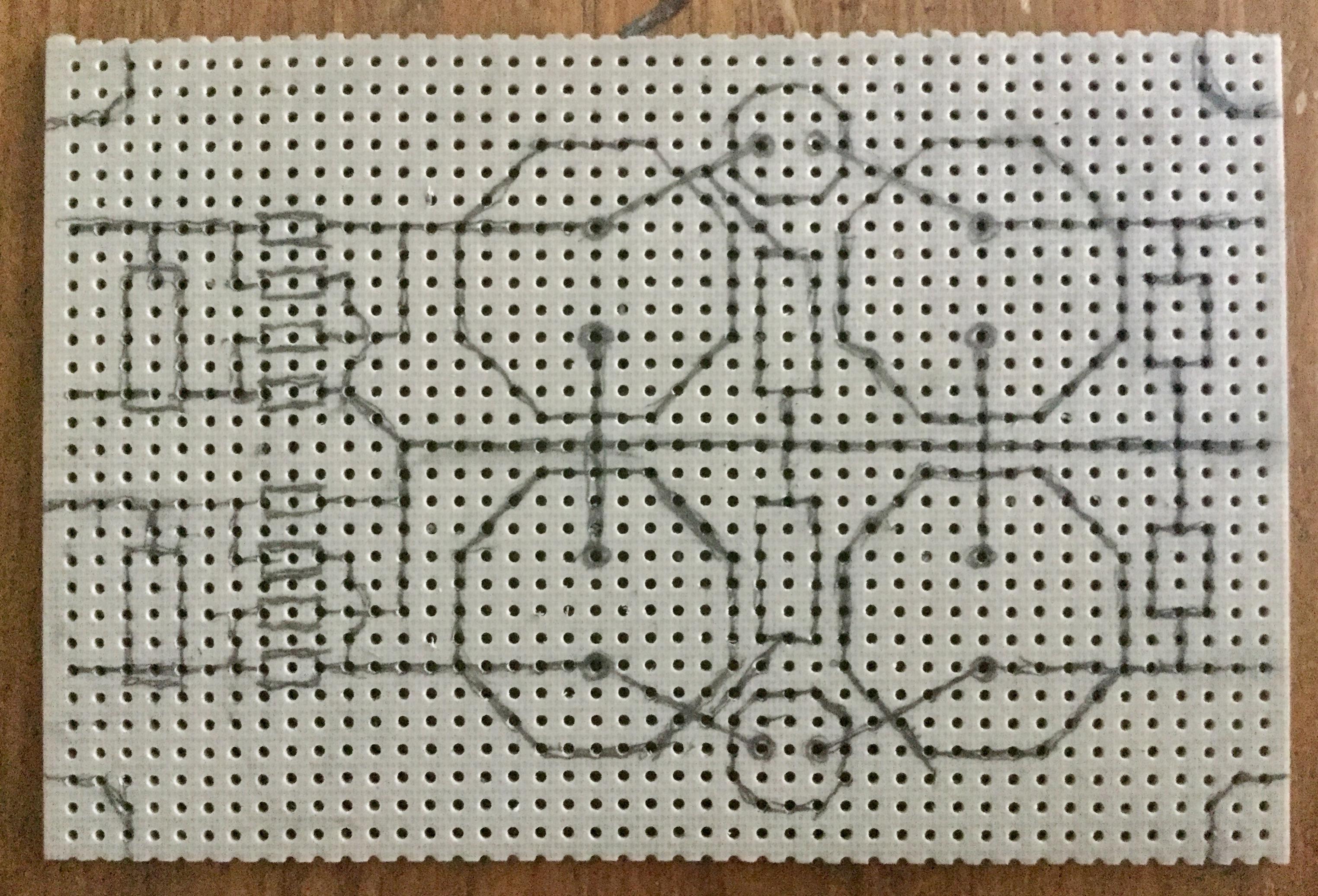

Getting ready to build my power supply. Using sophisticated circuit layout tools to make sure I get it right. 😀

This is certainly more complex than the method I used - I just poked the components through the empty board until they fit well next to one another. No need to use so much "fancy technology." 😉

once it's gone through PC , it's in CAD category
even if only for pic posting purposes
I started out firing up DipTrace intending to get a pcb fabricated, then quickly came to my senses, realizing for a small simple one-off CLC power supply that there was a cheaper faster easier way.
I had leftover perfboard scraps, and wasn’t sure they were quite big enough to fit the whole supply circuit as I had it designed. Good thing I checked, because the rectifier diodes and 10mF caps were indeed too big if I wanted to keep the inductors for the CLC, so I had to change to DO-41 diodes and caps with a slightly smaller diameter. Sadly by the time I went through the layout iterations and part changes, it probably would have been faster to do the pcb.

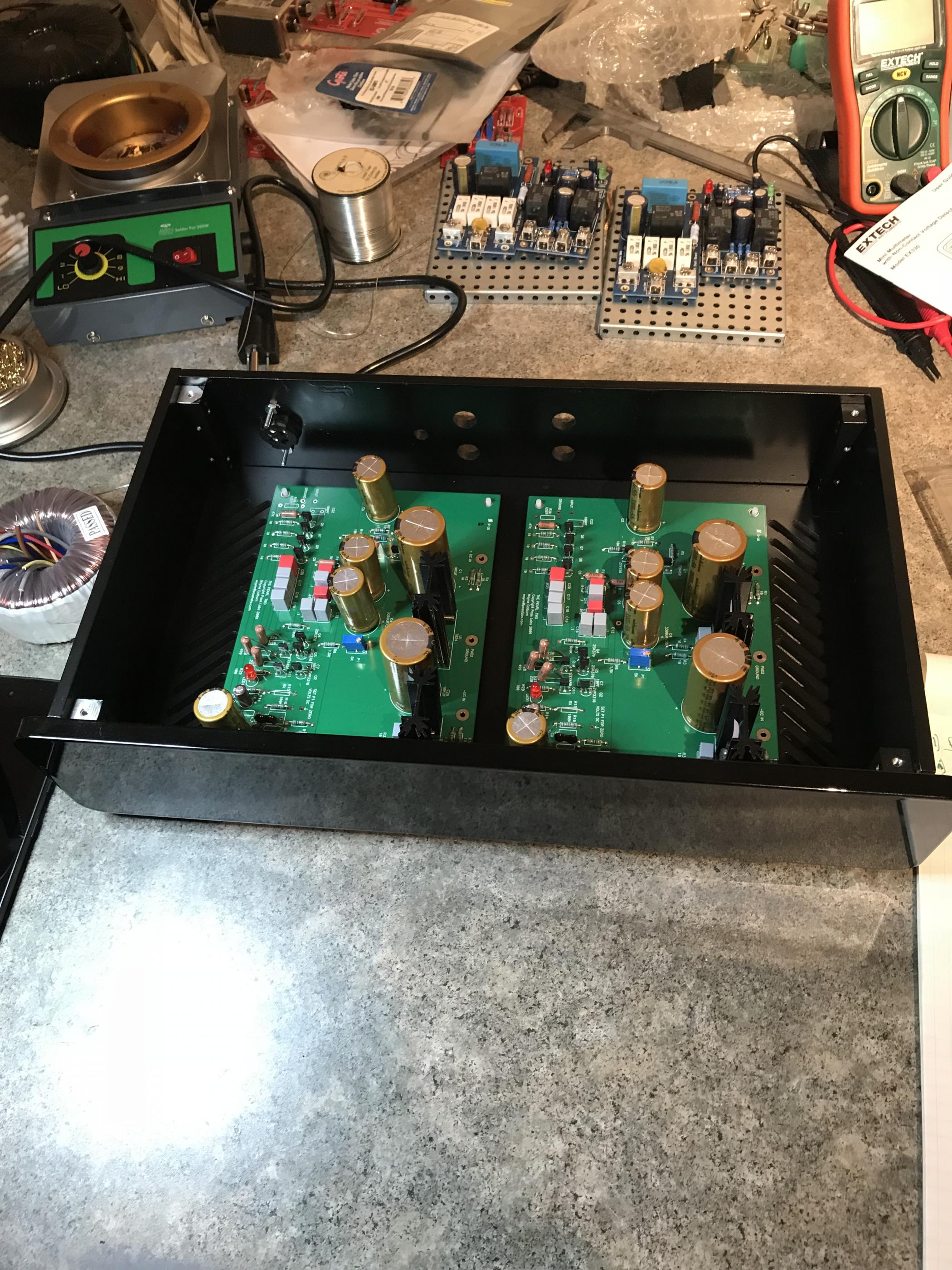

As my equipment rack is getting full, I'm contemplating moving my Pearl PSU inside the chassis with the PCBs. I was planning on using a small transformer and a pair of Salas' BiB regulators. If this works, I get a shelf back to use for a new piece of equipment 🙂

That's a good thought, but it's already a rat's nest of wires that is a nightmare to deal with. Adding a box on top of (or next to) that would only add to the mess, not reduce it...
Eric, No doubt the Pearl 2 is dead quiet with an external power supply but it may interest you to know several builders have built the Pearl 2 with the powers supply in a single chassis. I have personally built two Pearl 2s, both are single steel chassis construction. They are dead quiet. The Antec toroidal transformers are in cans in both units, which curiously, the cans cost more than the transformer itself. The AC wiring is twisted and away from the input. One of my Pearl 2s has braided shielding on the input and output wires and one doesn’t, and there is no difference in sound or musicality. Also one has 50v rated components, the other 35v rated components, again no difference. I’ve tried out several phono stages over the years, the Pearl 2 is hands down the most beautiful sounding to my ears.

Dont know the particulars of your build, I sort of followed 6L6's lead. If my power supply gets too near the Phono section chassis, it hummed. Seems like I remember 6L6 having same issue.
Interested to see how you tame this issue!

Jim: yes, the plan is to use Salas' shunt reg in place of the onboard regulators for the Pearl II. I have a few sets of boards, one of which is partially populated. Need to acquire the appropriate transformer first. I was thinking of using Antek's smallest toroid.
Russellc: I used Jim's example as well. But box space is getting sparse, so something has to give. Not sure how this will turn out, but it will be a little while before I actually get to try this. I'm really hoping I can make this work - I know a few others have. I have an Aleph-J (for me) and an ACA to build with my 11 year old daughter for her birthday first...
