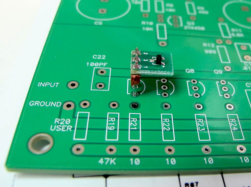

There's an easy way to use the NXP BF862 on the DIYAUDIO Store boards -- with a 3 pin adapter. The mounting holes will accomodate a 3 pin 0.100" Molex header. Just squish down two of the four and you're good to go.
