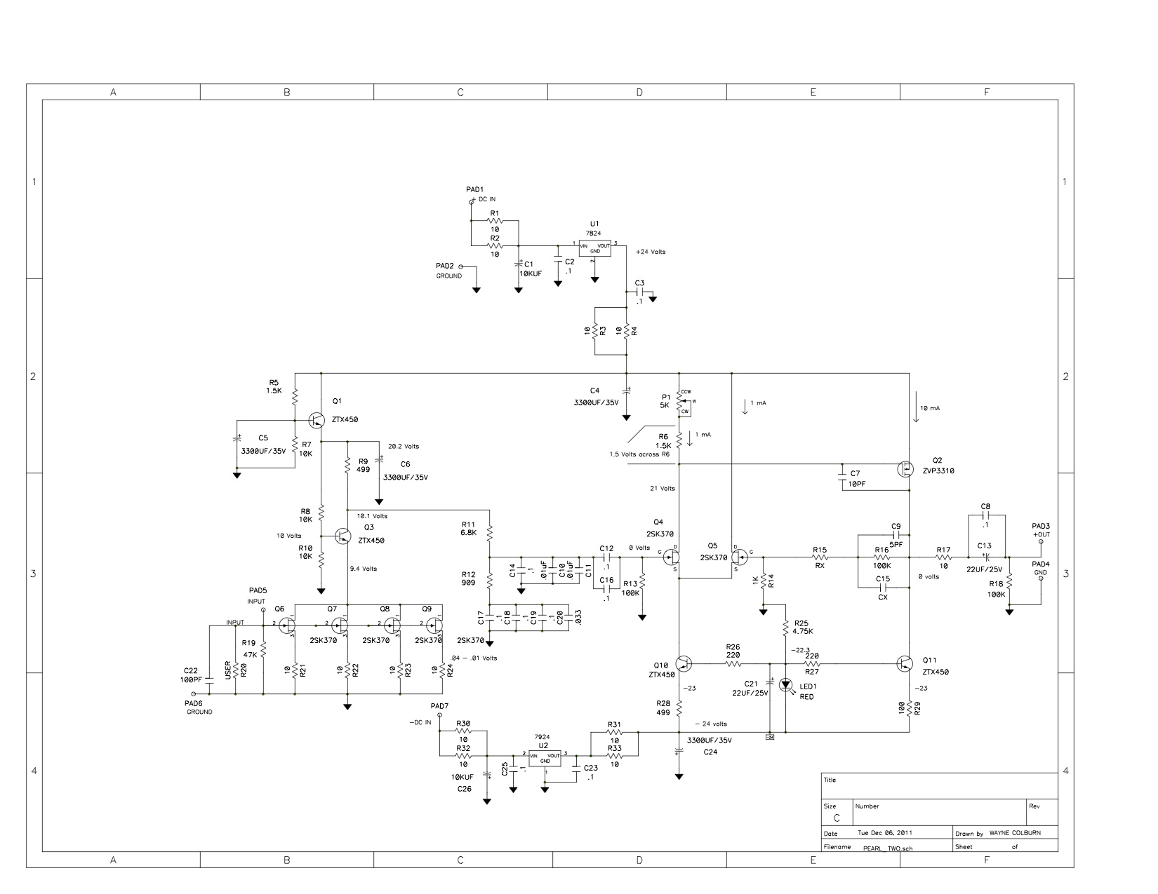

Help
I got all parts and populated my boards. Fired it up and I had insane gain. I could pick up radio stations by touching the cartridge drop bar. It was banging +/- 20V with a little clipping but enough good music came through to get me inspired with volume at zero. Figured it out that I forgot to jump R14 (hey it wasn't a part I needed to order so forgot it). I had the boards mounted pretty well with cables already soldered in so added jumpers from top and soldered front of board. Fired it up and got zero gain one channel the other channel lasted 20 seconds with too little gain so I turned it way up.... then oscillate to where I learned a high current capable power amp can trip a 15 amp house fuse. Now no gain, no hiss, no output at all. Power regulation looks Ok. Any guesses to what I fried and need to replace?
ZVP3310 is usual suspect...
Insane gain -- what type cartridge are you using? Pearl is designed for moving coil. You may also have used incorrect Rg and Rf.
The output MOSFET is already cited as the issue -- buy several,
or you can just scrub the stock output section and use this OPA604 which will happily run on the high rail voltages:

Koetsu Black vintage 1980 which is fairly high output moving coil 0.4mv. Without any jumper or resistor in R14 gain is infinity and beyond. Not playing music I could hear change in output noise if got within 6 inches of turn table and if touched forearm I picked up radio exceptionally well. My turntable lacks ground wiring (first generation Oracle Delphi). With jumper in the gain was not enough clearly with need to have volume near max to listen (which is when oscillation started)
There's (one of) your problems. R14 should be 1K. It can't be omitted.
The ZVP is the usual suspect, adhere to strict ESP practices and you will have no problems. I kept mine wrapped in foil until they were soldered into position and they worked perfectly first time.
R15 not R14 omitted
I was doing it from memory but now it is in front of me I had omitted R15 with infinite gain problems.
replaced zvp3310
Replaced zvp3310 but still no output, no static, nothing. Power voltages are correct. What is next most likely suspect?

Is there such a thing as a table of expected voltages at various points to help trouble shoot for failed parts?
This was working without R15 - just with way too much gain. Put in jumper and it was not enough gain - but only in one channel, the other was dead and it worked until I pulled out RCA without powering down and had huge oscillation scream then both channels down now.
