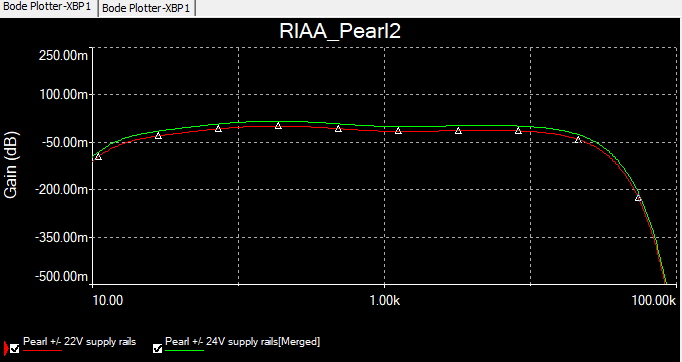

The performance of the Pearl 2 with a somewhat lower supply voltage is negligibly different. You can wire up an LM317/LM337 as +/-22V regulators, driven from a 48V SMPS with a an OPA544 rail splitter and derive almost the same result. (In fact, the LM317/337 will be quieter and have better PSRR than the LM7824/LM7924).
Thanks for your input jackinnj! So regulating down to 22v would be to allow the +3V leeway for the LM7824/LM7924, correct? Or do you suggest to skip the LM regulators altogether and drive Pearl 2 from +22/-22?
Just went over the graph you attached, it’s clear what you meant, thanks! I will try to do it in the similar way.
