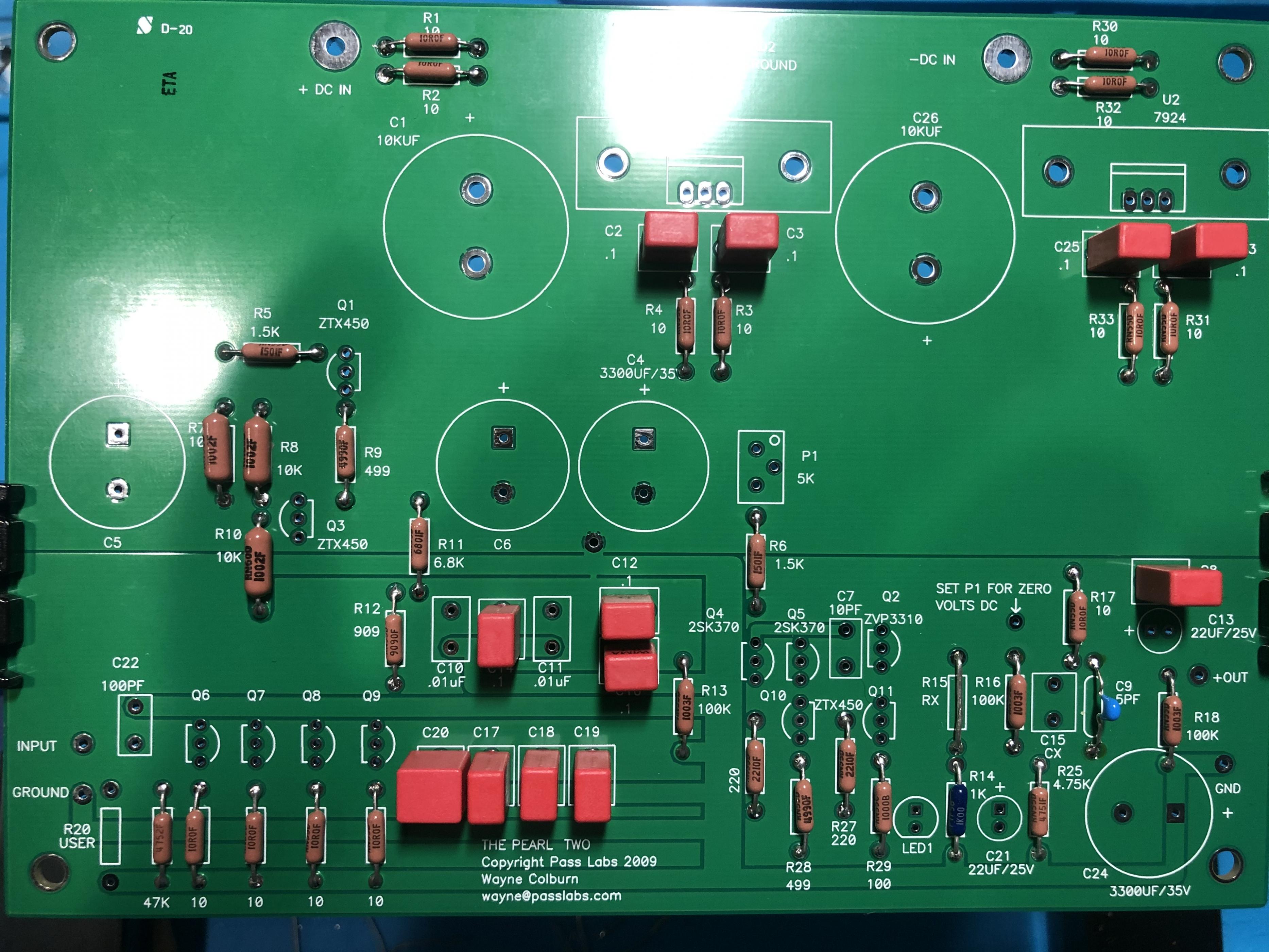

Looks very nice!!
EDIT: One resistor is fine. If you really want to add something, grab the 0.47 ‘s you removed and add them in series with the other filter resistor. More resistance in this case is beneficial. (Currents are very low so the losses are negligible.)

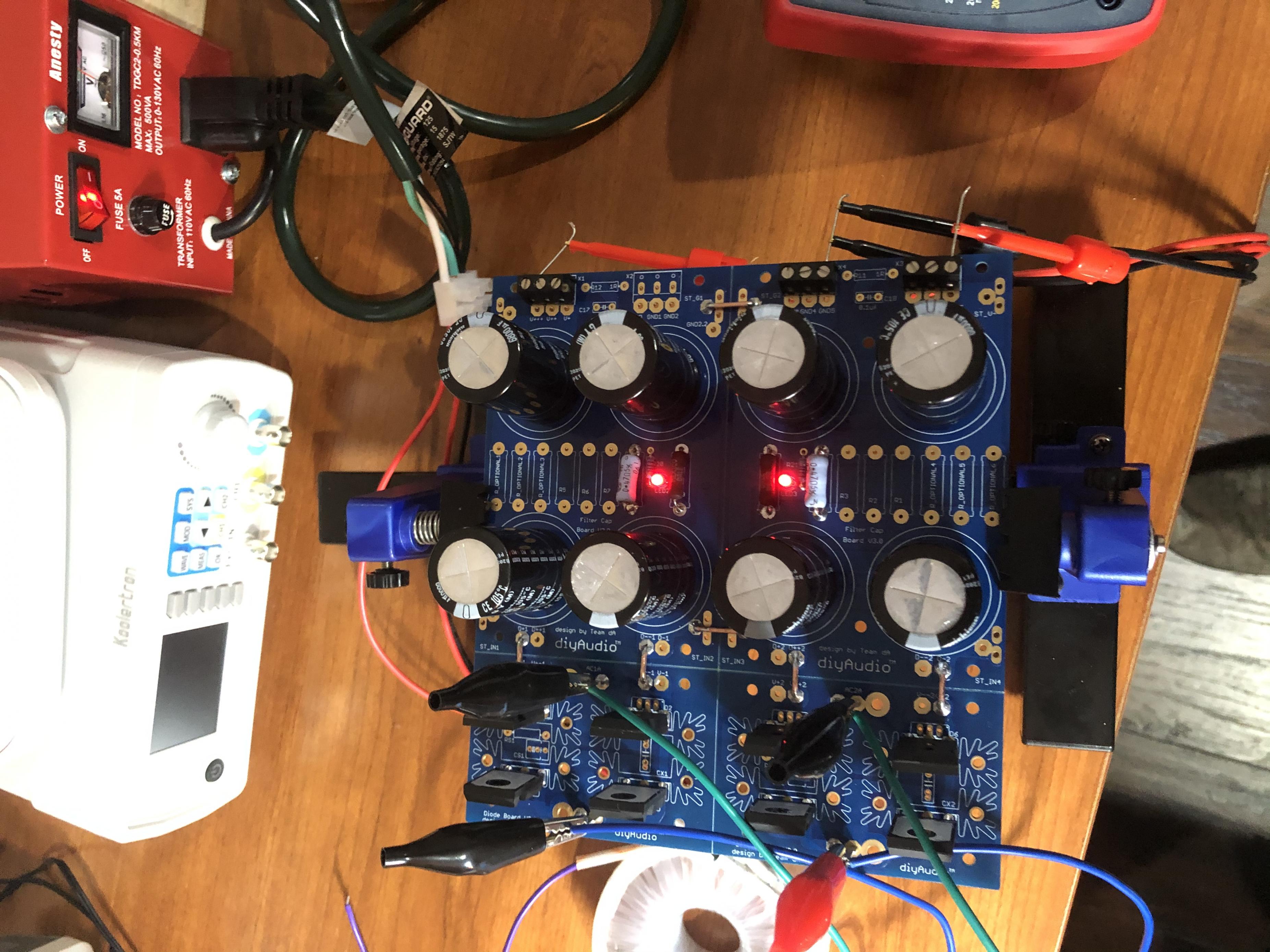

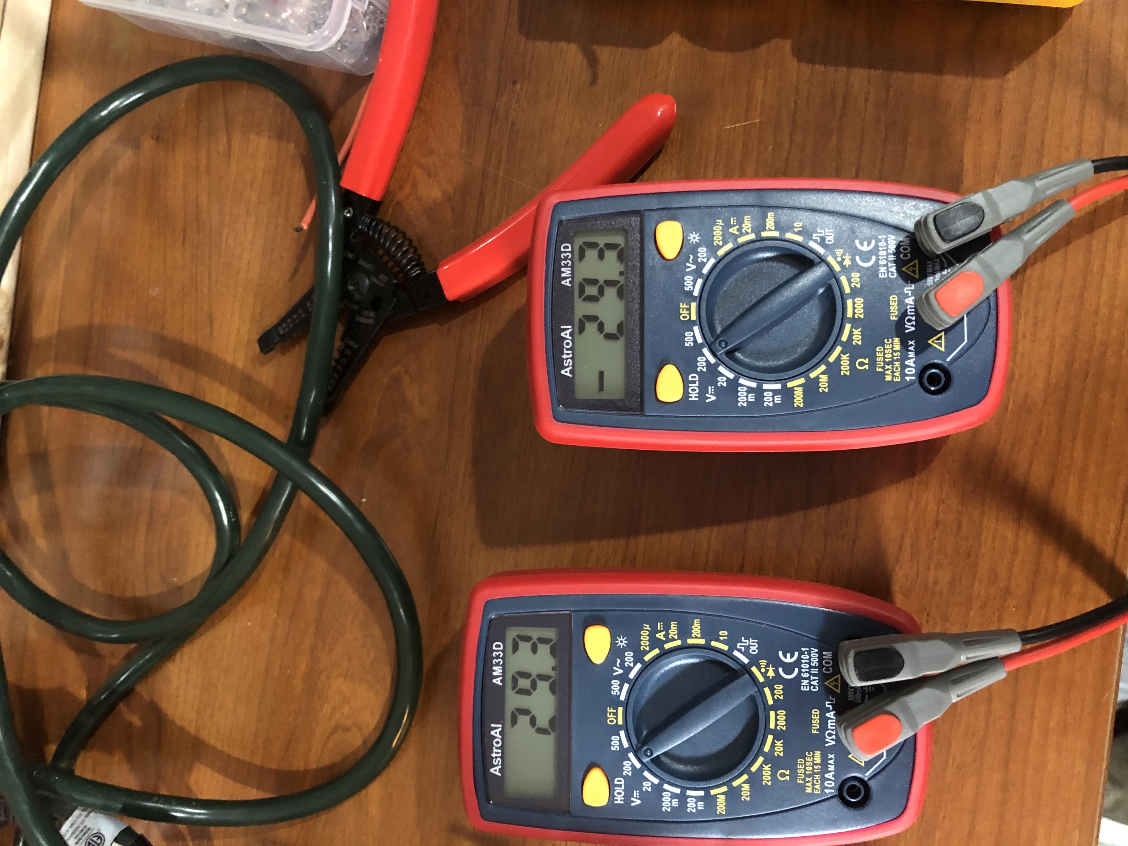

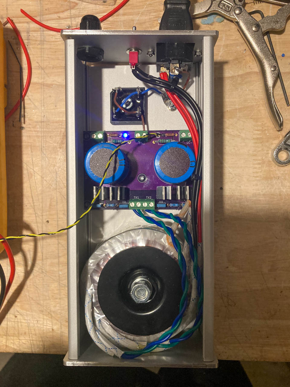

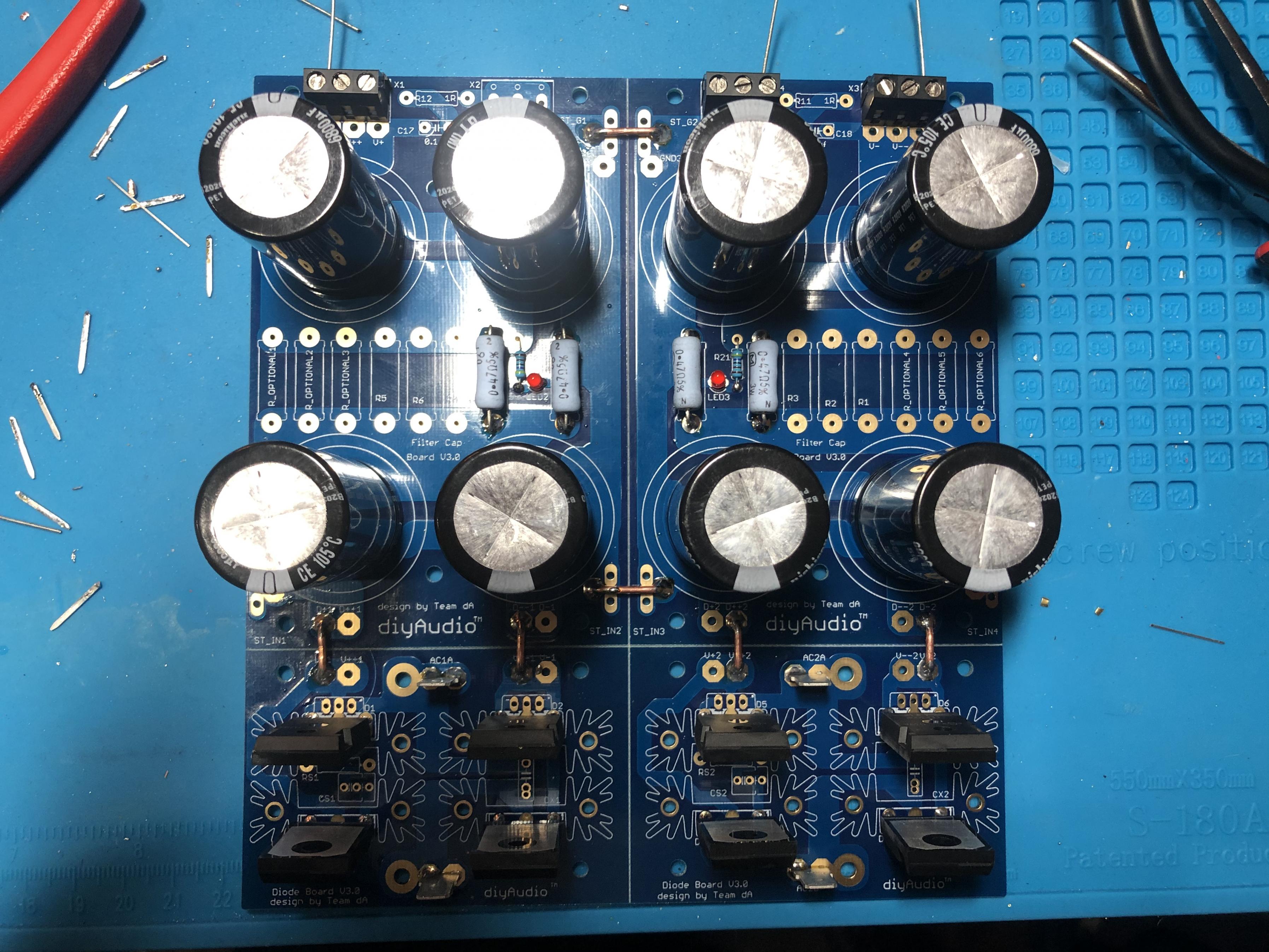

Power supply issues
I've built up my power supply for the Pearl 2 (based on 6L6's schematic) but have discovered an issue. The no load outputs are measuring +40.4Vdc and -40.3Vdc. I'm planning on using the AMB labs sigma 78 and 79 low noise regulators in my Pearl 2 build which can tolerate a maximum input of 35Vdc.
My power supply uses a 15VA Amgis L01-6355 transformer with dual 22Vac secondaries. The root cause of the issue is that (and I should have read the datasheet) the no load output of this 22Vac transformer is 27.2V, based on an input of 115Vac. Given that my mains voltage is sitting at 123.3Vac I'm seeing 28.7Vac at the secondaries. Converting this to DC gives me (28.7 x 1.414) 40.6Vdc.
Given that the Pearl 2 has a pretty low current consumption (~30-60mA I believe with the lower value on the -ve rail) I don't see the power supply output voltage under load dropping very much. I've ordered some resistors to load up the outputs and verify what voltage drop I can expect.
My question is how best to drop my output to below 35Vdc so I don't fry the regulators. The two options as I see it are as follows:
1. Replace the transformer with the L01-6354 which has 2 x 18V secondaries with a no load voltage of 22.2V. With a primary supply of 123Vac I figure I should get a no load output of 33.6Vdc.
2. Increase the value of the resistors in the CRCRC filter to drop the necessary voltage. And unless my math is wrong, in order to drop 6V at 20mA I would need a total resistance of ~300ohms in the -ve rail, and ~100ohms in the positive rail to drop 6V at 60mA.
Option 2 would be cheaper, but is it appropriate/reliable?
Thanks for your help in advance.
Gary
I would wire it all up and see what happens you actually place a load on the transformer. With a 15VA transformer, it will sag a bit under any load. I used an Antek 25VA 25v transformer with a CRC filter to knock down a few volts. I think I used 10R 3w resistors. If you are concerned about blowing your regulators, install a CRC first and see what kind of voltages you get. Then you can tweak things from there.
Adjusting voltages with resistors in this case is simple because the current draw is so low.
