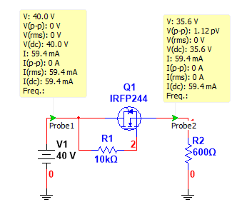

An older MOSFET will drop a bit over 4V a la

I am getting, -35v and +36v(unloaded) from the output of my power supply, is this to close to the margin for the regulators(L7824CV/L7924CV).
The power supply consists of transformer 2x 27v27 at secondary's(2x24v24 was specified!), Pos and neg = 1x 10,000uf, 4x .47r, 1x 10,000uf on each rail.
I'm thinking you'll be fine with +/- 36v without a load. The datasheets indicate max input voltage of 40v for 24v regulators, so you are already below this threshold. Once you put a load on it, the voltage is likely to sag a bit, depending on how robust of a transformer you've used. If you need to bleed off a few volts, Jack and I have already provided some guidance above.
