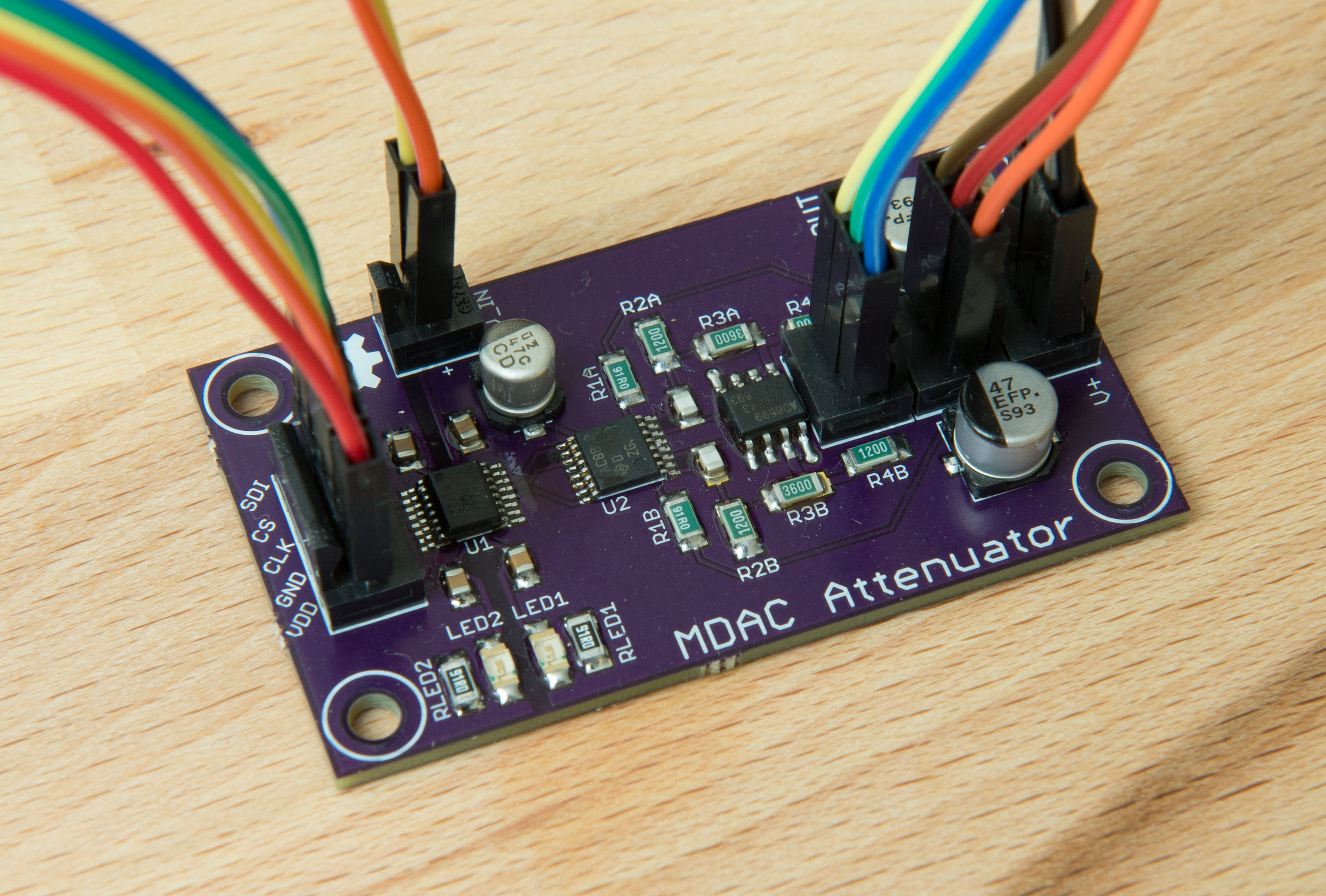

I used your PCB and similar parts from your BOM. I also ordered the input selector board, but haven't populated it yet.

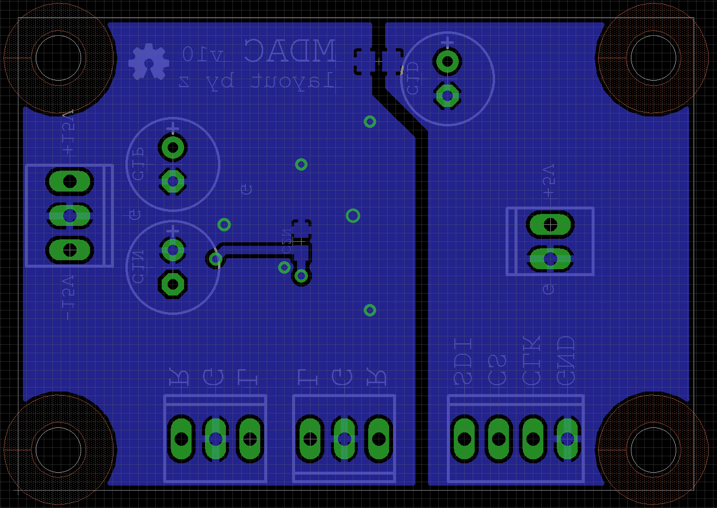

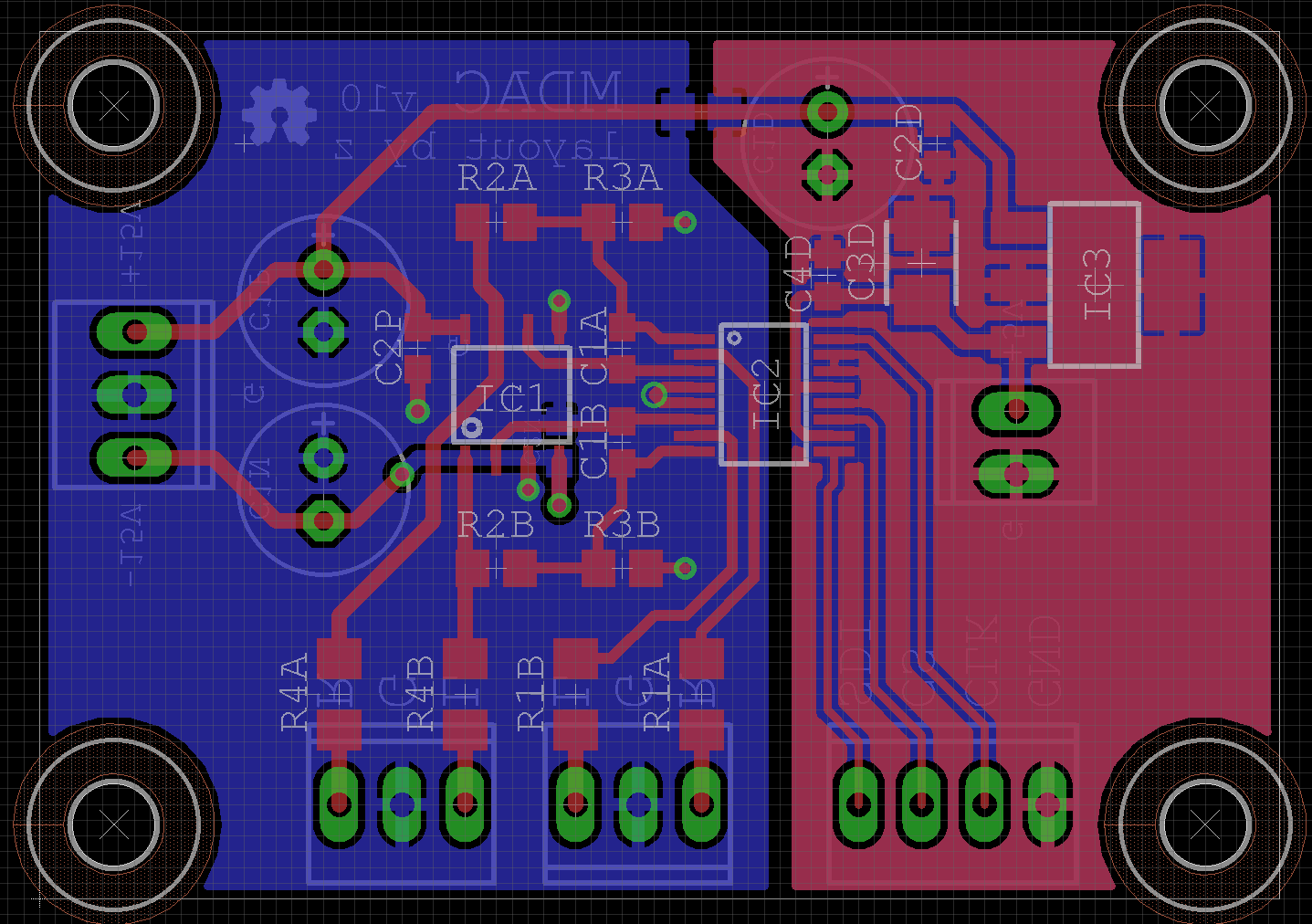

Anyway no isolation. I added onboard 5V psu. Digital and analog ground connected in one point (ferite bead or jumper probably).
How bad is this layout?
Still this is probably way over my ability to design and I should probably just use your design but I wanted to try if I can make something.
PCM measurement is 50x35mm.
Any comments

Nice! Would help if you posted a schematic too. What ICs are you using? Have you tested this?

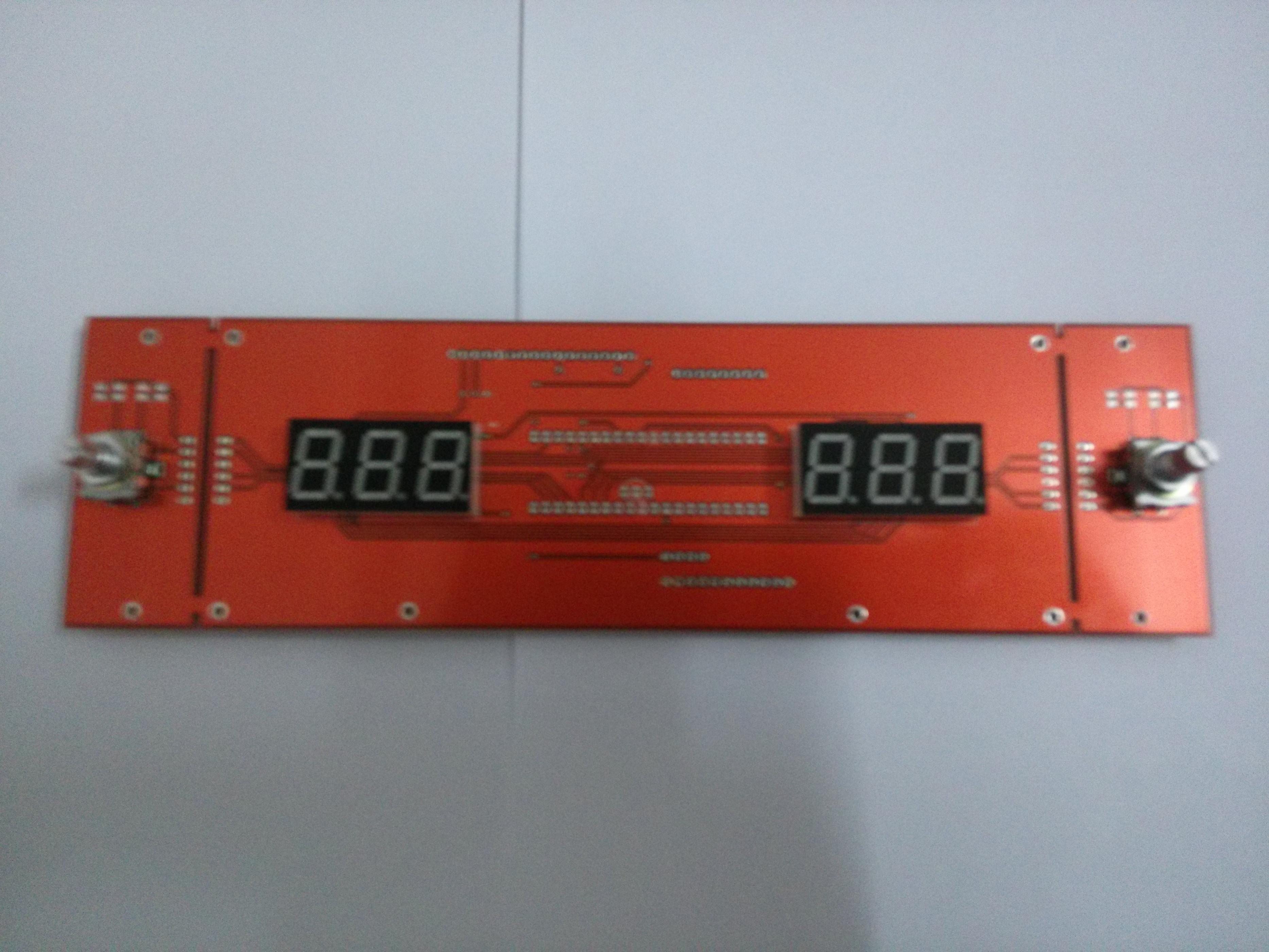

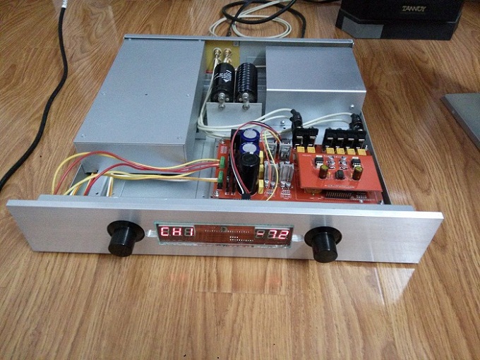

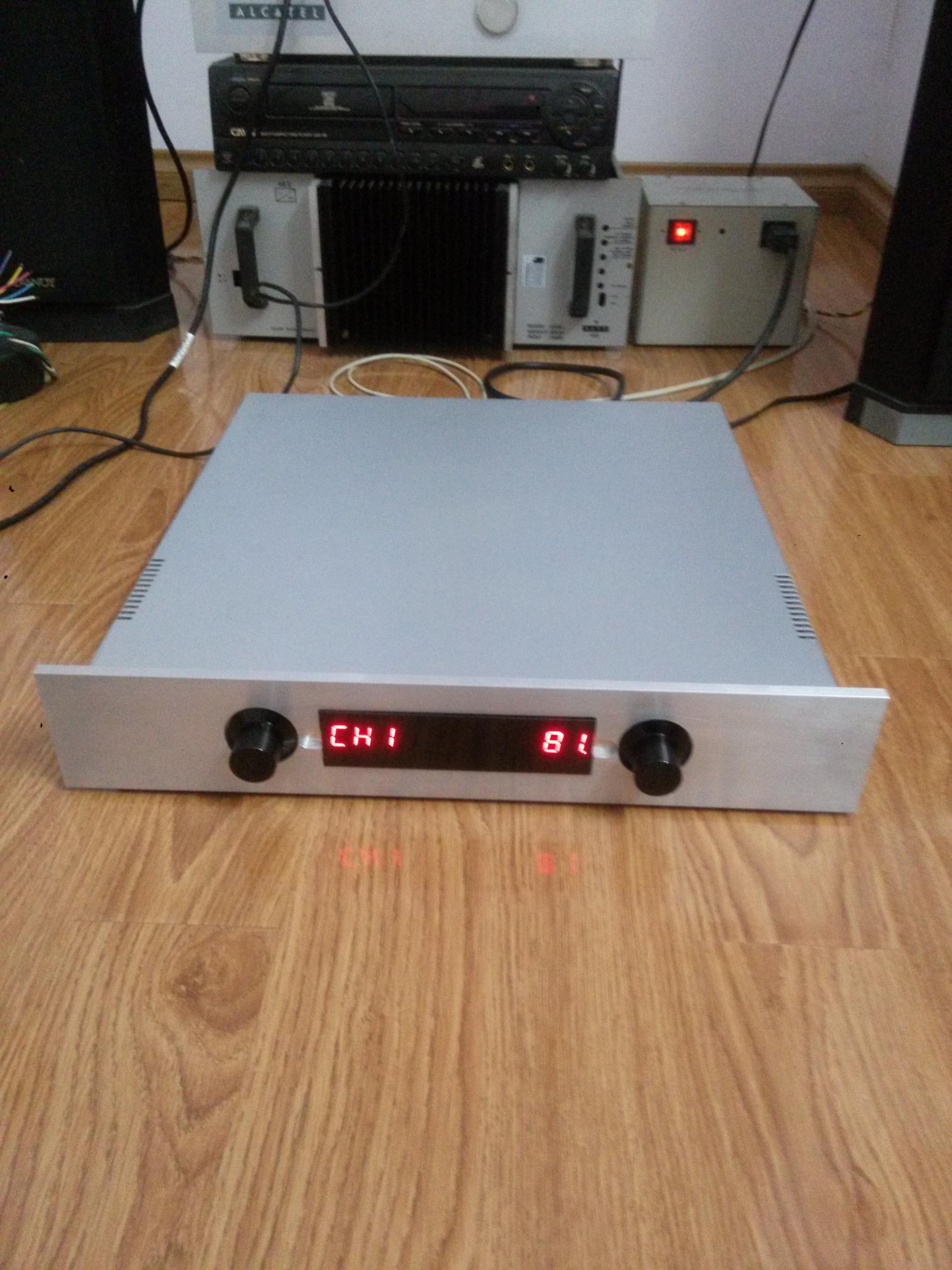

Sorry my English is bad, but this is my product in forum DIY VNAV.

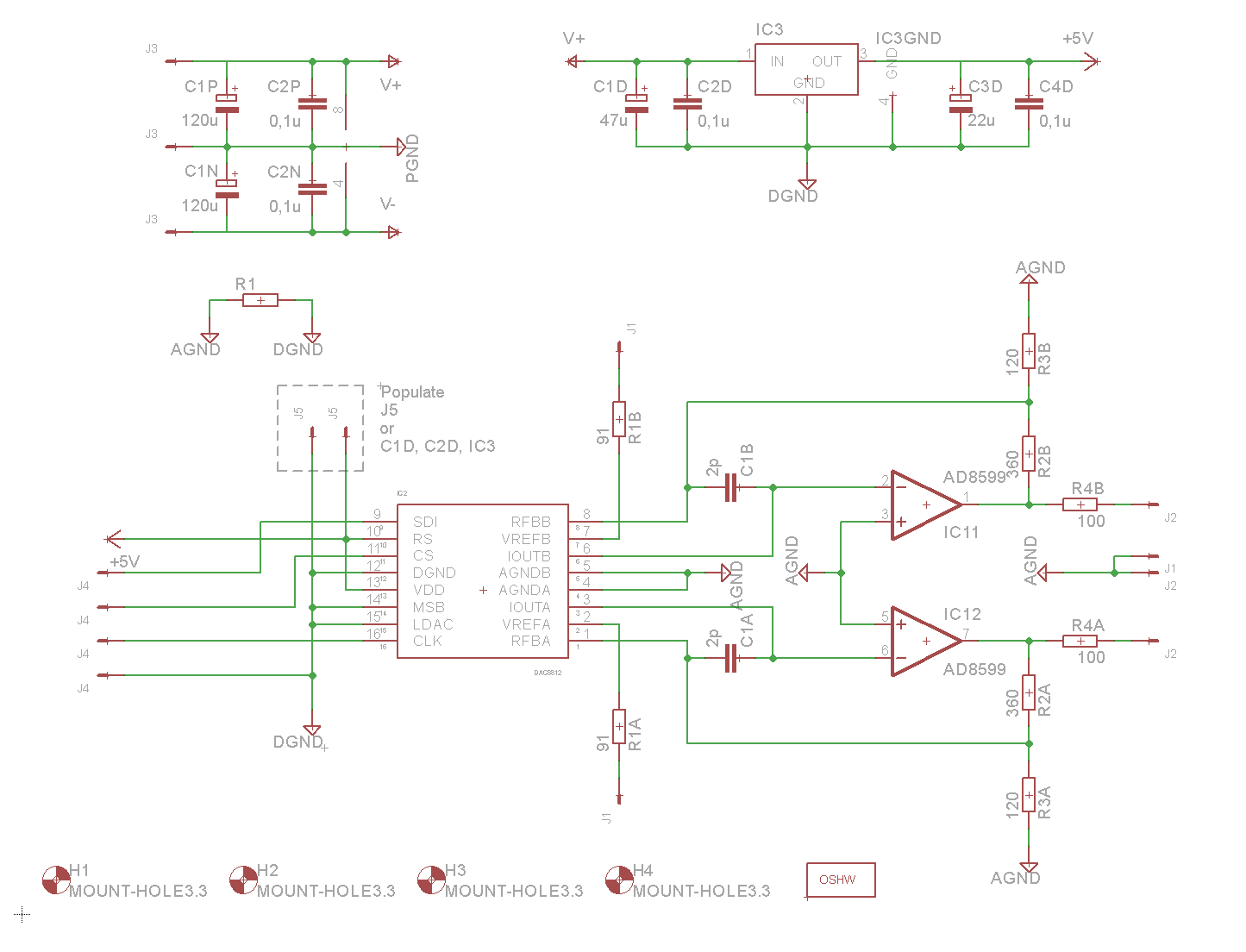

Well schematic is shameless copy of your design. I hope you don't mind.
IC1 would be AD8599 or maybe LME49720. IC2 is DAC8812 of course 🙂 IC3 is LT1129 regulator, I couldn't find any noise specification for it but I was more concerned about cooling of the regulator that is why I went with something in SOT223 package considering Vin-Vout is 10V. In DAC datasheet I only found power consumption when there is no input (5uA) so I didn't know how much current will it actually need.
All resistors will be Susumu RG, big caps are oscons and and regulator out cap will be poscap.
BOM right now is almost 40eur.
I have not yet tested this PCB. I am getting my Mouser order together. I am hoping to order in two weeks time.
Of course not, that's why I posted it.
Sounds good. Post results when complete!
