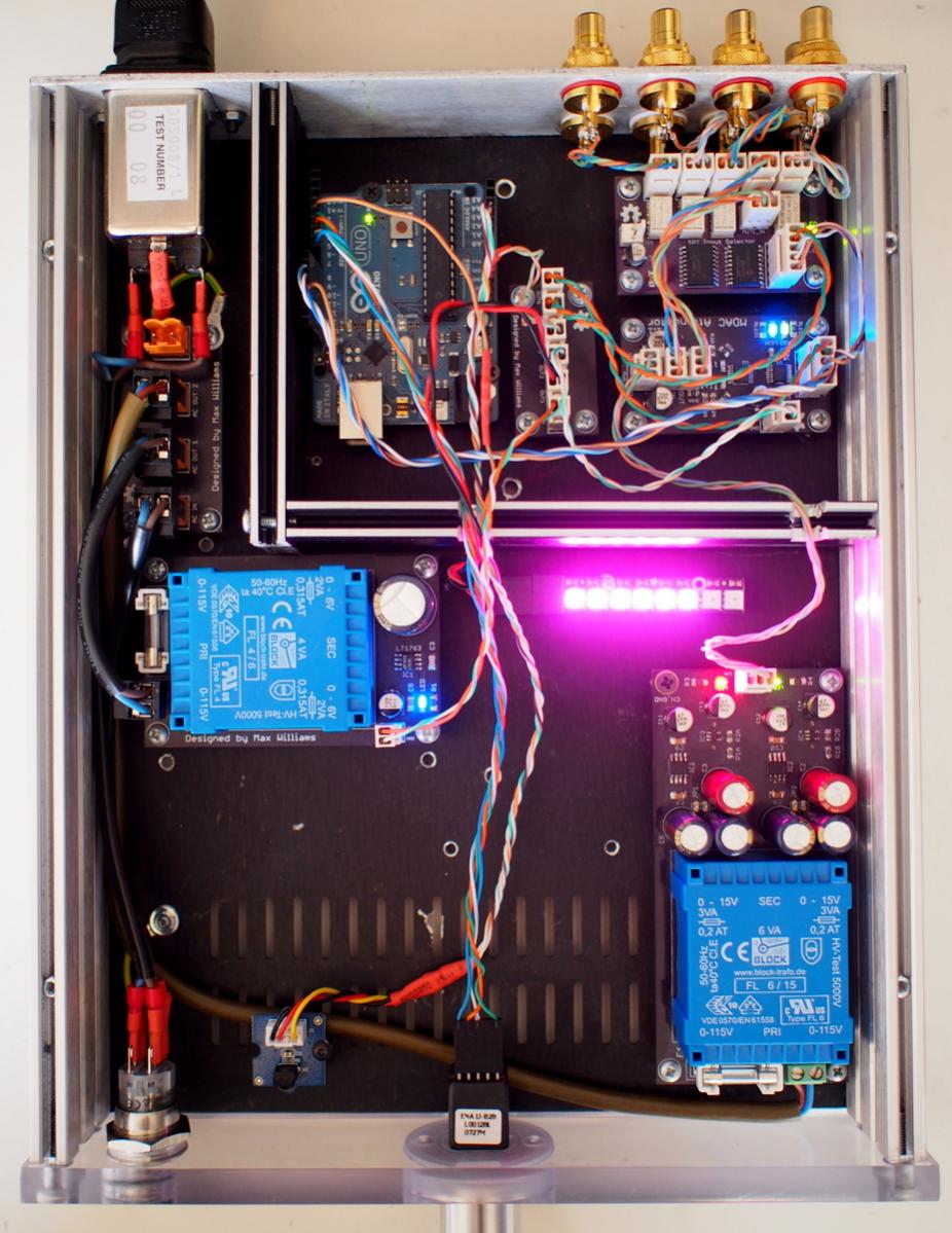

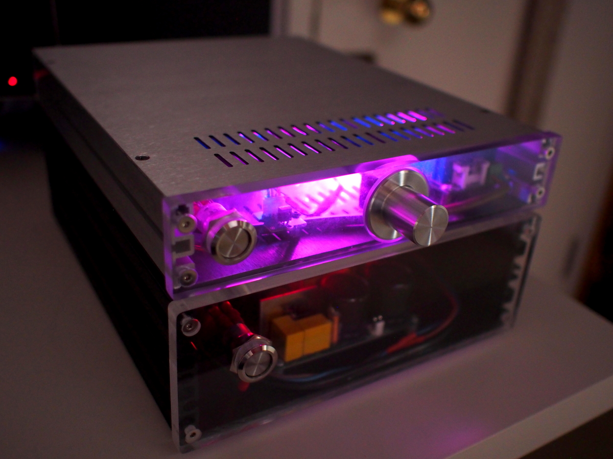

Finished

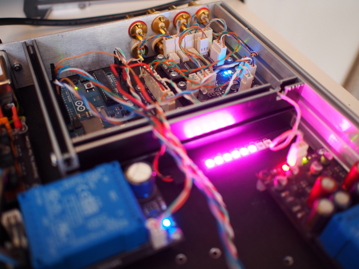

This is my last update as I think it's now complete 🙂
I've removed one of the 5V PSUs as it wasn't required and added a strip of 8 NeoPixels. These are controlled by the Arduino using a single data pin. I decided to use the NeoPixels because I think they look a bit nicer than LCDs which usually look a little cheap IMO. Using some smart colour fading/flashing/pulsing they can indicate input changes, mute and volume level. The NeoPixels will:
- Fade from blue to red as volume increases.
- Flash (very quickly) when changing inputs.
- Flash green when mute is enabled.
They are controlled by an 800 KHz bitstream. Initially I was worried that this would impact audio measurements since the DAC IC is sharing power/GND (that's why I used an SPI isolation IC on the MDAC) but while I can see it in Arta, it doesn't go higher than -140dB.

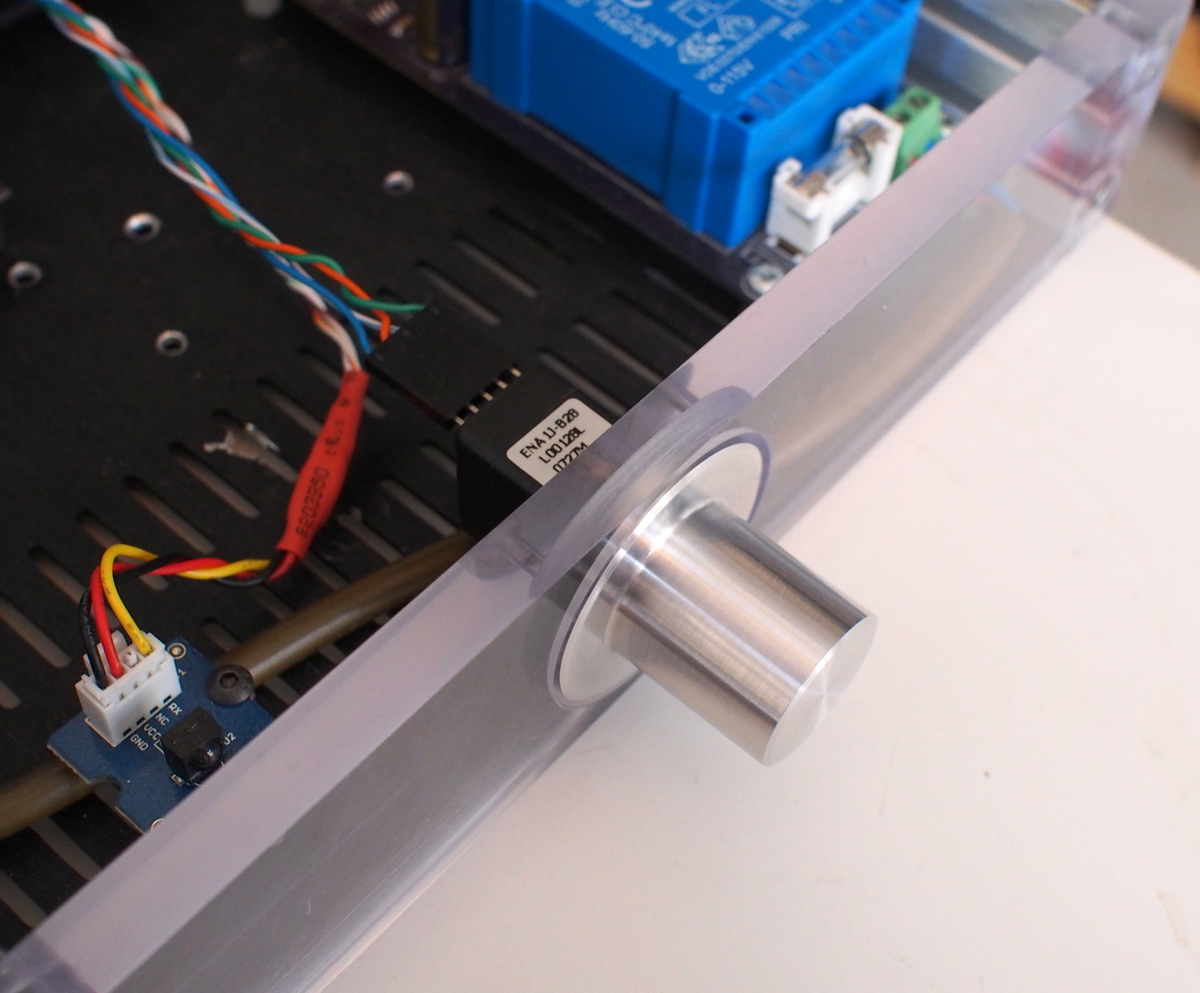

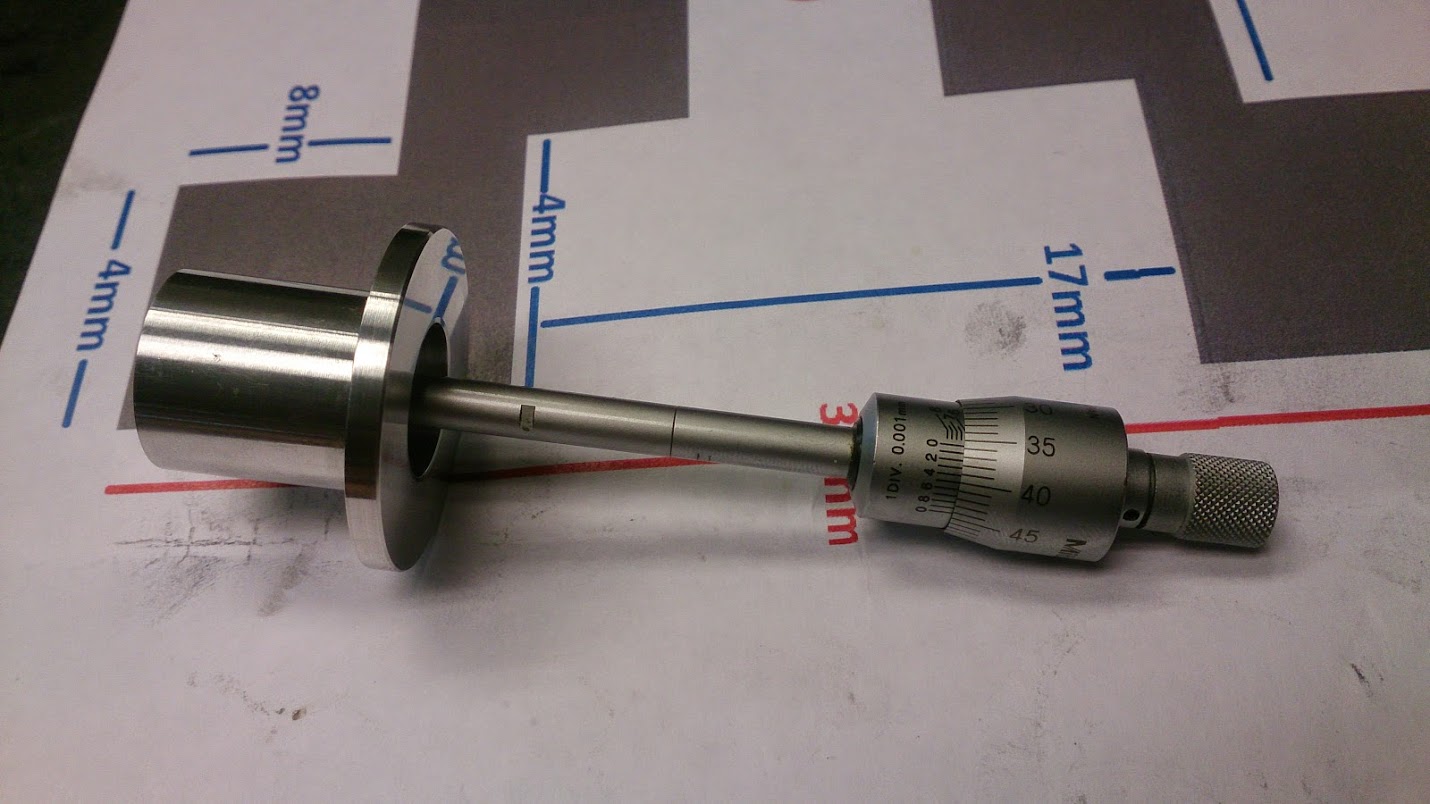

Final version of Arduino code is attached. I'm surprised how responsive the Arduino is. The volume and NeoPixel colour changes instantly when rotating the encoder, even when I do it really fast. I was worried that the amount of math I was having to do in the main loop when changing the volume level would slow it down but not at all!
Big thanks to Pjotter for the custom aluminium knob that allowed me to get rid of the annoying shaft size adapter thing.
So there's my preamp from design to build to completion. With schematics, layouts and measurements posted too.
