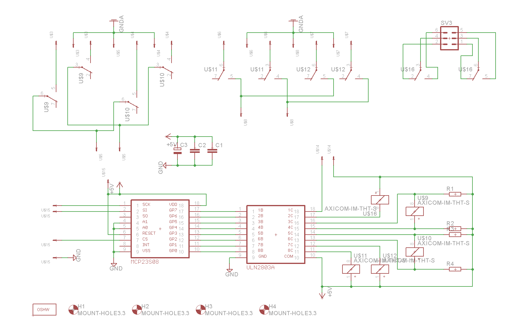

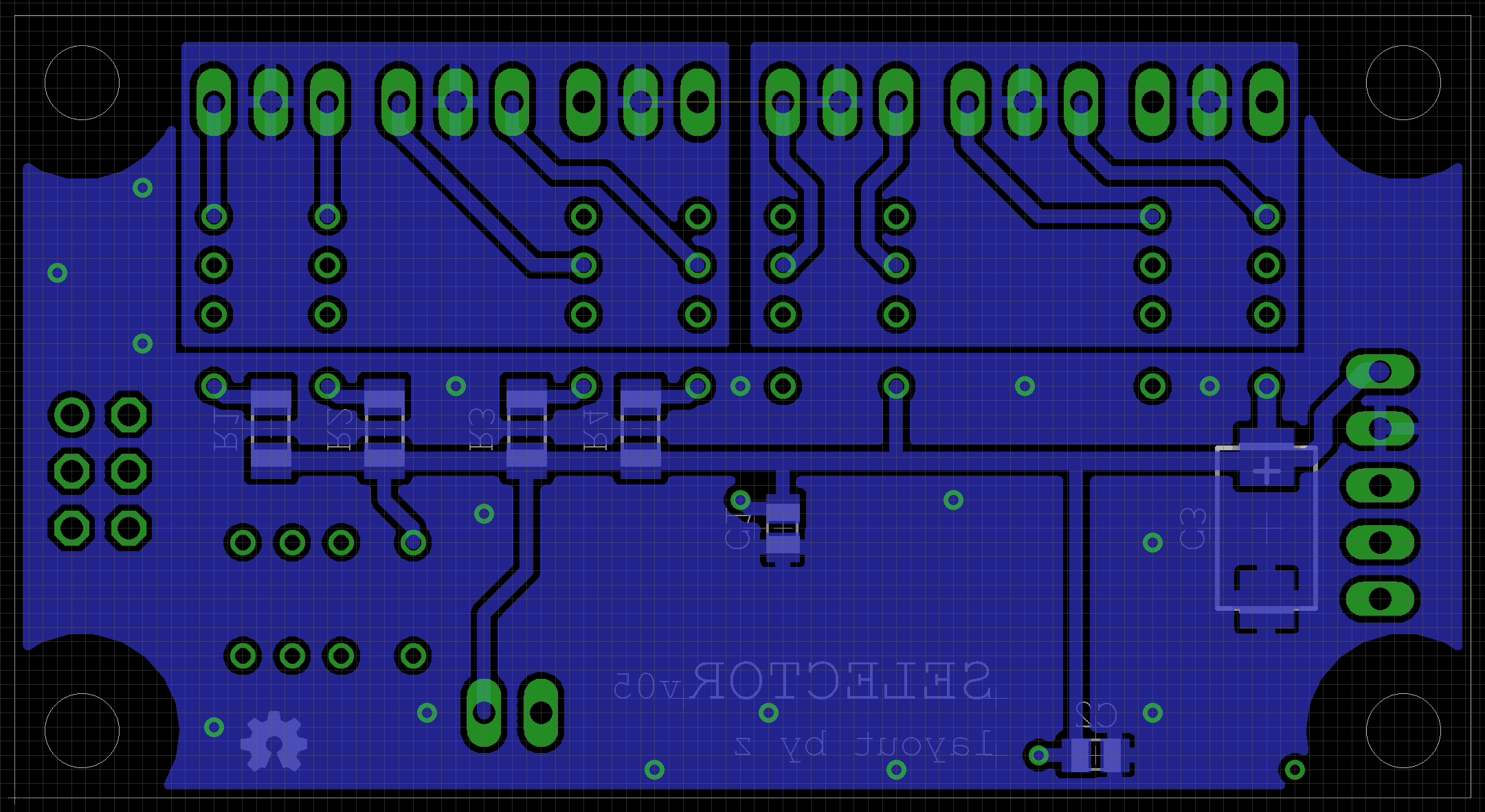

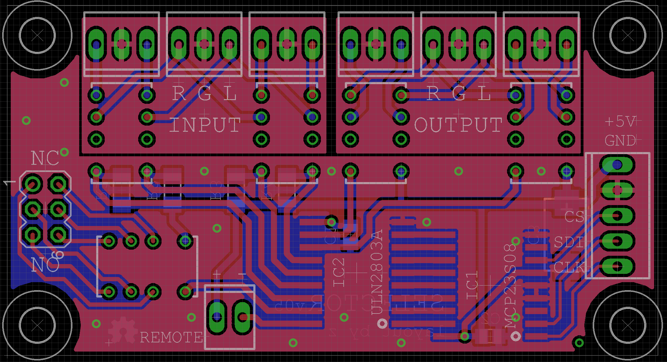

Anyway I managed to lay out second board for input and output selection based on your input selector. Basic thinking behind this since it will be for computer use I don't need many inputs so one for PC and other for any other gear I might want to connect. And two outputs (speaker amp and headphone amp) that act as mute switches also. There is also one relay that will act as speaker amp standby switch and one more output for additional outboard relay if I'll need it for something else.
Board size 35x65mm
Is this layout good enough?

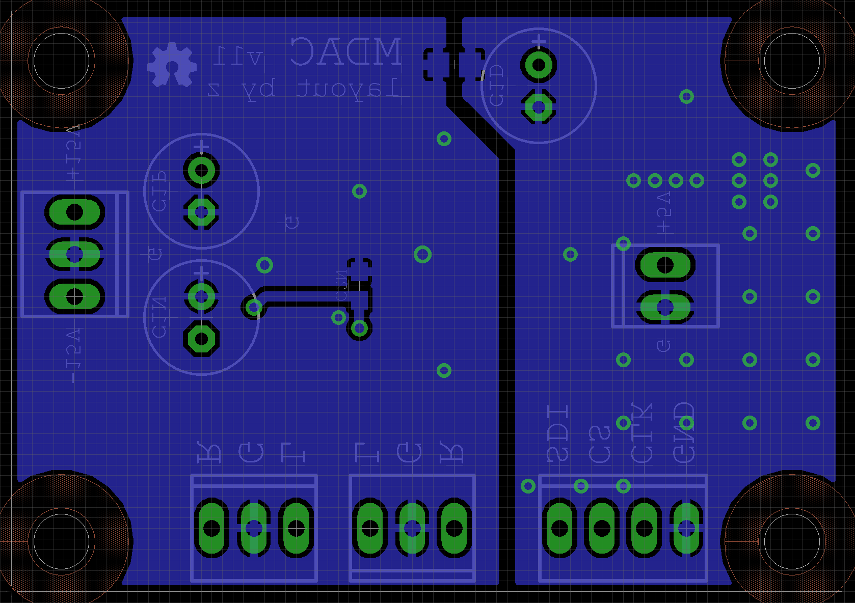

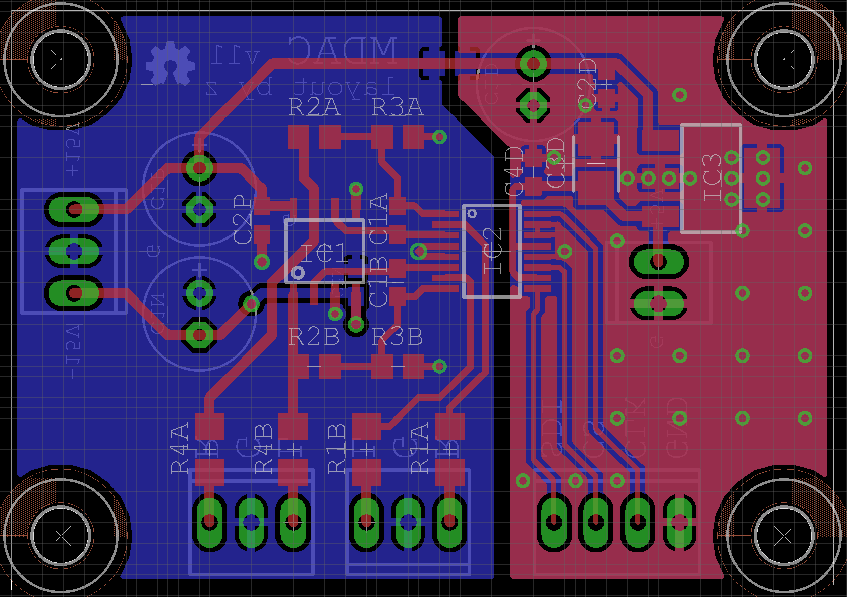

Other thing is I added few vias between ground planes on MDAC digital side. If this is good? I am guessing some of them under regulator should be there for cooling.
One more thing max how did you select which resistors to use on latching relays?
OSHpark order this week I hope.

Looks good to me! I like it.
In regards to the vias, I'm not really sure if that's a good idea or not. For dispersing heat, probably a good idea.
I chose the relay resistors by copying other designs.

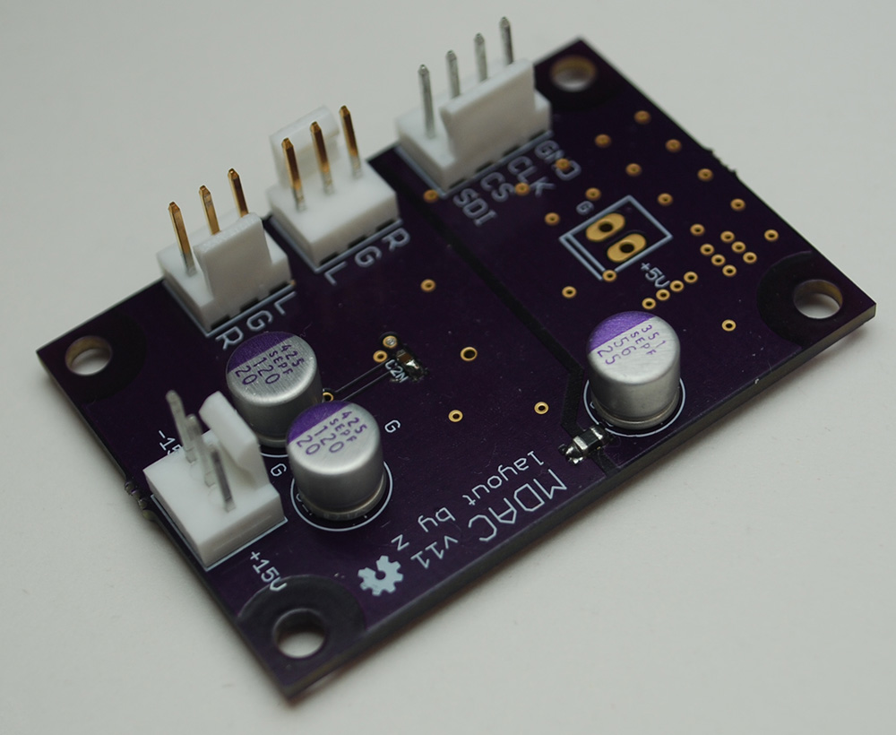

Thanks for all your help. I finally managed to complete my first mdac. I had only one bad solder after "finished it" on friday. Today I repaired that and it works now. Since this was my first ever smt work I think it is good enough.

Excellent, looks great! I'm so happy some people are using my design. How do you find it in use? Are you driving headphones or is this part of a preamp?
Today I just tested it if it works after repairs. Volume change is very nice with no clicking or other glitches. For now I found out if I use it without relay in front to mute it on start-up it clicks when code changes it to 0 but after that its OK.
