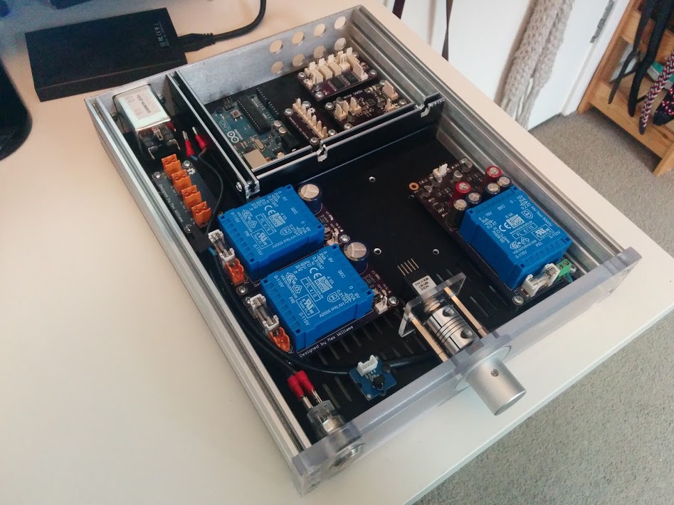

My power switch is made of metal and is mounted in the acrylic front panel so is not earthed. Do you think I need to connect it to the enclosure?

Did your MODU chassis have a pre-cut IEC inlet? Mine has and it's actually really annoying as it doesn't line up with where my PCB mount inlet sits in the chassis, I'd rather have had the option to just cut that myself. Maybe yours did too and you have just enlarged it?
I'll be interested to hear if the aluminium dividers help your noise issue much. Quite often it is a ground issue instead of radiated noise but you now have 3 PSU modules so should have plenty of scope for proper grounding.
Thanks. Nope, mine was blank and I cut it myself.This looks very good, nice work! 😀
I had long wires everywhere too so hopefully shortening, twisting and simplifying the wiring will help too. We'll see. Should be done in a couple days 🙂I'll be interested to hear if the aluminium dividers help your noise issue much. Quite often it is a ground issue instead of radiated noise but you now have 3 PSU modules so should have plenty of scope for proper grounding.

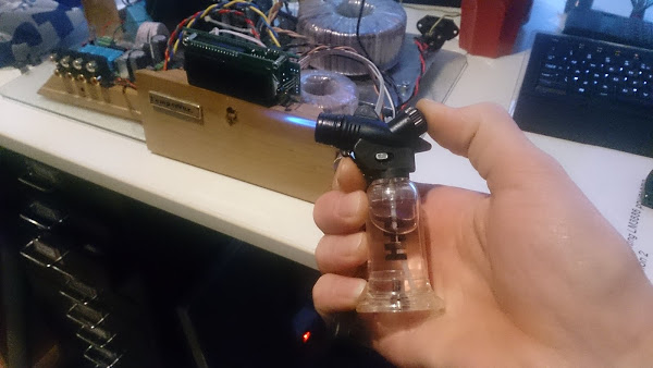

My new problem is that I can't solder cable onto the ground part of these connectors:
Even with my 70W Hakko soldering iron I can't get enough heat into the connector to get the solder to stick properly as the connector is such a large solid piece of metal 🙁
Any body else had this problem?
I have the same rca plugs and I don't recall having soldering problems with them although I have a 30 watt soldering iron.
Try with a different solder paste or scratch the surface of the metal a little bit, it should be easier after that.
Definitely had the sane problem. I've used a small gas torch to heat the connector up. In my case it was a speaker connector.
Just be a bit gentle with it, it's really hot, about 1400 degr C or so. Just heat it up from a small distance so the tin will melt, not burn ;-)
I'm sure you're aware of that..
I've tried to include a photo, not sure if it works though.
Maybe the way the temperature control works on my Hakko iron? It's not on constantly, it just turns on/off repeatedly to maintain a constant temperature. I tried for hours to get it to work and even put the iron on its maximum temperature but no luck.I have the same rca plugs and I don't recall having soldering problems with them although I have a 30 watt soldering iron.
Thanks for the suggestion! A gas torch sounds like it would work but I just bought a cheap 100W iron from eBay for £10. Will try again when it arrives.Definitely had the sane problem. I've used a small gas torch to heat the connector up. In my case it was a speaker connector.
