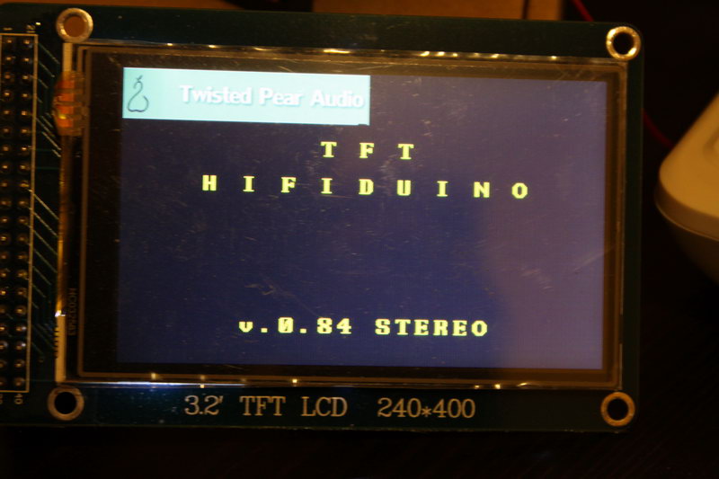

Thanks for sharing your code, it save me lot of time. I modified the code to fully utilize the screen, interface with Ian's FIFO and Selection mode can works with Remote. The only thing that need to be added at the moment is the controlling of Sidecar for selection between SPDIF and DSD.

I still can't convert a jpg file and display it on the GLCD successfully. I managed to display 3/4 TPA logo. Most of the time get the error message "image file too large" when compile the program. Can anyone help?
I am guessing that you are using the myGLCD.drawBitmap function and Henning's online ImageConverter 565.
Are you sure that the c files that are generated are not too big?
For example, the little graphic displayed below takes up almost 20K of memory:
I convert the TPA logo using the online converter and the file generated is 20K which cause the "file too big" error.
That is indeed odd. I don't have much experience with the drawBitmap function, but since it stores the bitmap in an array, it is limited by the max size of an array.
If I were you, I would probably experiment with the UTFT_tinyFAT library and try storing my bitmaps as files on an SD card. That is probably the way to go in the long run, since the 256K available on the MEGA is pretty limiting.

Thanks for your suggestion and will try this weekend.
