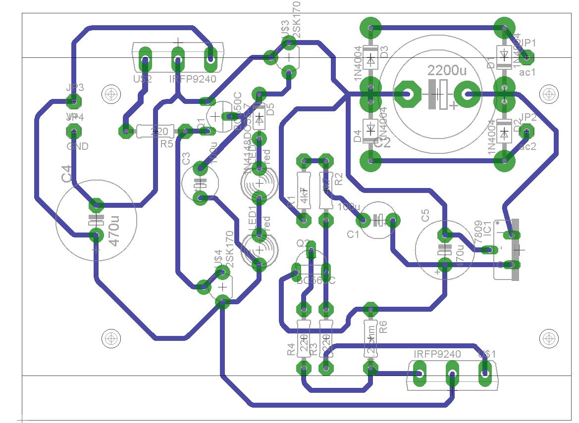

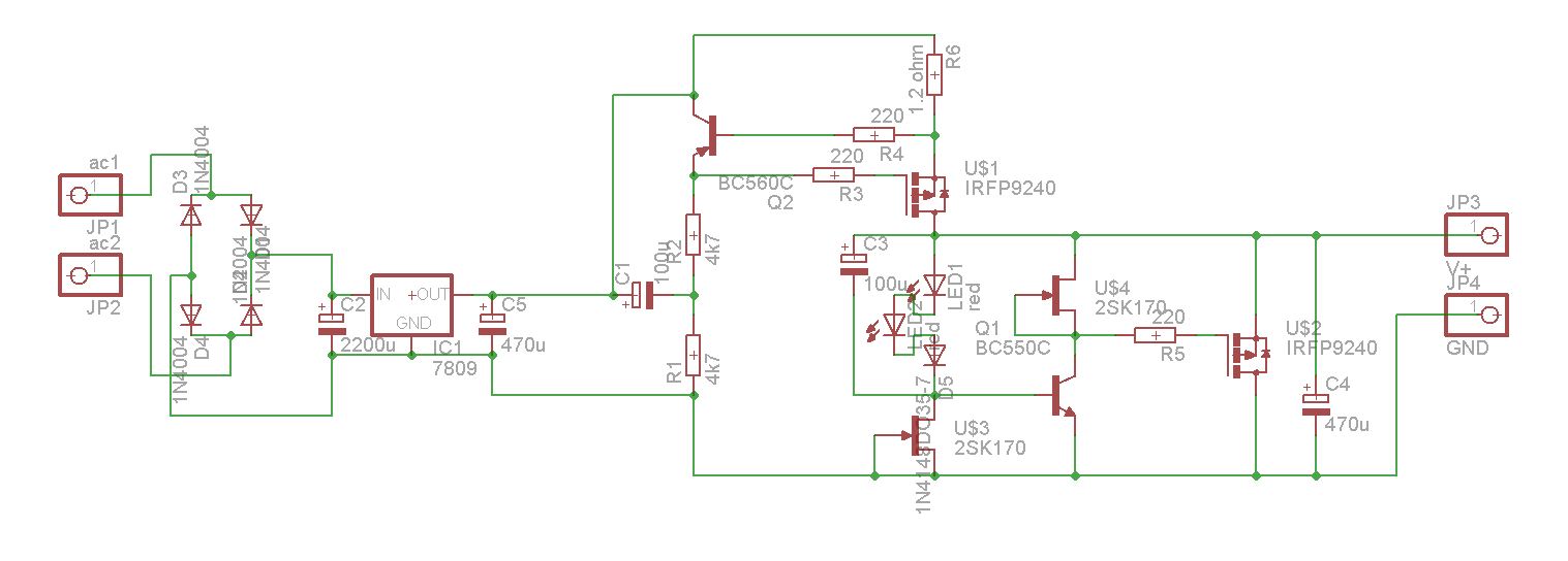

I did it like this; only DAC powersupply. 5.25V out. Works perfect.
(sounds good too!) BTW I used 7812 in stead of 7809 as in schematic.

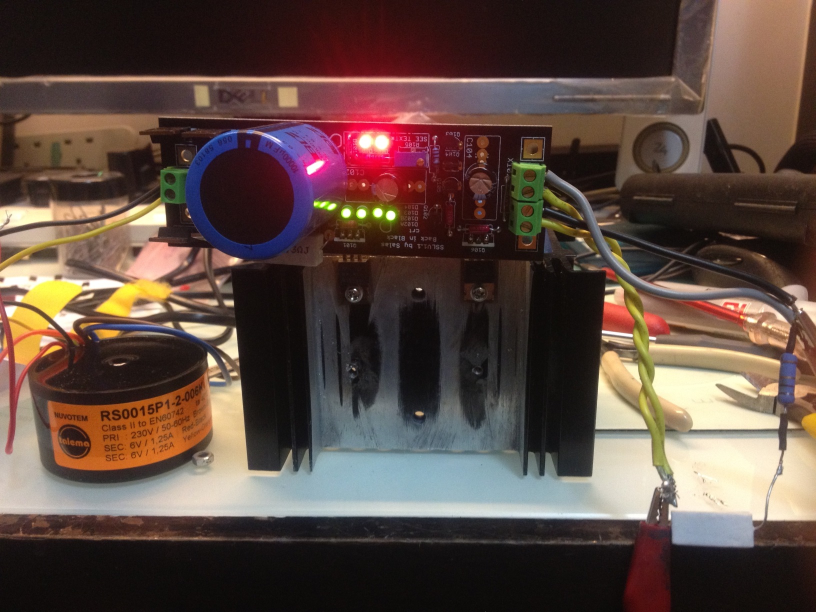

Just finished the SSLV for BIII, 5.25V 650mA output. It takes about 10 minutes for the output to be stable, drifts from 5.25 to 5.207. The temperature for the two FET are very cool. The Q101 is 40 Deg, Q106 is 34 Deg with ambient 28. Small size sink shall be good enough.
Hi, what is the value of Rx01 you use? I use 4.8ohm for 500mA and the heat sink is smaller than yours is quite hot after 30minutes.
The Rx01 is 3.3ohm with input voltage 15Vac and I installed all 4 green LED. The big heatsink give me a wrong impression that the heat dissipation of Qx01 is small. When I use a heatsink of 1/4 size, the temperature raised to 60 deg within 5 minutes.
