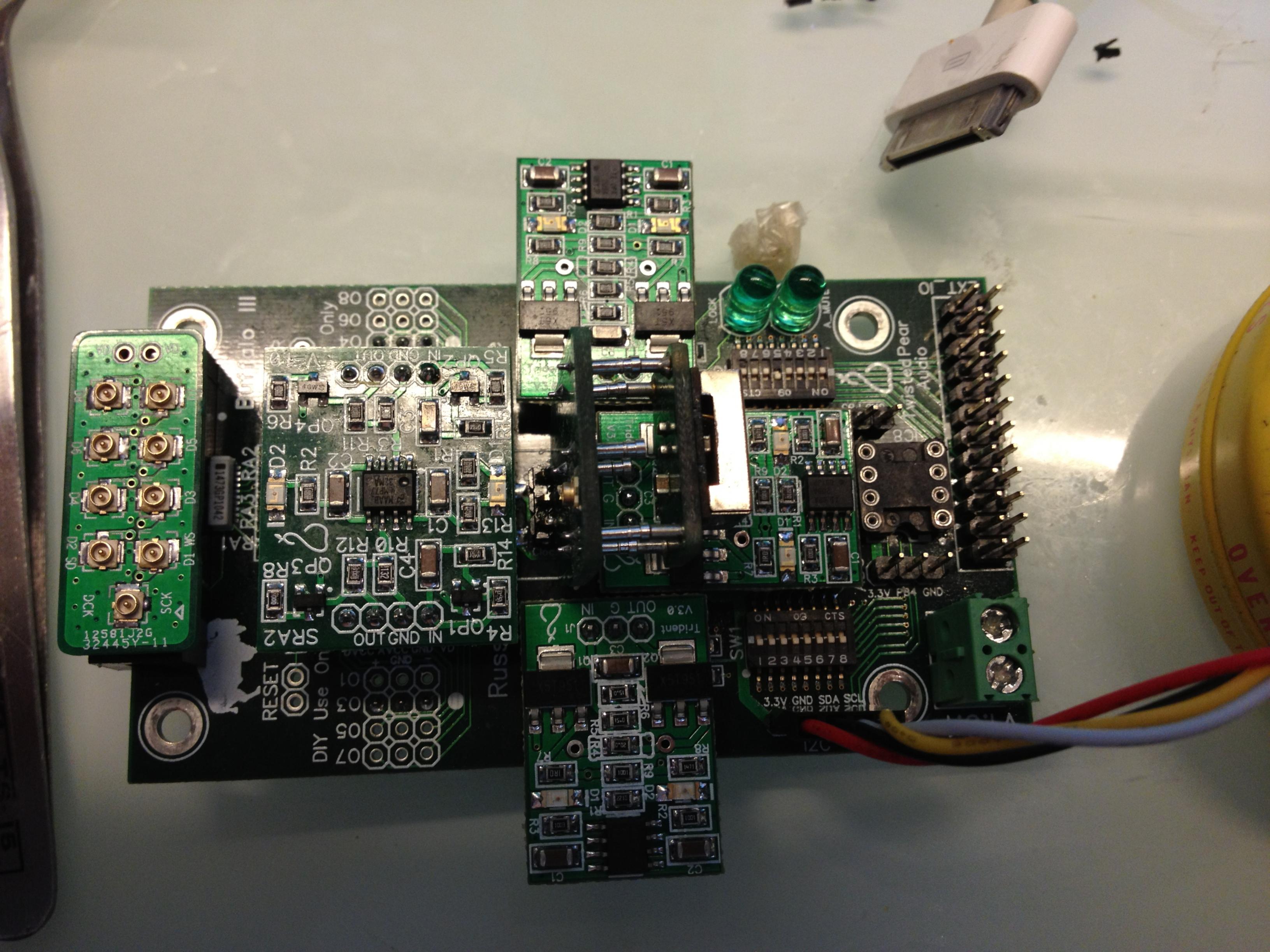

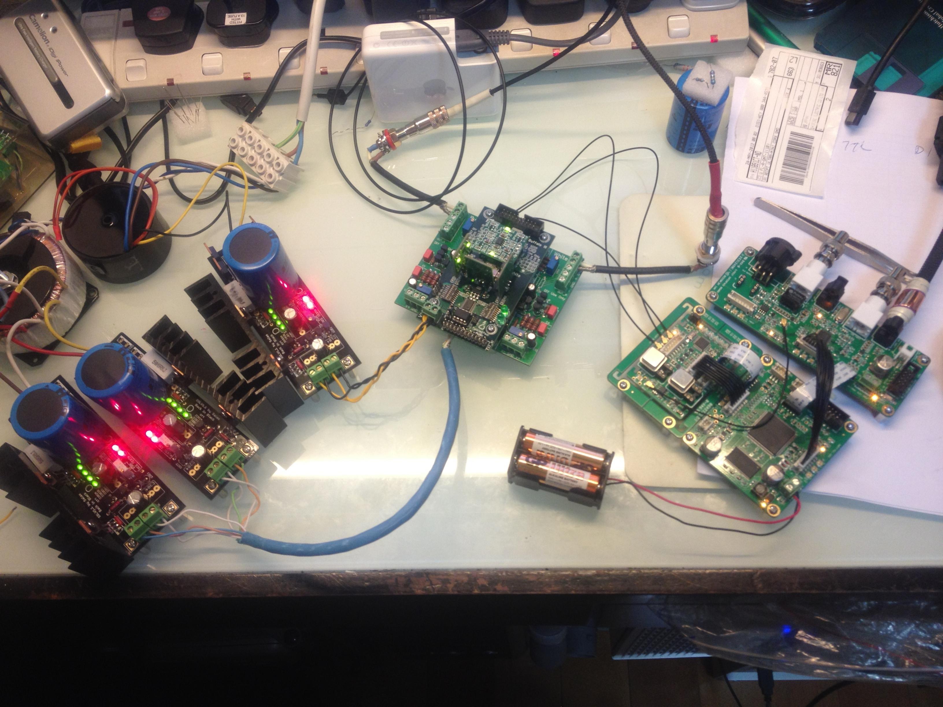

I received the BIII kits yesterday, a big surprise. Spent several hours for the soldering and install heatsink for the SSLVs. The most difficult part is solder 3 FL. sockets at the back of the buffalo. Finally, I have music from the BIII!!! Will connect the Arduino tomorrow.
Temperature on the SSLVs are still too high (close to 60 deg).

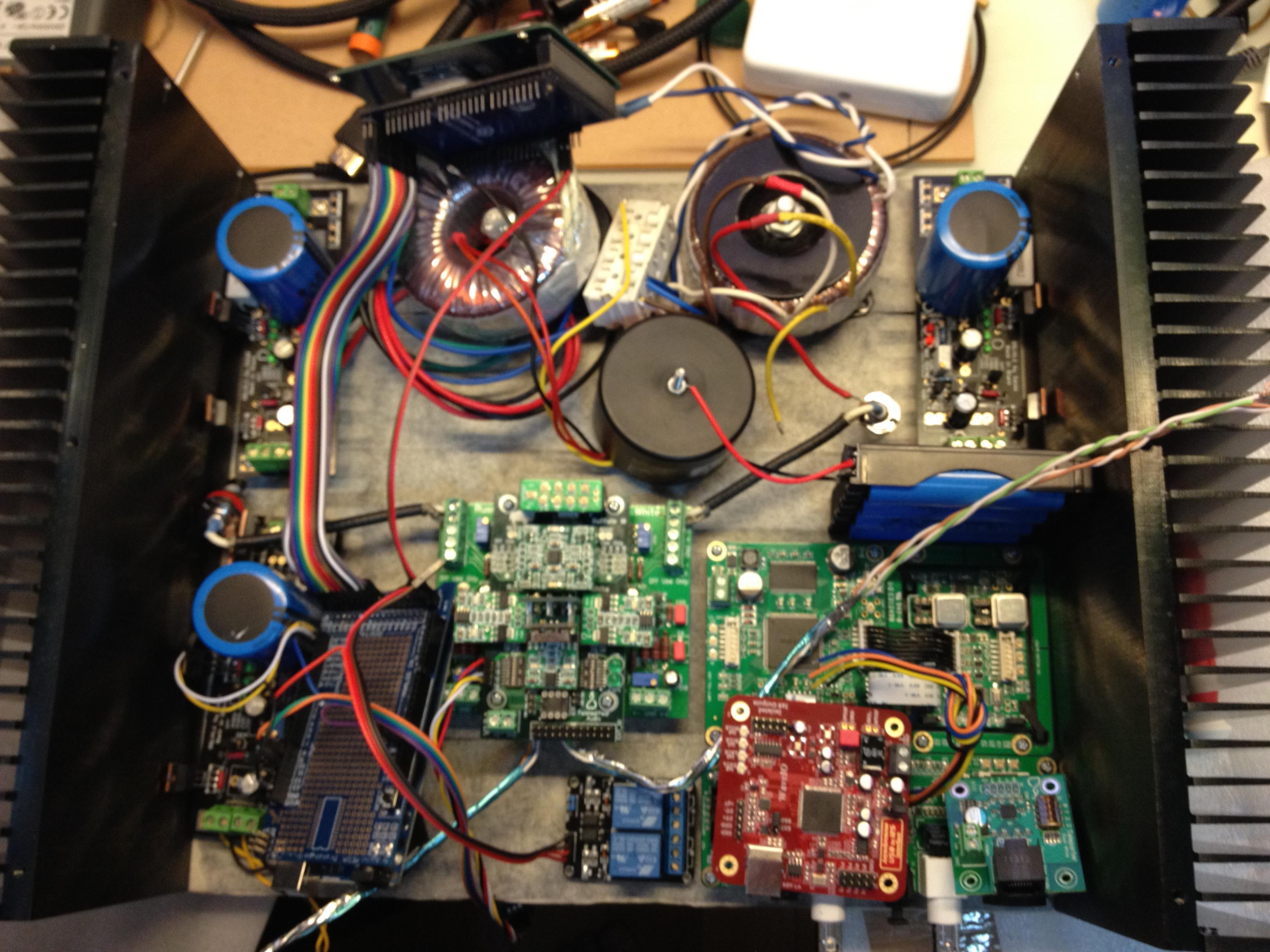

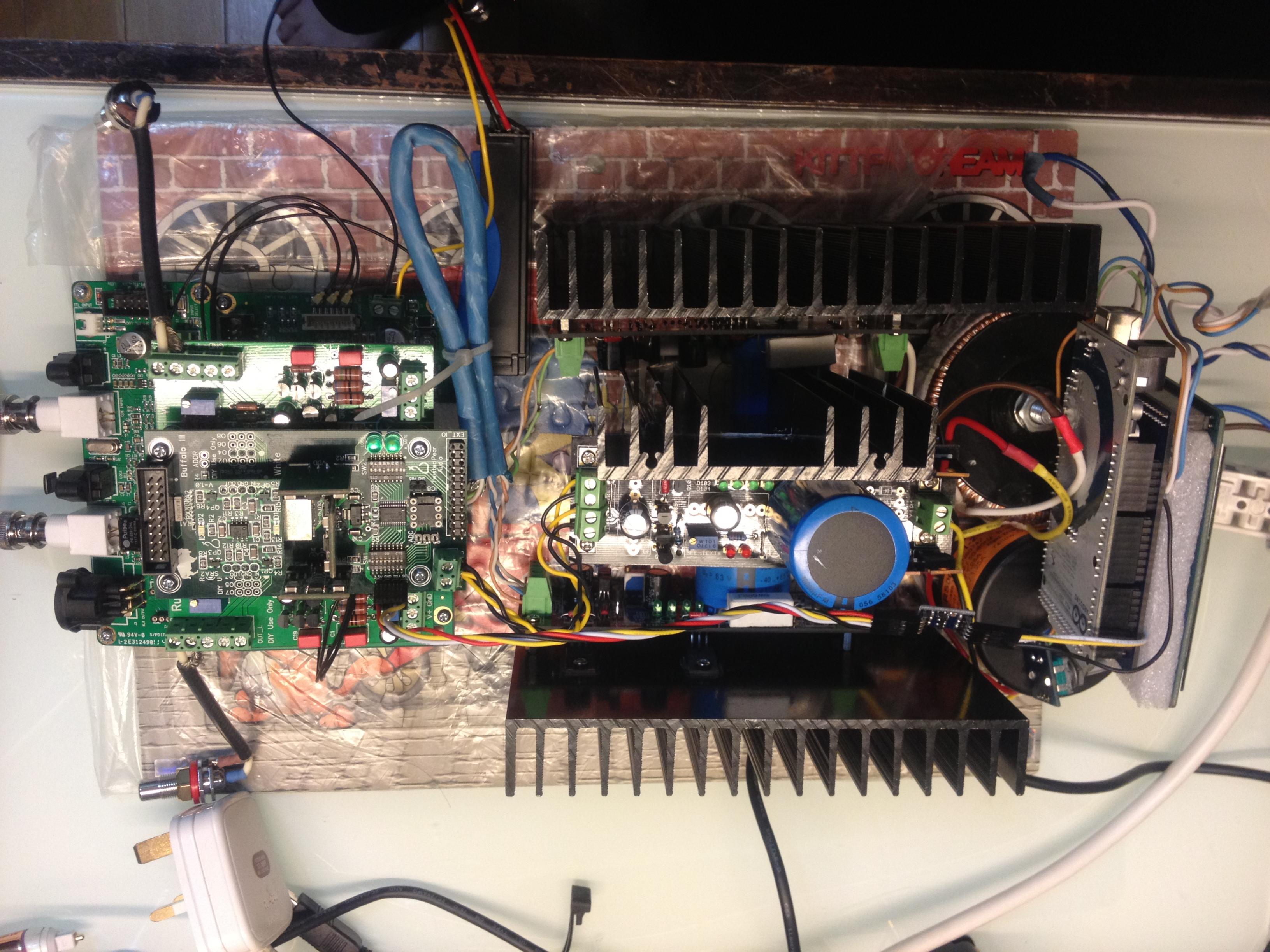

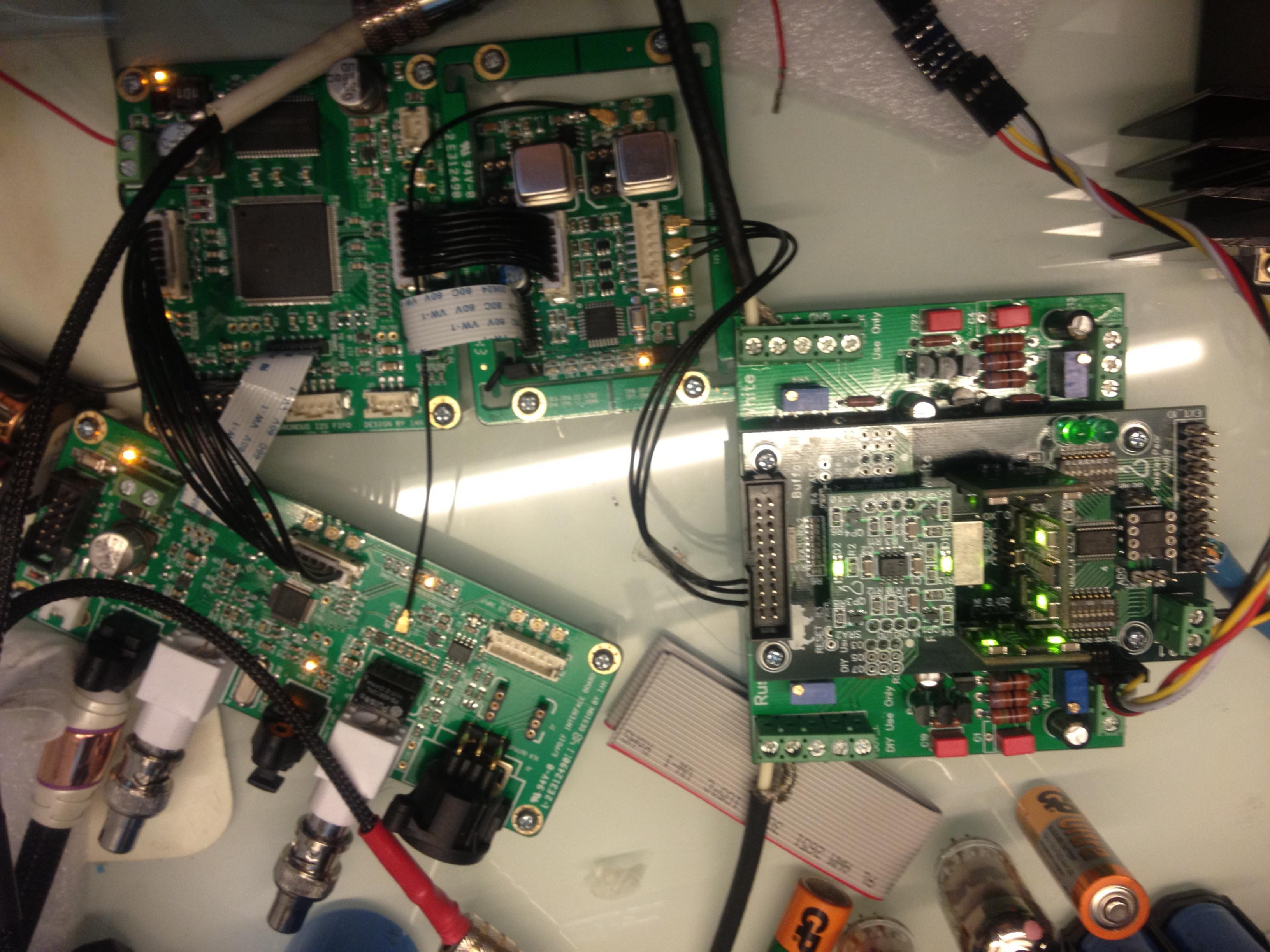

Today, I replaced all heaksinks for the SSLVs with much larger one. Before finding a suitable case for all the components, I have to figure out the best layout. After several trial, finally I come up with this as shown in the picture. I never expected I need such big size case with so many heatsink for a DAC!

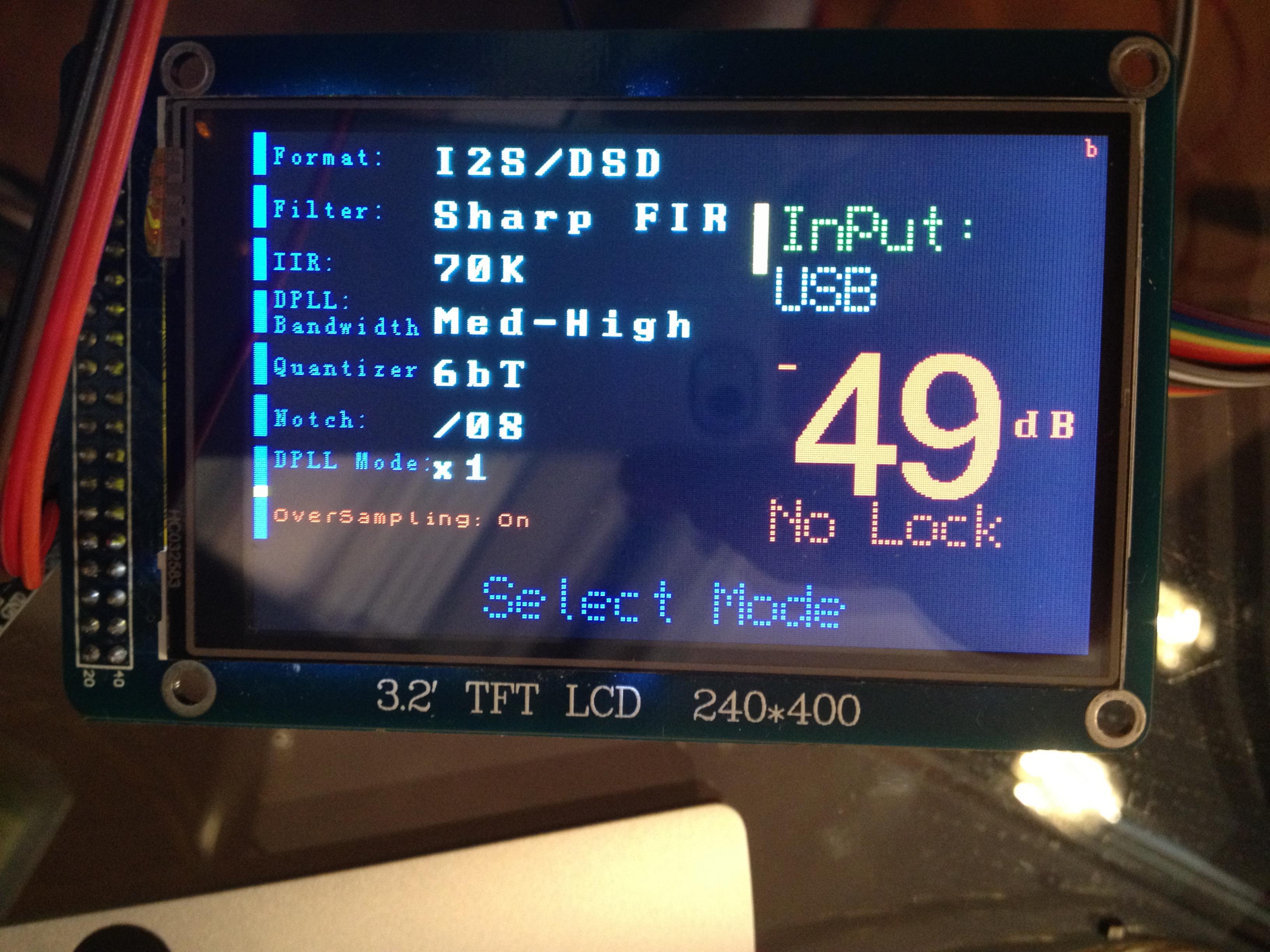

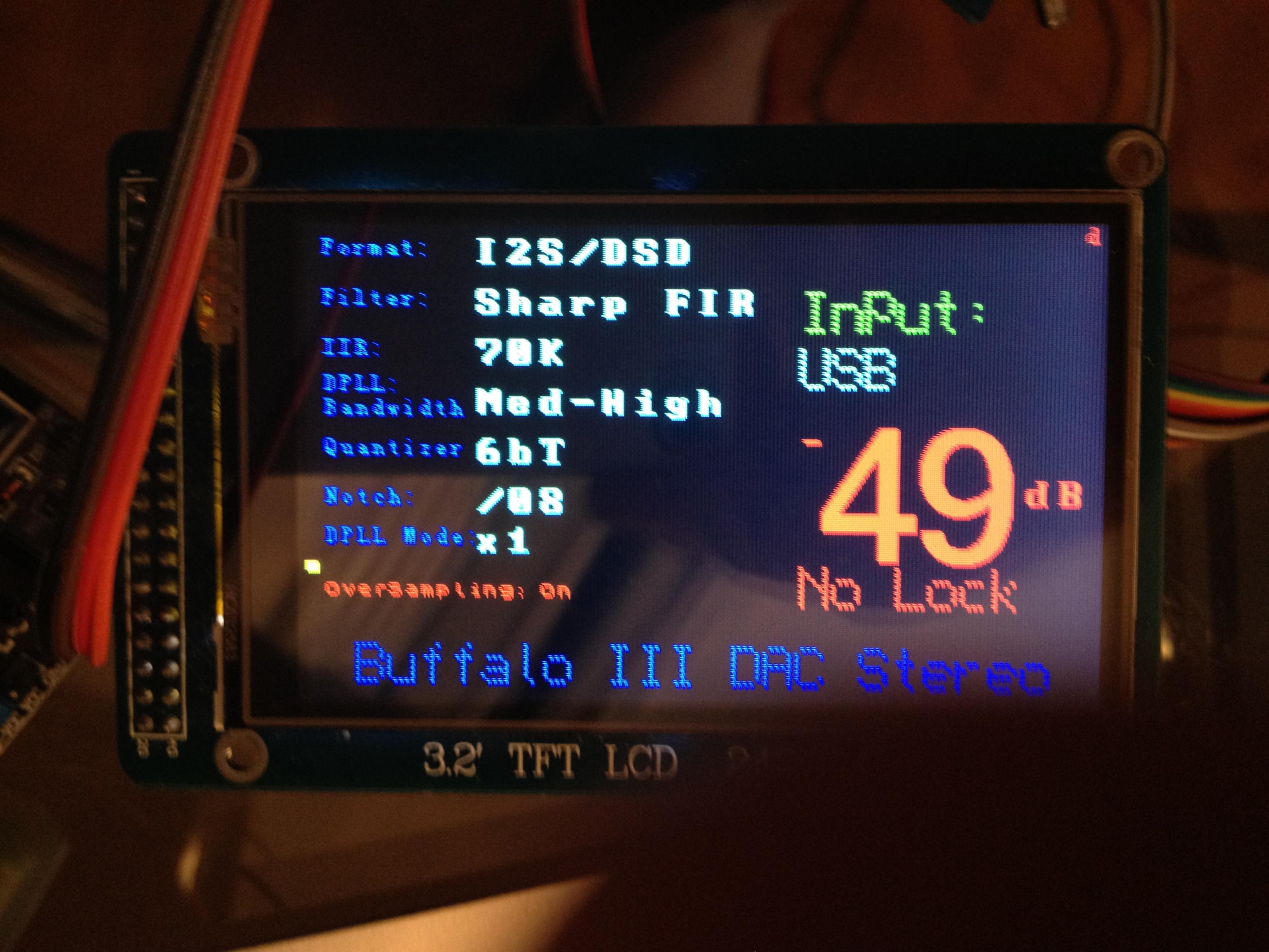

Finally, the Arduino connected with the BIII and function well. It's time to find a proper casing and decide whether use this color TFT or VFD.

It appears that you are basing your HiFiDuino implementation on my adaptation of HiFiDuino's code for the UTFT library.
I am glad that it is coming along so well.
I myself am taking a break from programming for the summer, and thus will probably be continuing as soon as the weather becomes depressing again. 🙄
There is much more work to be done on the code, for example you may have noticed that it is not taking advantage of the full screen real estate (it was originally written for a 240x320 display and not for a 240x400).

Thanks for sharing your code, it save me lot of time. I modified the code to fully utilize the screen, interface with Ian's FIFO and Selection mode can works with Remote. The only thing that need to be added at the moment is the controlling of Sidecar for selection between SPDIF and DSD.

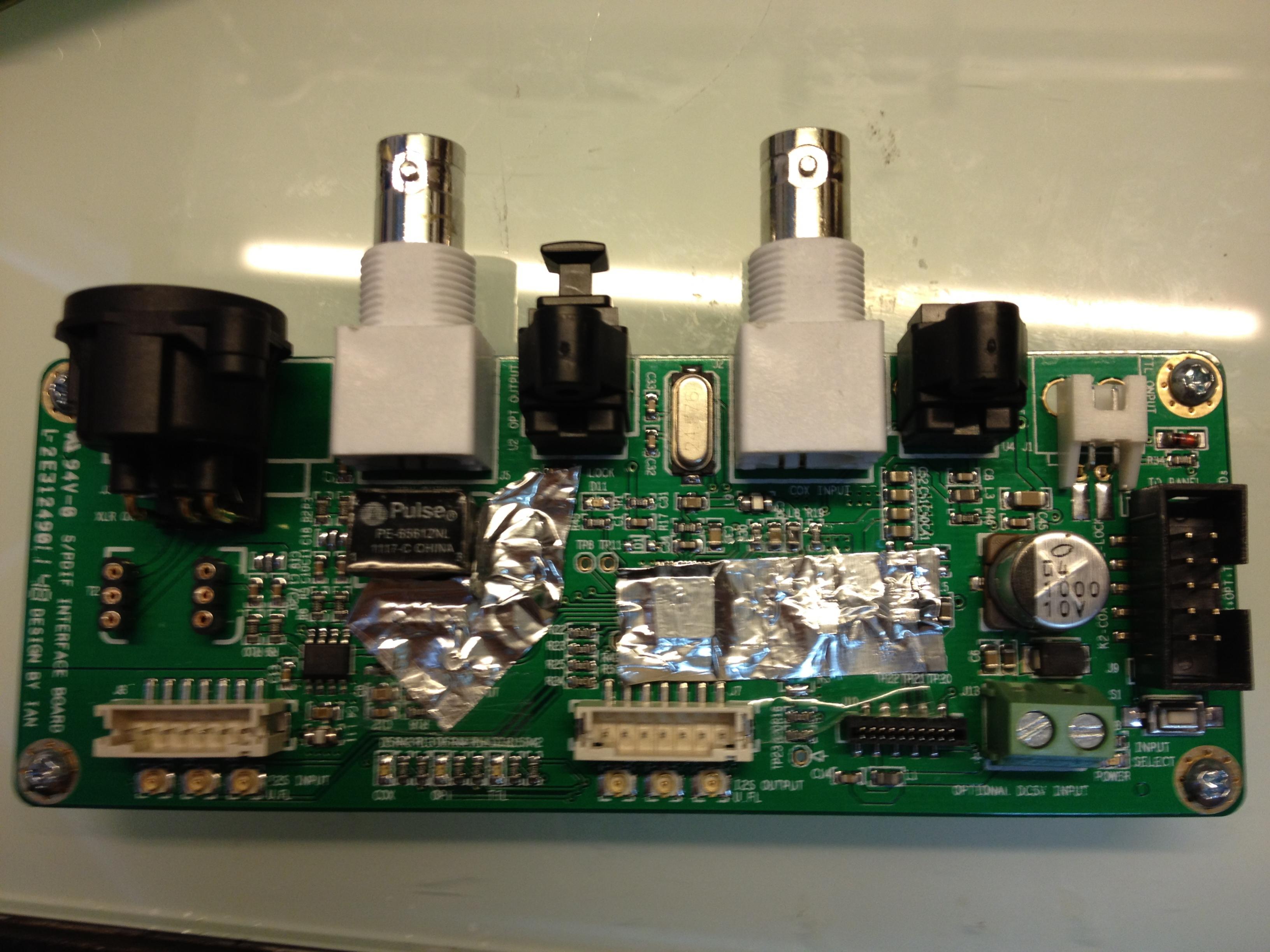

Thanks for Ian's high efficiency, he upgraded my FIFO and sent it back to me with all the adaptor kits within two weeks. Give me an extremely busy weekend. I installed the backdoor for the I2S, modified the BIII to use Ian's clock and input adaptors, control and monitor the FIFO input by Arduino.

I still can't convert a jpg file and display it on the GLCD successfully. I managed to display 3/4 TPA logo. Most of the time get the error message "image file too large" when compile the program. Can anyone help?
