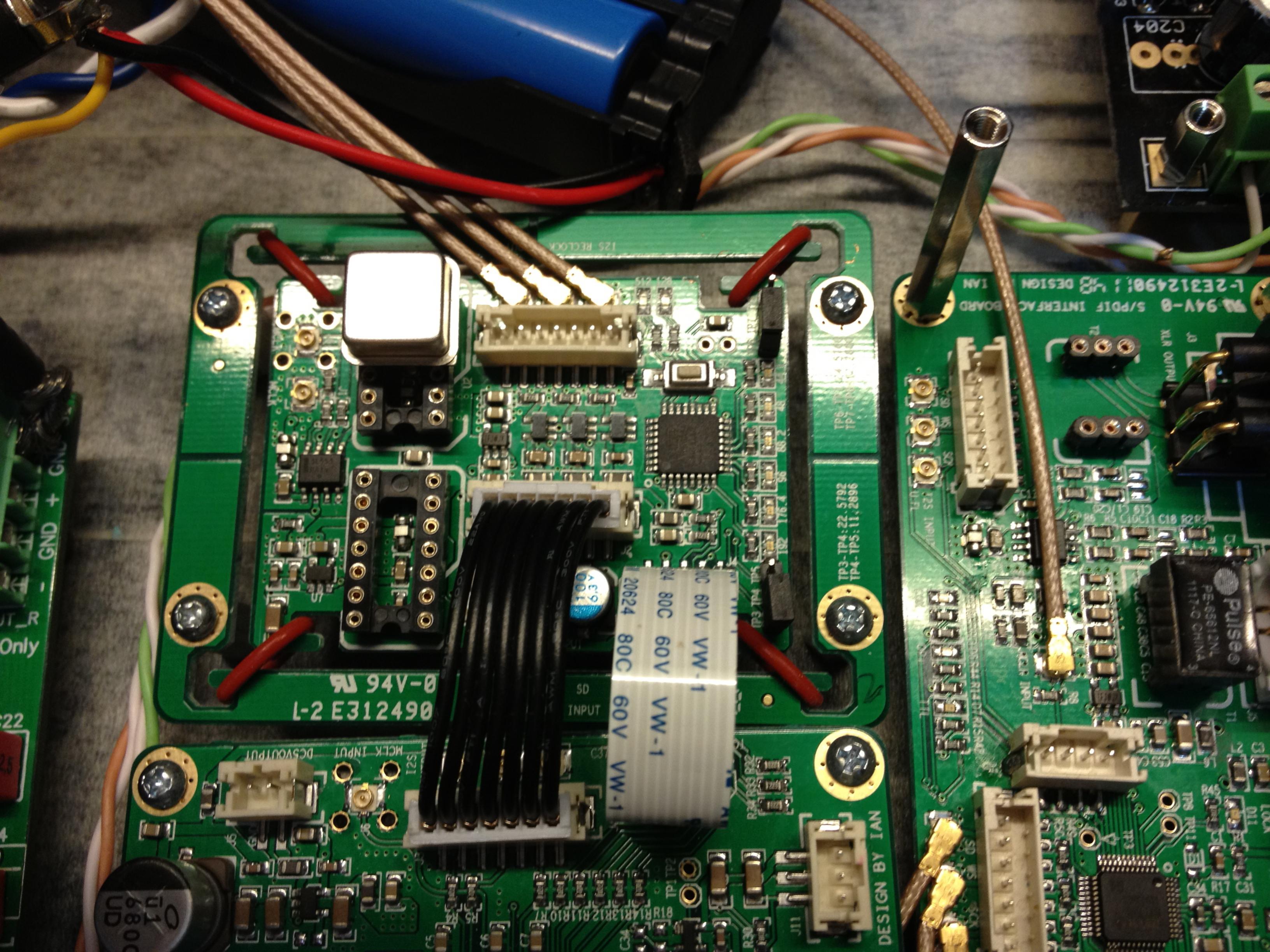

Just to let you know that when I changed the XO frequency to 45.x 49.x on Ian's clocker, my es9023 subu board got shorted.
Diagnosis: the short came from the es9023 onboard 50mhz clock. Replaced the es9023 clock and replaced the reclcoker clock to 22.x 24.x and all OK now.
Not sure if this came from the high clock frequency but I think the max on Ian's board states 22.x 24.x
Note: the 45.x 49.x combo worked for about 10 seconds before the short was created.
tried test again and at about 9 seconds, the lights started to blink so I immediately unplugged. I then replaced with standard clocks and all OK again

Its great information. I power the BIII with only DVCC supply and the current start to raise from 2xmA to over 300mA after several seconds which is similar to what happened to your DAC. I didn't use Ian's clock board to drive the BIII, I only use Ian's adaptor with the original crystal on the adaptor.

Please just check if there is any short on the BIII u.fl input adapter board. I noticed there is a power pin from the BIII input port. You can find more details from BIII user's manual about the input port.
Please run BIII at async mode first for your new configuration, then the sync mode. Just make sure all the section is in working condition.
I am running 45.XXXMHZ and 49.XXXMHZ at BIII sync mode with my FIFO for more than two months, didn't get any problem.

Thanks DQ828 and Ian, but I didn't make it🙁
The BIII behaved OK when I tested it with the bench PSU. Then I put it back onto the legato and connected the FIFO. Before that I checked all the output of the SSLV. Then power up, within seconds, the LED on the tridents blinking. Then I knew the same thing happened again. DVCC shorted to GND. :headbash:
Since there are only two ICs and one regulator on the BIII other than those passive components. The DVCC only connected to the ES9018. I can't think of any other source that kill the BIII and the only suspect is the legato. Will check tonight.
Already lost one third of a new BIII🙁

That is really strange. Using the ESS chip in asynch mode, does not use the master clock, so the bitclock, LRclock and DATA are still the same frequency regardless of the frequency of the clock in the FIFO board

I did not run the BIII in sync mode and tested it with everything disconnected (no u.fl adaptor). The BIII will overload all the tridents. Even the Crystek overload the XO trident. I have checked the legato and couldn't find anything that would kill the BIII. I have no idea how to trouble shoot it and may be it's time to let it RIP🙁

Just reporting back my clock problem.
root cause was the 45.x clock. removed the 100nf caps on both 45.x and 49.x and all working.
probably caused by an accident on my bench but not too sure at this point. It does not make sense that this cause a blown clock on the ess board.
