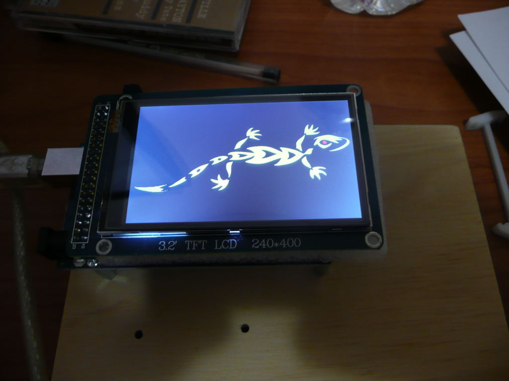

I highly recommend using the SD card facility if you want to display images. I had endless trouble until I reverted to the SD card tonight.
great job DQ828, could you provide more details on how to use SD card to store the file?
Sure happy to, the code is a work in progress, I have included it so you can see what libraries etc are needed.
Once you have downloaded the libraries #include <tinyFAT.h>
#include <UTFT_tinyFAT.h> I recommend that you should run one of the Demo's in the "example" folder in the UTFT_tinyFAT library.
You will need to get a standard SD card (not a mini or micro) format it to FAT16, How to Format a Fat16 SD Card | eHow.com.
Load the "pic.raw" files into the Root directory of the SD card, the "pic.raw" files are in the "Image-files" folder in the UTFT_tinyFAT library.
In the code you will need to change the "UTFTtf myGLCD(ITDB32S, 38, 39, 40, 41);" to
"UTFTtf myGLCD(ITDB32WD, 38, 39, 40, 41);
I think thats it!
If you want to display your own images, you will need to convert them to the ".RAW" format using Henning Karlsen converter & load them on the SD card. Dont put the files in a folder they need to stay in the Root directory.
You can see in my code how I got them to display, basically at startup the Lizard displays for a short time, the lizard aslo displays when I turn my system on, I m still working on the rest.
Oh, my courier font doesn't display properly😡 still working on that.
With "myGLCD.loadBitmap(0, 48, 400, 144, "L_YGB.RAW");" the 0 & 48 = screen position, the 400 & 144 are the image size, as you can see I have been able to push the width of the image right up to 400 pixels.
I think thats it!
