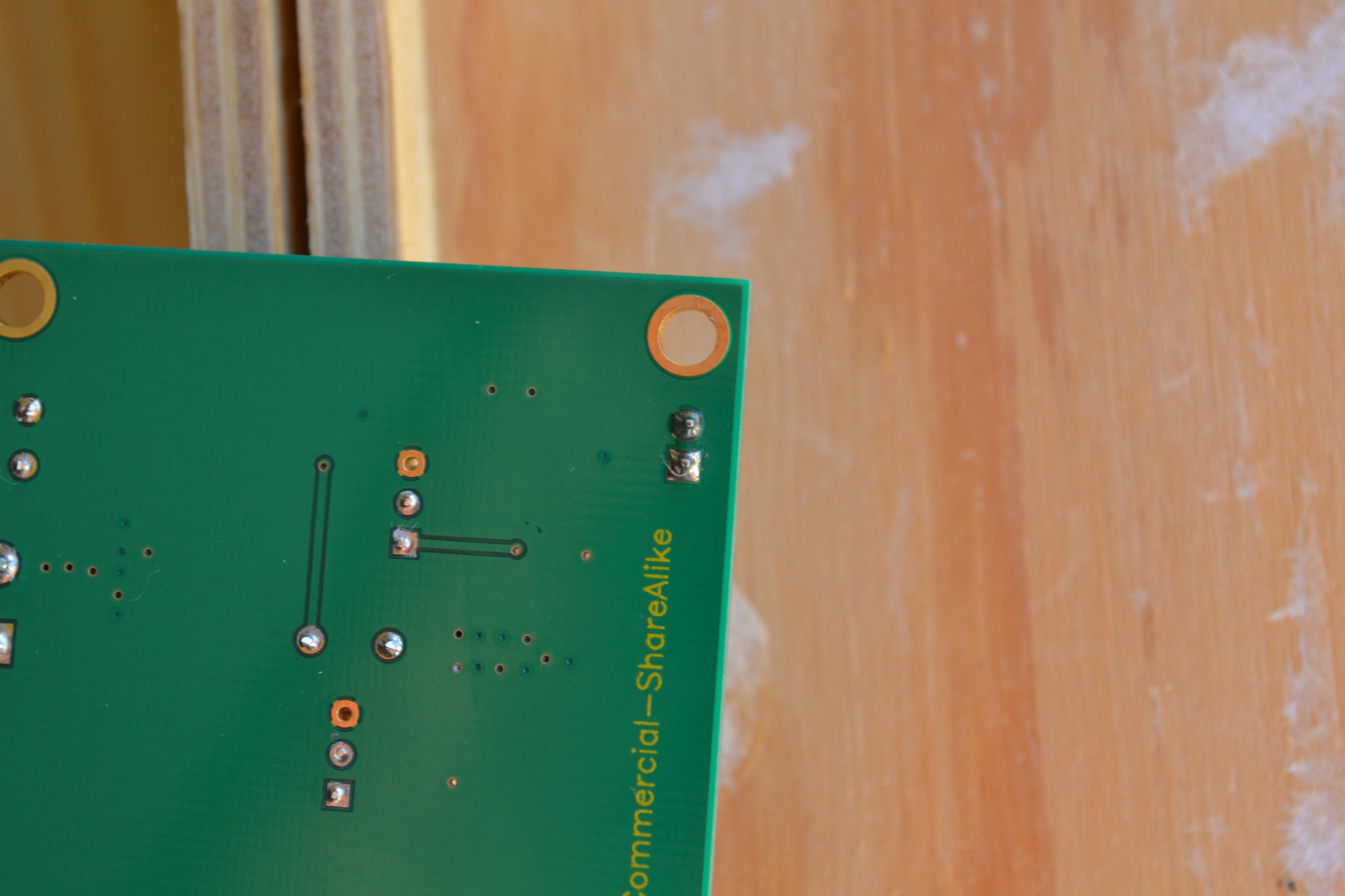

Phil: so here is the promised photo of the spdif connectors - hope this is what you wanted to see ;-) I ordered a new bnc cable, maybe the old one is the culprit. If changing the cable doesn't make a difference I will reposition the bnc connector so it is as close as possible to the spdif input port. just want to try the new cable first because I will have to make the whole front new for moving the bnc port - it needs a much bigger hole than the audio connectors so I can't just swap them ;-)

Post a pic of your SPDIF plugs, both ends, please.
Check the SPDIF wires continuity with your DMM too.

Phil: good idea with continuity check. Dont know why i didnt think of that by myself. looks like there is a loose connection in the wire i have. will wait for the new wire and try again 🙂

If you have a long spidf wire Inside the cabinet like your photograph shows .Try to keep the same impedance between the spidf wire between the cabinet plug and pcb plug with the one you use between the cabinet and your streamer/reader/computer audio card !
75 ohms is better than 50 ohms for spidf, even if you stay with non matched impedance plug like RCAs are.
Of course if your plugs are 75 ohms BNC from the computer to the cabinet spidf plug : even better than RCAs !

hey eldam, i do have a bnc plug from my source to the dac, so that should be good. I'm not sure of the impedance on the mic cable i posted earlier... will try to figure it out ;-)
You ordered Stereo wire with 2 shielded cables . You will only need 1 shielded cable, use the shield as the ground connection and the other cable for the data 😉

phil: are you talking about the wire from spdif out of the board to bnc plug? did a continuity check there after soldering and everything was good. since my old bnc to bnc wire is faulty i have to wait for a new one for further checks i think? I mean i could simple use a copper wire to bridge bnc out from computer to bnc/spdif in from dac, but i don't know what kind of new problems that would cause... *lol* If its easier for you to troubleshoot via chat/skype or whatever I am happy to do that.
Ok, check it again, and if it reveals OK then the trouble in elsewhere.
