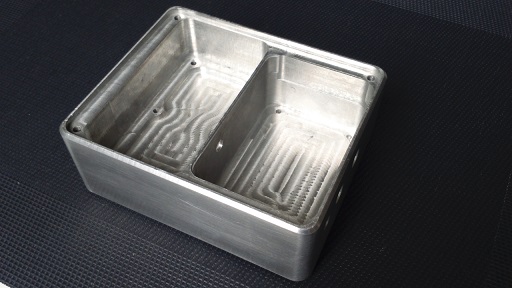

Build thread - building the Subbu DAC V3 SE
Next step anodizing.
Gold,gray or black can't make up my mind.
:confused:

Beautifull box ! Wow ! Any cheap GB planned ? Aluminium is light :)
In your shoes I will put a connector at each side of the partition wall instead a hole to allow even more EMC isolation ? two tunnels for AC wires with a widther box if JG buffer used (need to be feeded by a separate supply) : to allow an AC plug at the bottom of the box but separated by a partition wall from the DAC board aera !
Will make the box a little bigger despite the big thick of the partition wall to move away more the PS unit from the pcb dac unit ? For a second PS (JG buffer) : PS compartiment splitted in two to isolate the traffos from each other ?).

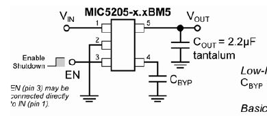

started soldering Subbu DAC. When I soldered U3 mic I got the impression of a flash
while soldering the three side feet. Do you think I damaged the mic?
northernsky
finally I completed DAC soldering and made the preliminary test, measuring VDC at L3-L6 without these inductors soldered.
I think the test is OK, but please give a confirmation, since I am not expert.
On one side of inductors I measured the expected VDC and on the other side I got obviously 0VDC as in the rest of the circuit. But only for L5 I get the measurement as in the picture in post #1 describing the test; for the others I get 3.2 or 3.6VDC on the reversed pin. But I assume is an error in the picture,
am I right?
Thank you
Northernsky

As you haven't populated L3/4/5/6, you can't measure further :)
BTW, 50MHz XO isn't fed, same comment for C17/22/13/8.
So, please check again your voltages on Tantalum C27/26/15/16.
Please confirm you've measured positive side of the caps (+).
If previous request is correct, then I suspect U3 (MIC5205 3.3V) to be faulty.
Check U3 pins 4 (Gnd) & 5 (Vout) values, according to attached pic.
