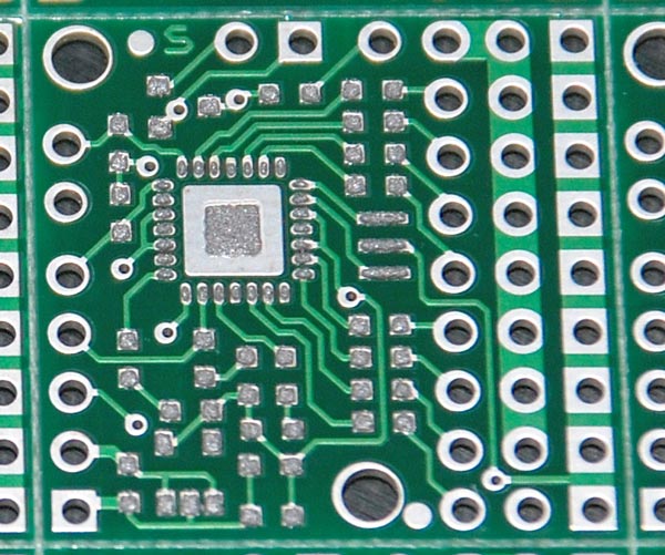

According to my understanding, your pic shows SMD solder paste for oven reflowing/hot air soldering.
SMD flux is translucent.
Tacky flux syringe and thin wire hand soldering then. Takes time and discipline to come up so well finished even after getting the knack. Nice work.
Thank you for your kind words Salas 🙂
Leaded solder 0.5mm thin (60/40).
Yes it takes time and attention, I consider it as a "Zen Meditation" 😎

Do you clean with Isoprop and toothbrush also in the end? As for those BL, old story indeed, but never too late. Don't match, random are fine too. Just pm me when you will remember.
Yes Salas you're right, some kind of "strong" aerosol cleaner for PC + toothbrush.
