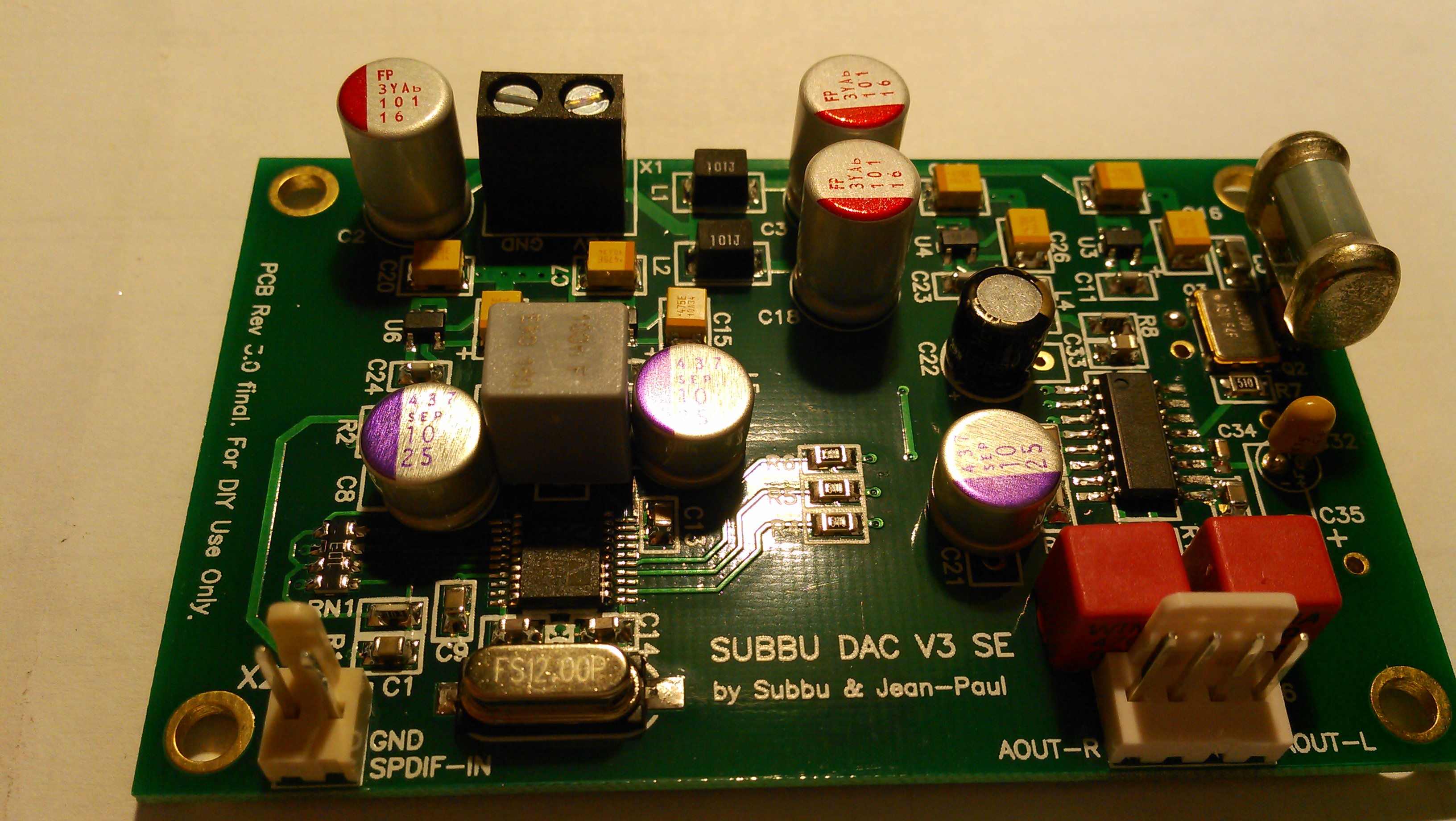

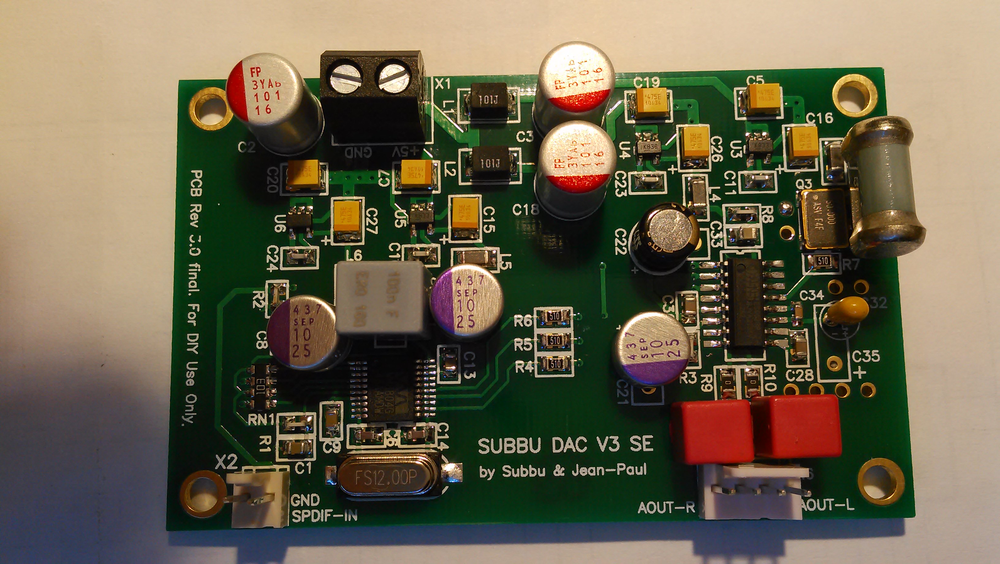

Finally one more Subbu/Jean-Paul dac deliver sweet music! My first smd build and had a few hours when nothing worked and find out that i had been little too careful about the XO! No electric contact on the four XO pads! Put more flux in and reflow with the tiniest iron i had and success!🙂
Impressive sound from the first minute.
Special thank´s to Korben69 that helped me with parts and through the build.

Looks good, I think you soldered the beads after making this picture ? I see you adapted to the mods which is a good thing. You also choose the best cap for C32 and you choose the original tantalum cap on the XO which is also a good decision. Must be a very good sounding example of the V3. I would reverse one of the output caps as I believe in audio voodoo 😉
I am glad you like it, it is nice to know there is another satisfied builder.
Thank´s Jean-Paul! Yes i forgot to take another picture after the last beads was solder in place! It´s cooking and have played music 24/7 since that🙂
And yes indeed! Jawdropping sound into my system! Have tried a few nice dac´s before and did have some expectations from this but couldn´t believe that it should deliver like this🙂 Thank´s Jean-Paul and Subbu!

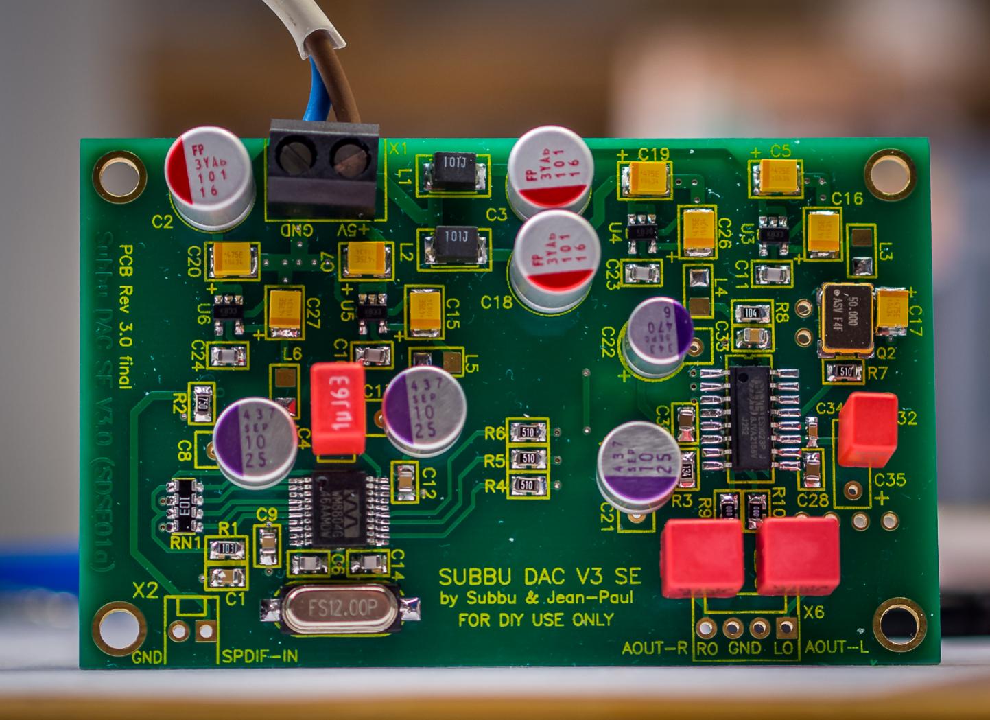

Hi Plan
Congrats for your SMD solders, very neat & nice job !
L6 should have been a little bit tricky to solder, wasn't it ?
Very nice shot of your built, kudos. 😎
Giving you a helping hand was a pleasure.
Regards
Phil
