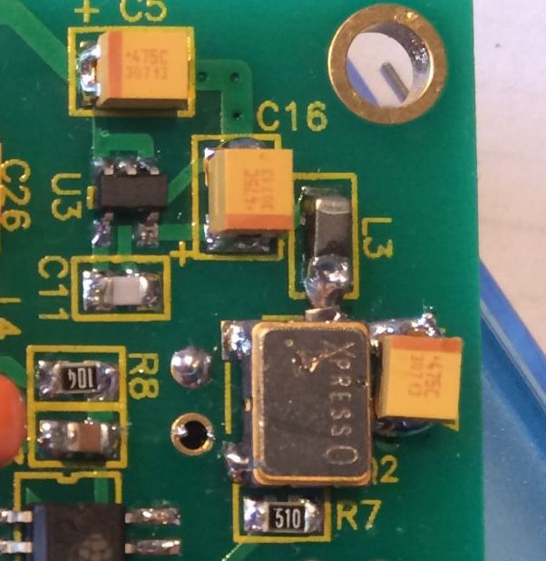

Despite reading the whole thread, I'am in the dark. I build two dac (at the same time, which is stupid I know, I should have started with one the the other ...).
At first both were having problem with Q2 (V around 0 on ess pin 11), Q2 were not correctly oriented (My fault I only used the picture in the first page of the thread instead of looking at the datasheet). I manage to resolder both Q2 and now all the voltage on both ess are good. One of the board had bad voltage on all wm8804 pins, I destroyed it trying removing excessive solder on wm8804 legs.
The other board is not working (no sound, perfect silence) : On WM8804 I got 1,83 V on leg 9 instead of 0V, 0,81V on leg 10 instead of à,52 and 1,50V on leg 13 instead of 0,83V. Everything looks good on the dac side. I tried using Q1 from the board I destroyed and I got the exact same voltage.
Does anyone has any idea on what could be wrong ?

looking at the schematic I was thinking my problem on wm88804 come from Q1, but having trying two of them and getting the same voltage problem I really don't know. I have double check every solder joint, all voltage at regulator and other vm8804 legs and everything is normal.

moumousganou, I'm not clear about whether one of your builds is actually playing music or both are not functioning. Please explain.🙂

Bcmbob, sorry for not being clear.
Both board are not working. One is "dead" as I lifted some pcb traces while resoldering wm8804.
The other one looks ok but doesn't play music. On this board checking the voltage against Atupi value (post #256) everything is good except for legs 9,10 and 13 of wm8804. I first suspected Q1, but I tried using Q1 from the "dead" board and I got the exact same value.
Q2 was soldered with a wrong orientation, while desoldering it (with my basic iron) I accidentally tear the pad on the upper right side. I used a flattened piece of copper wire to make a new track between the cap and L3 and soldered Q2 on it. That's why Q2 is is shifted right. I checked all the continuity and amazingly everything is ok and I get all the right voltage on the dac pin. So I think my problem is coming from the receiver part.

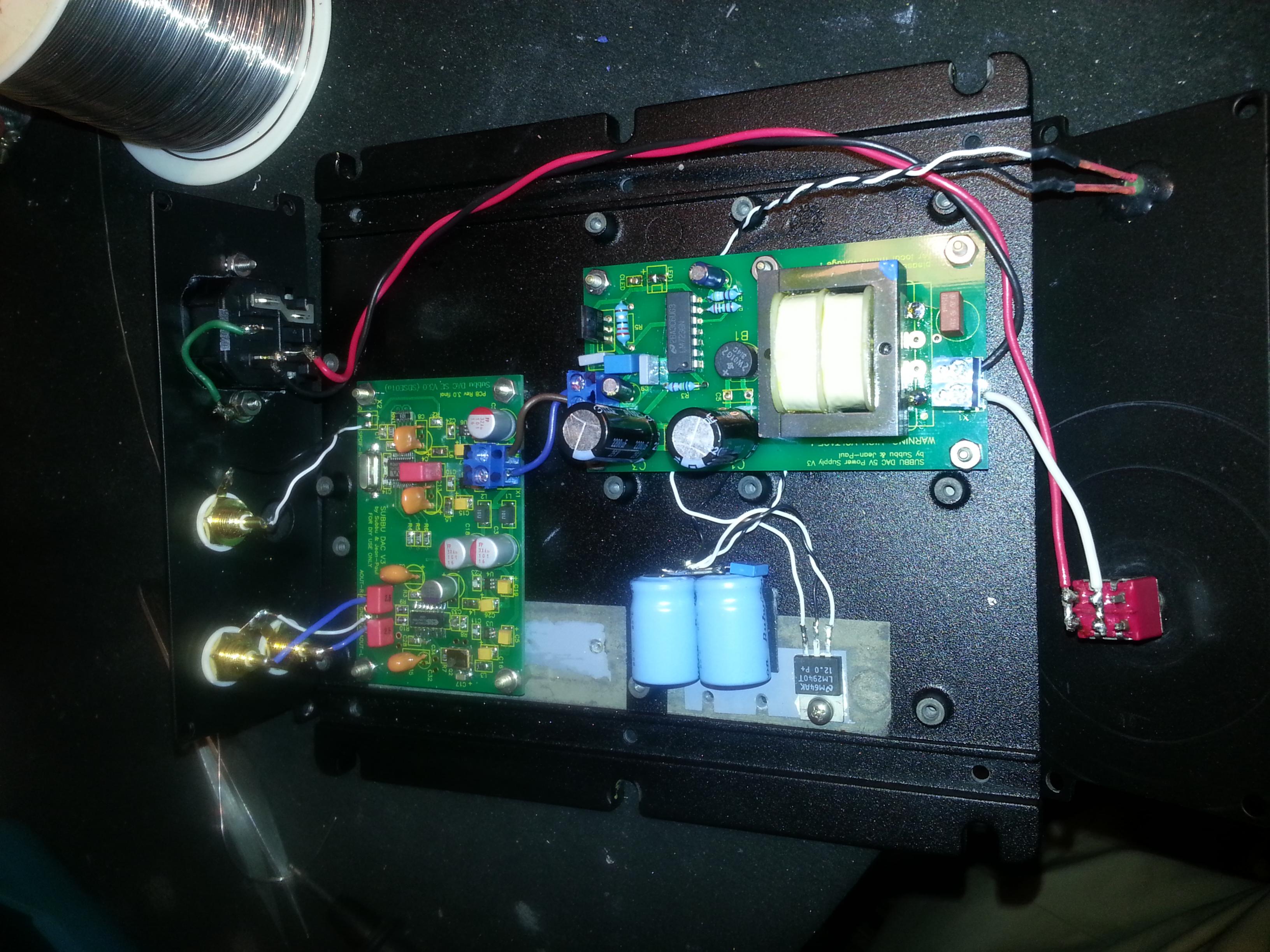

I finally got music out of my DAC. It sounds really good during quiet passages but mid to louder passages, really bad static distortion, especially during a bass hit. Any thoughts as to what the issue may be?
