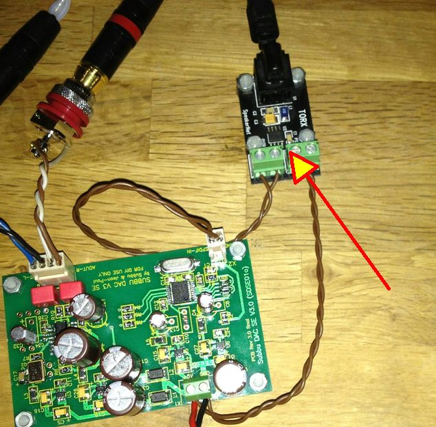

I've started my build and I'll be including both coaxial and optical inputs. I'm going to use a toslink module from Twisted Pear, it requires anywhere from 5 to 12 vdc and pulls about 35 mA. I'm using the PSU that you designed as part of the group buy. I was thinking of pulling a 5 vdc source from the DAC PSU to power the toslink module. Do you think that this will be all right, or do you think that I should power the toslink from it's own PSU.
Thanks,
PJN

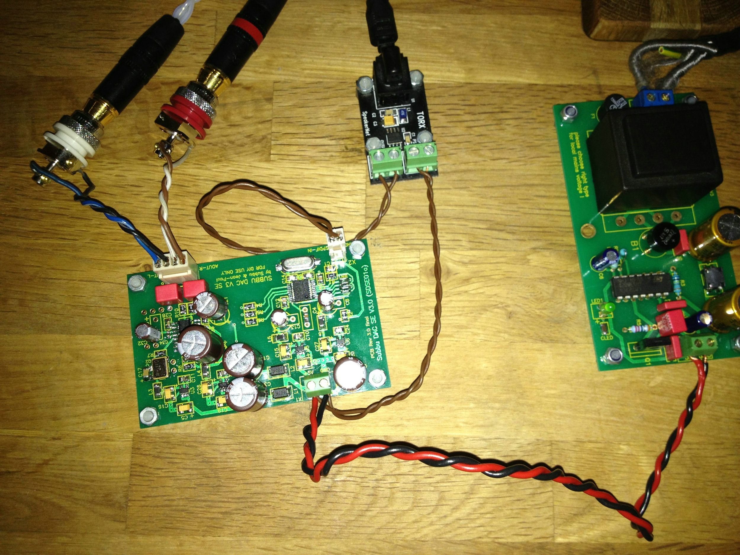

Well, here it starts, with the PSU:s. I'm building two DACs with 2 PSUs. The first one is fully populated:
The second one is lacking the fuse, the transformer and the semiconductors as I need only one PSU to test the DAC:s and for the second one I have plans that would need more power than the on board transformer could give, so I need to upgrade the fuse as well and fit the transistor on a heat sink. And I left the soldering of the LED wires to this later point as well.
Couple of notes for the PCB designer:
  • Pretty big holes for the plastic caps here
  • The wire terminals could use some more clearance around their foot print. There's almost no clearance at all between X2 and C9 and as I used a jumper wire for the transformer I couldn't get X1:s straight.
Testing is something for the end of the next week when I get home. Now I do not have equipment for that aside a DMM. And no, I haven't even cleaned the boards yet.

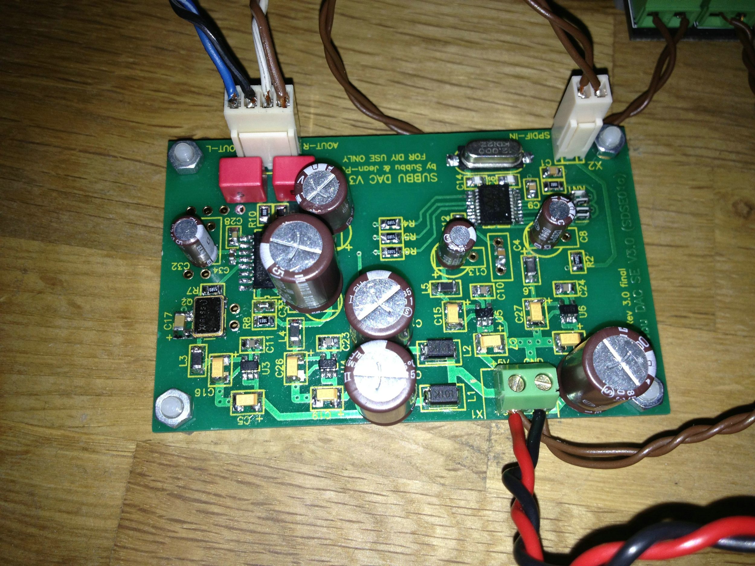

Just have finished mine!
many thanks to JP for such nice project! It was a pleasure to build unlike Red Baron, for instance, which became a non working nightmare for me 🙂
I'll give some time for burn in and later compare it to Benchmark and other diy Wolfson DAC.

That's the TORX Optical to S/PDIF converter. I'ts a great unit but seems to have disappeared from eBay. Many were used with the Mini 2496.
Edit: Ya, what he said 😀
