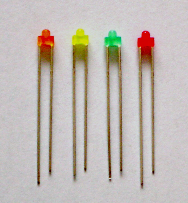

Replace the LED just in case and check the cathode for the correct placement. Check the resistor too. It should be 1k4 for a non-ultra bright shining green LED. If you feel it is too bright even with 1k4 you could use 1k8 or 2k. With 2 kOhm the LED will have 1.6 mA flowing through it which must result in a dimmed shining green LED when using standard 3 mm LEDs. For other colors values might have to be adapted as they have a different Uf. People that use bright blue LEDs don't need to apply for info as they are dismissed 😉
Calculation: 5V -1.8V = 3.2 V. 3.2V/Rled= Iled. So 3.2/2000= 0.0016 A = 1.6 mA

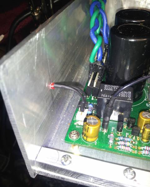

If you use the Molex KK connector for the LED you can solder thin wire to the LED at the other side of the wires, insulate the LEDs lead wires with thin heat shrink tubes and heat those with a lighter to shrink them. Now put some adhesive (sticker) on the front panel (to avoid scratches from drilling), determine the place where you want the LED, then drill a 3 mm hole in the front panel of the case with a sharp 3 mm drill, remove the adhesive and the debri and use a 10 mm drill to deburr the hole Do this by hand, just turn the drlll lightly clockwise and feel if the burrs are gone. Don't overdo. Now put the LED in the hole from the backside. Secure it with some 2 component glue at the back side of the front panel. It is nicer to use a so called LED clip for the LED or a prefabricated LED with clip for this purpose. Check the distributors for finished products. For a few $ or Euro the results will be better. I use these made by Dialight and I think they're OK:

When using a LED clip the hole must be 4 mm in most cases but check first. Also deburr the hole with a 10 mm drill by hand after drilling the 4 mm hole. With a LED clip you camouflage the clearly visible drilling.
I hope it is clear that using the Molex connectors will result in easy disassembly of the case when the device will be modded, repaired (Subbu DACs don't break down but still...) etc. This counts for both the DAC board and the PSU board. You will end up with an unusable DAC when you will have to desolder wires a few times from the PCB.

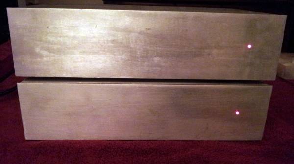

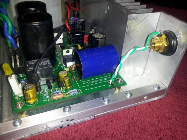

Here is an example of the technique JP describes. It's on a FE power amp but is the same thing. I didn't finalize with glue/RTV as the chassis serves as home for a couple versions of the amp. I used tiny copper tube from the local craft/hobby store on the LED leads to replace the female Molex and avoid soldering to the pins.
Ah Bob, always in the first rows of the class 😉 Thanks for the pictures.
When a high speed drill is used (so no deburring necessary of the hole) and flat round 3 mm LEDs are chosen it really looks good as they will be flush with the surface of the front panel. Of course that won't happen with the Dialight ready made panel LEDs. There are several lengths of these flat head LEDs so check and choose according the thickness of your front panel. BTW when I googled for a picture of the flat round LEDs I just discovered that these also exist in a kinky purple version. As any color is better than blue I suppose it won't harm to show the picture.
Of course I found even nicer 1.8 mm LEDs. They will not be flush to the surface but they will be recessed as with Apple Macs. Wish I had discovered those earlier as it seems they will give a "chique" look to DIY gear. And then I suddenly thought: how many pages can we fill talking about Subbu DAC's power LED ? 😀

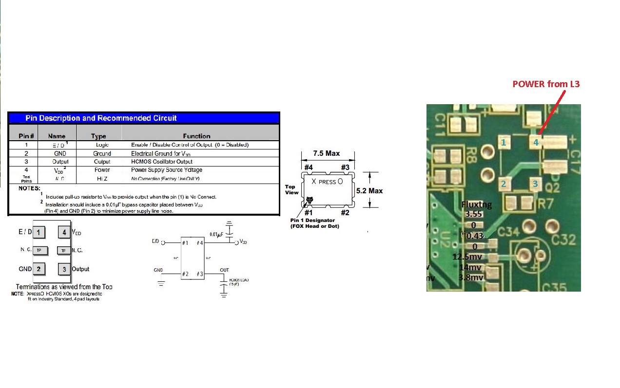

The other way around. The dot should be at the left upper corner if the out put connector face to you. The photo that showing the dot at the lower right corner now.

Exactly. It would have been better to ask first and solder later. And please solve the output wiring too and clean the PCB from excess flux.
Its not soldered on yet! look a bit closer instead of picking up things that are not finished 🙄,

C17 needs to give way in order to put Q2 in place. Change C17 with ceramic cap. Fellow member GaryB mention it awhile back. I did that and noticeable, I don't want to say a big step up but very significant.

There is a problem here. The second picture in post #1 shows the dot in the correct orientation. It is reversed in the next one.
In post #6 JP states that Q2 needs to be reversed but no reference to which photo, so there could be some confusion. I need to straighten that out so I made a composite keying on the power supply for Q2.
That means the "Dot at the thick line" indication in post #1 is also incorrect, adding more confusion.
Before I make corrections to the first post - please confirm.

No problem Bob as we're still breathing. The picture you just posted is right so for you guys it is post #575 that is right. I am flabbergasted in what ways I can make clear how to solder Q2 😕 Many 2.6 DACs have been soldered and no one asked....
Something like this ? "The text written on Q2 should be aligned with the text C17 on the PCB" ?!?! You decide as it is your language. I can make it perfectly clear in german/dutch language if needed. After some thinking a small yellow dot on the PCB indicating pin 1 would have made it better but you all really should be able to read datasheets and follow PCB tracks when you want to build a device like this. No excuse but this is a DIY thing not a kit or ready made device. Any builder should take the challenge to build this thing with ....OMG... some own thinking
