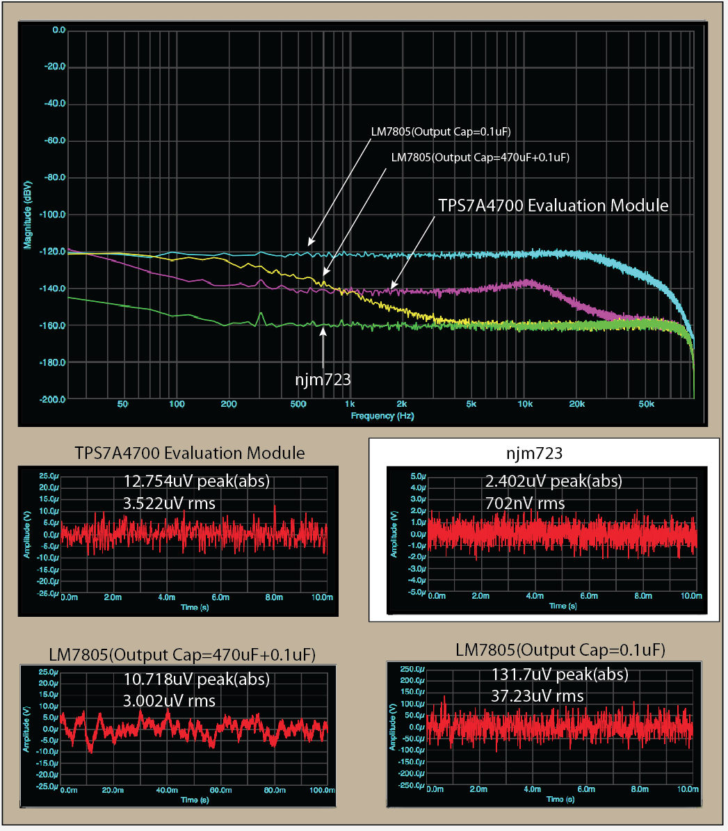

That was already tried out by a member but I forgot who it was. The Salas was only very slightly better but considering the size/cost/heat the original PSU was preferred. Feel free to experiment, I think our LM723 🙂 (still makes me laugh) text book design performs very good. There are only a few regulators that beat the LM723. No 3 legged device can beat LM723.
This japanese gentleman also found out TPS7A4700 is not better than LM723... interesting read.

It could be me, actually. I think the LM723 based reg is still excellent with respect to the simplicity, ease of housing the whole unit in a case, and bang for the bucks. It was indeed very close to my very first p2p Salas shunt reg build.
Lately (last couple months), I have tried a few implementation of the Salas Shunt reg, I have to say that the difference is now very noticeabe when I switch the 2 reg back and forth. Since I don't have the right equipment to scope, it is my subjective opinion that the shunt reg is more suitable to my preference. The dark side of the shunt reg is that it adds complexity such as
1. One must follow the "cook book" to figure out how to get 5V.
2. the housing of the dac becomes less flexible as the shunt requires significant heat sinking,
3. a separate transformer
Since it is DIY, one can decide whether he wants to explore or not. I have all the parts (new or used) to build the Salas shunt reg, so it cost me nothing to explore to unleash the max perf of the Dac 🙂
OK. I like the Salas and I have them in my DCB1 but IMO they are not really suitable for the Subbu V3 in terms of size and dissipated heat. Subbu V3 should be build tight with short connections for best results. If you have a large case it is possible of course.
