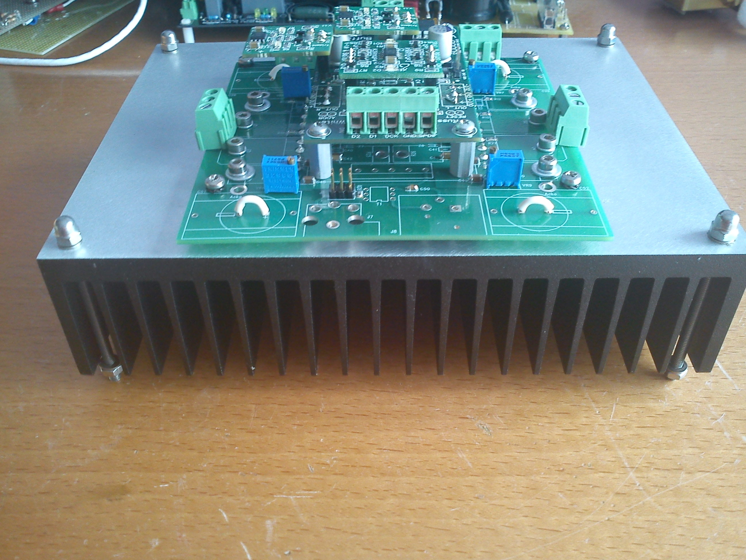

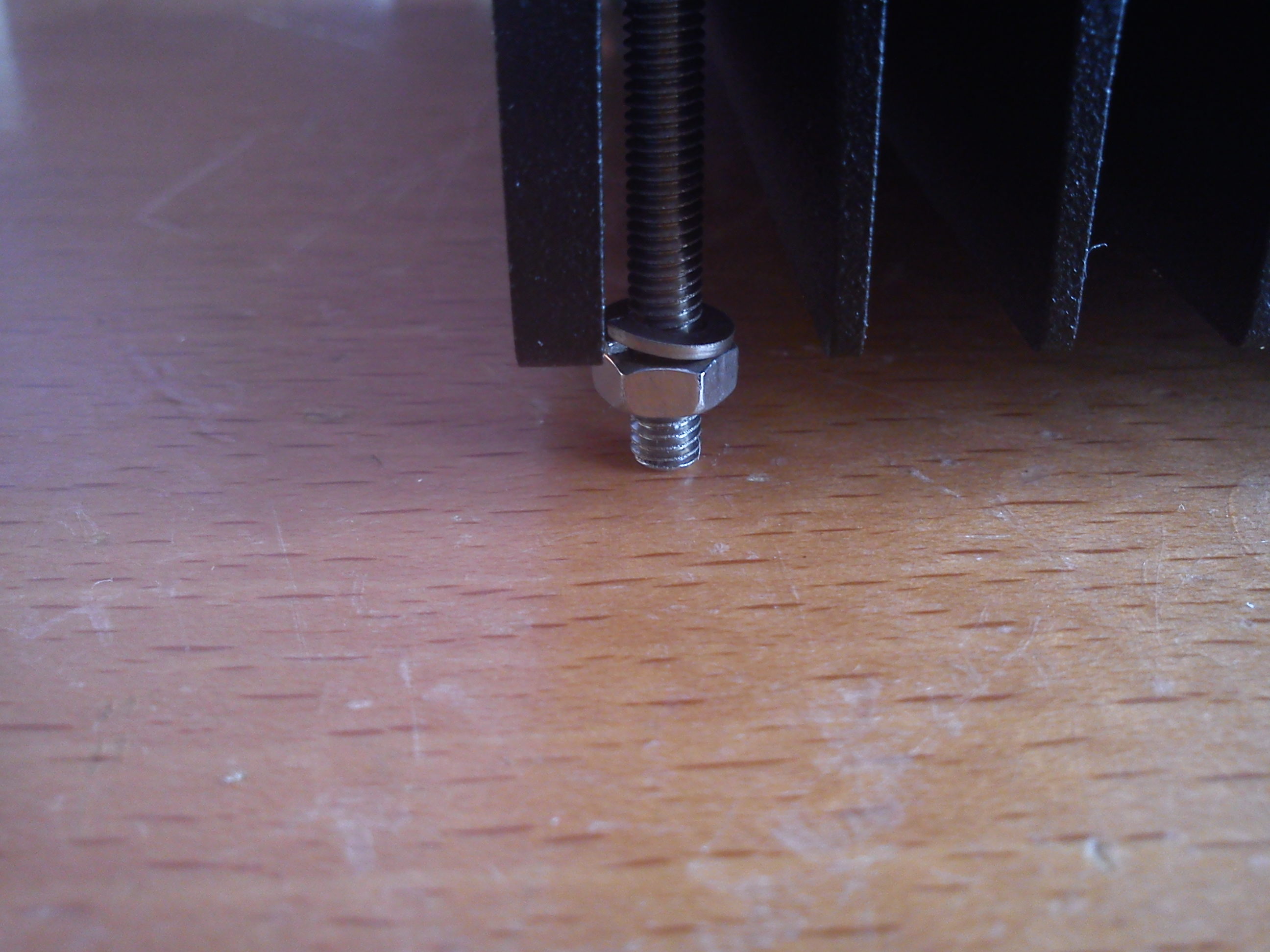

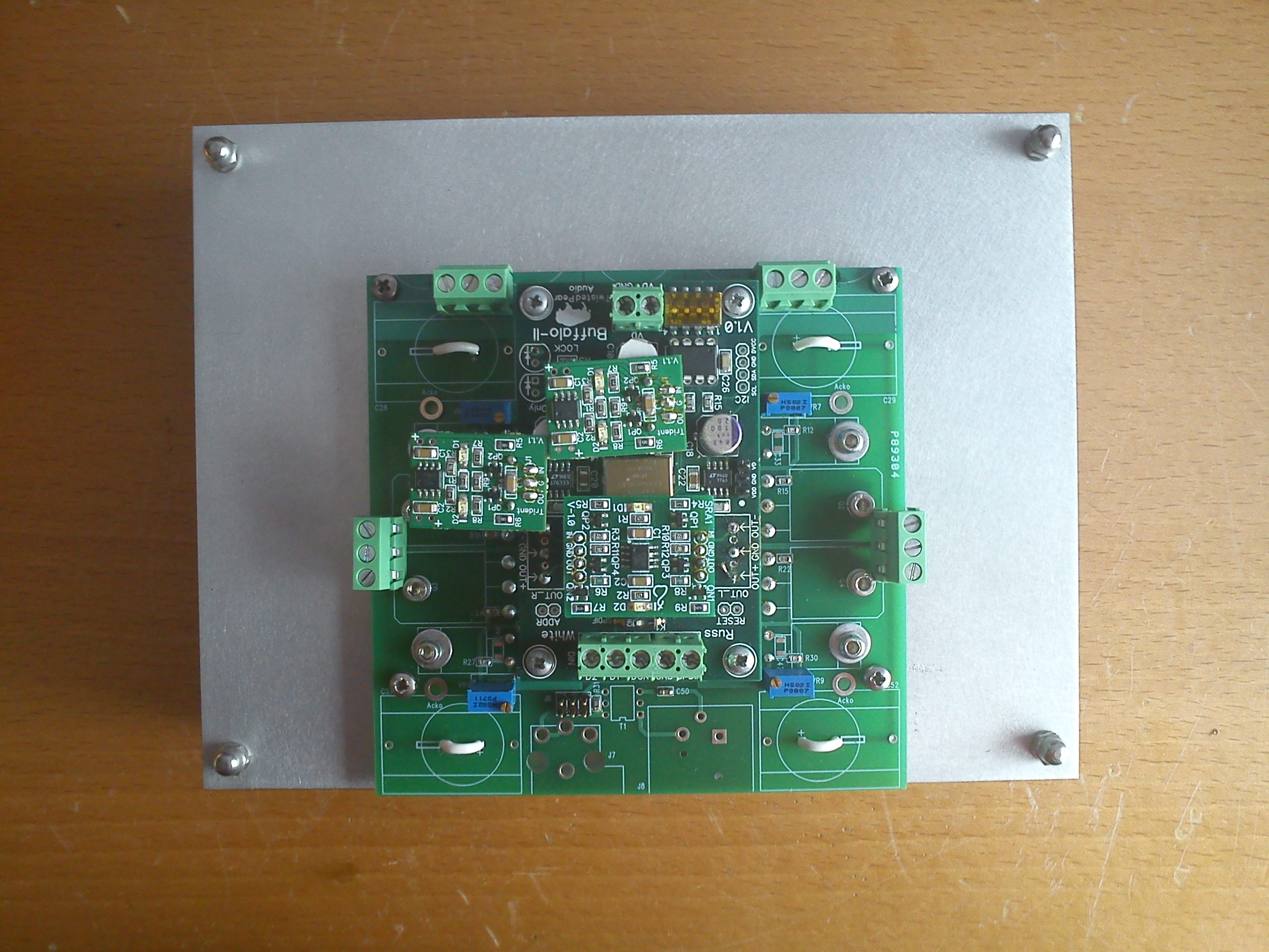

Work in progress pics & for Horio IV mounted on the heatsink🙂:

Great pics Felipe! Thanks for posting those up!
Looks like you're 90% of the way there. You just need to hook everything up and give it a go. Have you adjusted the power supplies yet? Now is the time to do it with them disconnected.

Merlin, how are you planning to mount that heatsink in your case? Are you going to mount it with the board facing down and heatsink fins oriented upward toward the top of the case?

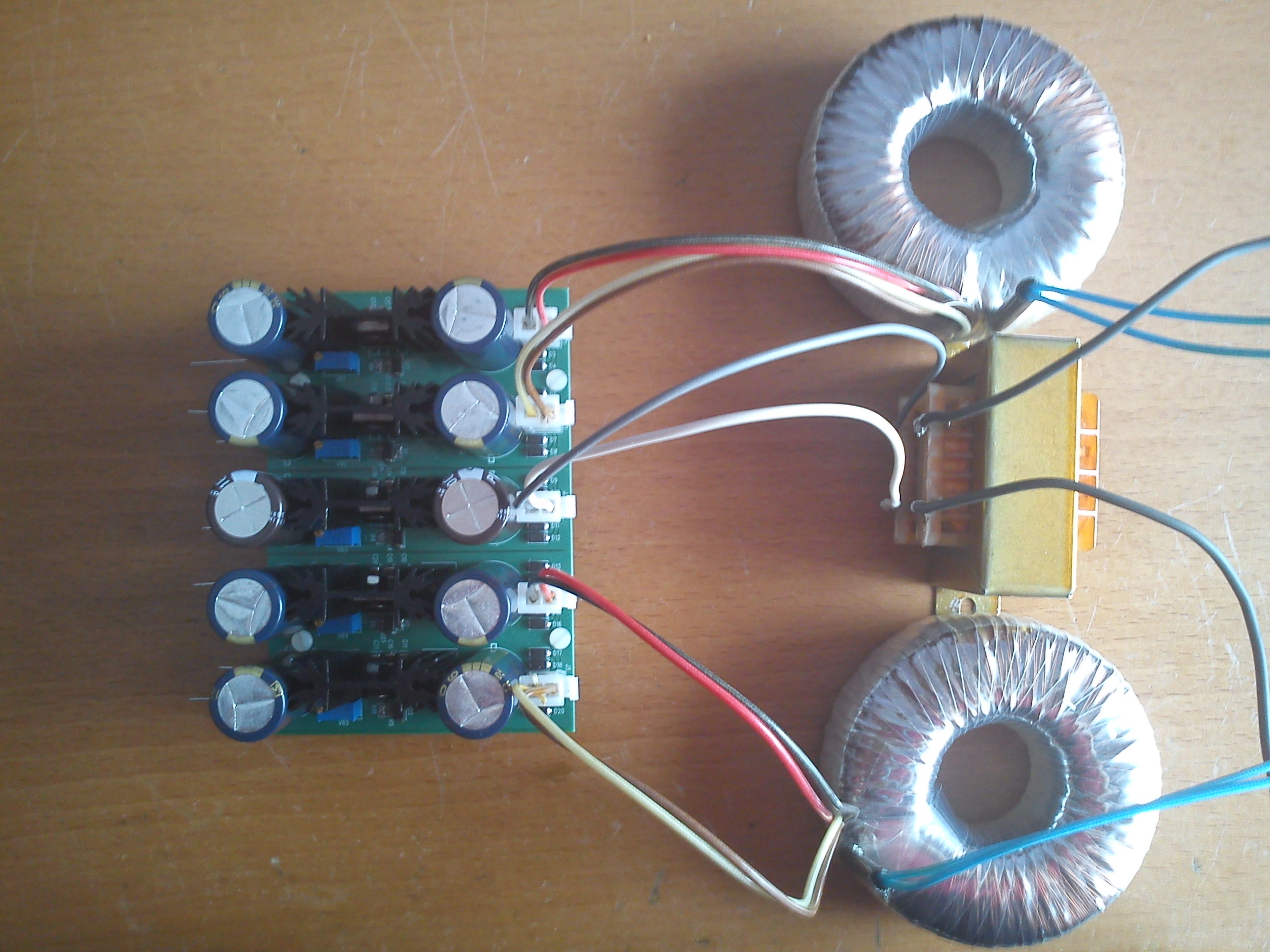

I'm using AVCC & Tridents so can't mount the board facing down because I'm afraid this way disconnect the AVCC module & Tridents.
Bad news: I have a hifi2000 model PESANTE 2U width 435 depth 300 height 80mm & the BII + heatsink need more height possible next model 3U but I will use this for the Erno Borbely IV with PCM1704 DACs
soz for the delay, quite a bit of breaking down for ackodac, got the top off, just neatening the wiring up for pics hehe. been doing quite a bit of testing with various things and doing some head to head action with USB->i2s interfaces, batteries vs rewgs for vosc and AVCC etc etc. so its a little chaotic
there is no need to have the heatsink facing up, its not that marginal wrt dissipation, i sized it to cope with worst case scenario in case someone in the tropics runs it in 40 degree ambient heat. as it is the heatsink gets very marginally warm and it would be impossible for me with the ackodac, as there is 2 stories plus the mounting platform for all the regs, so effectively 3 stories on top of the heatsink+IV. it could be done as there is m4 metric threaded holes in each corner, but theres no need.
