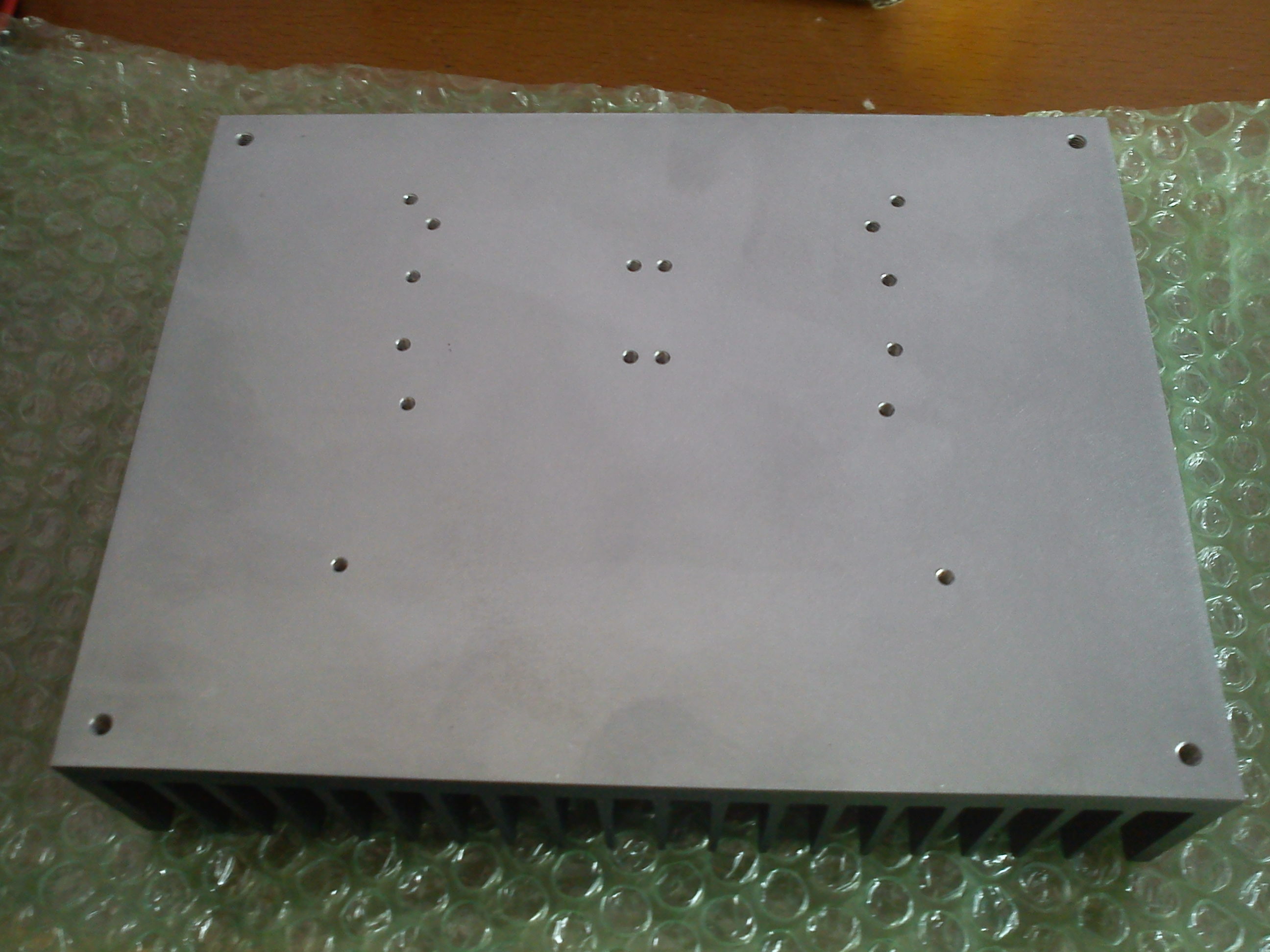

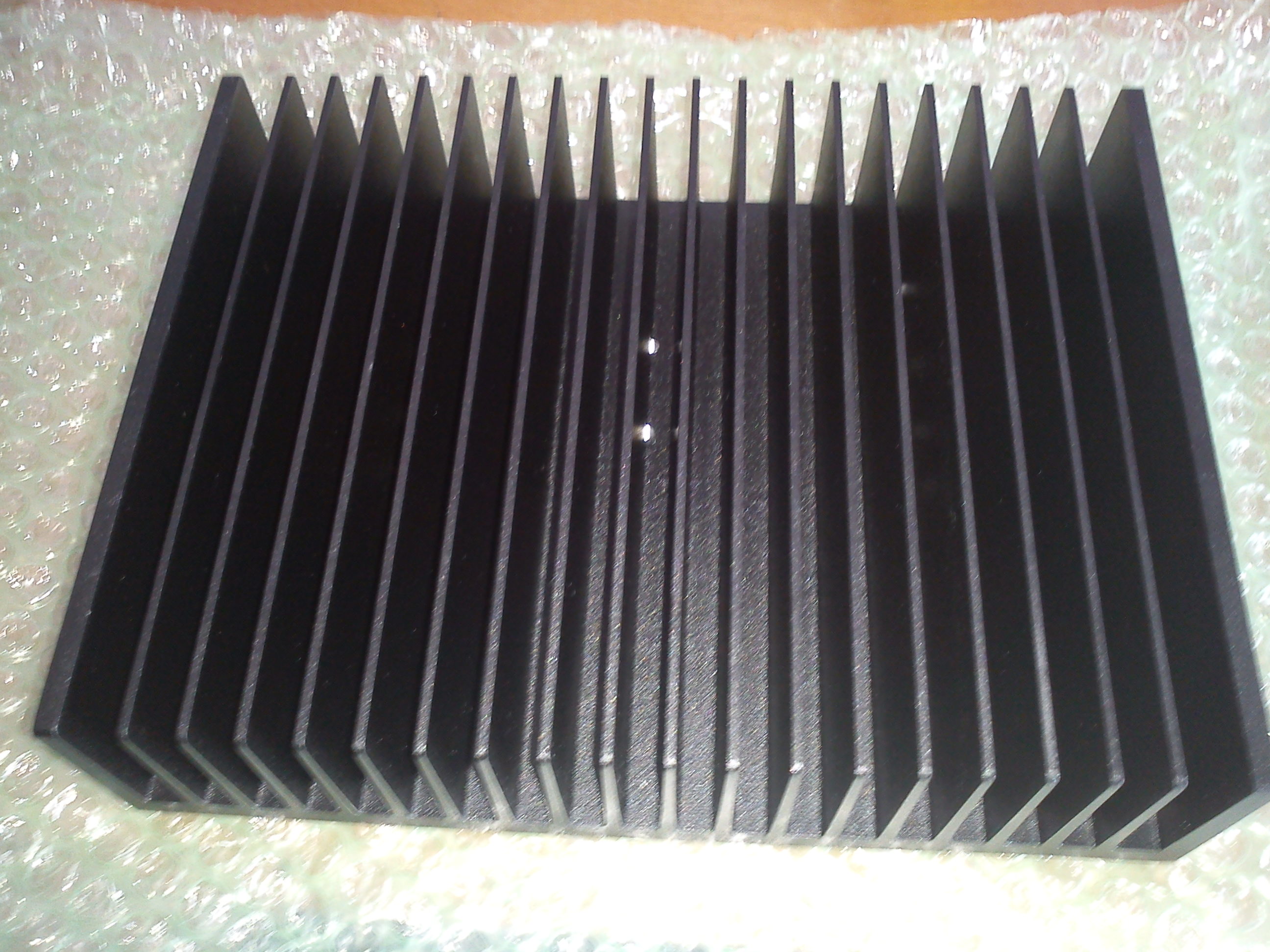

Hey qusp,
Received today the heatsink🙂
Thank you
Felipe

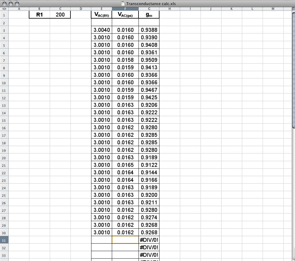

hey hey guys, well i have some good news, i gave you the saga already, found that i needed to research, design and build a circuit that i could attach to the gate and source points and tap the AC voltage there while injecting a 3vrms 1khz sine wave. i needed to be able to do this with accuracy and without effecting the matching cct by loading it down and then multiply this to gain greater accuracy and at the same time subtract one from the other, emulating what a meter does when you measure across 2 points. i couldnt do this with the hp, because the circuit points are well above ground. so the solution was to build something that did not effect the testing cct, while allowing me to connect the hp and take the dc voltage out of the equation, while increasing accuracy.
anyway i've finished building and just tested the differential instrumentation amp with 100x gain and i'm very happy with the results, i will attach to the matching circuit tonight or tomorrow and i'm off to the races. at the moment my testing shows that i can use this in combination with the hp to measure the voltage in millivolts from gate to source with around 0.001% accuracy and thats in absolute terms, relative matching should be the same or better. so provided i havent missed something obvious and it works just as well in situ, i'll get right on with it, finally with everything i need. i made it pretty overkill, after the trouble ive had getting the tools to work as designed, when i had something i controlled the design for i had to make sure.
here is the thread i started to make sure i was on the right track before building it.
your telling me, built and tested the above diff amp without the matching cct and was perfect, attached to the cct and even with the caps inline there was still enough leakage of dc to clip the 2nd stage with dc once the gain was added :headbash: tried another isolation transformer and it loaded the cct, no good and finally tried another set of film caps in between the input buffer and the summing amp and success!! no DC finally i could get on with it. that was last night, woke up today, sorted out some work first and i've knocked off a rail of them since about 6pm. best doing them at night due to fairly constant temperature. wont be able to do a rail each evening, that was a good 8 hours. each is bolted into place and after about 60seconds its up to the right voltages, adjust if needed and when settled start a 3 minute countdown timer. at the end of the 3 minutes i take the reading for each one... rinse..... repeat
the above is the gm, all vds is done. the middle row is the measurement that has been causing the grief, now it actually contains another 2 decimal places to the right that are cutoff. they are taken into account for the calculation on the right, but it rounds off for display
