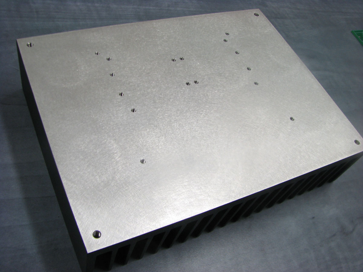

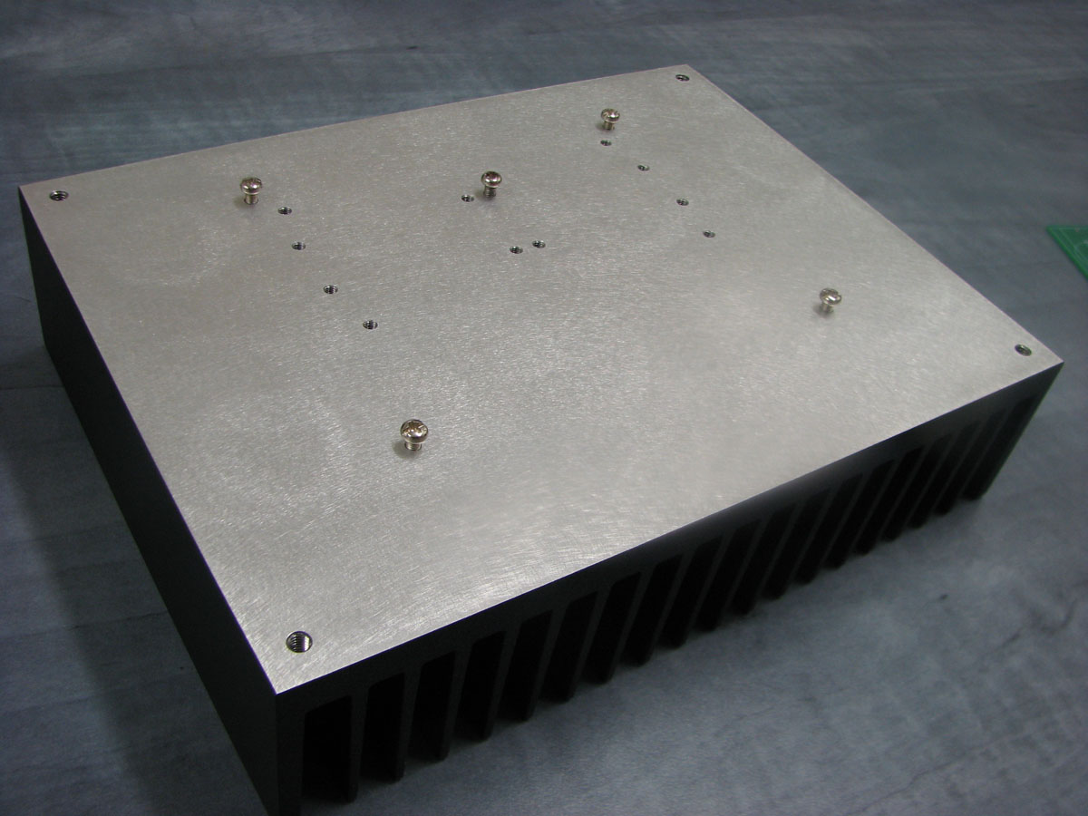

found out what the delay was with the heatsinks, they had to do again as they mistakenly anodized AFTER they tapped them, meaning the taps were too small. so they did them again, spoke to Julian yesterday and they should ship today, hopefully I will have them by the end of the week.

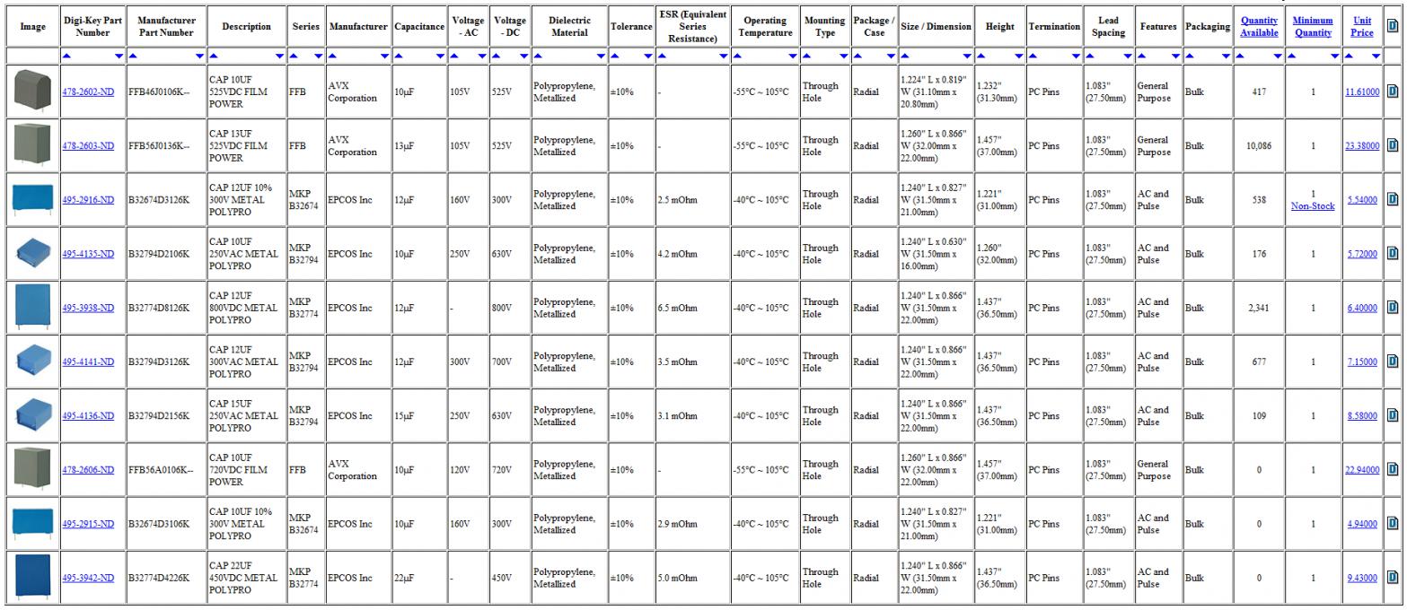

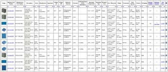

I've attached a list of caps that could be substituted for the Epcos parts a specified. Try to stick with the polypropylene caps, and the value really depends on the impedance of the next stage. Generally, I'd try to stick with 10uF or more.
Owen

BTW guys the heatsinks are here, arrived late yesterday, so I can get on with it. i'm actually rather excited, because I have the rest of my dream dac pretty much assembled
Good news, if you can could you post a photo?
yeah tomorrow, not mounted though as my IV isnt done, but you'll get the idea. I will of course have crazy amounts of incentive to be a matching machine now, to get it all over with and pick the perfect match for me and get my dac finished; as its the only thing stopping it from being fully operational.
I have a meeting with my landlord on monday about some things that need doing around the place and of course for him to eyeball us. I wont have much time tomorrow to work on it, as I need to take measures to stop my end of the house looking like a mad scientist/terrorist workshop; but this week is full steam ahead.
Of course I now have a massive glut of work just come in, but I want to get this done asap. still will have to do work too, but I'll be able to get a better idea of how long its going to take, with being able to do at least 2 devices at once now should be able to get at least 20-25 devices done a day I would think, once I get into a rhythm probably more.
its pretty chunky guys haha, especially after upping the size to the MF20-151

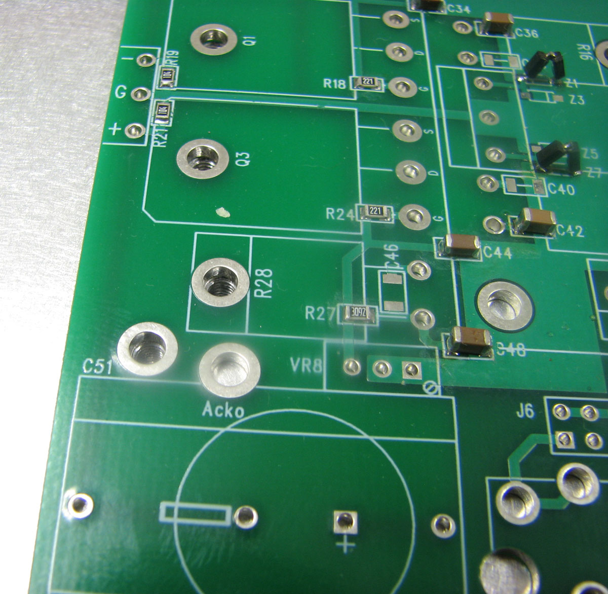

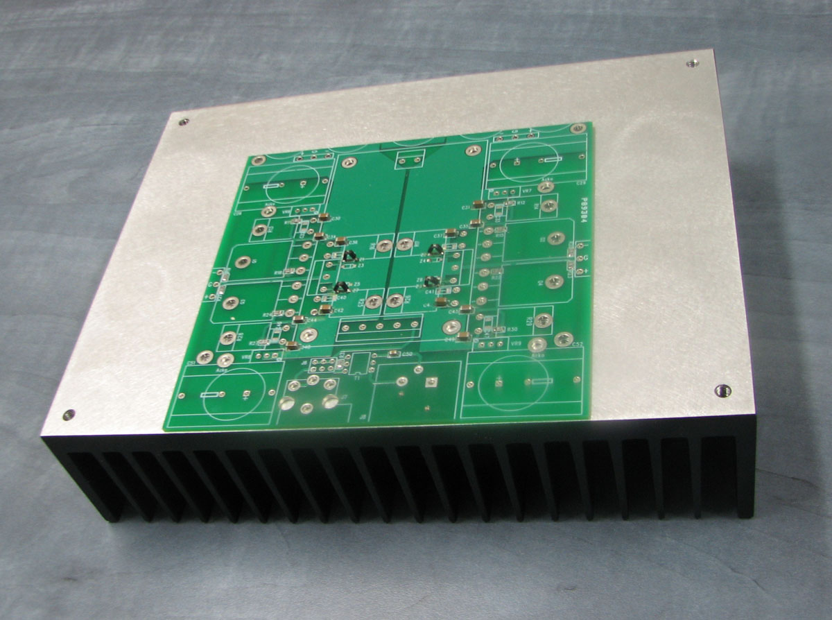

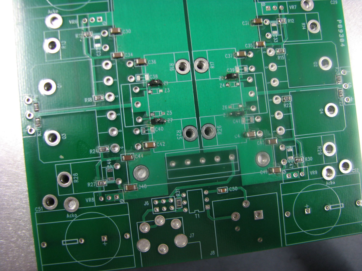

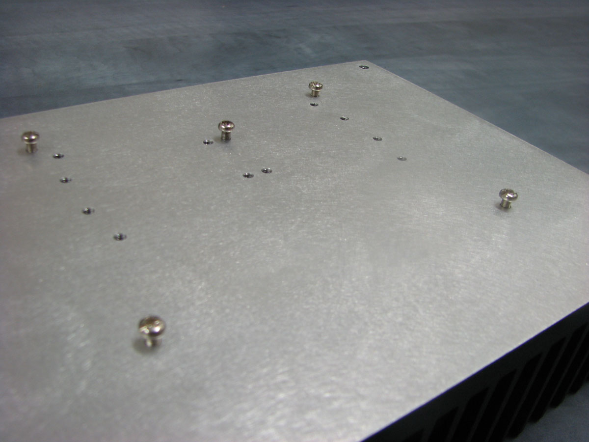

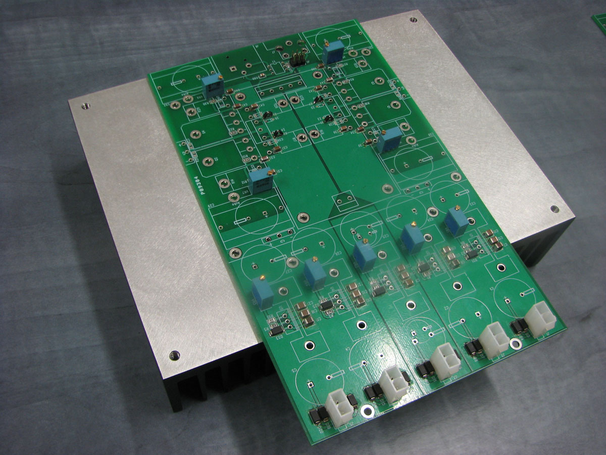

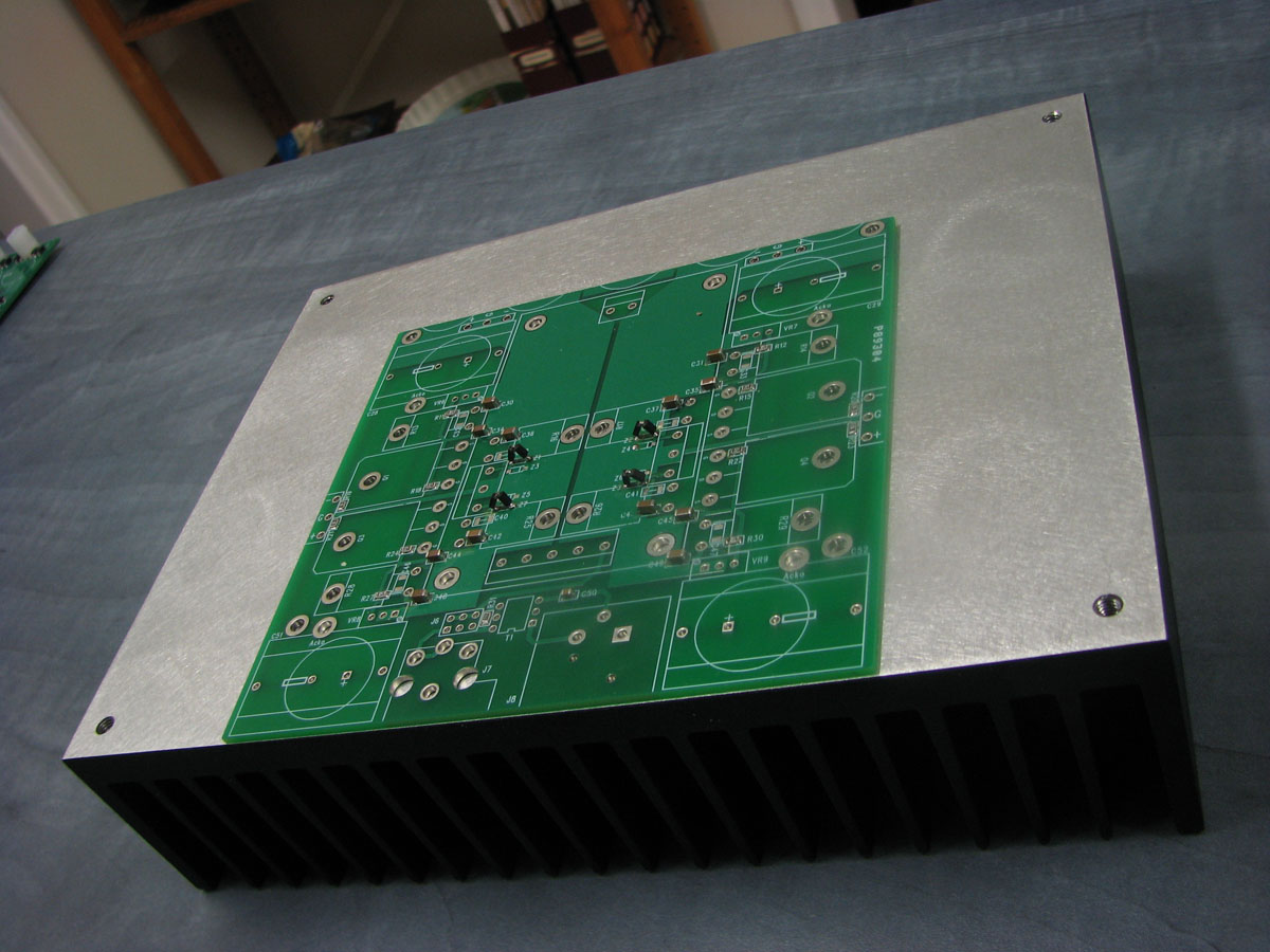

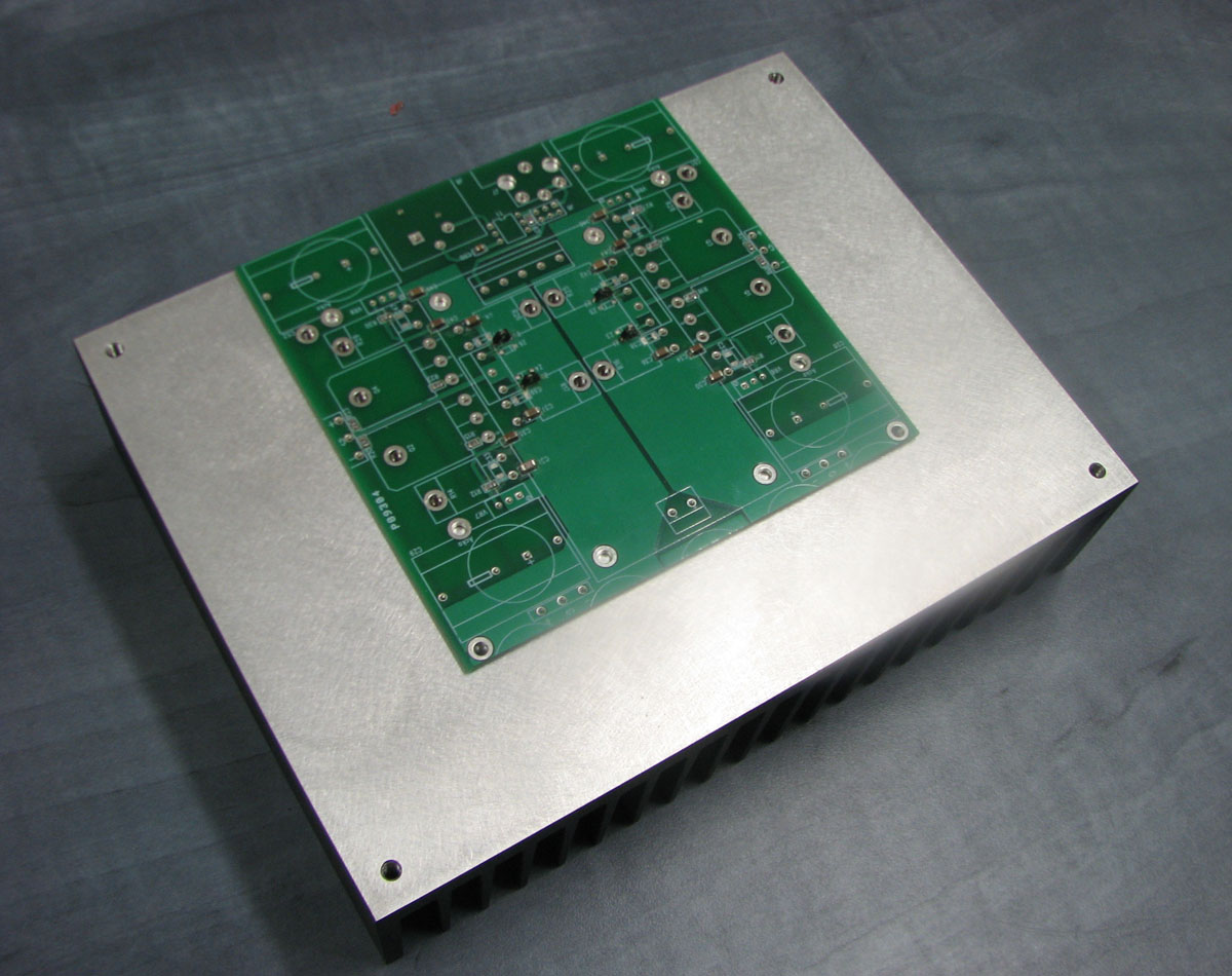

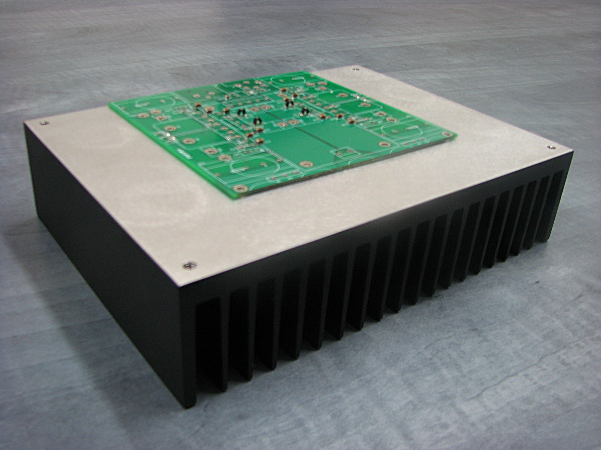

hey OK here we go, sorry for the day late, had a lot on my plate yesterday.
as you can see its pretty chunky, but also pretty neat. the holes are perfectly tapped, so glad we got this done!! initially the size we were getting was perfectly snug against the sides of the PCB but after further math was decided it would be too small to risk. so changed from MF12-151 to MF20-151. makes it quite a bit wider, but makes for better mounting as you can see I had room to put some chunky M4 taps at the corners; which will be used for nice copper brackets and mounting my umbilicals for the ackodac. also i'm going to use these to mount various other parts of the build probably including the caps (not directly on there of course) connections to the power supply will be made from underneath for hose of you using the stock PCB power supply, if I were you I would also try the transformers under there and see if there is any noise.
at first I wondered why they hadnt rotated it to make it fit neatly, but then I realized they had probably only seen my PCB. doesnt matter after further thought I realized it will make for better airflow over the surface of the sink
