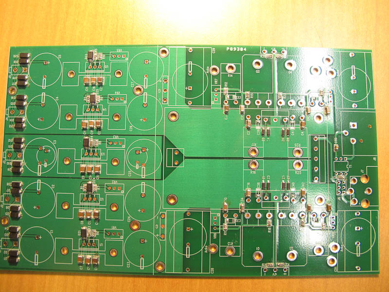

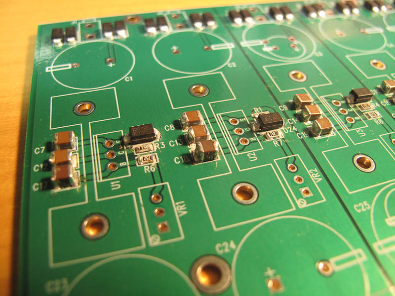

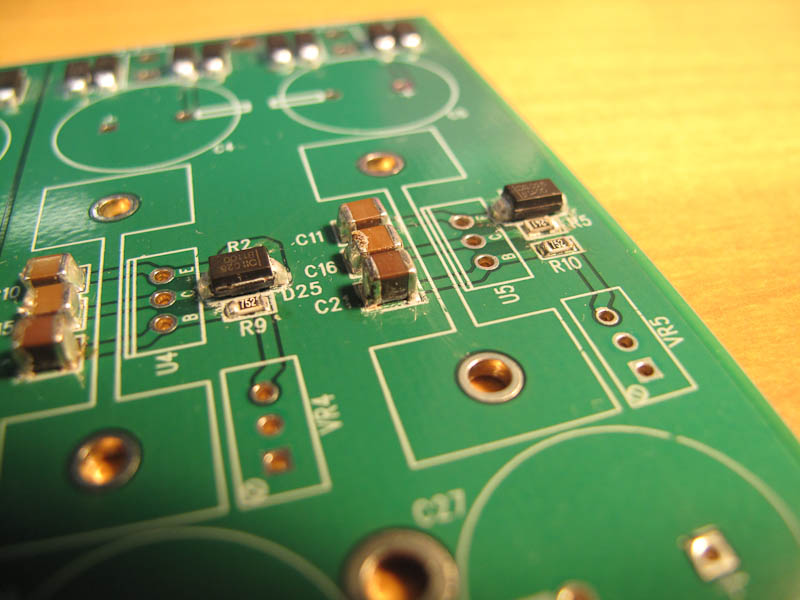

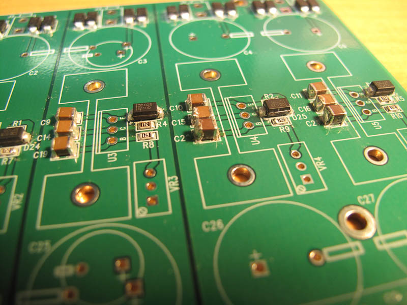

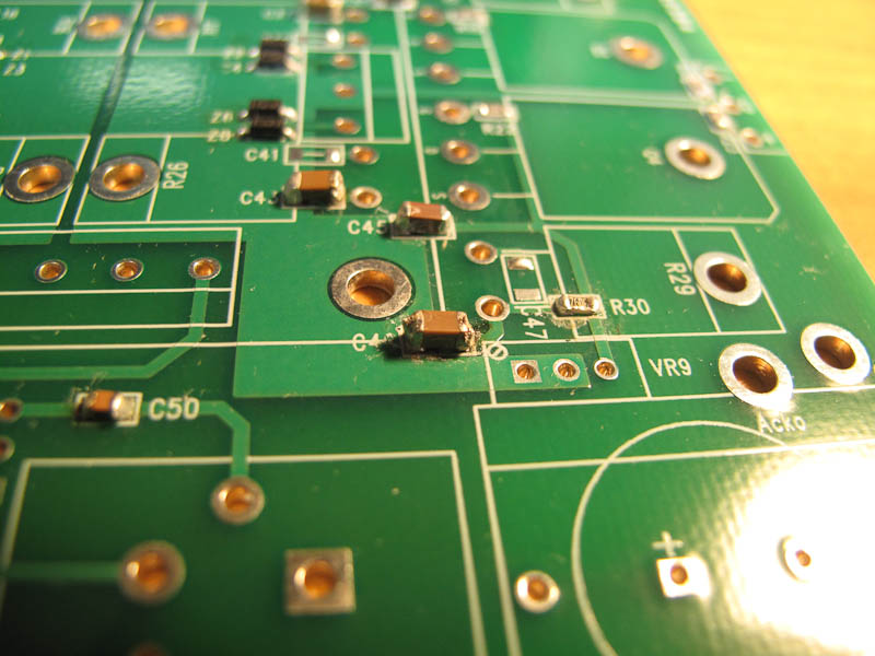

So, it looks like my SMD component are done. Just some tips from my side for people who do SMD for the first time:
1) Start with the diodes of the rectifiers, they are the easiest component.
2) Resistors follow: they are very small, but the pads are big enough to allow good contact between the iron and the component.
3) Zener: I did the track side before the ground plane. This allowed me to place the component in order to leave as much space as possible on the ground plane pad to push the iron on it and have good contace.
4) Capacitors are the most difficult, as there is not much space to put the iron and to heat the track. I did, but here I'm not sure of the results. I did this as first components, and I think it was a mistake.
I used 400 C as temperature and for few pads on the ground plane I had to rise it a bit.
