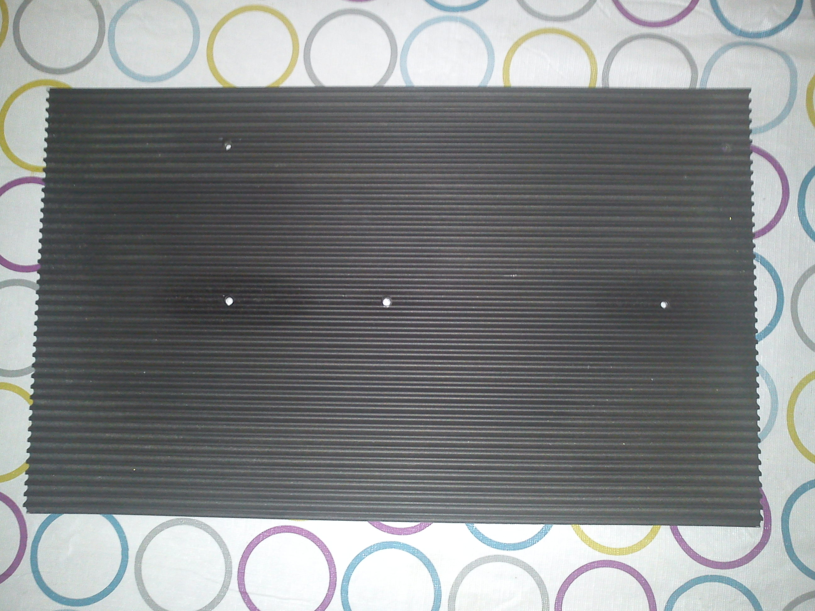

Do you have the heatsink?
errmm no as I said pretty much the post above you
no, I have my heatsinks for the matching rig, but not the D1. so i'll get going on that this week sometime. hes not doing the D1 sinks till the end of this week, so i'll have them sometime next week. if I had the sinks you would know about it. also there is only one shipment being made right? unless you want to pay for separate shipping for the heatsink and the mosfets

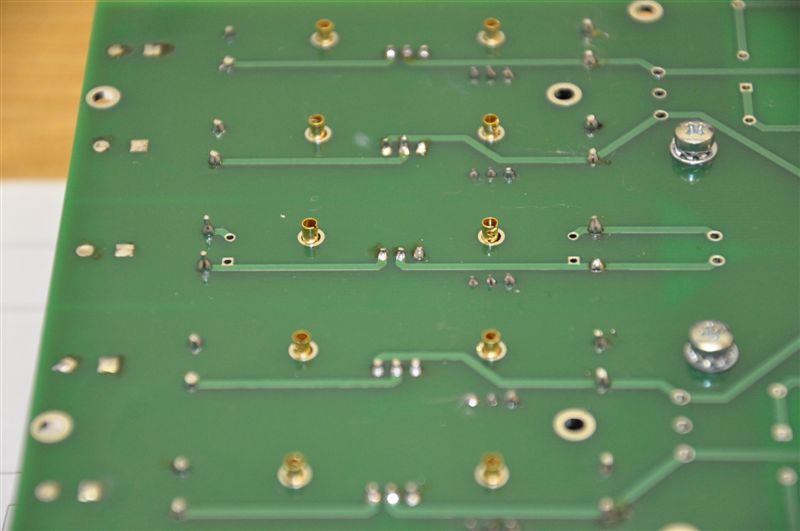

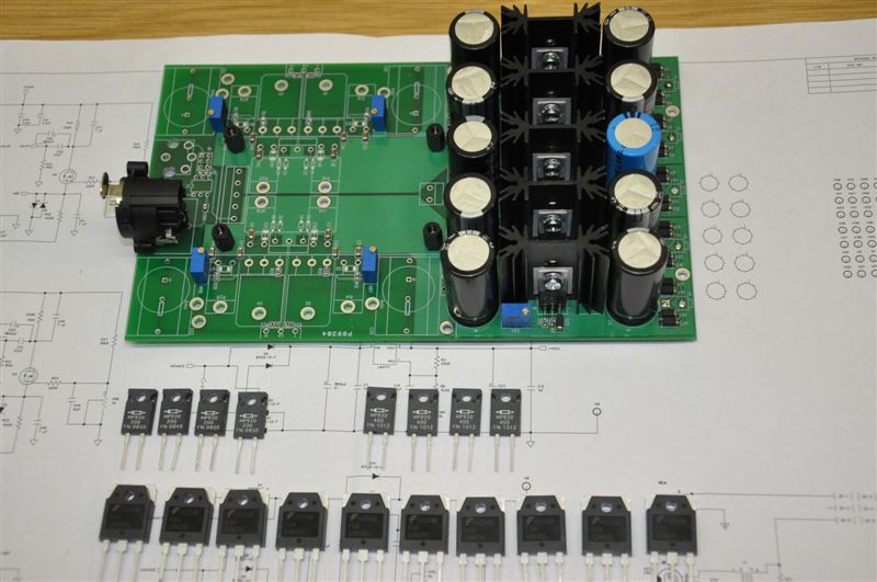

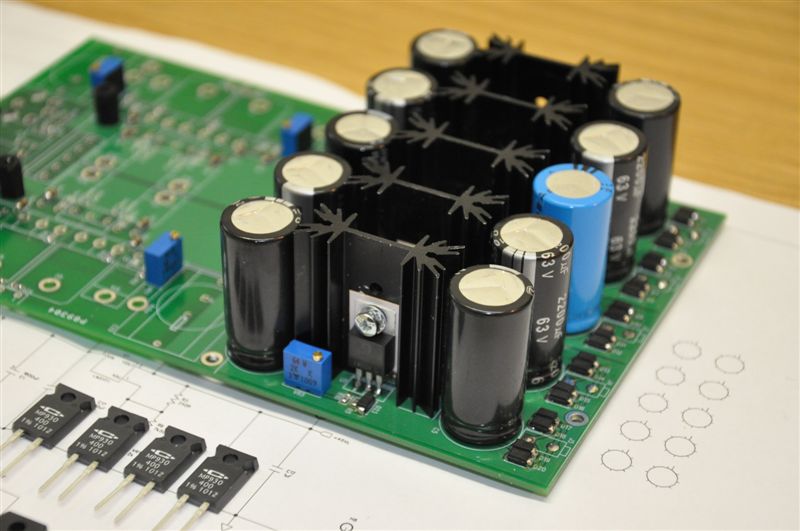

the 5 adjusted power supplys are working very good.
See my first pictures.
I think it is better not to solder the 10 solder pins of the regulator heatsinks.
See the picture of it.
It will be much easier to get it out, if you have a problem with the LM337/317 or wanna update the regulators later.
Please isolate the heatsinks of the regulators with kapton or something else, because all the three pins of the regulators you can measure a voltage and this voltage you have on the heatsink directly above the PCB.

My next step will be matching the fets to get two good pairs from the 10 pieces I have here.
best regards
Salomon
