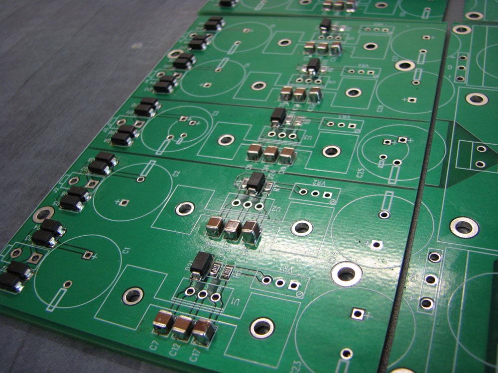

hmm, I dont know about the large heatsink catalogue at DK or mouser. the only way this board can be mounted really is with the sink under the board and it must really be at least 0.60C for 80 degree rise and preferably better. very quiet here, nobody else has done any building? I have done all the SMD soldering for 5 boards and nobody else??

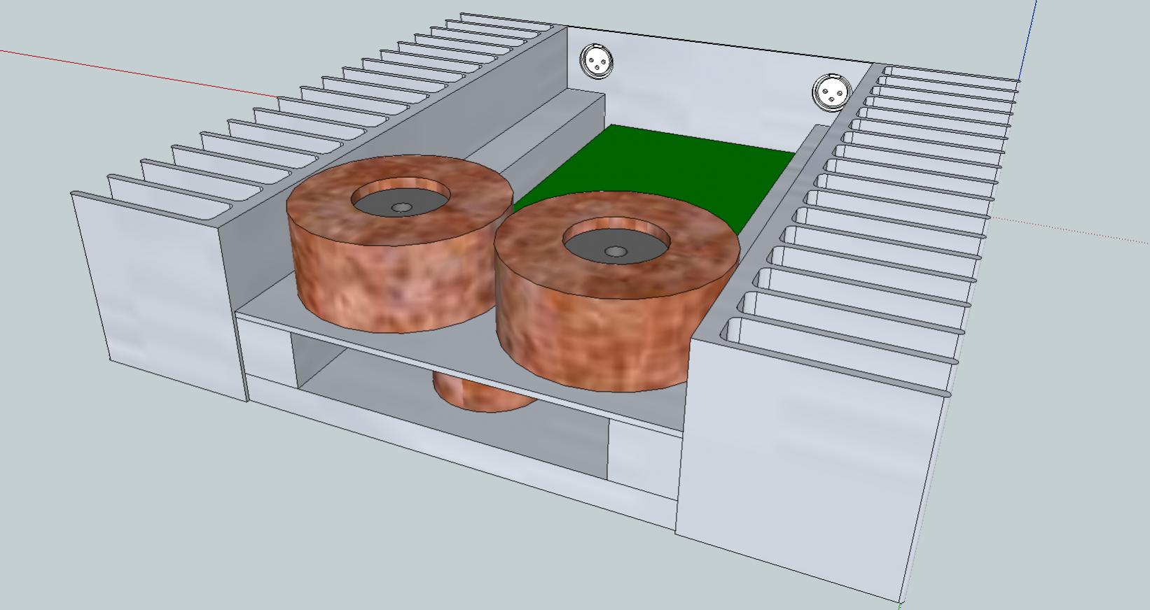

I'm surprised how quiet it has been as well. I am going to do the SMD soldering this weekend. I'm planning to use the base of my case to spread the head over to two conrad sinks mounted vertically (much like OPC had shown in a sketch a while back). I'm hoping a 5mm-6mm thick aluminum base for my case will do the trick.
sure that should work, but you really will need to make sure there is good transfer to the sinks from the bottom plate. A plate that thick may of course be good enough all by itself depending on the size, perhaps do some calcs to see, as tghis will save a decent amount of money and effort if you can get away with it. as I said anything .55-.60C/watt for 80 degree rise and better will do.
The bottom plate may be enough, but I'd rather be on the overkill side. =)
I'm planning to use a chunk of aluminum bar (1" x 1") with a bunch of thermal paste to couple the sinks to the base.

Hi Guys,
I drew up a quick model of what my plans are for the DAC, so everyone can get an idea of where I'm going with mine.
For reference, the bottom plate is 0.5" thick, the whole DAC is about 12.5"wide by 12.25" deep and 3" high
I'm going to use Aavid 65535 extrusions cut to 3" lengths for the sides.
The 1" by 1" bars will transfer heat from the bottom plate to the sinks, and the whole thing should run pretty cool.
The .zip attachment is the Google Sketchup file.
Owen
Owen

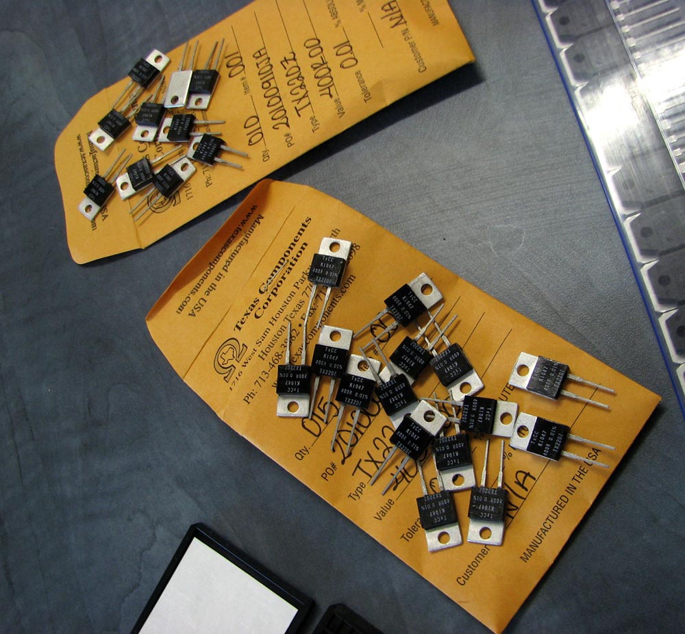

parts hoarding

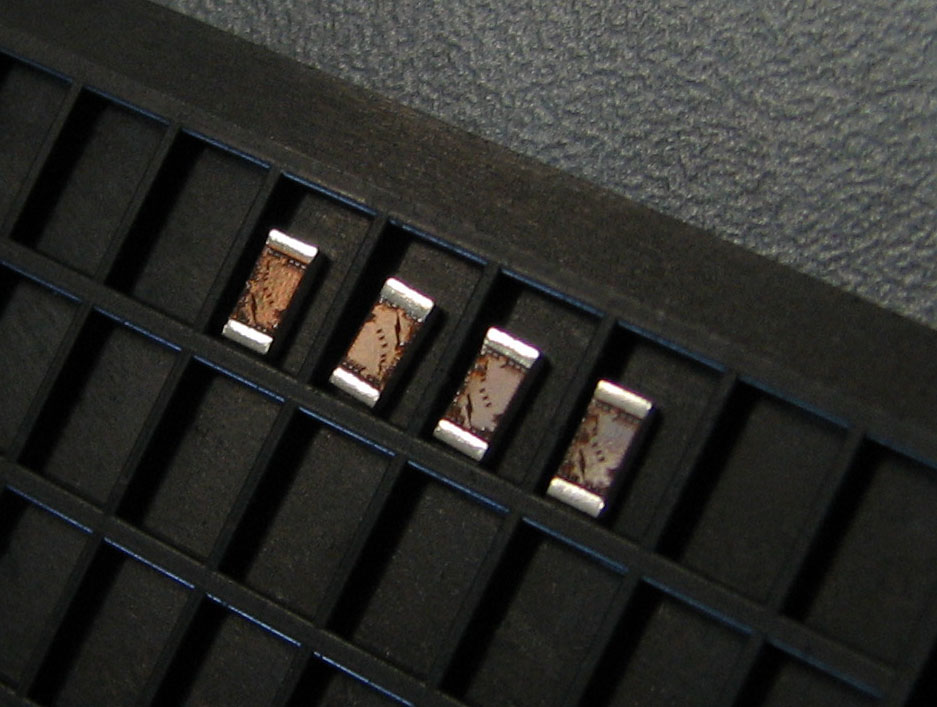

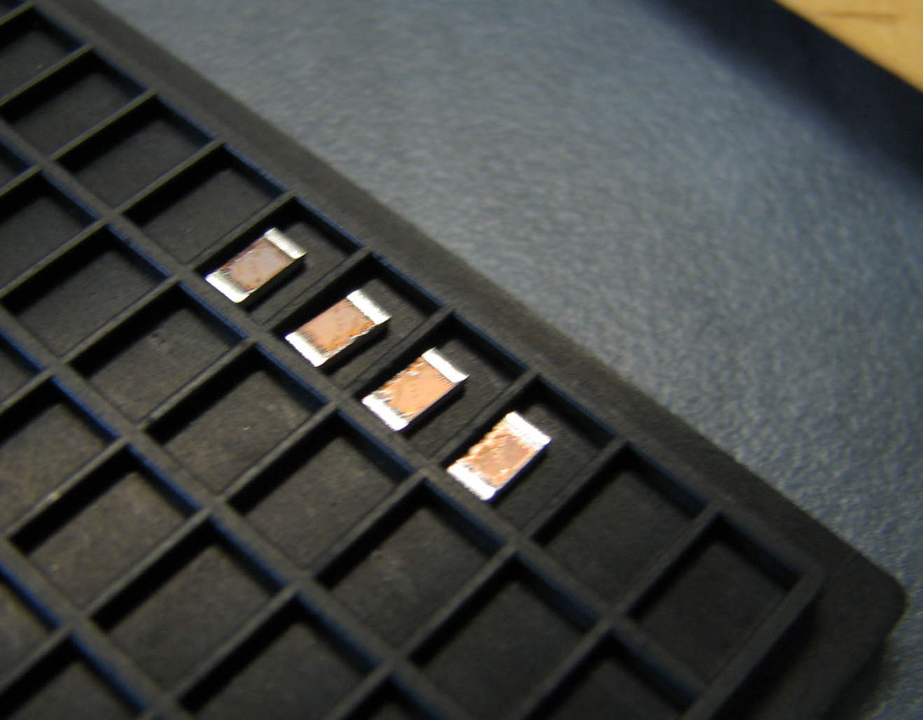

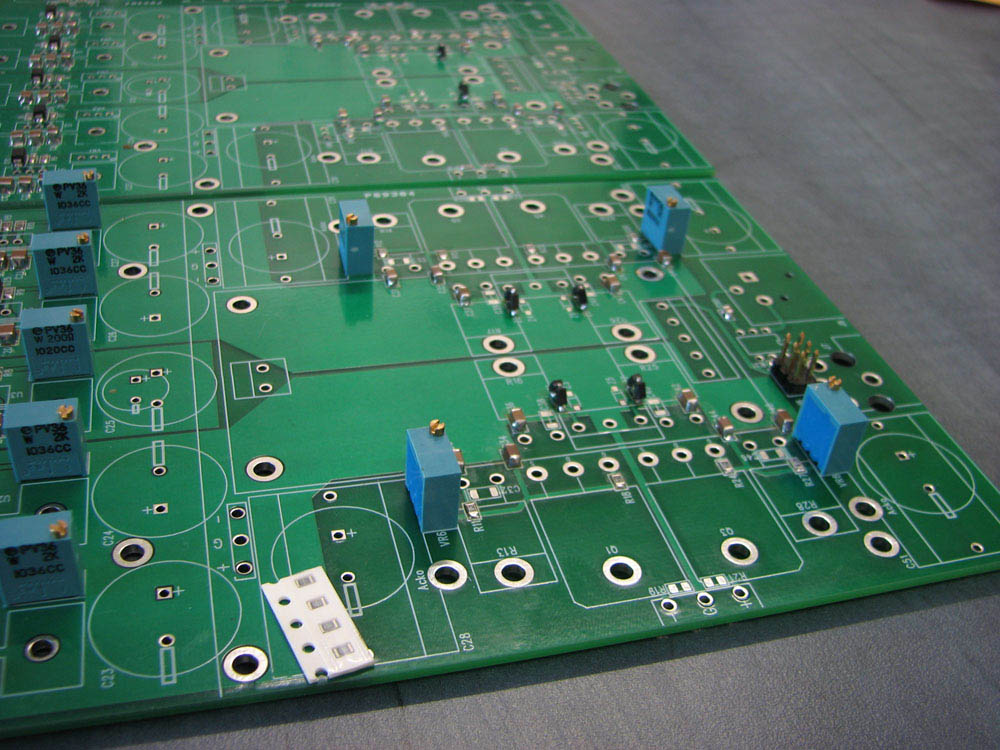

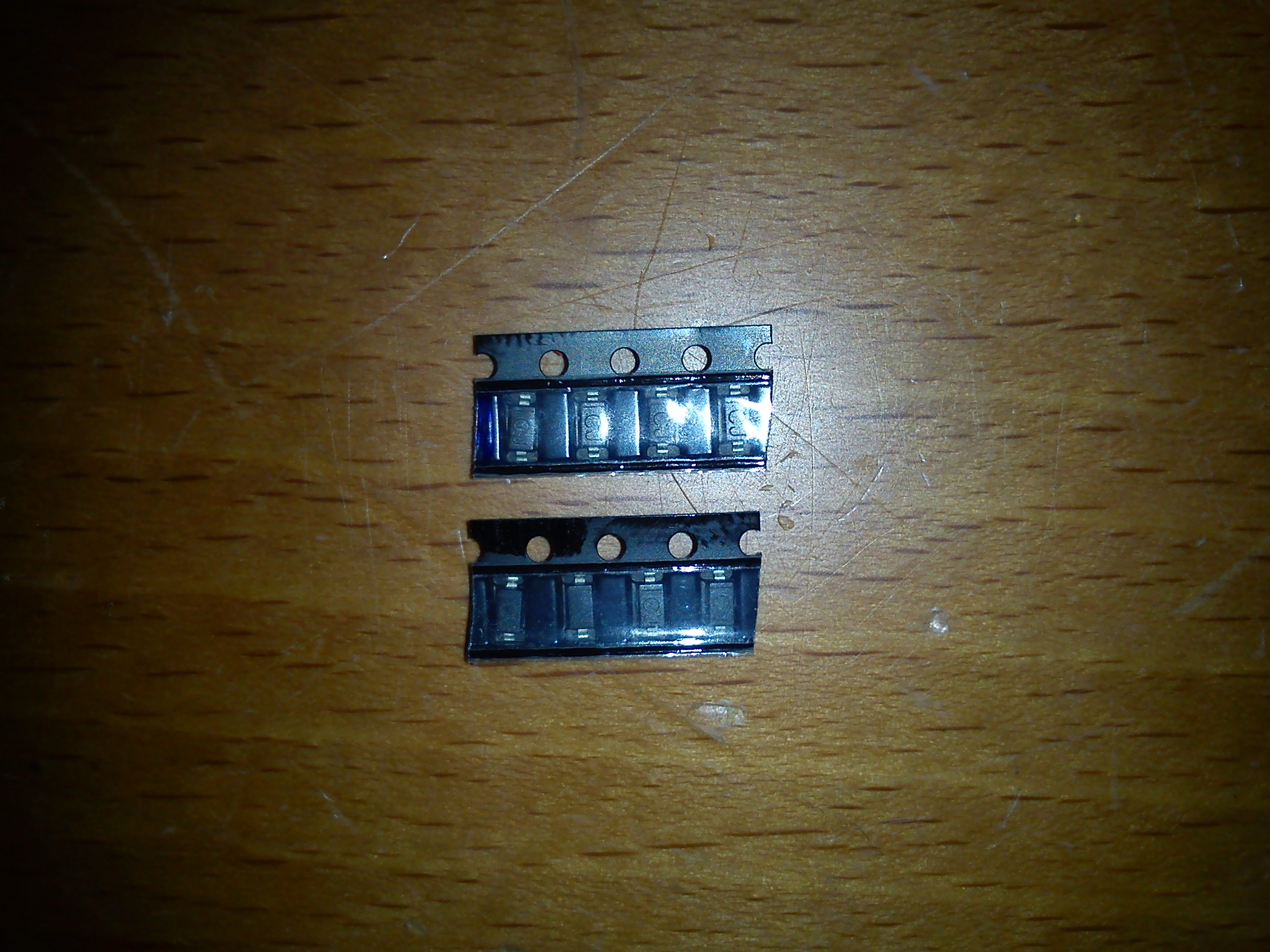

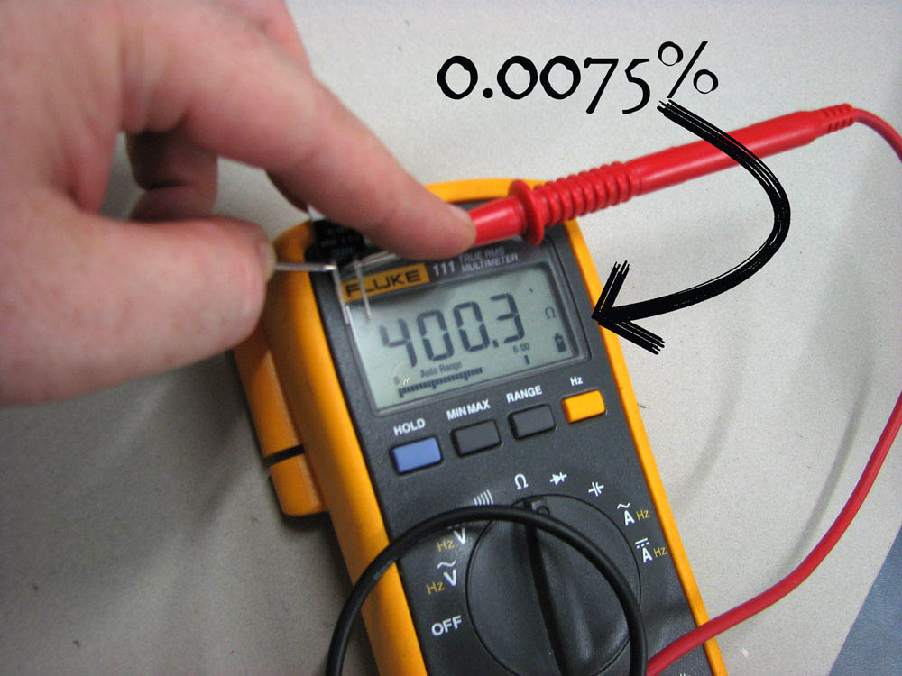

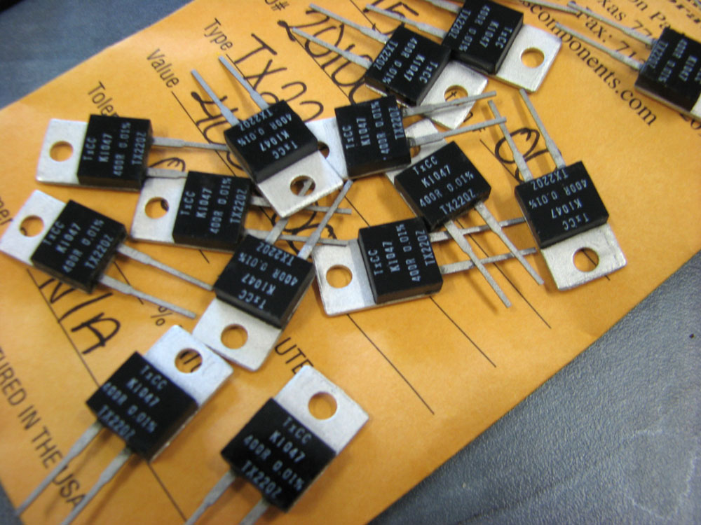

here is SOME of the parts that are here, i'm running out of room. the last ones are just posted as a matter of interest, they are the SMD Zfoils i'm using in another project, cute hey?? 😎

P.S. Hey nice photos, do you have four Vishay 400R for me?
protection diodes for the input (Z1-8). the little tipis he was talking about and you can see in my pics. no extra Zfoils sorry mate
