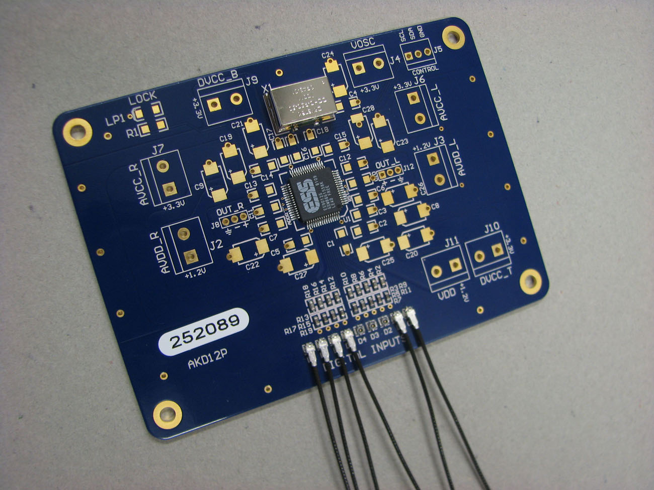

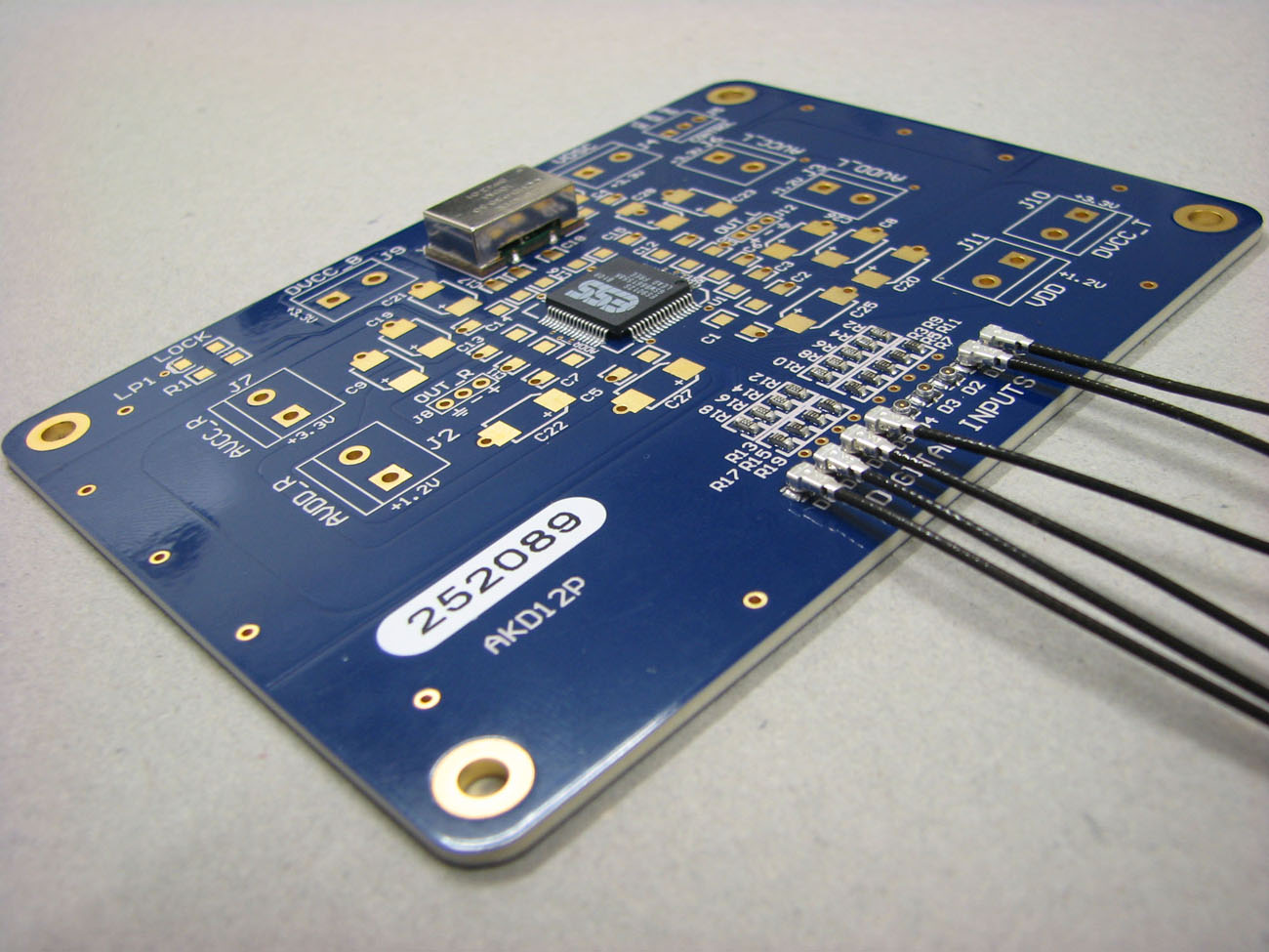

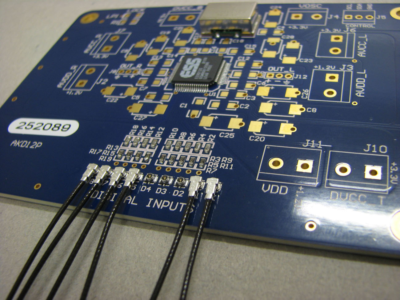

Xmas came early for me
, look what I found under the tree plus another one the same (and 2 for a friend) partially stuffed Ackodac Rogers teflon substrate AKD12P ES9012 dac. I love it when a good plan comes together, this has been in the works for a while now, if it sounds half as good as it looks (and going by my experience with the regular version it will) then i'm gonna be a very happy man, this combined with the D1 IV with Zfoils and CuTF VCAPs, mini gold regs...oh my
