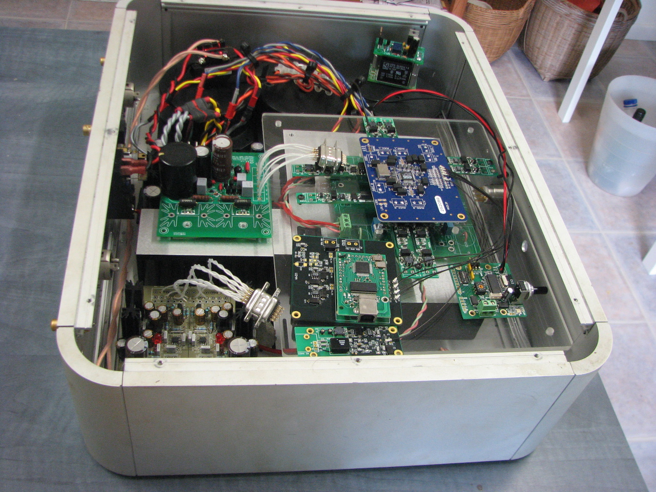

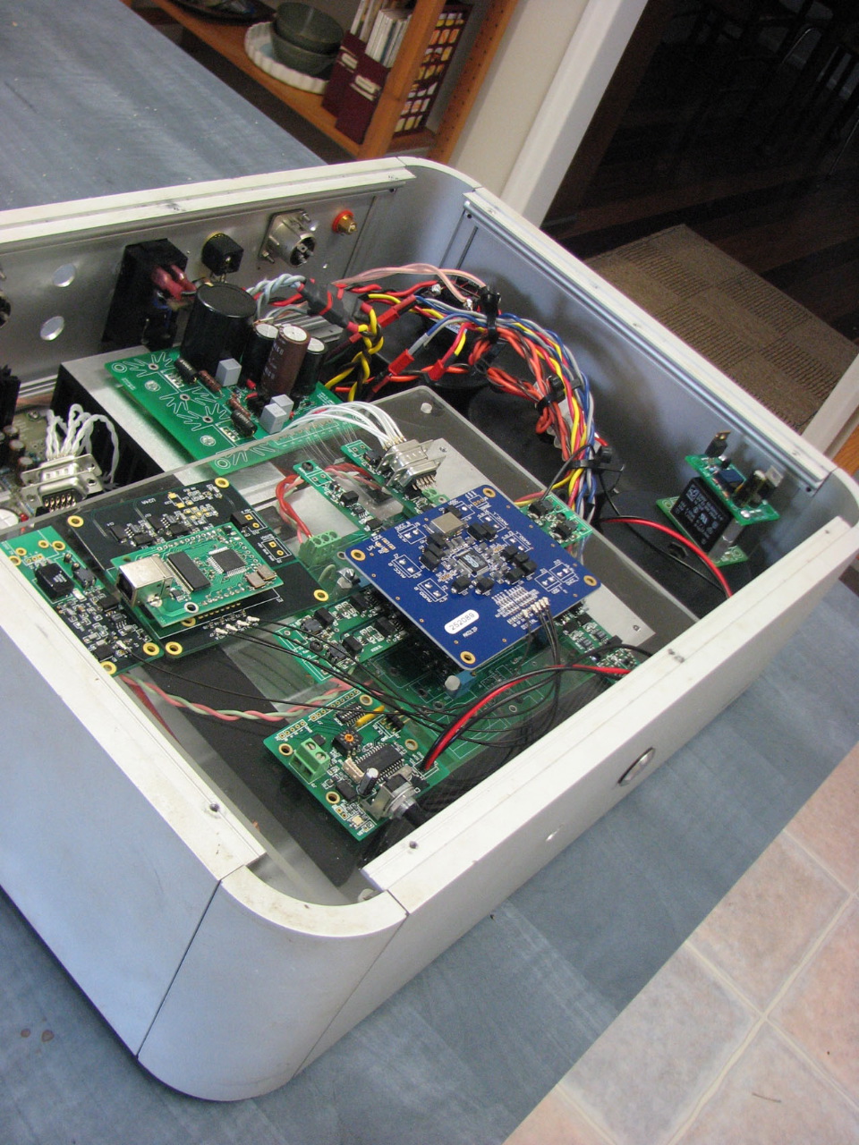

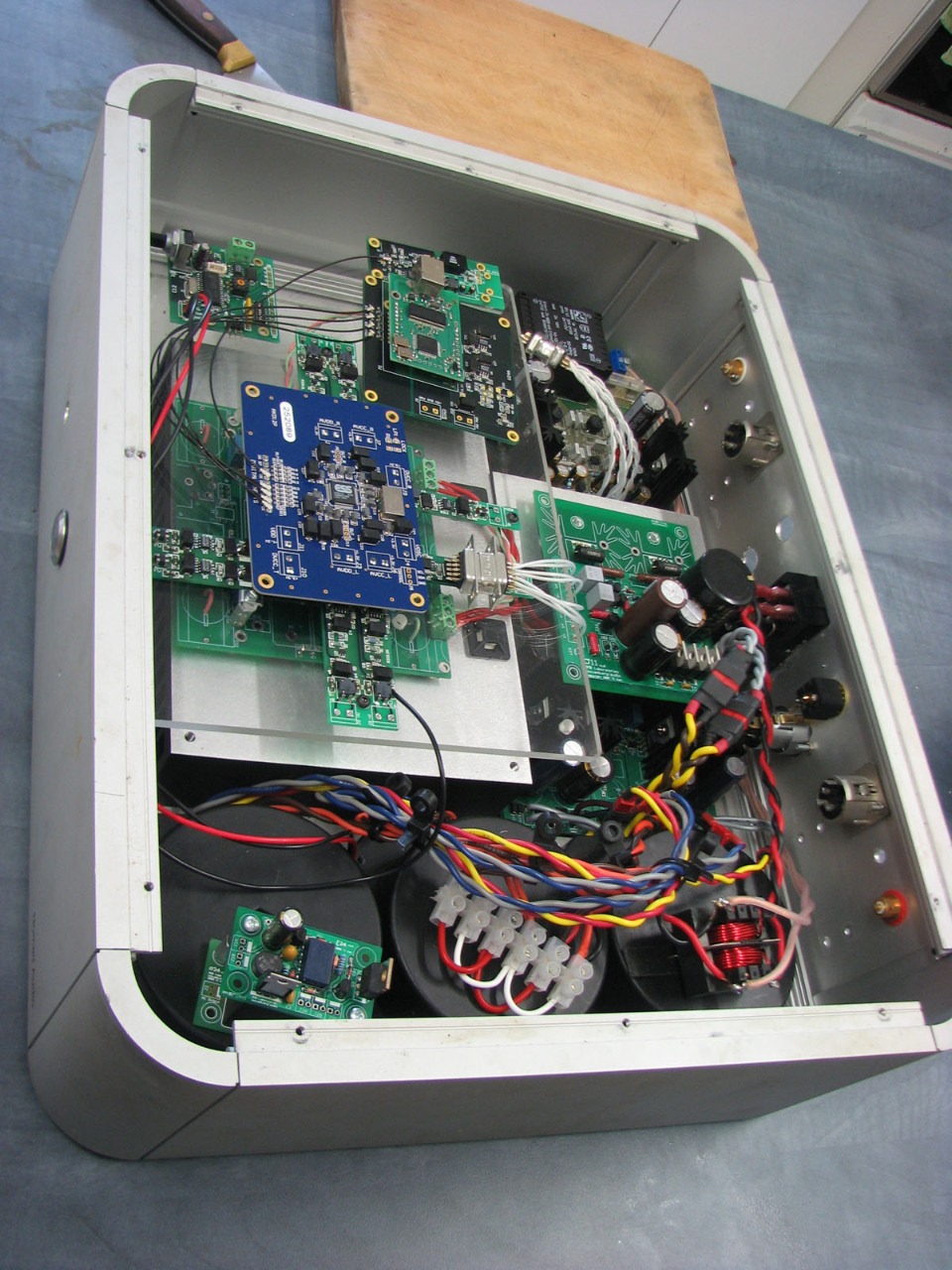

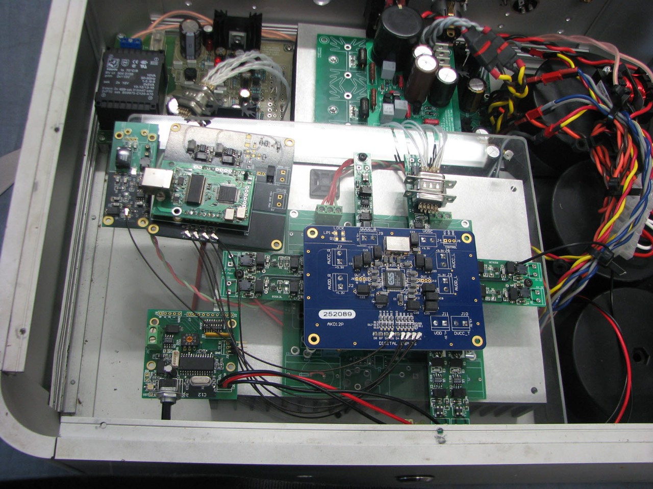

hey hey, well i hear a few people's fets have arrived and more should be arriving every day. so where are the builders?
heres an old pic of my ackodac akd12p when it was mostly done, its been rearranged with a brand new usb board and some more suitable transformers will be here on monday.
but i'll post these pics just to get the ball rolling and to give a few ideas.
will post more during next week. at this point i still hadent figured where i was going to put the caps, was pretty crowded, thus moving to 2 box build and dual diff

I received my FET's just a couple of days ago. I'll probably start soldering everything together soon, but I need to figure out how I'm doing the heatsinking before I can get this thing running..
Where did you get that case qusp?
its a class D amp chassis from hexateq, they dont have them like this one anymore and they dont really list chassis on their site, i scored this used on the forum, but its not big enough without using an external psu, well not for my dac anyway hehe it says something when a power amp chassis isnt big enough for your dac.
one box of transformers arrived today which is cool, only had the aleph jx ones in there though, the other is close behind and has the dac and circlotron iron in there.

Congrats nice job, how do you fix the heatsink to chassis?
thanks, there is m4 tapped holes in the corners, i use metric m4 threaded rod bolted through the floor. in that pic it was just sitting there. i also have some m4 titanium bolts on the way to use. to find such hardware, look at motobike/motocross racing parts supplies stores online.
