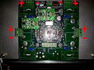

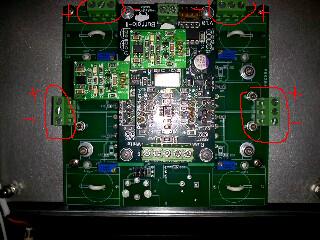

Pic shows psu +- connections & +- output connections are ok?

Just see this pic
So only confused the signal outputs:)
That's all necessary to connect the I/V?
Before to connect the DAC only it's necessary set both trimpots to minimum (0 ohms). Increase the value of the trimpots to set the voltage at the source of each of the tow fets to 1.65VDC referenced to ground. Once this is done, verifiy that the voltage at the drain is about 9 referenced to ground. If all is good, power down, connect to the DAC output and start back up. You may need to re-adjust to get exactly 1.65V at each source, but it shouldn't have changed much.

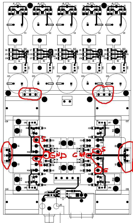

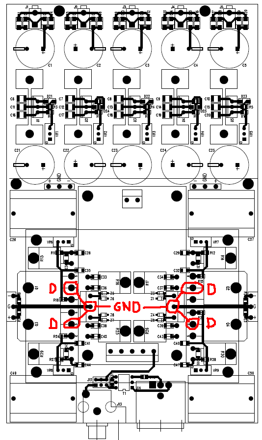

merlin, yeah that set up is pretty much all there is to do, i'm not sure i cant see your pic, but in the orientation you have it, from left to right with the power input at the top goes + |-+|- ________ - |+- | +
dont you still have the psu part lying aroubd? just match it up, but yeah what ive written above is how i have it

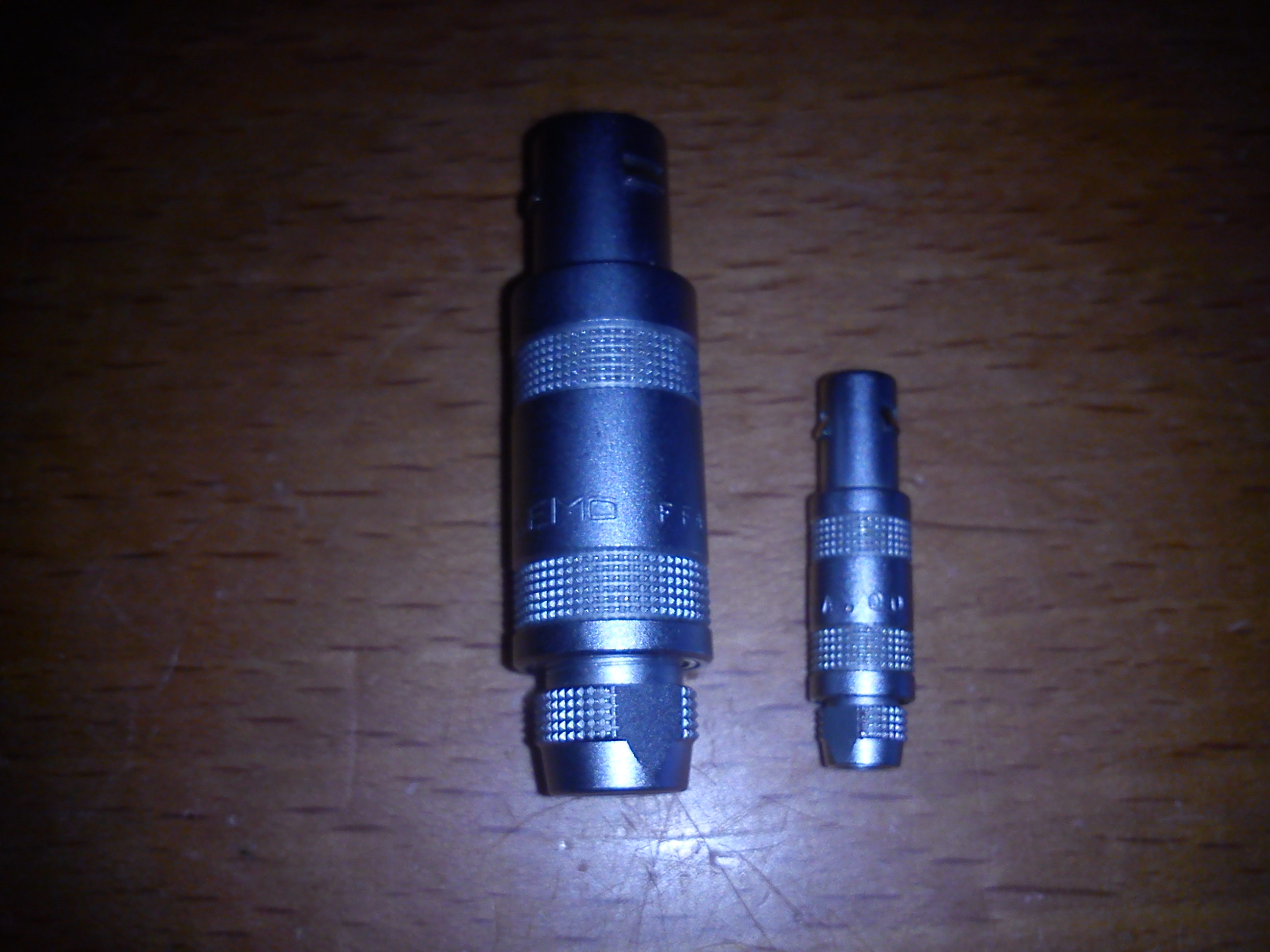

you are using lemo single pin coax type for balanced? they make a 2 pin as well, those wont be the best for cmmr, but they sure look cool. what are they connecting to? levinson or something? i'm using lemo in the smaller 2 pin package. how is the voltages looking now; still having problems?

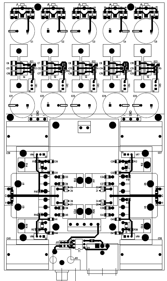

Is there a schematic for the board version merlin el mago is showing? I have seen several so far. I am trying to get caught up on this thread and i think i have missed a large section of it along the way someplace. How did we get from Nelsons original article to this board??

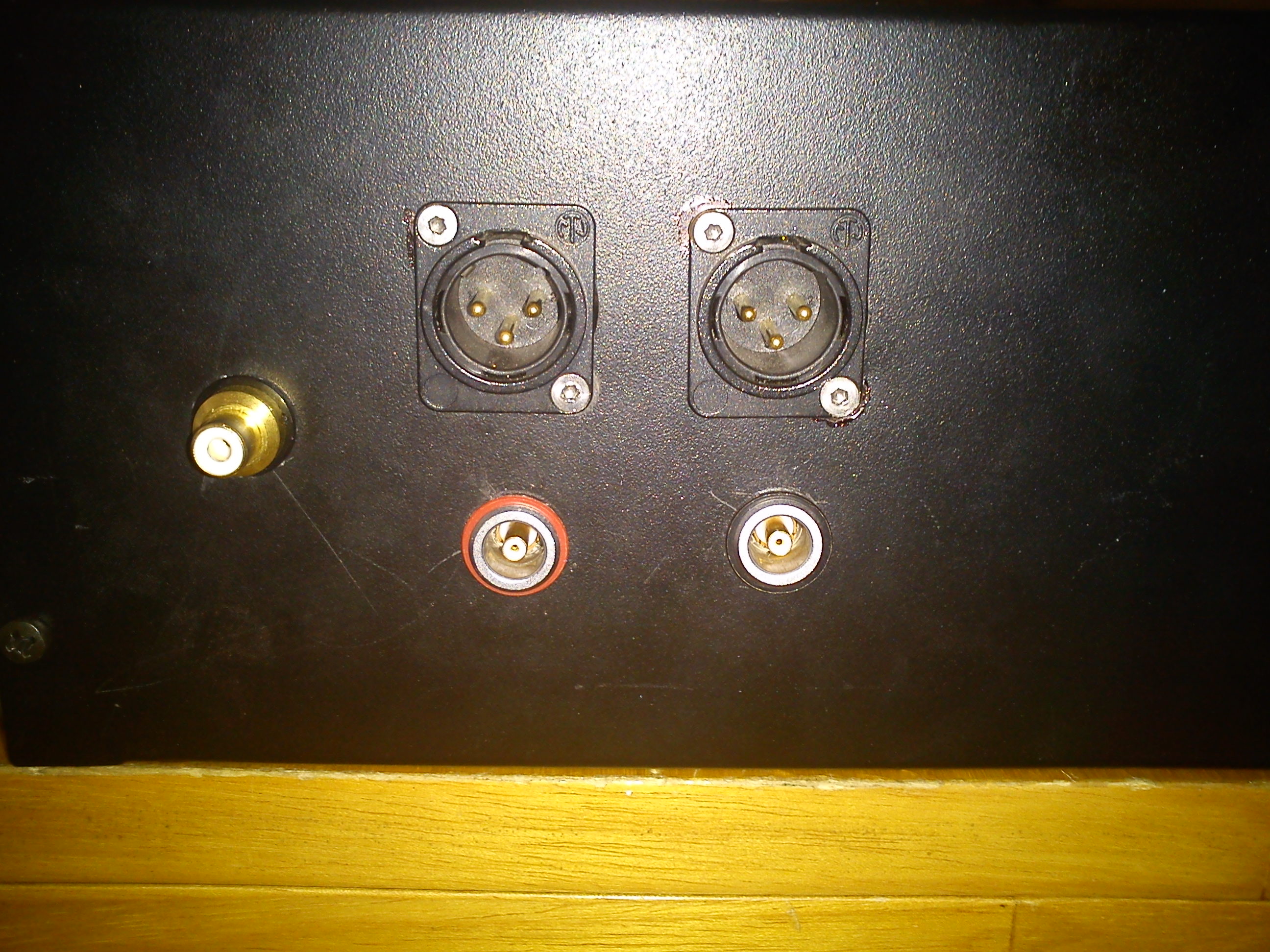

Lemo is FFA 1.S model is twinaxial + ground so perfect for balanced LEMO|FFA.1S.250.CTAC52Z|PLUG, S1, COAX, 50OHM, GROUP1 | Farnell United Kingdom but I bought directly to Lemo, Levinson's use the model FFA 00 see the pic that show the difference between the two models. Voltages are still wrong only decreasing the trimmer can get max 0VDC:confused:

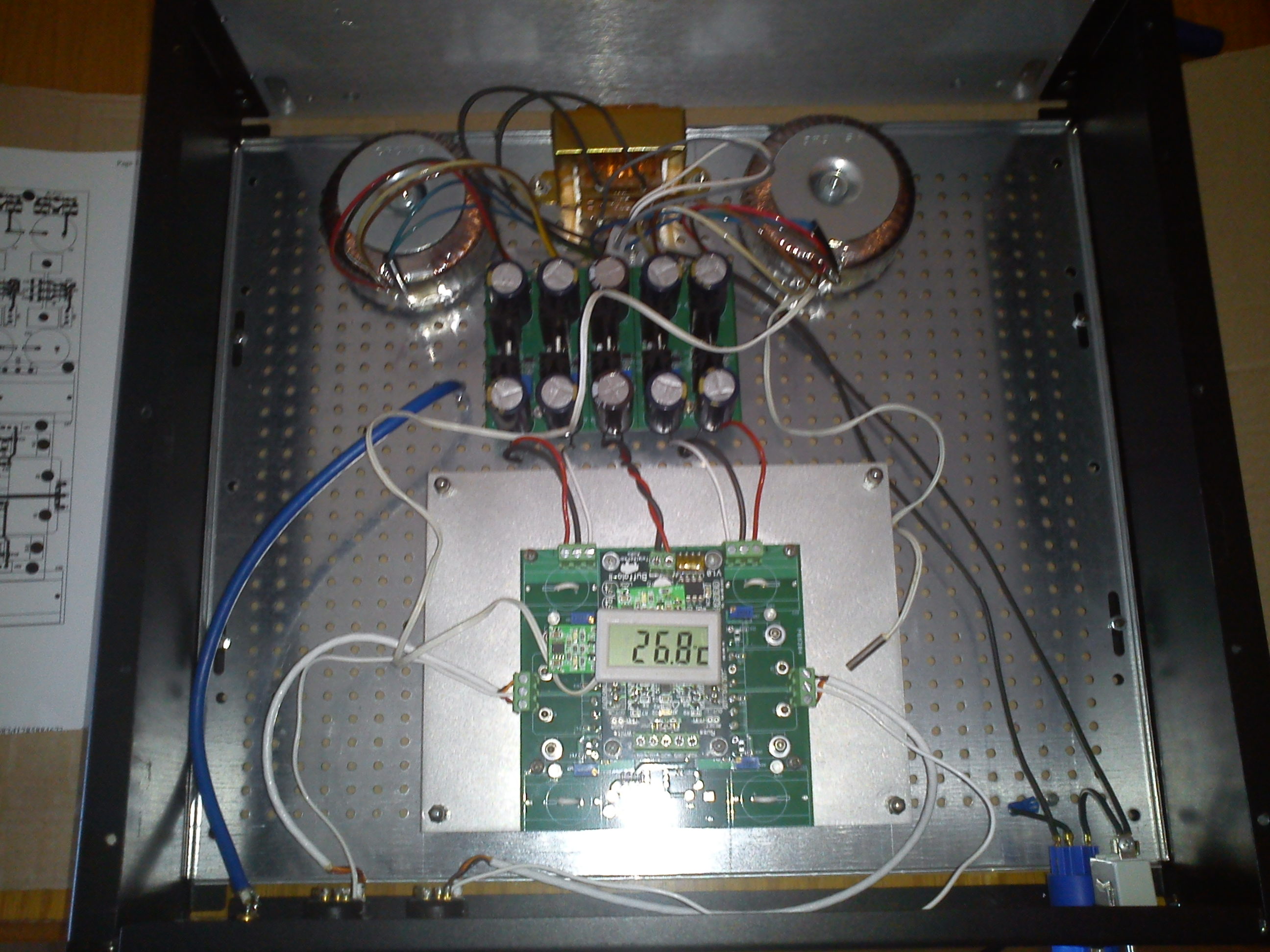

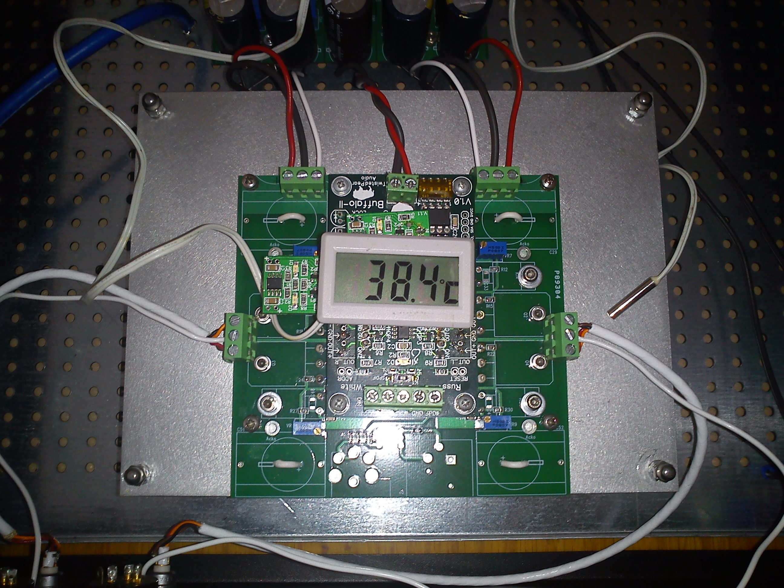

what is the air temp inside, so we have an idea of rise above ambient? sounds like its about the same temp as mine and we will probably end up with about 50c when its all cased up, which is just right for good lifetime of the caps and the dac. that is until we also add other shunt regs into the case :D
insideyour house i mean, since this is in the open
Yes inside house, see pics with ambient temperature 26.8ºC & a general biew of setup, blue cable it's a 75 ohms characteristic impedance: +/- 1 % of the nominal value
