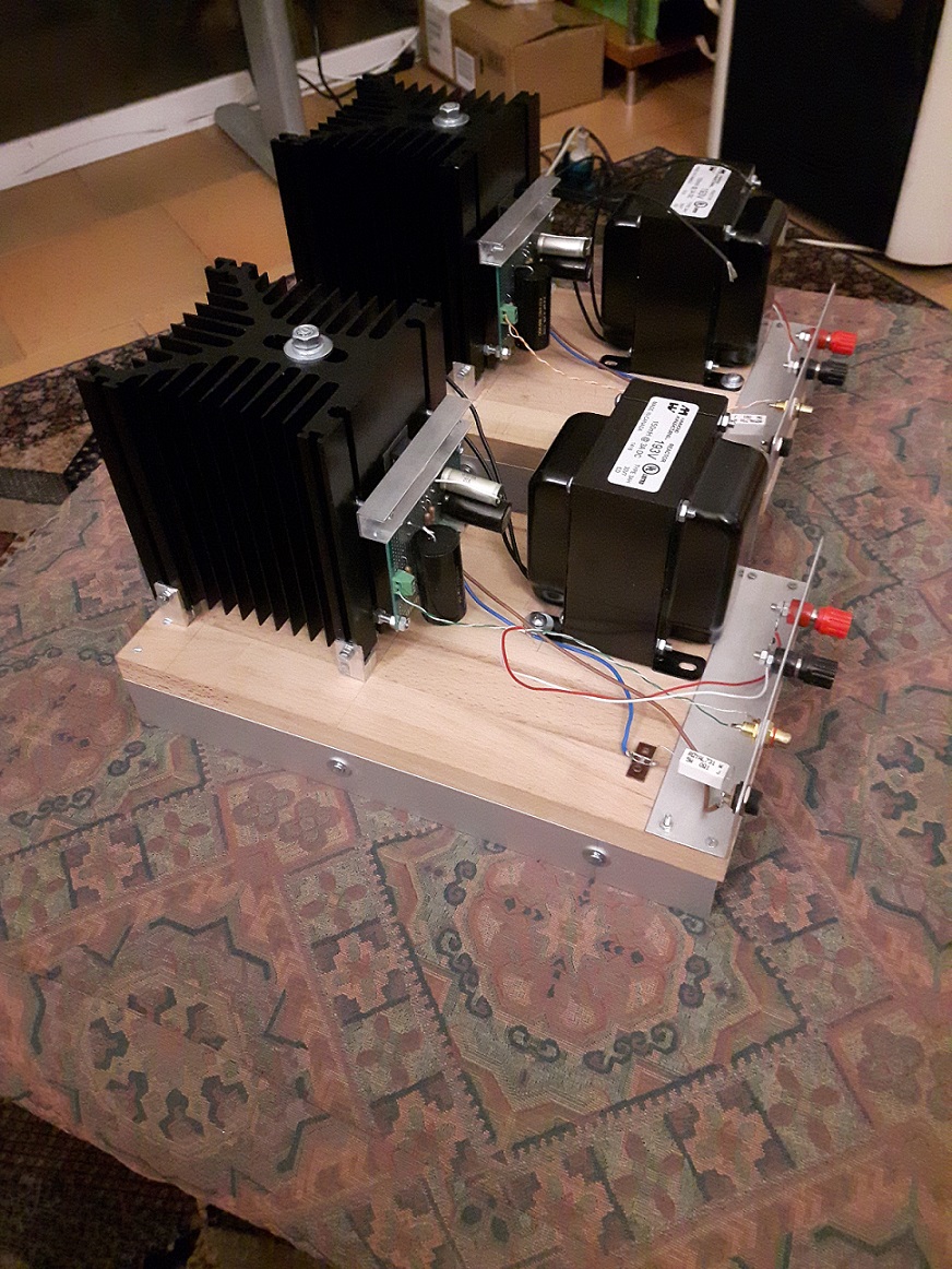

Two components needed for Big-MoFo. Arrived at my home the Hammond 193V and smps MeanWell LRS-200-24. Changes to the cabinet to place under the power supply. I wait to have time to put a panel connector to supply the 230V AC and complete the wiring.
In the meantime I have exhumed my old tube pre with 6SN7 sylvania (this is the KISS of Ciro Marzio: simple common cathode with plate loaded by an autotransformer .... zero electrolytics on the circuit and on the power supply ... only caps in polypropylene CLC ... 5Y3 rectifier) and the quality of the Mofo came out explosively ..... I just forgot that I had only 12 Watt available .... only 12w .... but my pre can field 20db of gain .... and the MOFO sings ... really wonderfully. no constriction or hardening .... perfect.
The experiment with the pre of juma(with supply Salas shunt) of which I mentioned in a previous post I was not satisfied ..... only 10-11db of gain and lack of vitality '.... but it is probably only unsuitable to work with the Mofo dates its characteristics (no gain).
Now let's see what happens with Big-MoFo ... I suspect an increase in the dynamics and quality of the soundstage .... which is already high quality.

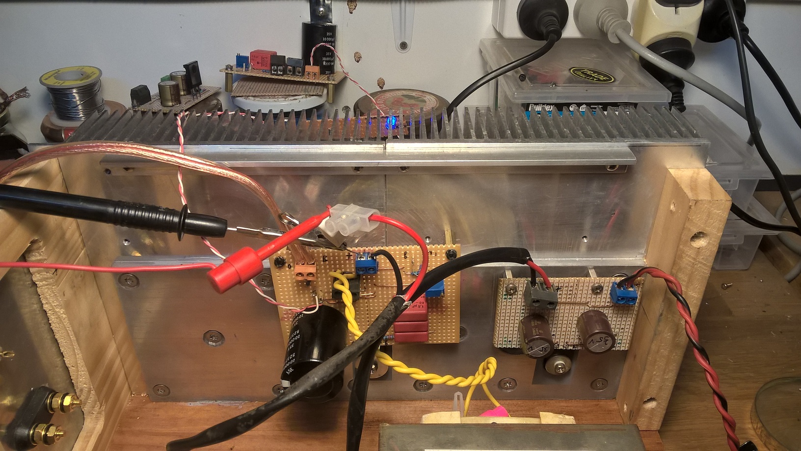

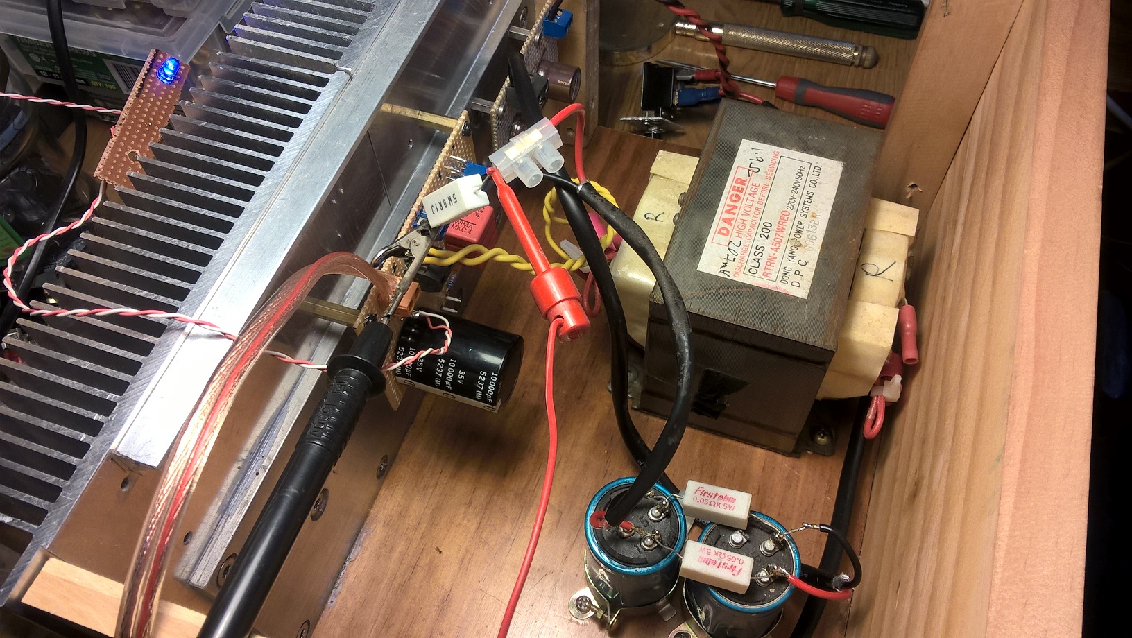

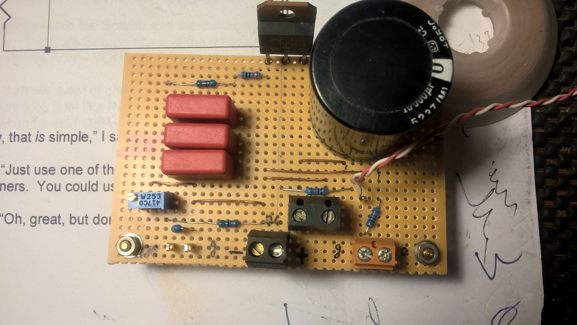

Hi everyone.
I need some help with the MoFo I'm building on a proto board - I can not bring the current down, it stays at around 4A.
The choke is a microwave transformer @200mH, 1.9 ohm (measured with my cheap LCR meter).
FET is IRFP150,
P1 is 25K.
V+ is 20V, 24V in, CxMx, then CRC with 15mF-0.05ohm-15mF.
Not sure what am I doing wrong. The current through the FET sits at 4A no matter how many turns I turn P1 either CW or CCW.
The FET is hot to the touch, but it tolerates the current (being bolted to a massive heatsink), there is no smell or smoke from burnt components.
Will be great if someone can point to the error I've made.
Below are some photos.
Thank you.

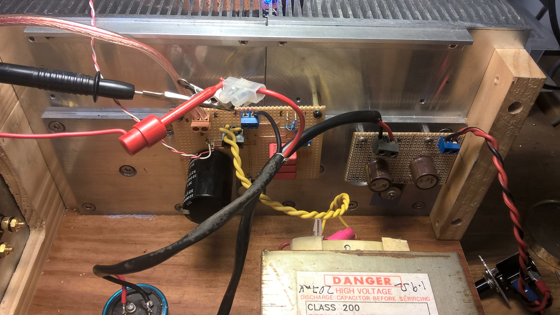

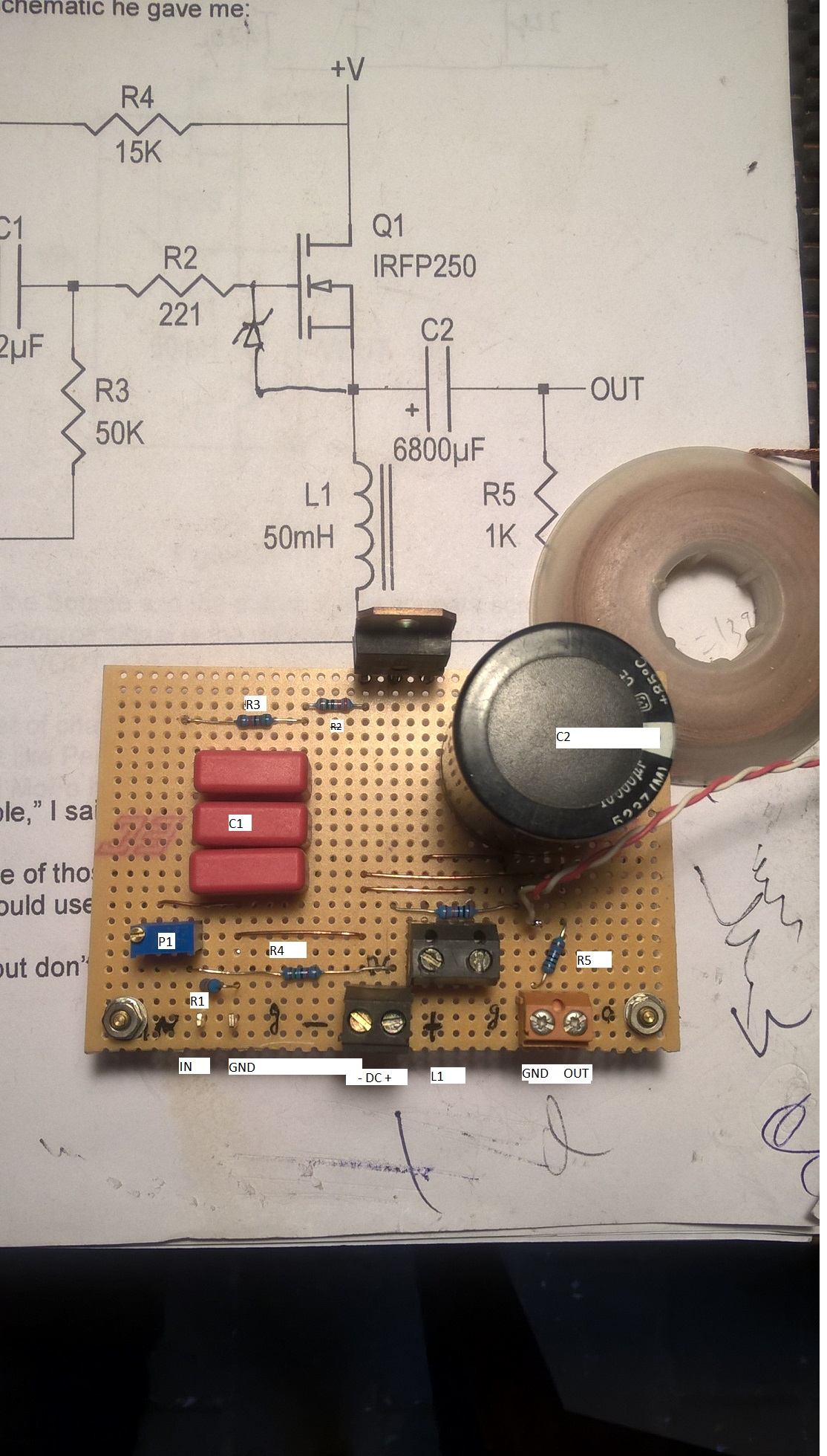

OK, I should have been more specific.
This is the second channel and the FET is not soldered, just plugged in there for the photo.
Otherwise the boards are identical.
I am just working on one channel and ironing out possible wiring and other faults, e.g. found that P1 was 200K, also there was no GND connection to the bottom of the choke.
The worrying part is the Pot has no influence on the bias through the FET and I don't know why, everything is wired according to the diagram on p.4 of the original MoFo file.

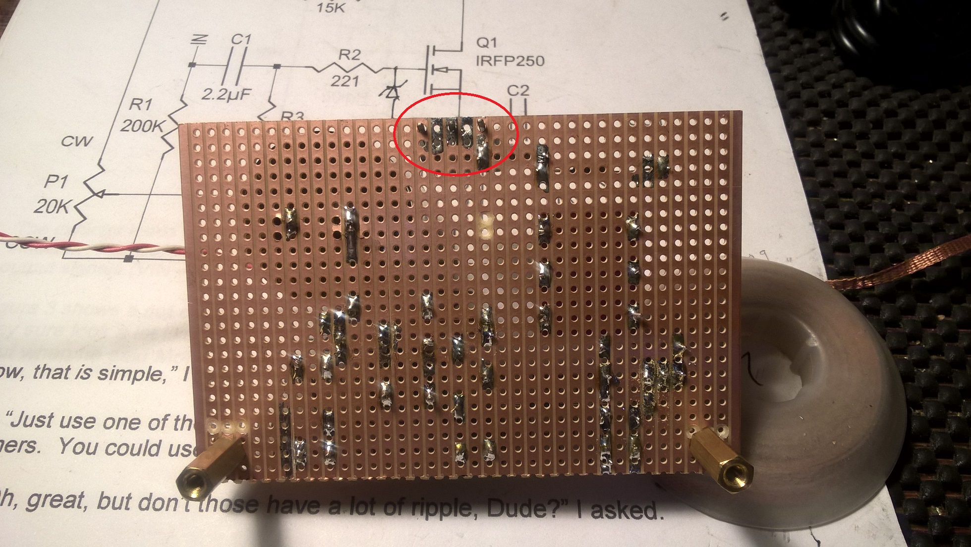

Look at the soldering of the FET itself circled two dry joints!
That might be the cause.

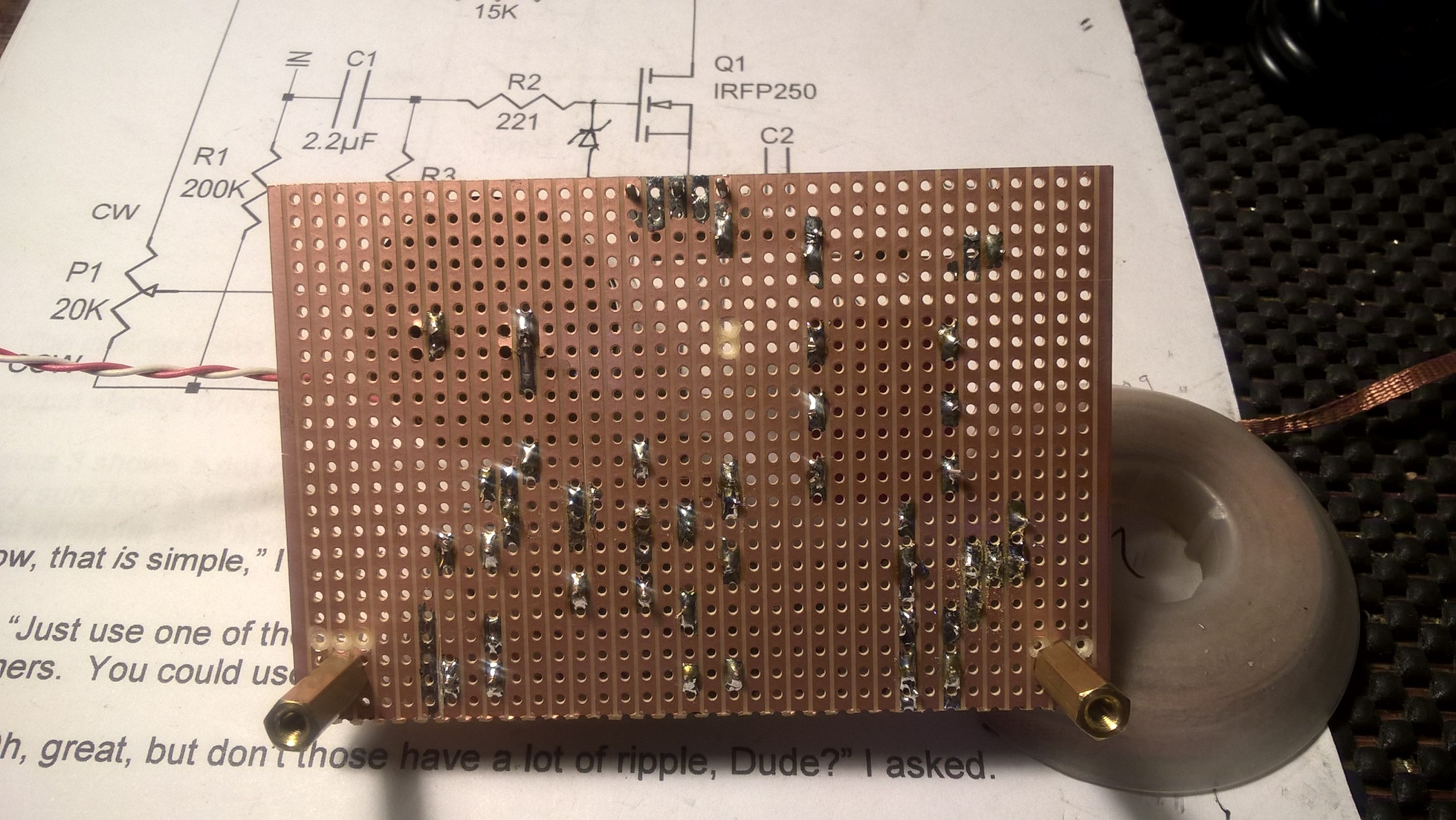

Hi formantjim, you'll might be pleased to know that you were very close to the mark.
Turned out that the channel under test had a broken track between the gate of the Fet and its gate stopper resistor, although both are probably 1 mm apart.
Thank you for the lead in the right direction.
Once repaired all went fine - adjusted bias to 1.6A, stays steady, monitored for an hour.
Tomorrow will test the other channel, hope will be good from the start.
Some photos of the one under test.

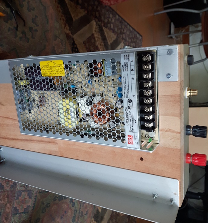

Finished construction (added SMPS MeanWell LRS-200-24 and related IEC connector and 193V inductor)...look this post
fixed the bias to 2.4A for 24V. In static mode the heatsinks now heat up more but my hand can leave it without bother ... I do not want to measure.
