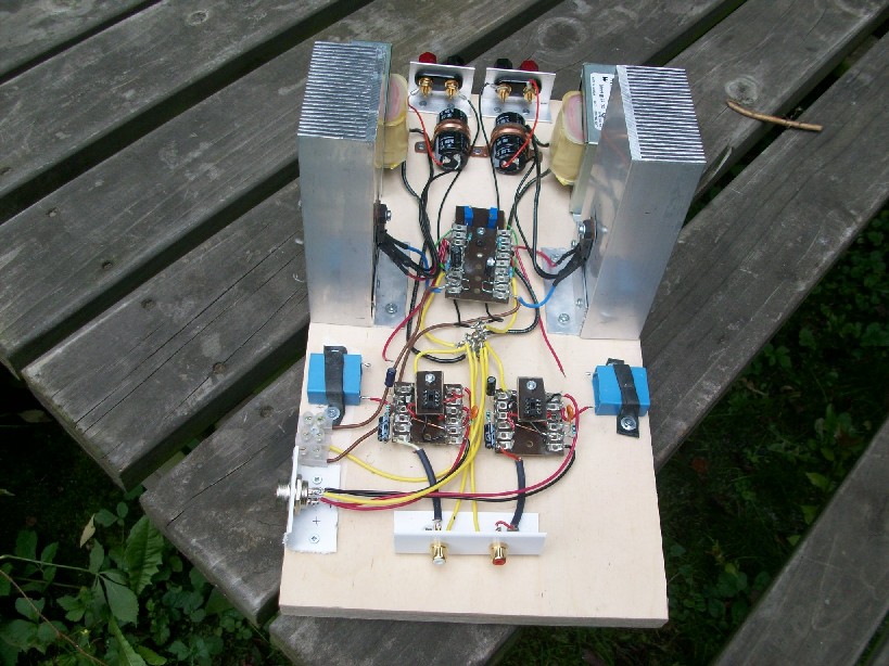

I haven’t had too much time and progress is slow, but this is what I have done since last time with my MoFo with a twist. I still need to mount the switch mode supplyes.

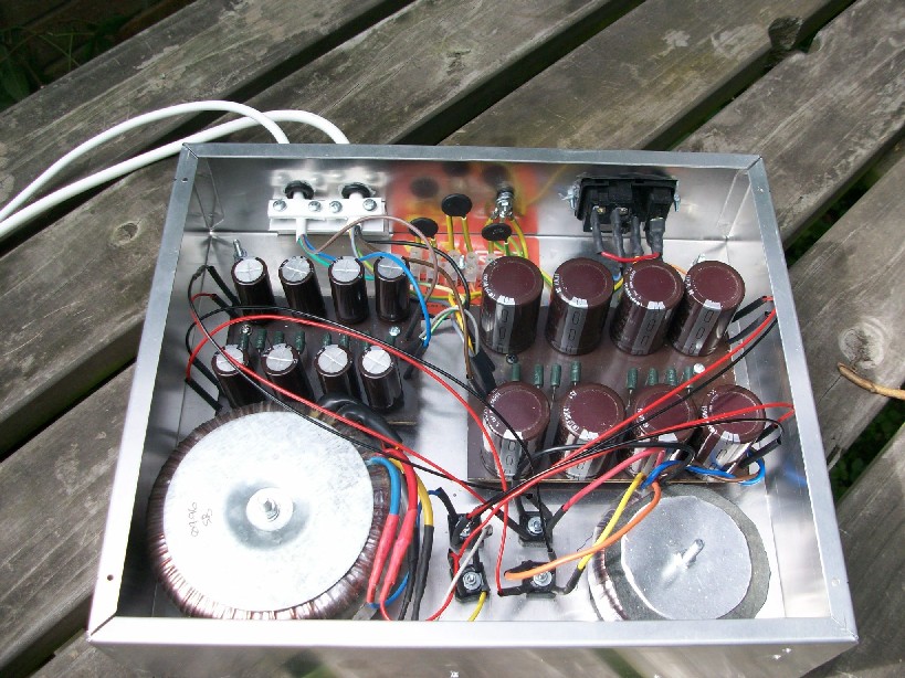

What is it about passive amplifier loading that sounds so nice (at least to my ears)? The MoFo has become my favorite amplifier now, it just sounds right, especially with my Markaudio Alpair 12P's in Super Pensils.
When I swapped out the switch mode PS for a linear PS and the bass just finally worked. The transformers are slightly undersized, about 80VA per channel. They're two Parts Express clearance toroids I've had sitting around forever.
Sagging PS voltage magic? Listening to some Chris Stapleton now and just wow!
I'm thinking of building my MoFo with a linear PS.. Does anyone have a circuit I can follow.. Thanks
My MoFo supply. Rectifiers, 30000uf, 0,120ohm, 30000uf. Per channel. 2,3 A bias and 23V.
No hiss, hum, etc.

Hi El ReinoMy MoFo supply. Rectifiers, 30000uf, 0,120ohm, 30000uf. Per channel. 2,3 A bias and 23V.
No hiss, hum, etc.![]()
did you compare with smps?
The Universal v3 PSU + Gnd - board can be turned into two parallel Gnd + boards merely by not connecting the grounds together in the center of the PCB.
That's basically what mine is. 15VAC transformer that loads down to 12.6VAC for about 17.5VDC out at 1.3A bias. The only difference is I replaced the resistors between the cap banks with 2mH, 4A inductors.
I'll probably go with a 15VAC, 250 or 300VA when I build into chassis. Those little transformers mechanically buzz too much.

I would reverse the polarity on the caps of the negative side of the board (C1, C2, C5 and C6). Then reverse the connections of the negative side rectifier going to the negative side cap board:
V++2 to D--2
V+2 to D-2
V--2 to D++2
V-2 to D+2
Then go ahead and tie the grounds together of both sides for star grounding. This puts the resistors between caps on the + side of both sides now. Of course the V- output is now a V+
V++2 to D--2
V+2 to D-2
V--2 to D++2
V-2 to D+2

here's bodgy..
I dont have an active pre-amp so I've put an op-amp on the front with a gain of 3. It's 2sk1058 and hammond 159ZC. I'll start at about 1.1 amps bias cos I'm not sure of the heatsinks...
the power supply shown is from another project but I'll use half of it here for the op-amp. The fets will be powered from 2 x 24v smps that I had lying around.
