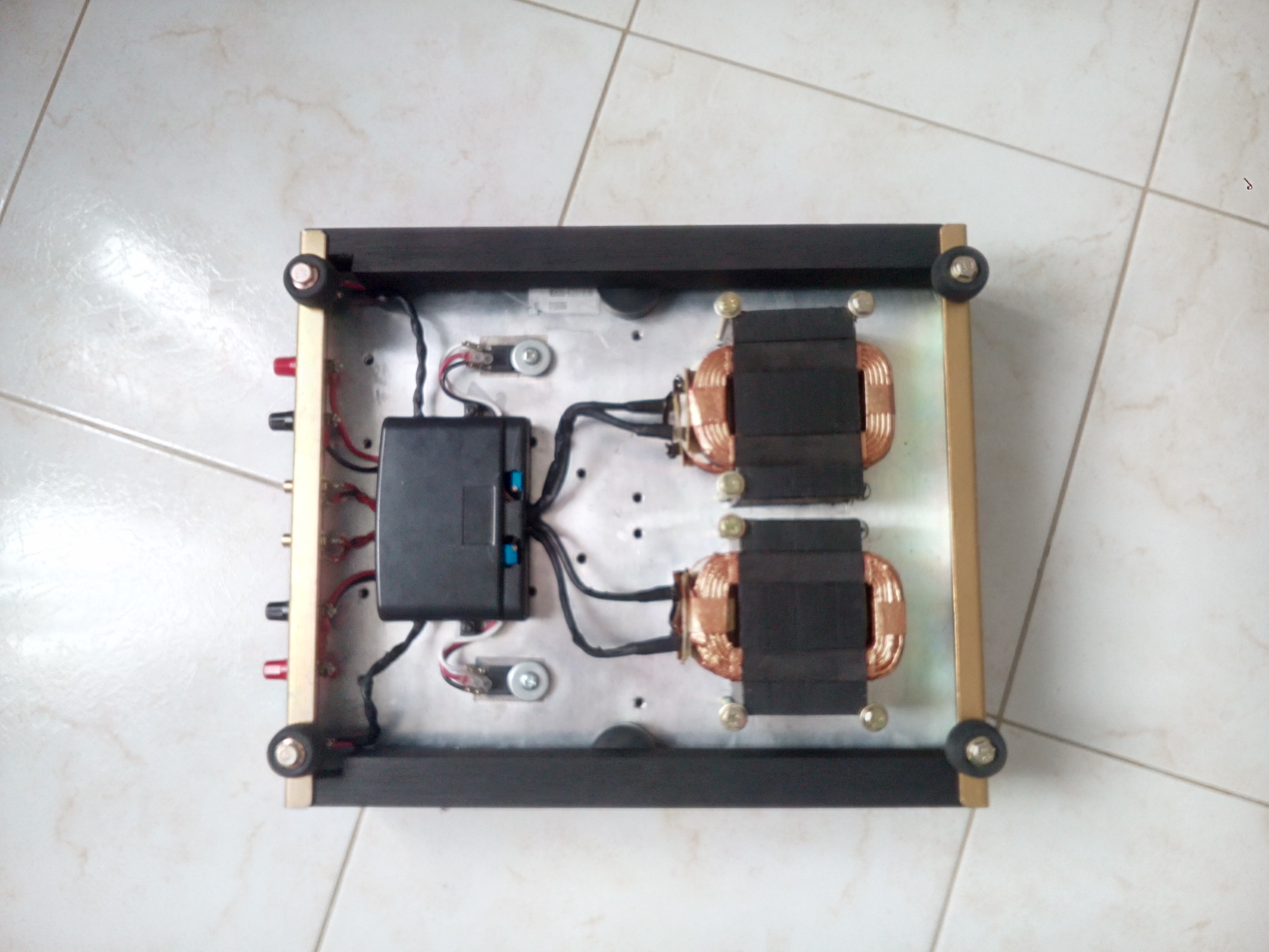

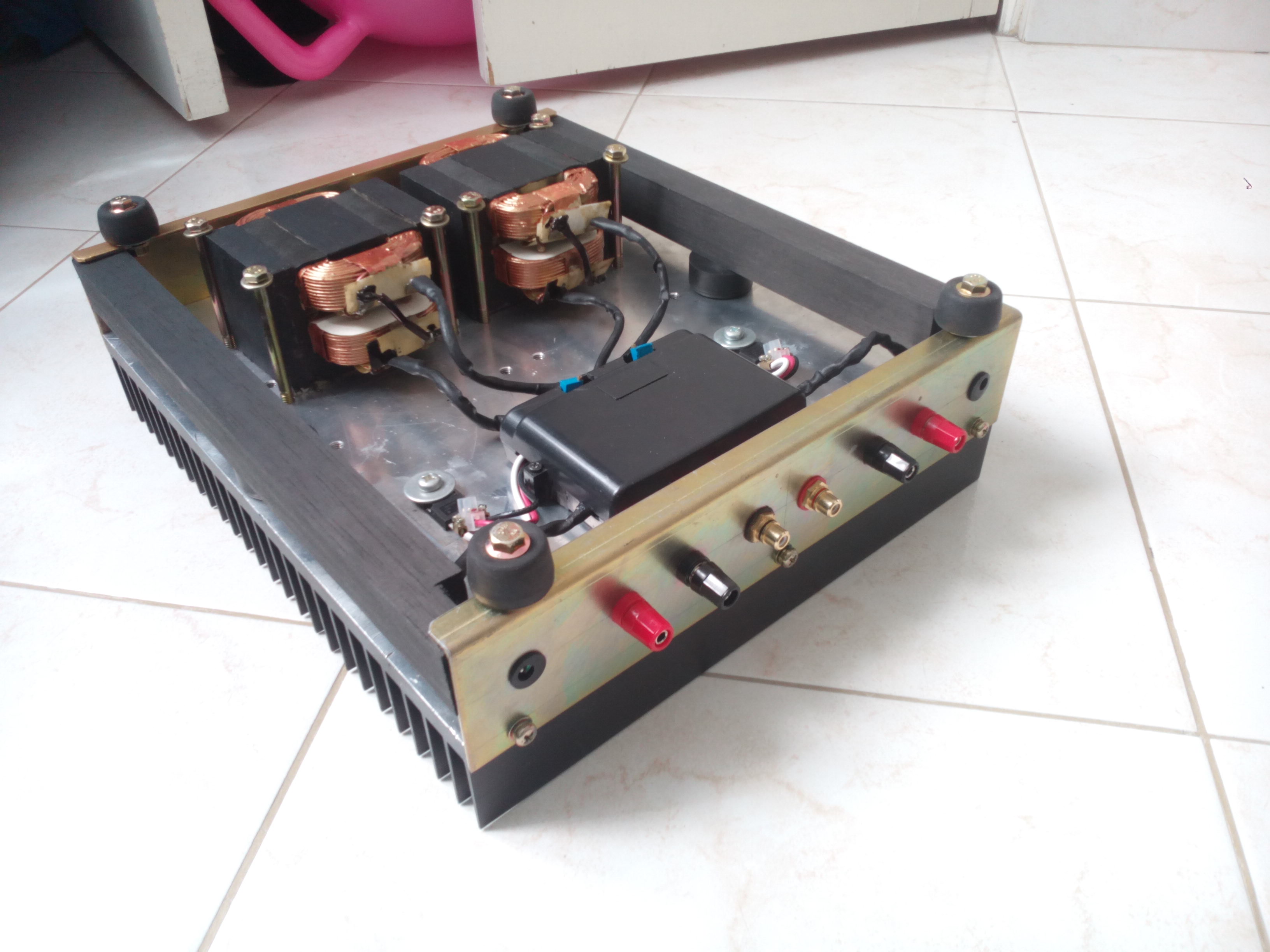

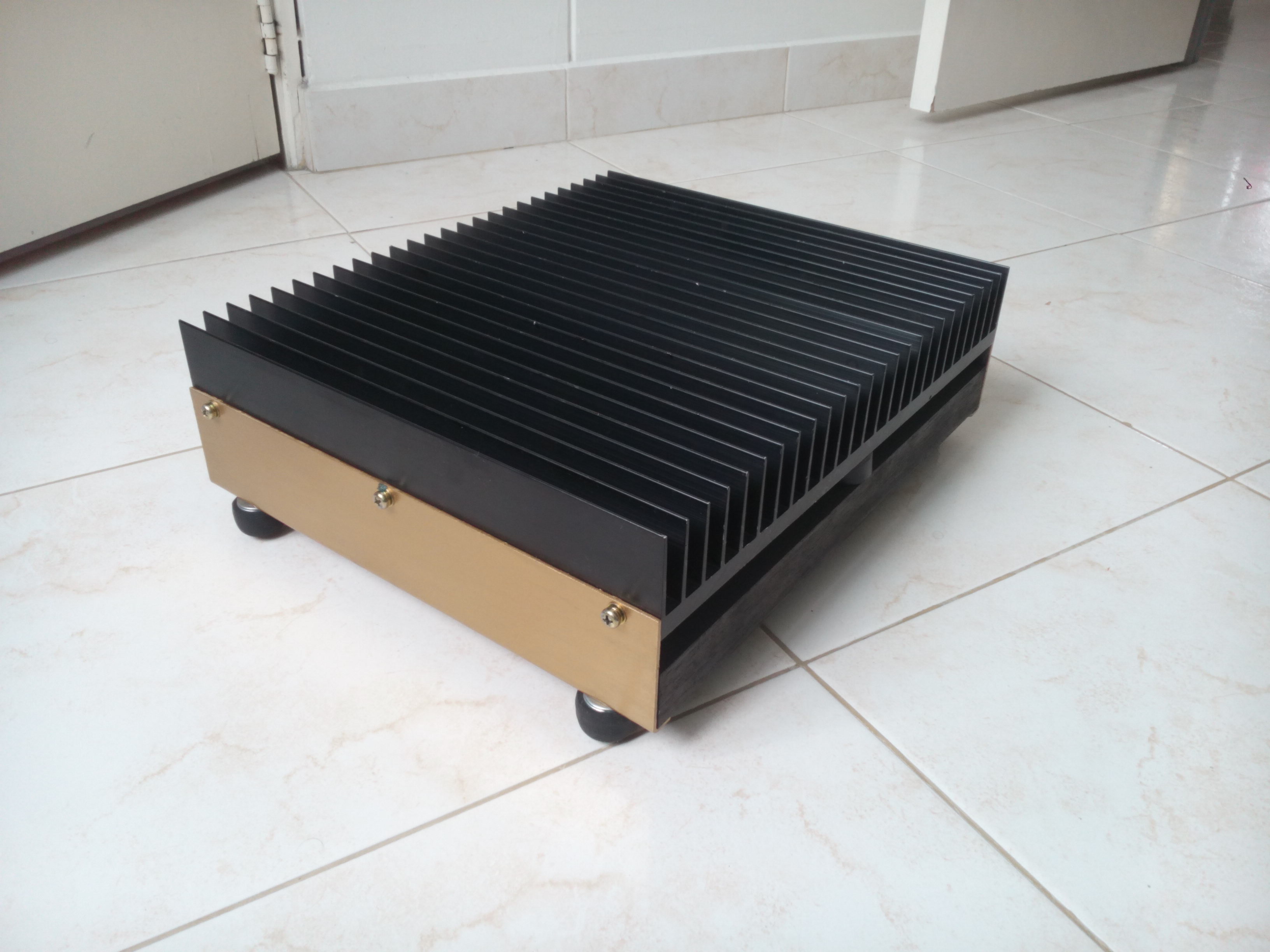

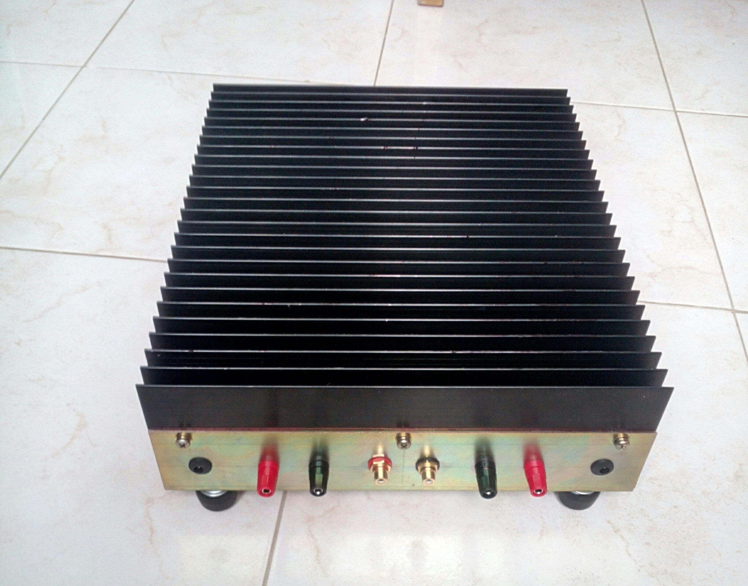

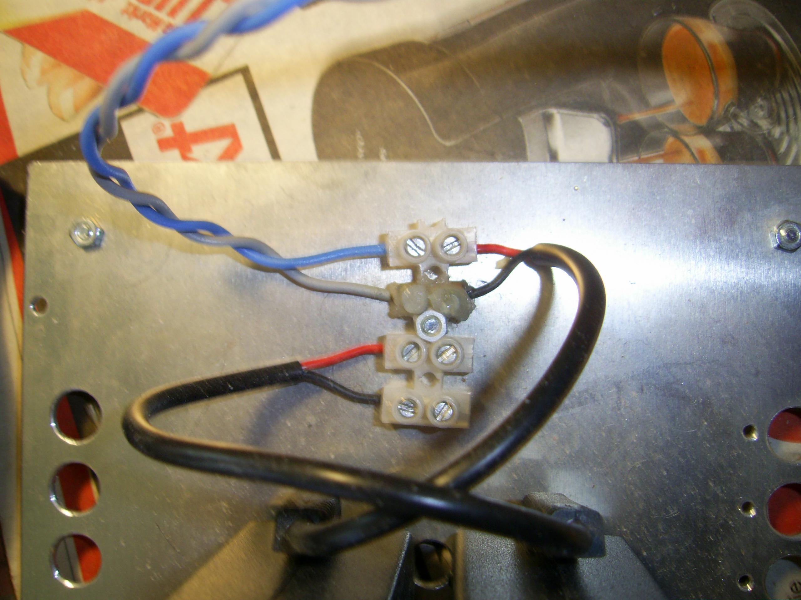

I built this MOFO, in a 19v version. My first DIY amplifier. For the file, I attached some photos.
The amplifier is medium in size, very friendly with the decoration and only weighs 12kgs. I used the heat receiver (recycled) as a chassis, since it had previous perforations, which I used. It has no bottom cover for better cooling. Very minimalist
I read all the pages of this forum !. A lot of useful and inspiring information for a novice like me.
The small black box they see at the center contains the two MOFO channels, built point-to-point.
As an inductor I used an MOT, which I removed the secondary and added another primary in series. I painted them with copper color, to match them. I used nail polish.
The heat sink weighs 6 kgs. Each choke weighs 2.5kgs. I think that they allow me a route of easy update to 24v.
Later I will give my impressions on the sound.
Thanks a lot Mr Michel Rothacher and members of this forum🙂

Nice.....but....I built this MOFO, in a 19v version. My first DIY amplifier. For the file, I attached some photos.
there will not be too much heat under the cover of the sink?😕
pardon...
I saw the openings for the air.....good

your inductance how many Amp bears.
If you go to 24V you could raise the bias up to 2.5A and have a good margin of power.
In short, fall into the BigMofo ..... I will do it when I am in possession of the Hammond 193V😎
JAGCH,
You've got a cool looking MoFo there!
Congrats and Enjoy 🙂
Very nice build JAGCH
One question: How did you do for the winding of MOT. Wasn't the iron welded?
Thanks!.🙂
Yes, the MOT had solder joints. But it is easy to cut through the welding line. I used a metal saw. Then, removing the secondary with some hammer blows is relatively easy. I took the primary of another MOT of the same size, inserted it instead of the secondary one and connected them in series. I bought them used, at only US $ 2 each!
In this forum someone put a link to a similar job (I do not remember who or where, there are many pages...), but instead of taking the primary of another MOT, he´s built a coil and then inserted it. A lot of work for me! I chose the easy way.
I seem to remember that the author suggested that and I listened to him. Good advice!

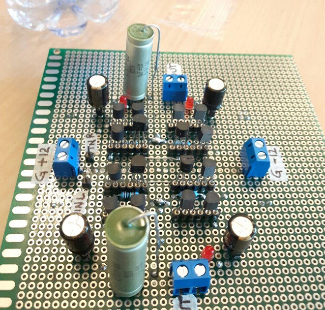

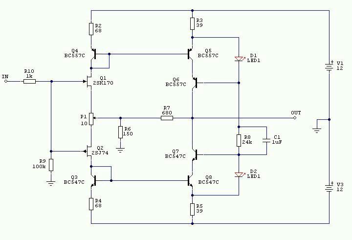

to play with Mofo, I chose to start the front-end tests with an interesting pre by Juma.
I finished the construction today .... I'll have to think about feeding it with a shunt salas .... maybe.
this is the scheme and the realization on perfboard.
let's see ..... and let's listen
