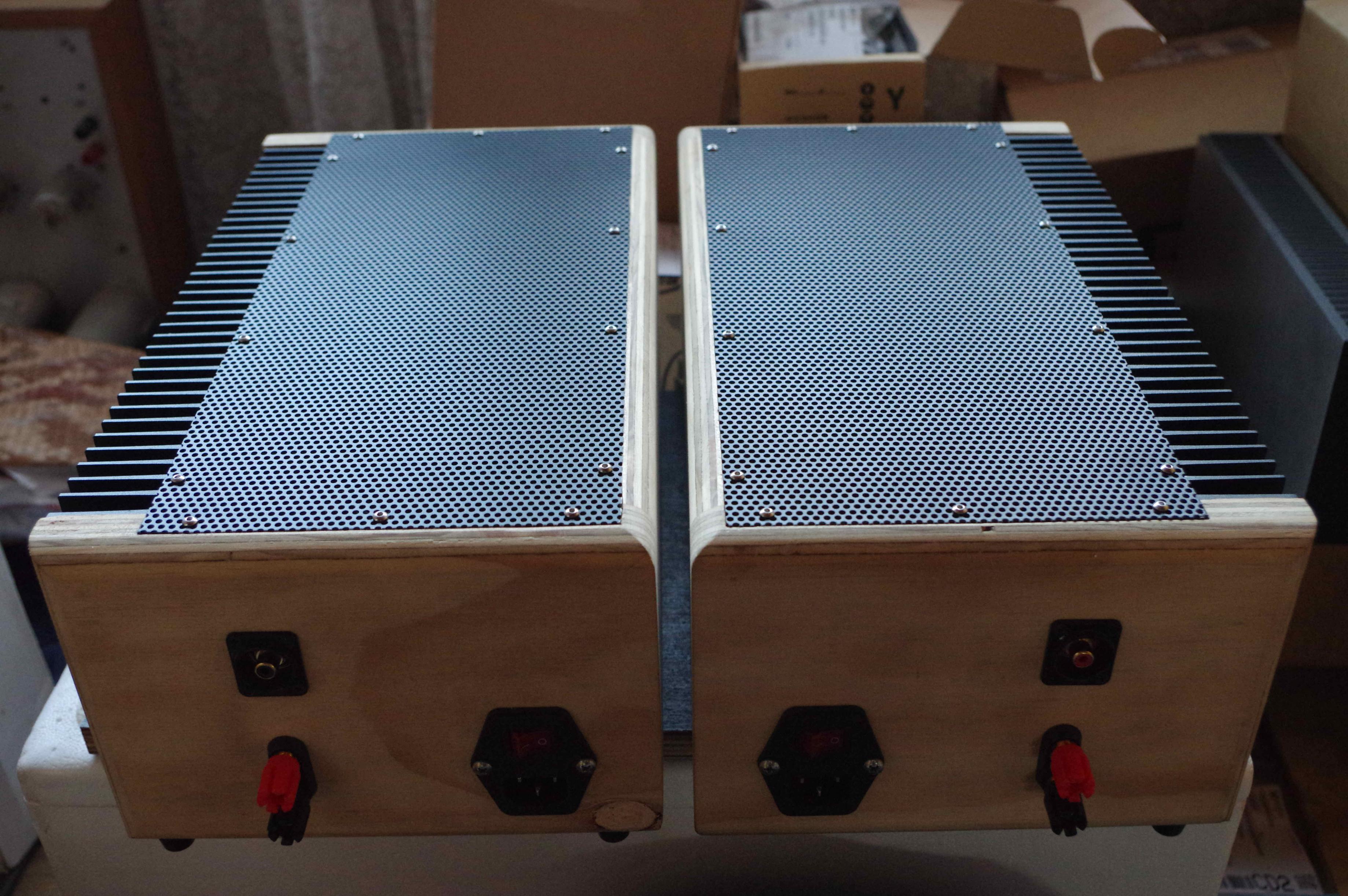

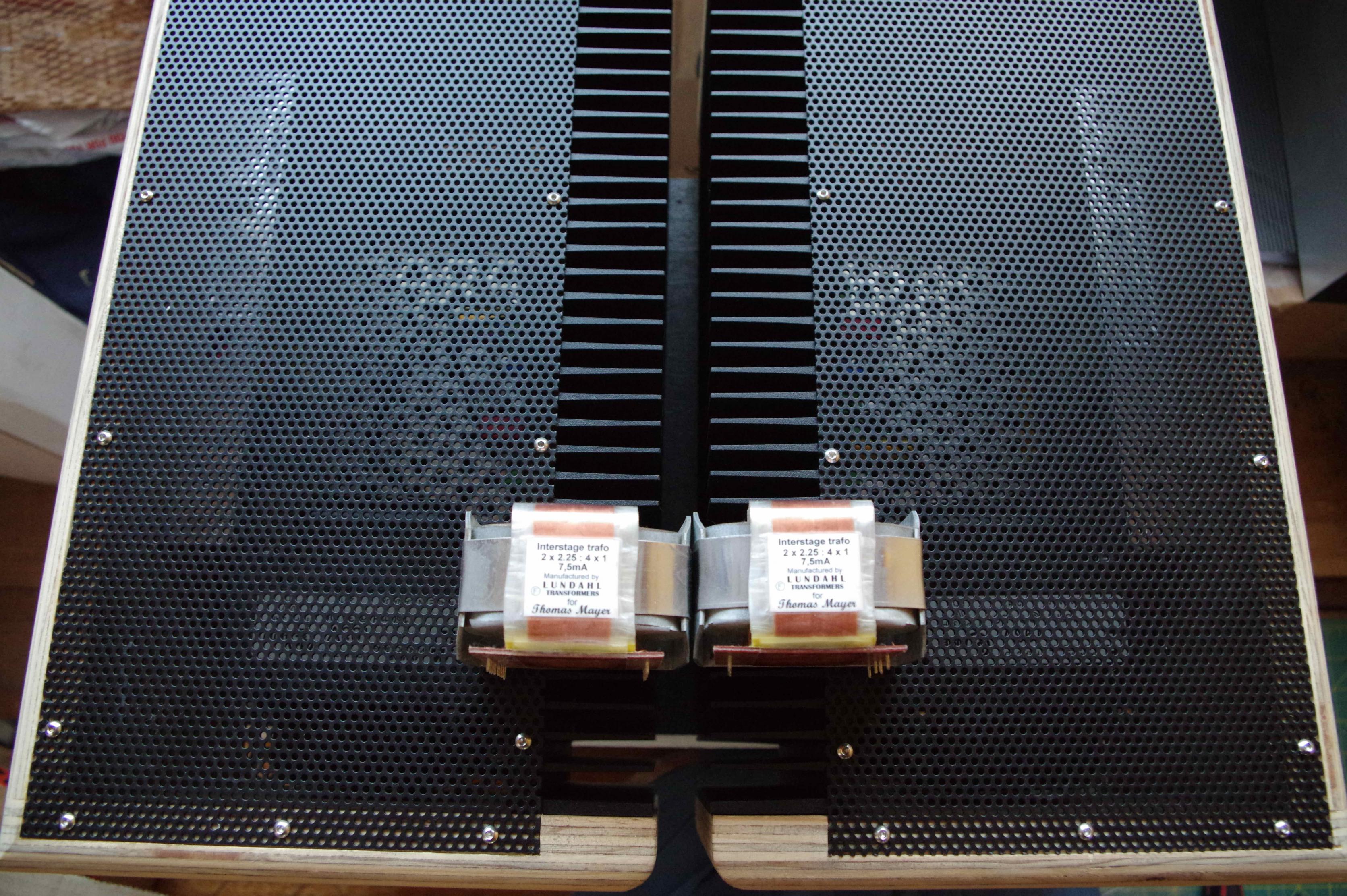

Heatsinks are from Conrad MF350-151.5,Overkill as they barely get warm but who knows what "EVIL" plan Michael has in store for MO-FO Mk2.
Maybe a couple of these critters pictured.
And a shot with the lids on.
Steve.

Very nice build! I was thinking you were constructing these in the "Classic DIY" style - that of over-engineering! I'm also a HUGE fan of wooden chassis - I like to make stuff look more like wooden furniture that can blend into the decor a bit. I see you've also used my favorite router bit - a 1/2 roundover. I use that bit on just about every project I make...
Thank's Eric,
Being that i'm a worn out carpenter i can't help but use timber.
As for over-engineering i'm not sure there is such a thing as too much heat sinking!!!
Steve.
Steve.
