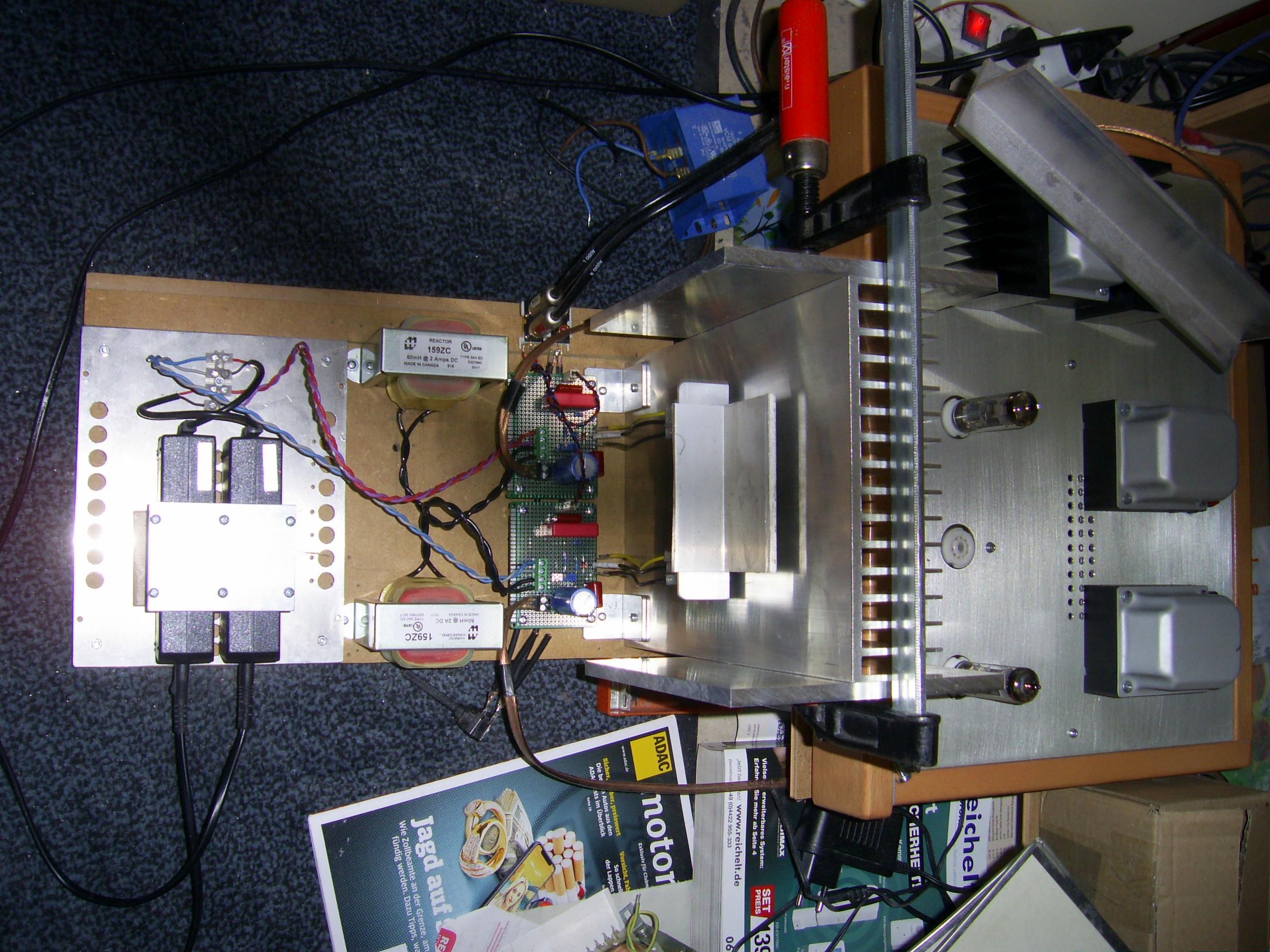

MoFo with IRFP140N is burning
First: Big Thanks to Michael- great stuff Dude!
To choose from that many good shared ideas i have started from low cost
with Hmd. 159ZC Inductors.
Now the third all day long 🙂 the MoFo is heating up the living room.
The Bricks i have borrowed from ACA- 20V,5A.
For daily listening i must reduce stable bias to 1,7V- measured over coil- otherwise heat goes to high and bias is lsowly raisng up.
Just for first start up now.
Capacitors are MKS4 2,2u+ parr.0,1 pp and KA is bypassed with 1u pp.
This ones: Weber :: Film Foil :: Capacitors :: Passive Components :: Electronic Parts :: Banzai Music GmbH
What i read here there is a wide range possibilities for testing out, playing arround, in future, to find the own sweet spot.
My only useable source is directly connect to TV from HP out and regulate with remote.
First impressions: to early? not sure 😉.
Clearness is first impressing, stable center, separation image. I miss in moment a bit more 3D image.
Tonality is clear from deeps to highs with authority all on Pauls little Overnight Sensation.

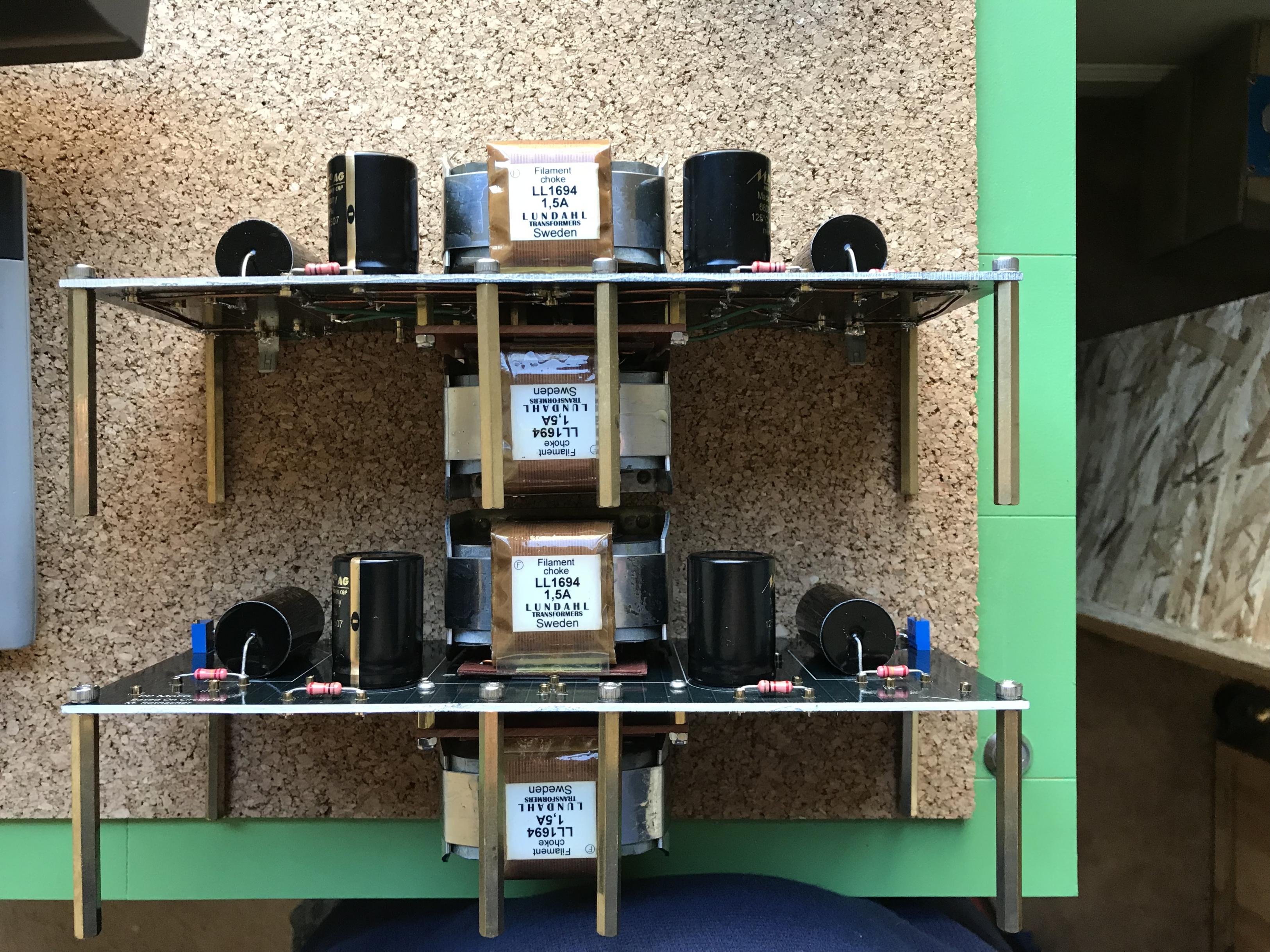

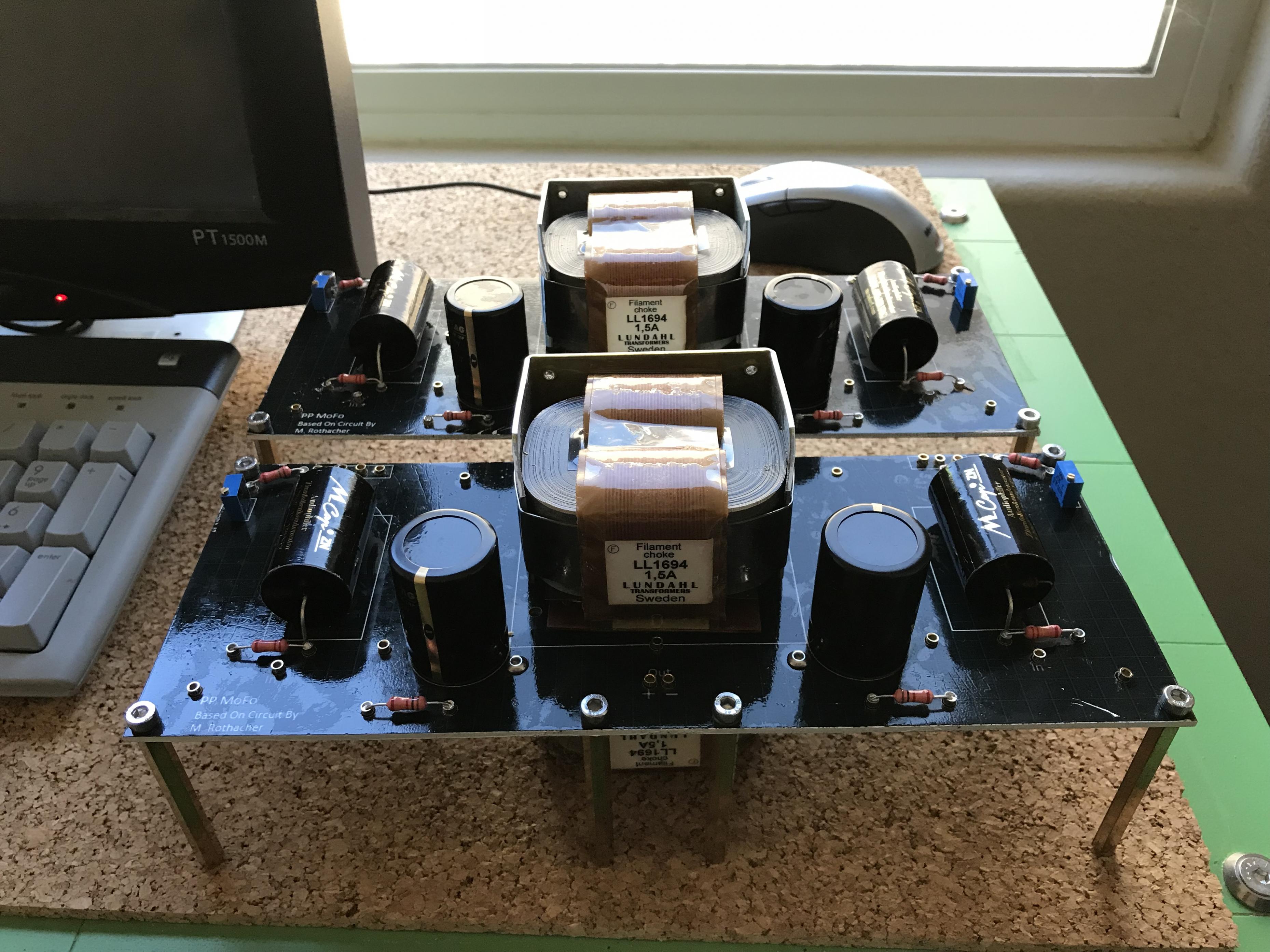

Hello, I’m finishing up my PP MoFo and was wondering if their was a P channel equivalent of the IRPF250? I’m currently using the IRPF240 and the IRFP9240. Thank you!
