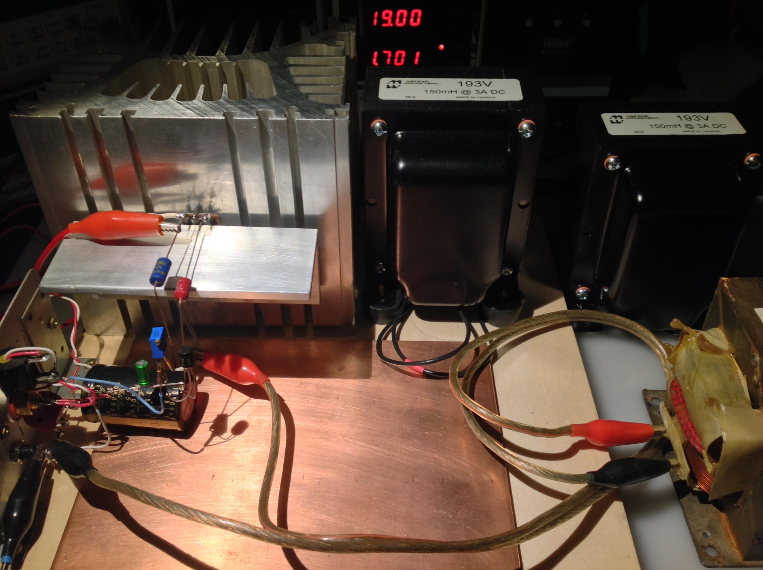

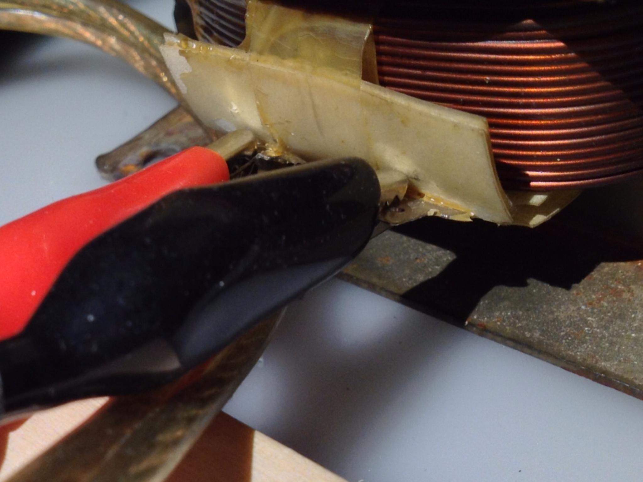

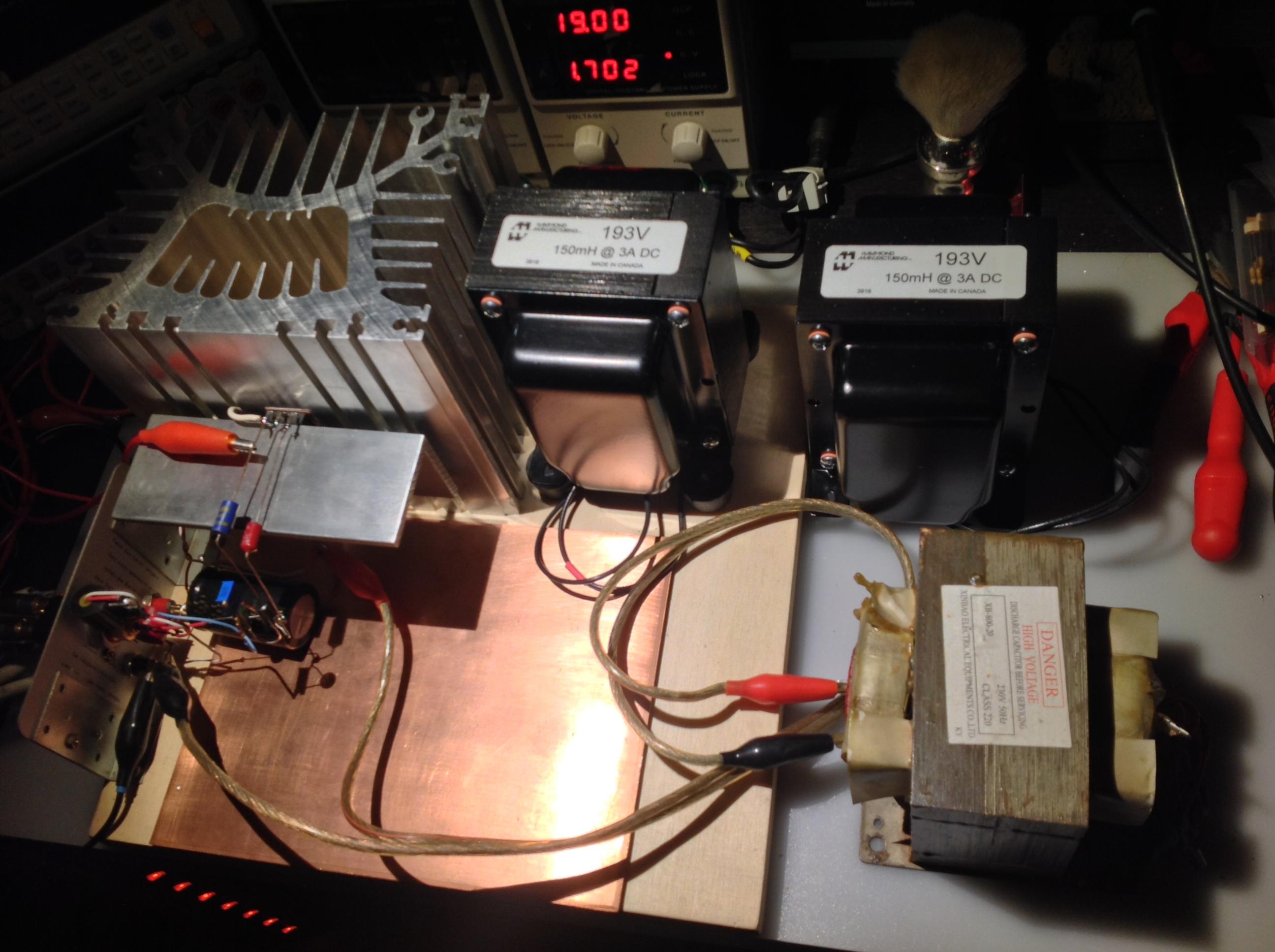

Find another microwave transformer in my junk box. His name is Rusty Dusty.
This one is more high but less large core.
R=2 Ohm
L= 164.1 mH
Who have professional L meter and microwave psu transformer to compare values of mH measurements ?
:D
If you have an oscilloscope you can use a large capacitor and discharge it through the inductor with a low Ohm value power resistor in series, hook up scope probe over the resistor and then translate the scope curve into current, using the formula v(t) = L * di / dt the inductance can then be estimated. :)

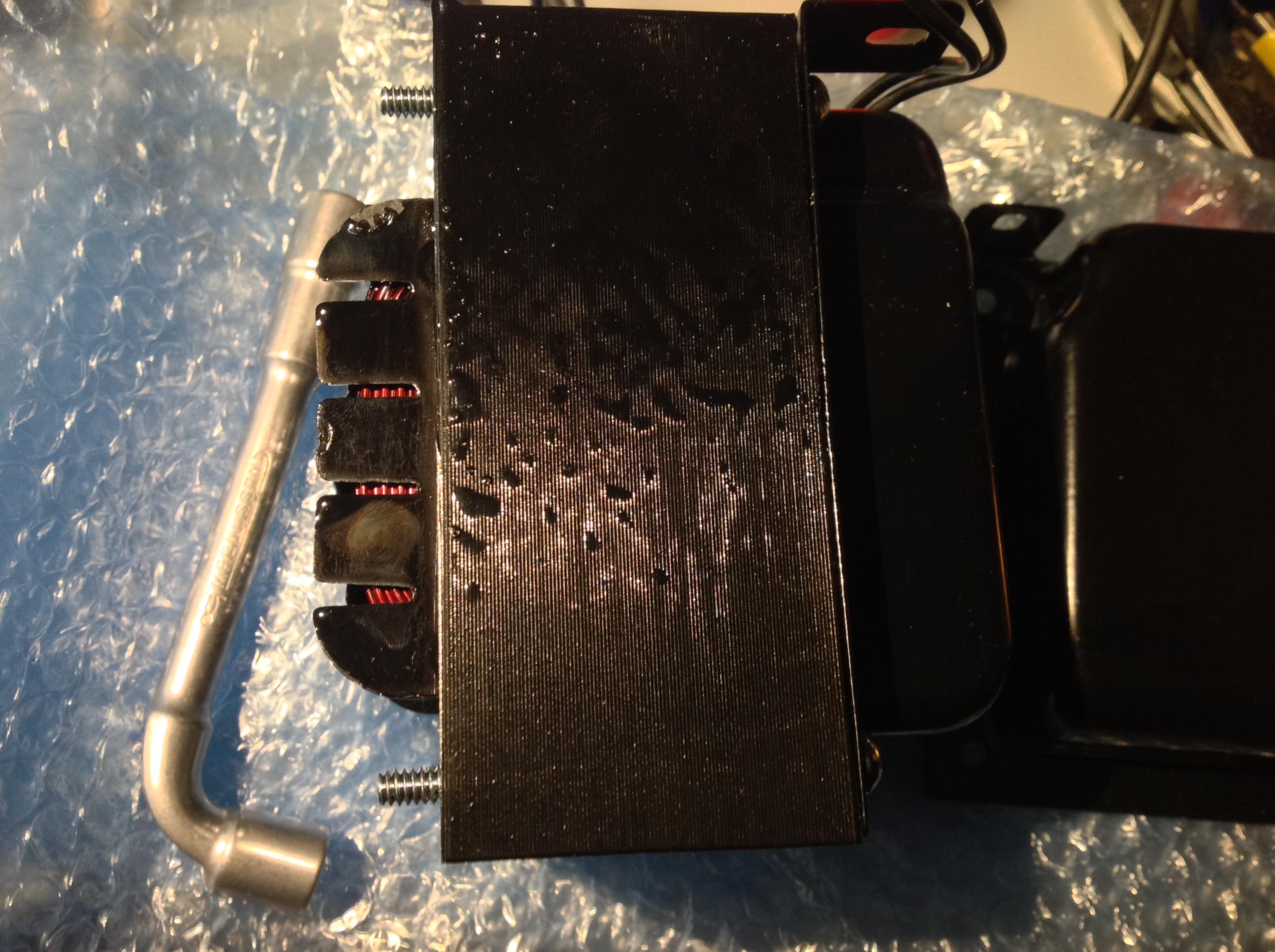

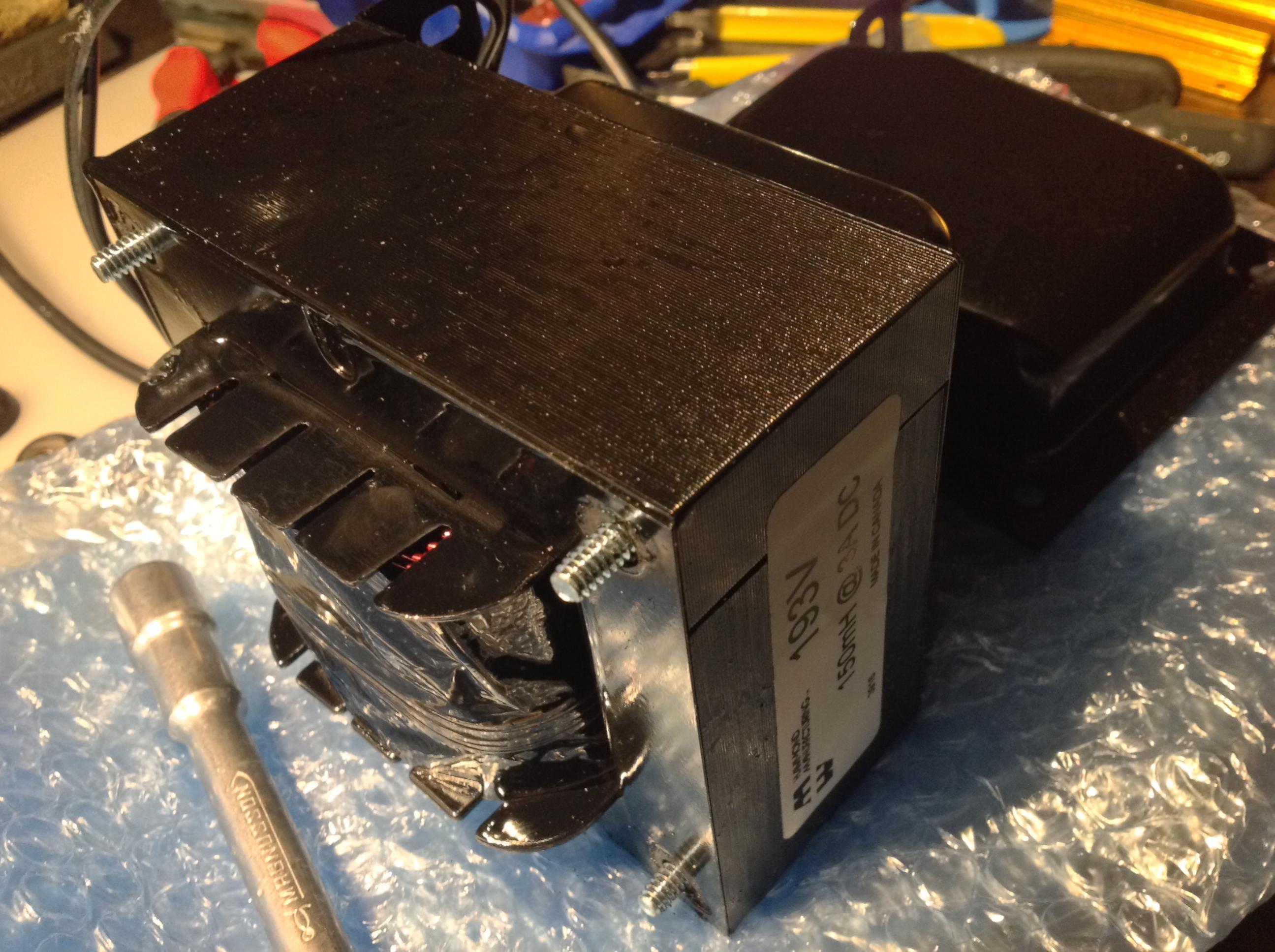

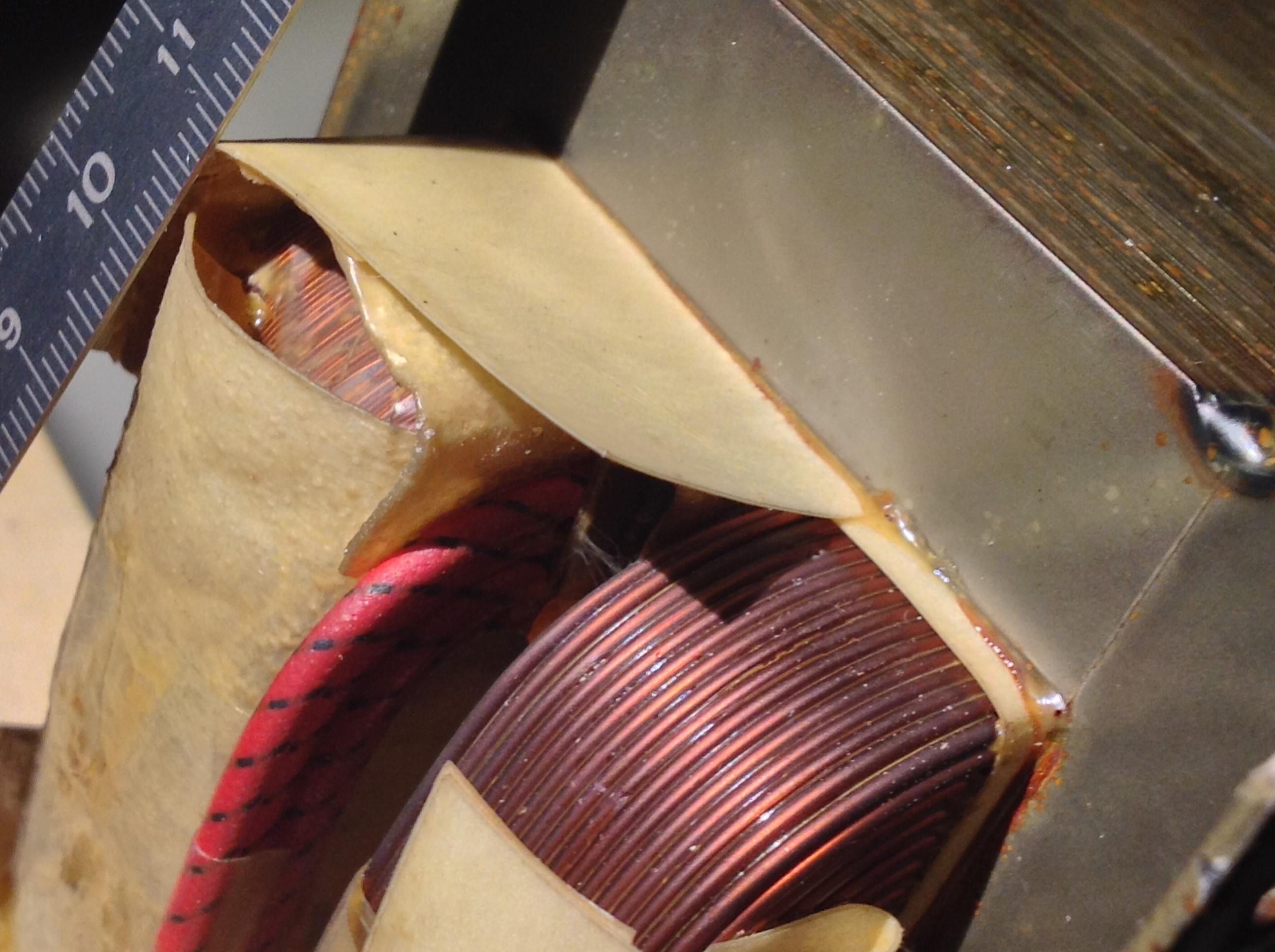

I do simple visual inspection inside of Hammond 193V | 3A to verify diameter of the wire
and compare with inductor microwave wire diameter.
Look like microwave version have the same or very little less diameter.
I am not 100% sure about 2.5 A but it can handle 1.7~2A and stay safe.
Quality of the core lamination , sufficent quantity of inductance ?
Well let's try what happen anyway with cheap speaker and run MoFo with 19 V | 1.7A psu this night

Yes Please Sir :D
hard to tell but looks close from the pictures :)
....lamination is OK but there is much more of it!
It will be a highly dynamic coil! give it a try I think you will be surprised Even without a gap there will be plenty of inductance :)
This Primary coil will handle crap loads of current.
Yes Please Sir :D
My pleasure Sir Lawrence
Yes, I am surprised You are right this choke made from microwave oven transformer sound perfect
for one MoFo psu 19V | 1.7 A bias build version.
Non saturation, nasty distortion etc. all is clean.
What I need now is find match 2 Ohm similar MOT for stereo.
Work like glue with other elements of actual audio system : Build This MoFo!
Thanks for discovering and funny good time on the bench :up::cheers::wrench:

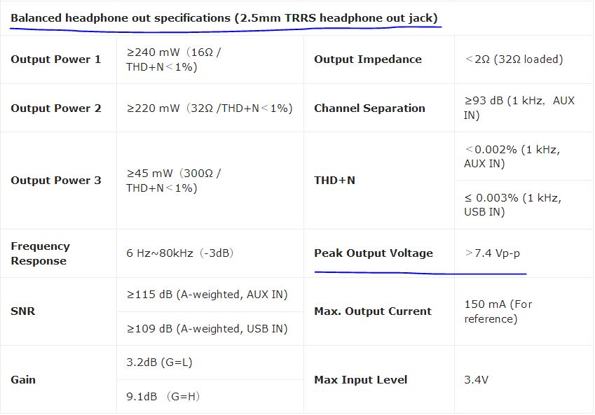

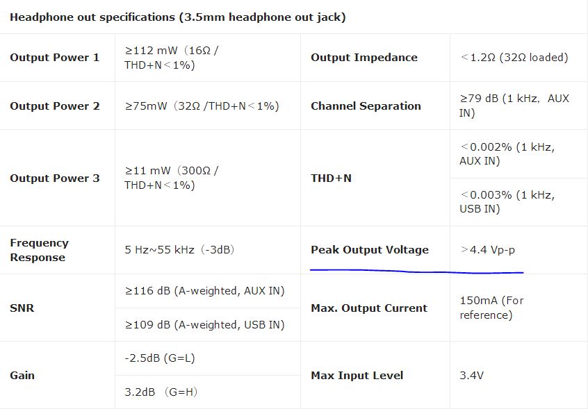

Dear All,
Sorry I am asking same question again and again in other forums.
Can I use balanced out put or unbalanced output of headphone DAC.
Is the output from headphone DAC sufficient for MOFO ?.
Please let me know if it works I will build this.
I will listen low to mid volumes. I am using 20W 7.5 ohm CHR-70 (3rd-gen)speakers.
Thank you.

The normal MoFo is single ended. So unbalanced. If you would take the unbalanced output of your DAC, you have a 4.4Vpp max. That is equal to about 1.5 VRMS or 300 mW. That is not much.
I have a Allo Boss DAC that is capable of 2.1 VRMS (500 mW if used with the MoFo). It is good enough for normal volumes with my 88dB speakers. But I'm running it close to its maximum. So I really prefer a preamp.
In theory it might be possible to use the balanced output (and connect the minus to the earth). But this is only possible if both channels of the DAC are completely separated. I doubt if this is the case. I wouldn't do it.
You might consider a step-up transformer. If you can get one with a 1:4 ratio or something, that might work. You will have a really high capacitance so a low impedance at the input. But your headphone amp will have no problems with this. You could even drive this transformer balanced. :cool:
