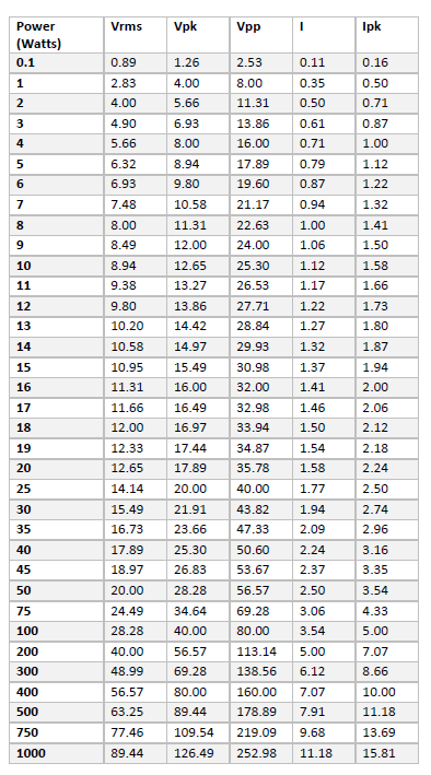

The normal MoFo is single ended. So unbalanced. If you would take the unbalanced output of your DAC, you have a 4.4Vpp max. That is equal to about 1.5 VRMS or 300 mW. That is not much.
I have a Allo Boss DAC that is capable of 2.1 VRMS (500 mW if used with the MoFo). It is good enough for normal volumes with my 88dB speakers. But I'm running it close to its maximum. So I really prefer a preamp.
In theory it might be possible to use the balanced output (and connect the minus to the earth). But this is only possible if both channels of the DAC are completely separated. I doubt if this is the case. I wouldn't do it.
You might consider a step-up transformer. If you can get one with a 1:4 ratio or something, that might work. You will have a really high capacitance so a low impedance at the input. But your headphone amp will have no problems with this. You could even drive this transformer balanced. 😎

ok little slow here
what is this?
looks like output power vs voltage in?
8 Ohms
what is this?
what is this?
Wise guy mode on:
This table shows how many volts you need for a certain amount of Watts.
P = V * I
V = I * R
with Vpp = 2.8 * Vrms and Vp = 1.4 * Vrms. That 1.4 is the sqrt of 2.
And because this amp is unity gain (output voltage is input voltage), you also know how many volts your preamp should deliver....
Wise guy mode off. 🙂
