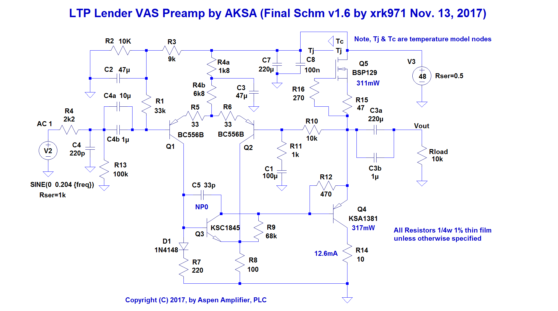

Is the 1.5% THD typical of a resistive current sink SE Class A amp? For my headphone amps, I do same thing and distortion is typically in the 0.1% or less but then it's 70mA bias and 120ohm loads.
The load impedance and the power you're putting into it (obviously) affect THD in a significant way. Plus, your headphone amp isn't a pure follower, is it?
It's not a headphone amp - it's a preamp designed to drive higher impedance loads like power amp input stages. Schematic here:
As far as load I am giving it standard 8ohms and 2.83vrms - standard setup for testing amps at 1watt with 8ohm speakers.

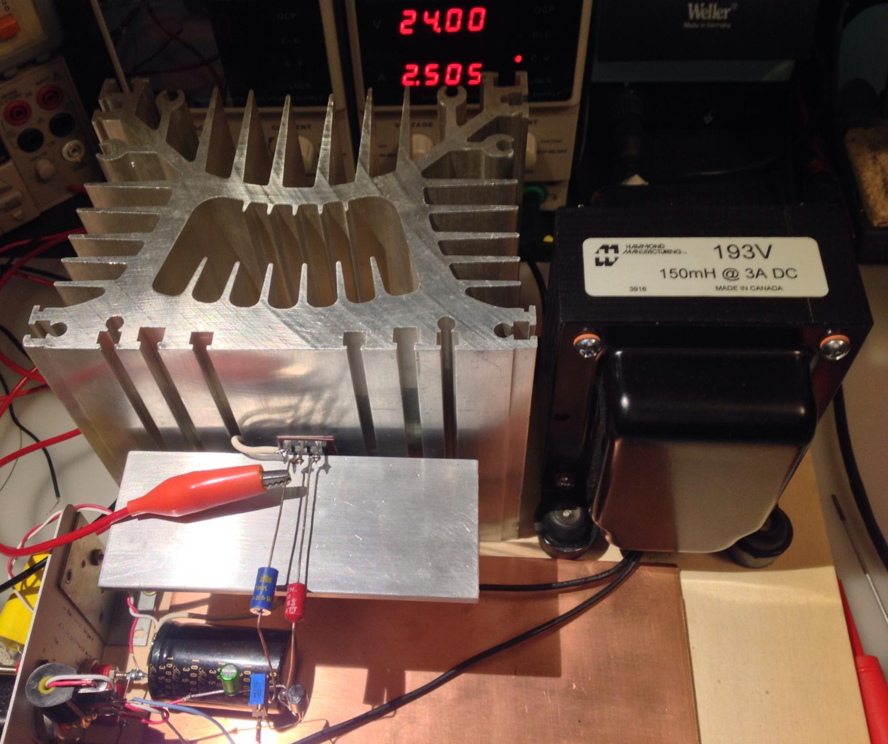

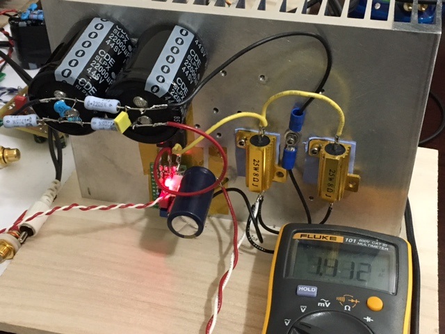

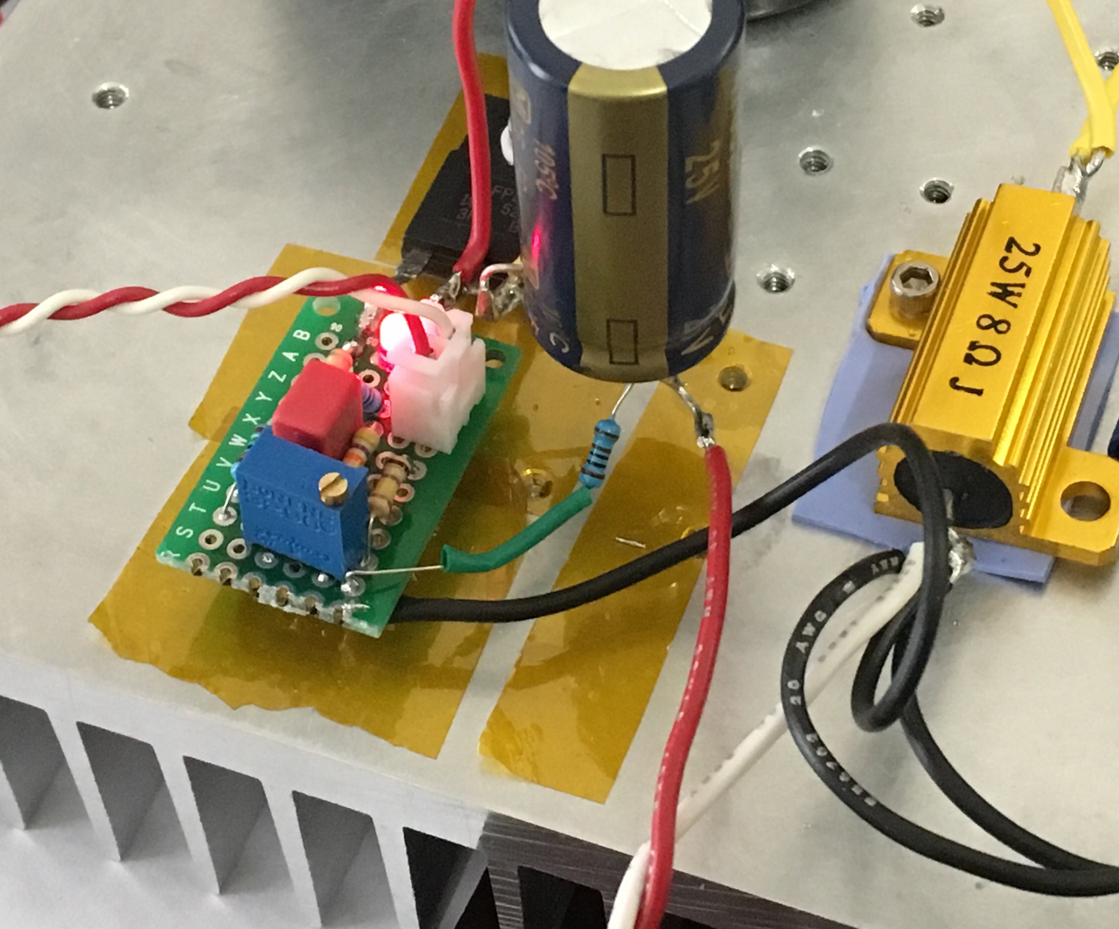

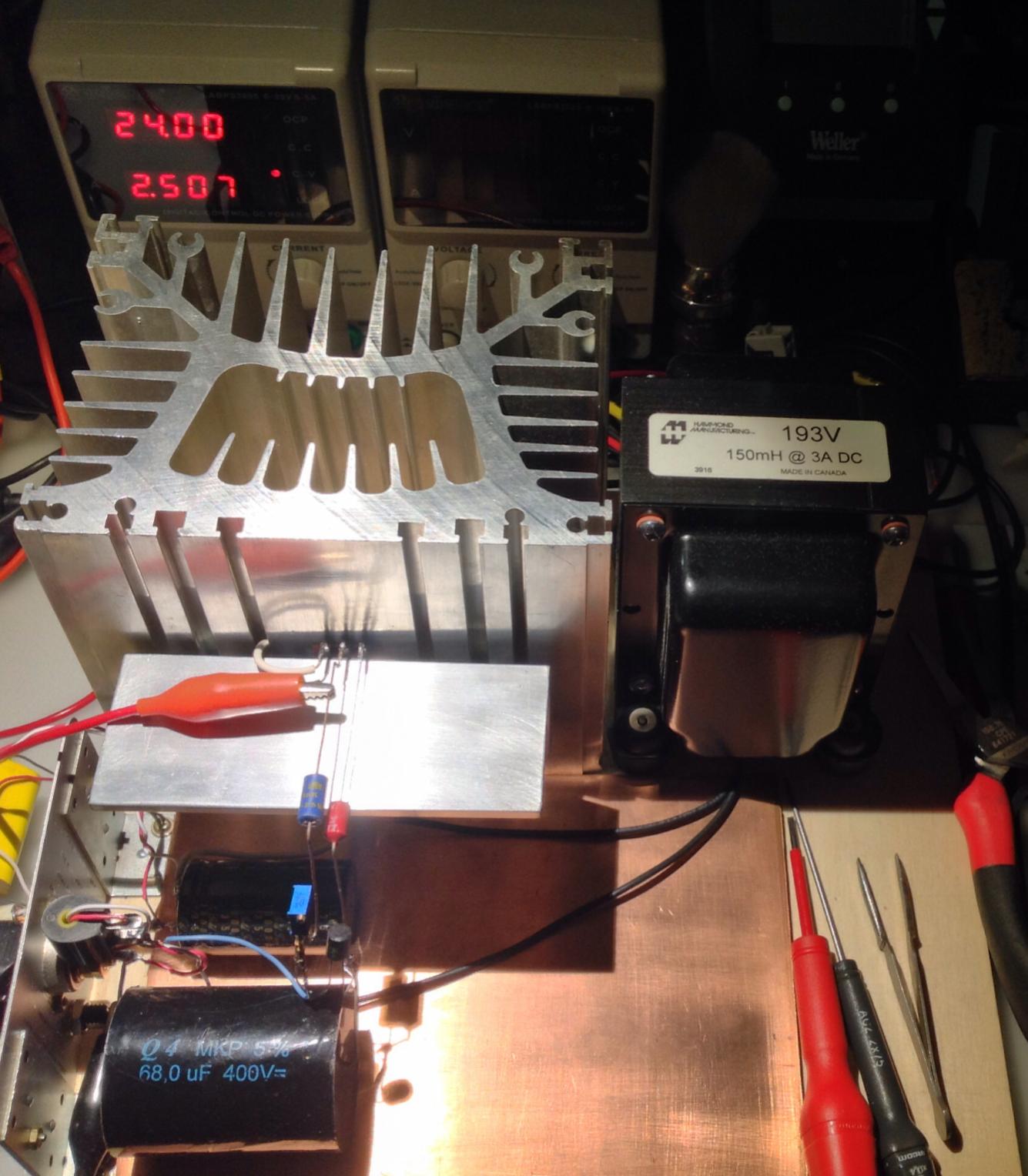

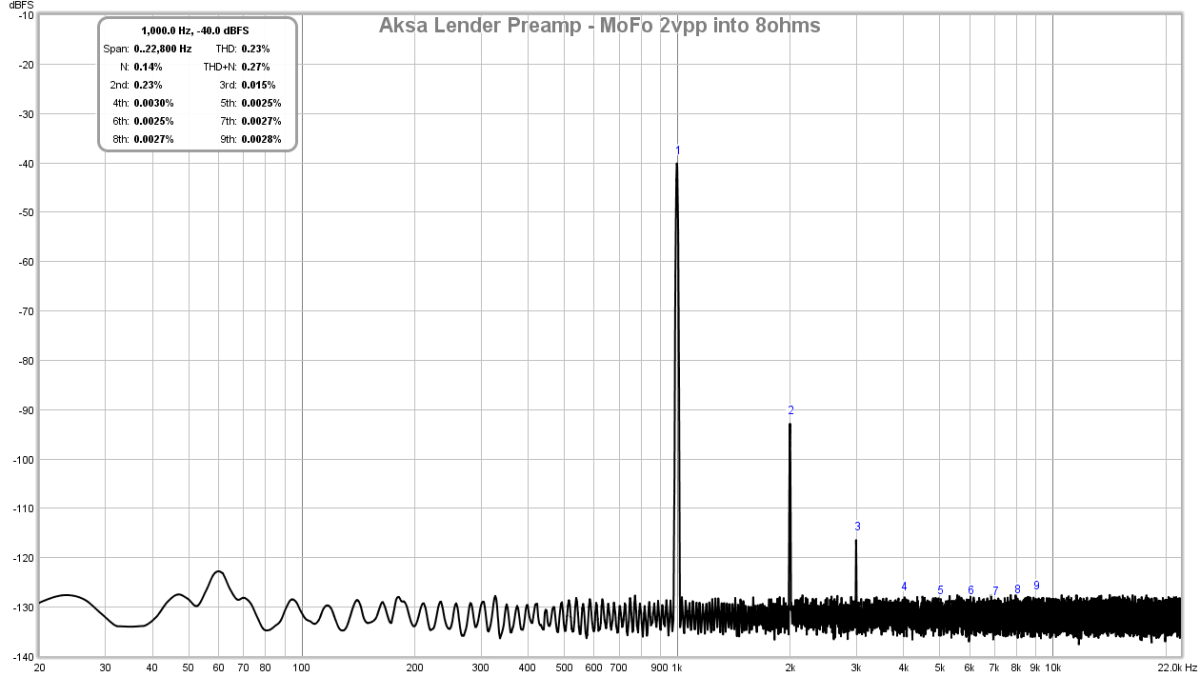

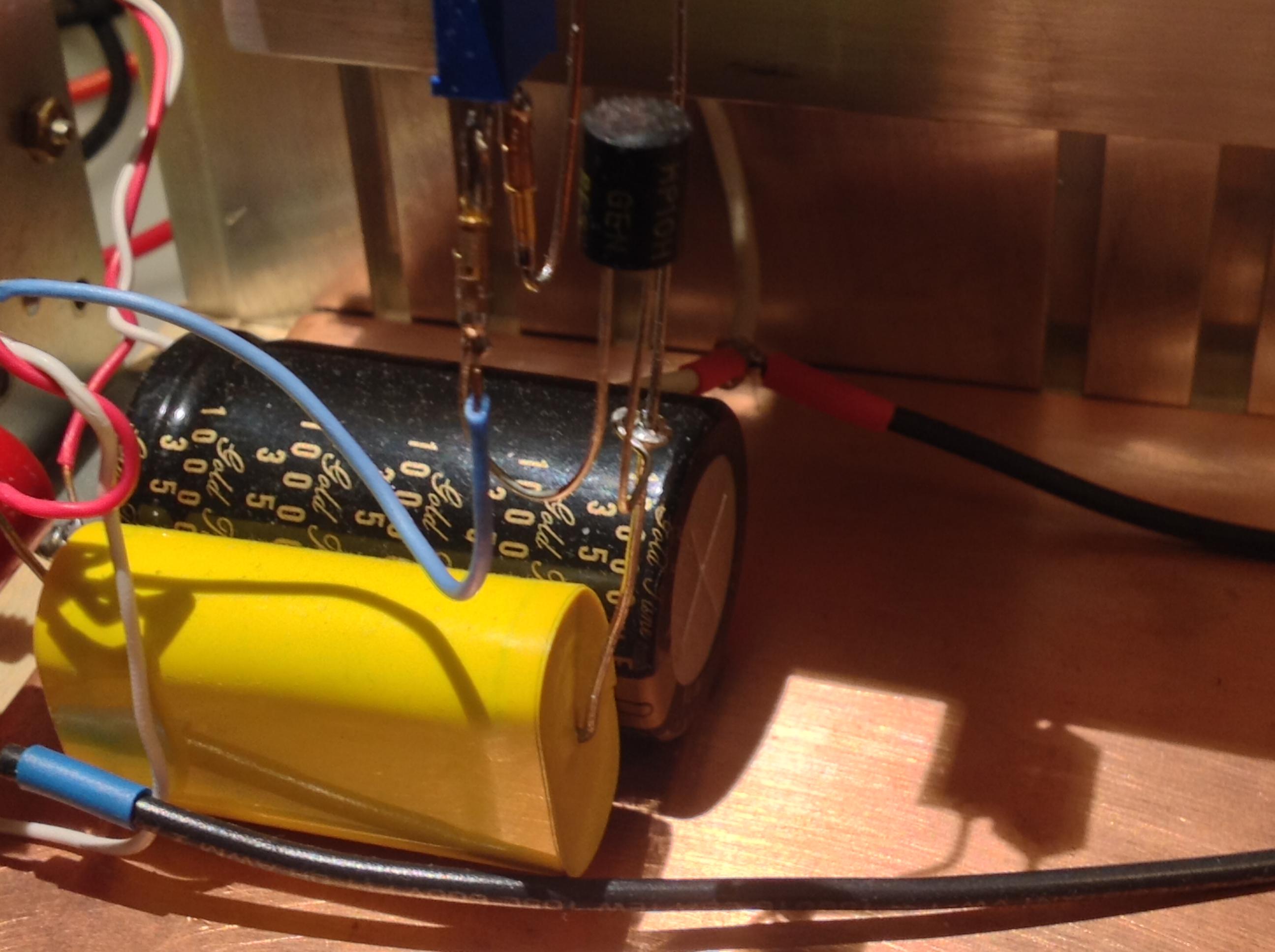

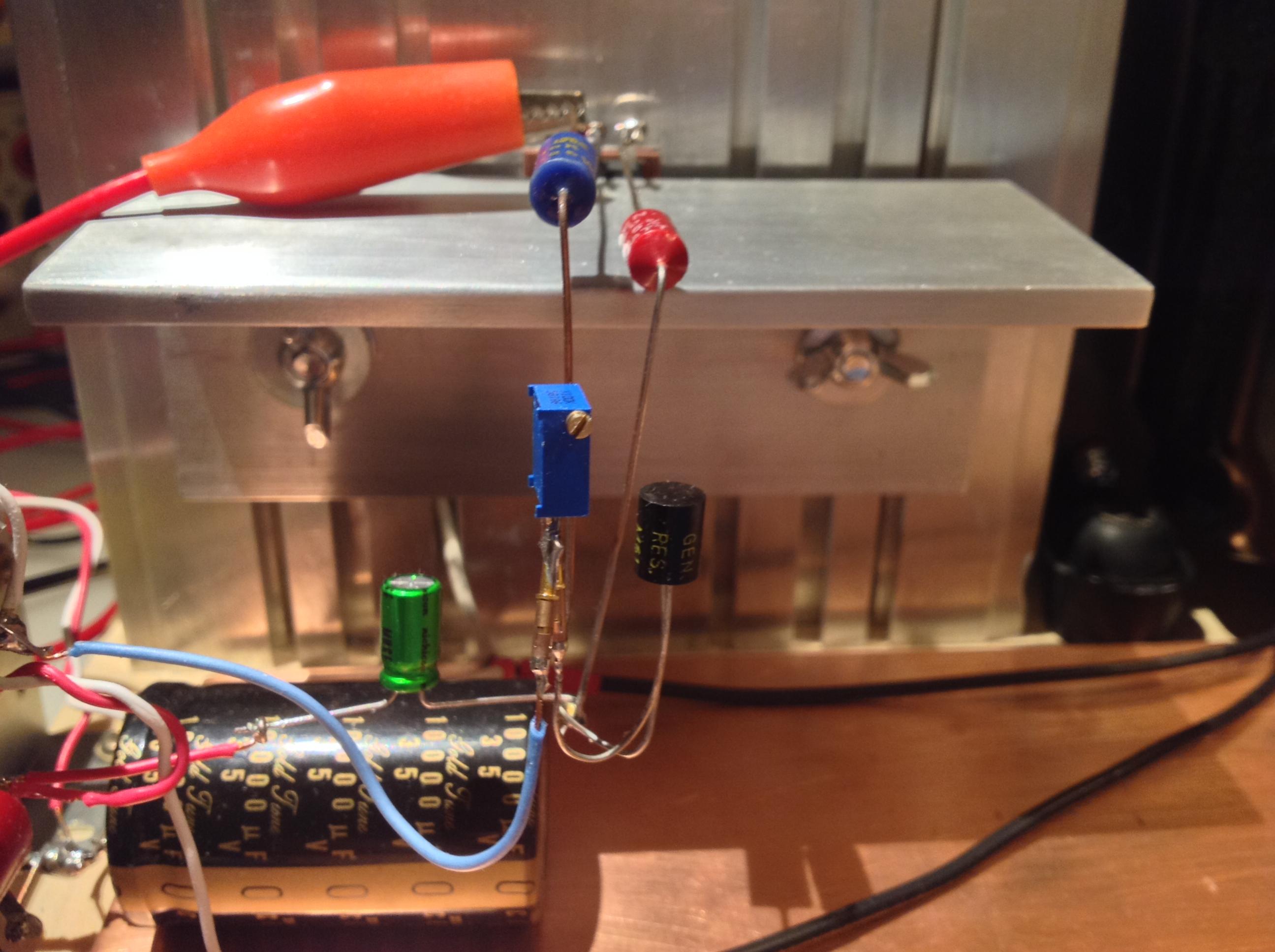

So I hooked up my Fluke 101 to the output of the MoFo in mV scale. It read 0.0mV noise with no input (conformed by FFT). I thought to myself this is a really quiet amp, even when connected to basic 24v SMPS and a simple CRCRC. What would it sound like with headphones? I connected my OB-1's while the 8ohm dummy load was still connected, to hear what the dummy load "hears". Well 2.83vrms is way too loud so I backed it off to a loud but pleasant and clearly great sounding level. Very nice - like a great tube amp. Deep deep powerful bass, and smooth silky mids and delicate but articulate highs. No sibillance, No fatigue. Forgot to mention that I added a 10uF 35v Silmic II at the wiper of the pot to smooth the voltage reference out. I think that helps a lot. Anyhow, it sounds gorgeous, and made me wonder if the FFT now looks better, because my ears don't lie. It was a beautiful sound like the voice of angels.
Here is 2vpp into 8ohms, about as loud as I would listen with headphones to sound comfortable, THD is 0.23% and mostly H2:

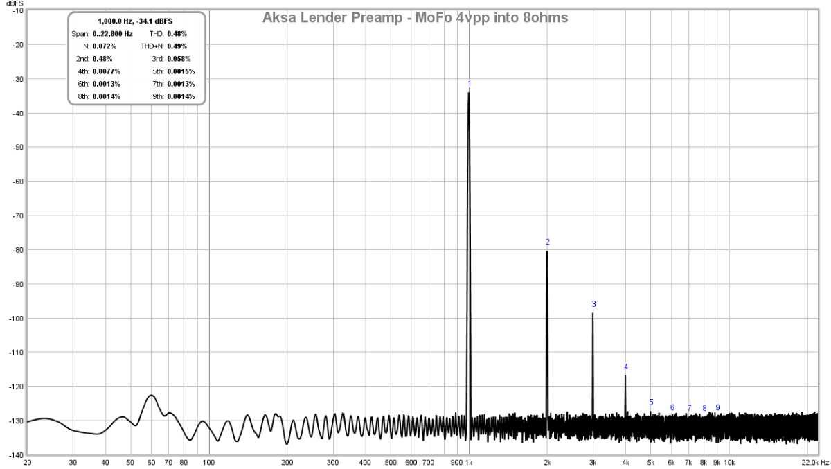

And here is the FFT for 1.41vrms or 4vpp into 8ohms, now I see why it sounds great. Looks like a SET tube amp. 🙂 Again, 1.9 amps bias current through 50w capable 4ohm current sink:
So, in short, this can be an excellent headphone amp as well.
This is the setup, now standing up to help cool the 45w of dissipation.

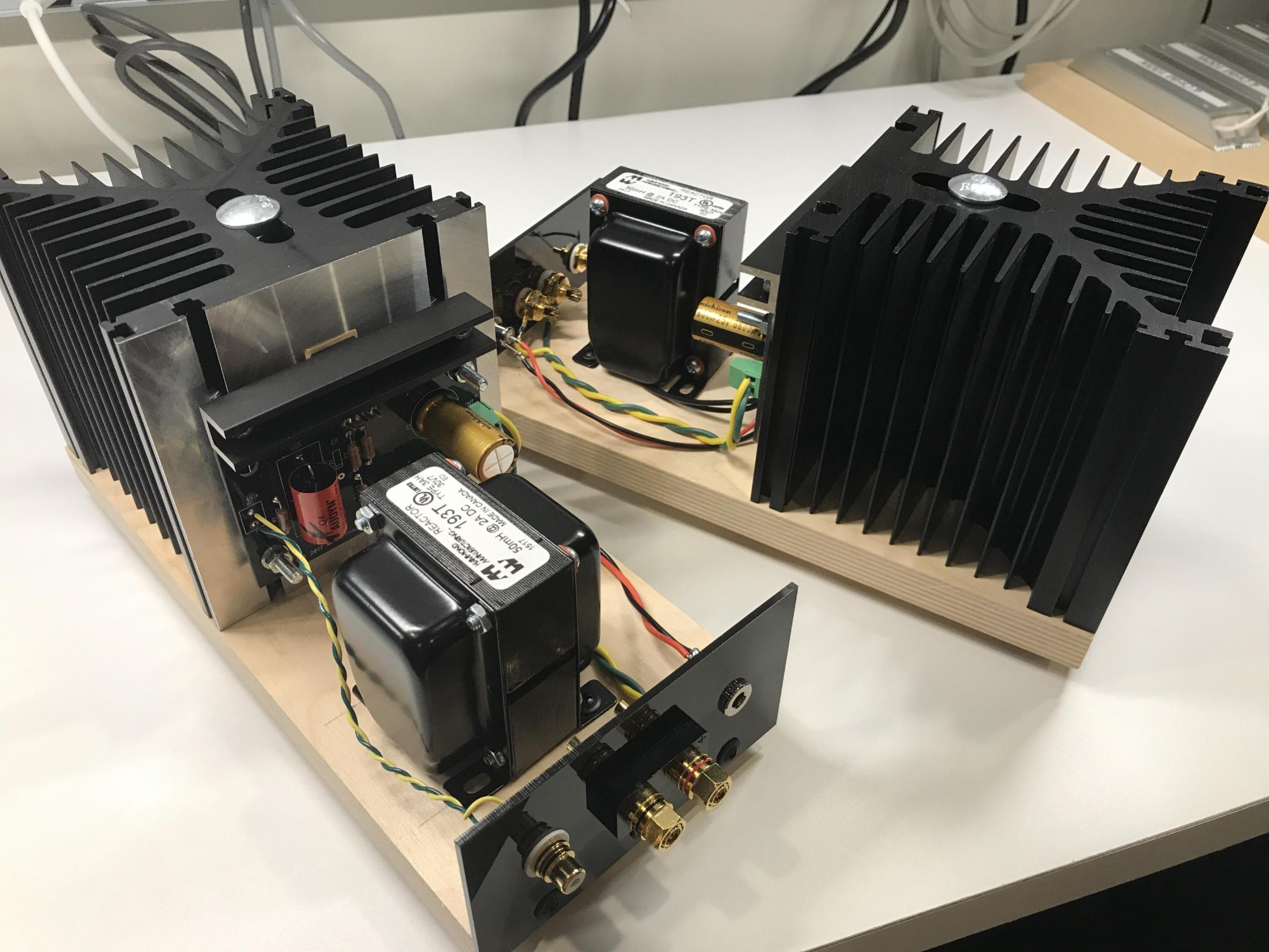

MoFo music sessions & solid state preamp
Hello Sir Lawrence
Update :
Recently changed triode preamp to solid state and try new configuration with MoFo.
Surprise only one tube stage of the CD player is sufficient.
The sound is focused and lively without much "warm colorations " of the triode vacuum tube preamp stage.
I do try huge 68 UF MKP at input and 10 of bipolar Nichicon " Muse " series.
Well, two sounds great and Muse are audio grade and cheap ~ 0.50 $ from my memory at Mouser, etc.
Conclusion: build MoFo with quality components and taste all goodness of class A amplification. The Dude is cool

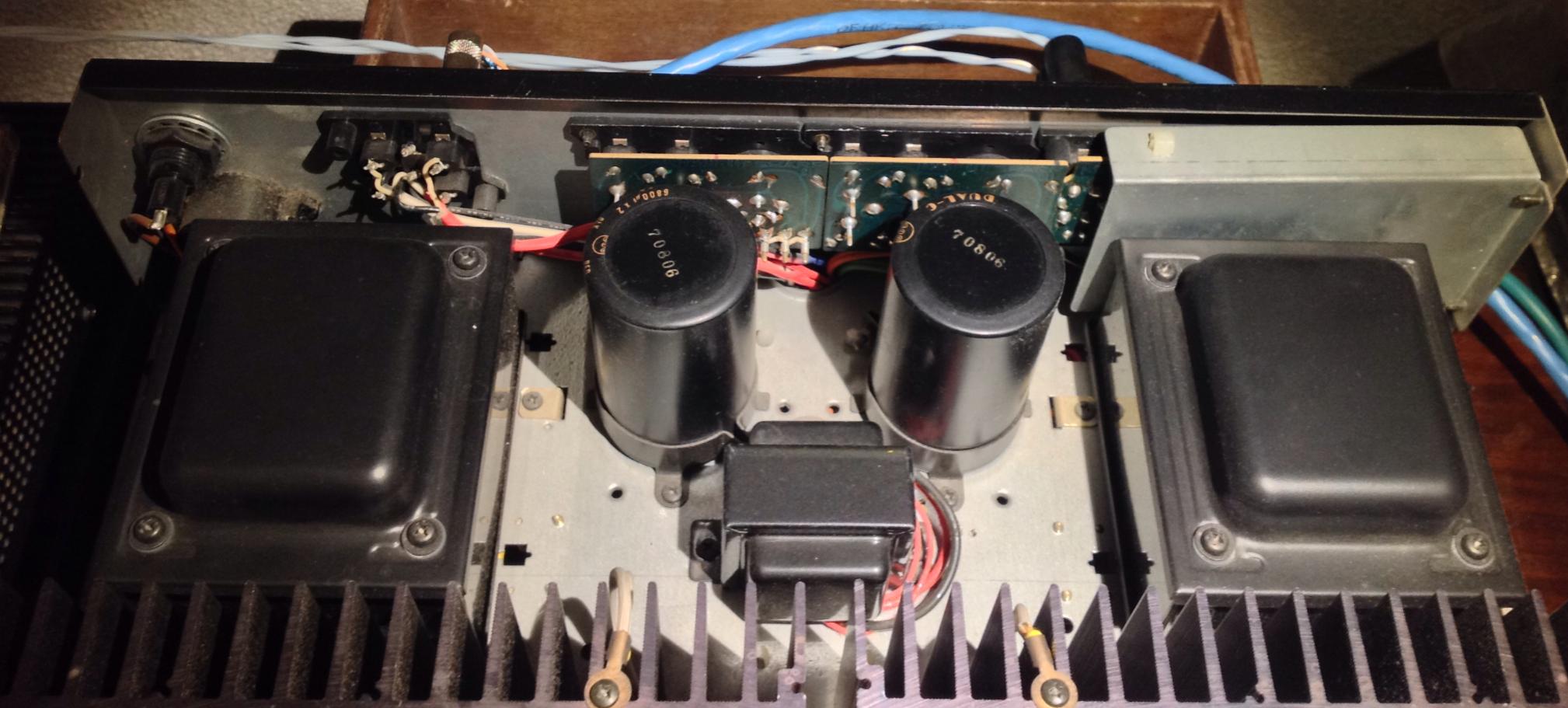

Nope, please look again at the photos You have all stages.

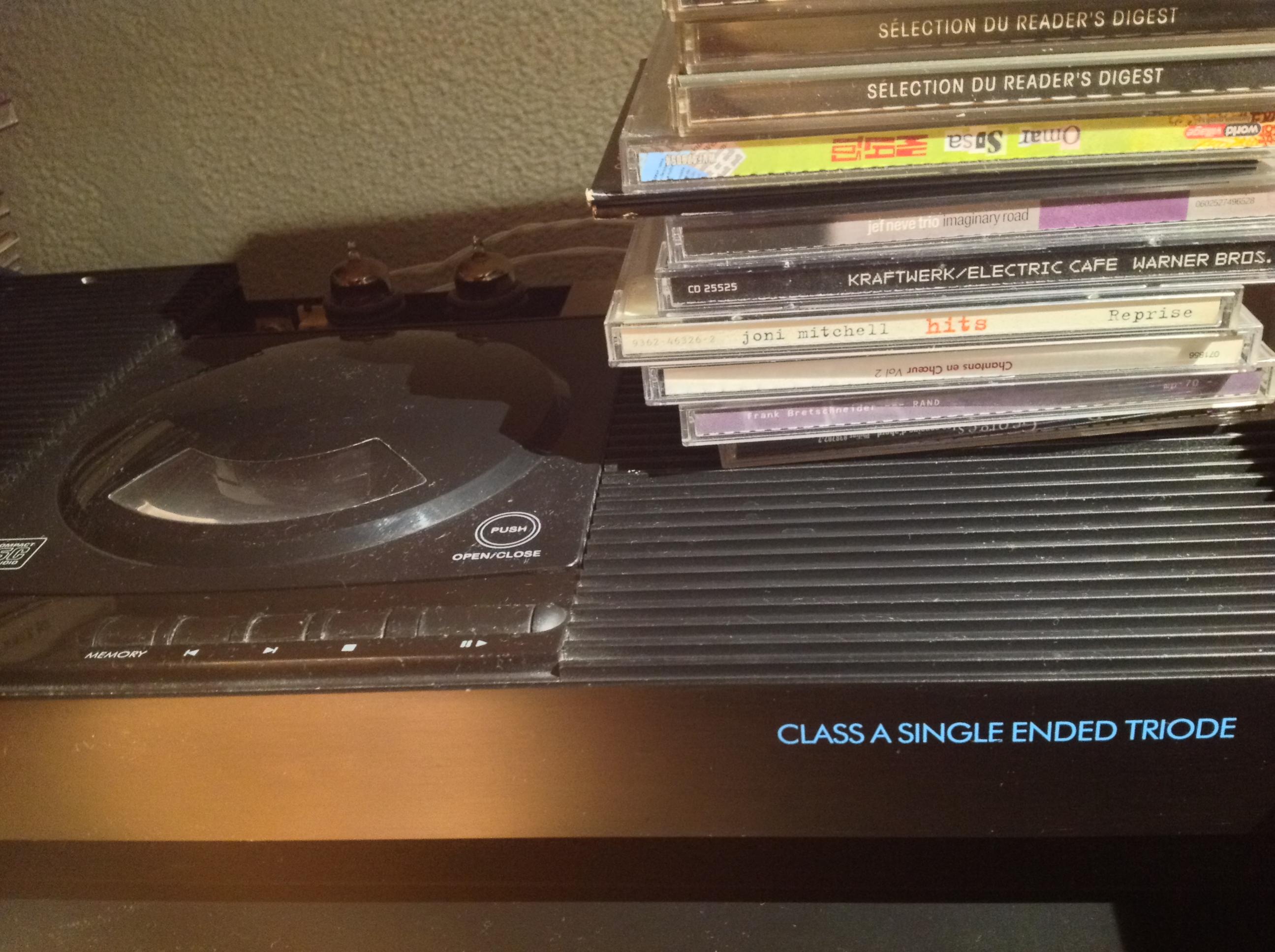

Actual configuration is:
1 |CD player with class A triode stage
2| preamplifier is solid state (no more triode now)
3 |amplifier Big MoFo 22watts PSU 24V | 2.5 A bias
4 |12" wide range drivers speakers
I do experiment with CD player directly connected to passive pream AVC
autoformer volume control and MoFo, but musicaly was "short" feeling.
Adequate impedance and gain solid state preamplifier who match with MoFo bring instant fullness in bass, medium, highs.
Control nicely large 98 dB drivers with his 40 damping factor. Oh yeah
