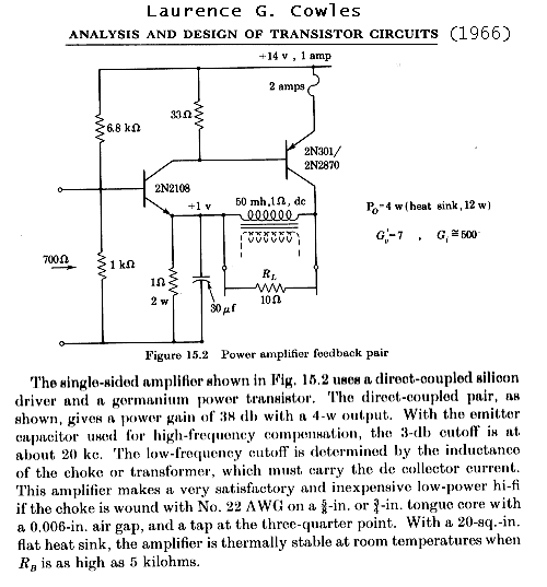

My first electronics book had a class A amp in it with an inductor for a current source. I thought it was ancient at the time. 🙂
Here's one.
Just remembered the book- Electronics the Easy Way, 1988 by Rex Miller.
Barron's Electronics The Easy Way by Rex Miller

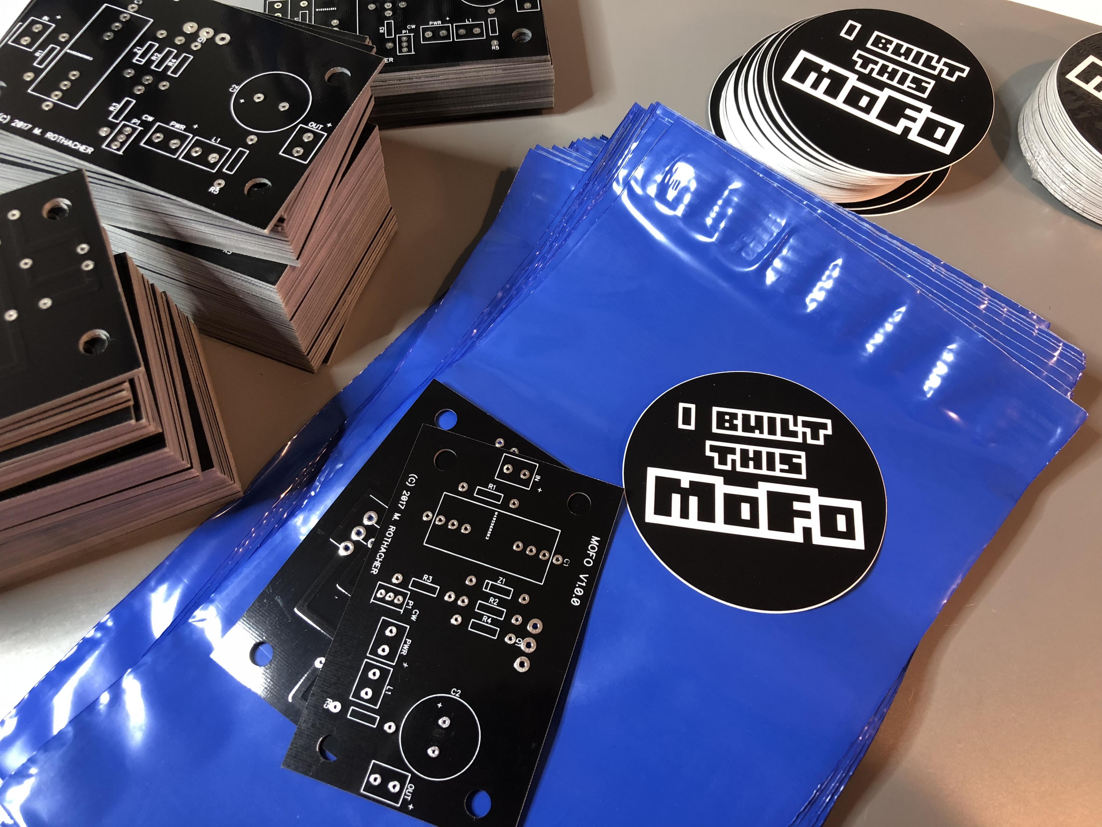

Family coming in for Thanksgiving next week. Good chance to put them to work bagging circuit boards. 🙂

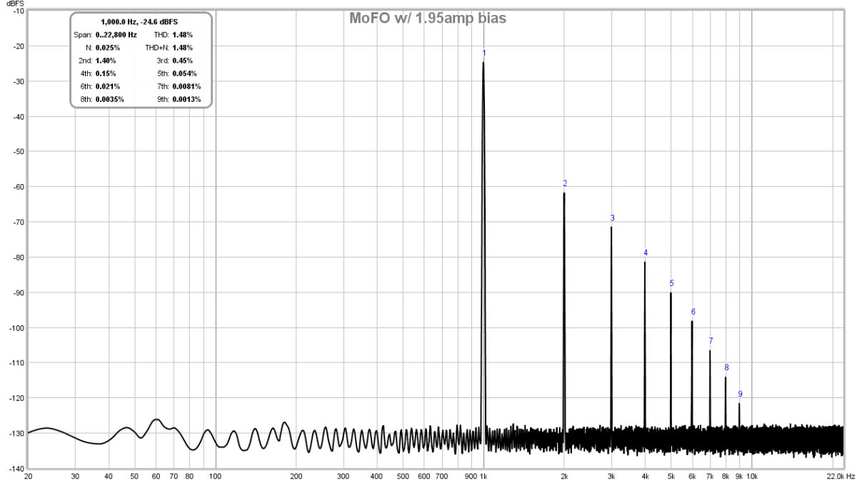

While waiting for the inductors to show up, I built a MoFo with a pair of 25w 8ohm power resistors in parallel for 4ohm load. I really wanted to test out my new Aksa Lender preamp so hooked that up and running on my XKi W5-2143 speaker now. Power is 24v SMPS and running 1.95amp bias at moment. Sounds very nice 😀

I did a quick measurement of the amp and distortion seems a bit high for 2.83vrms into 8ohms (1.95amp bias):
Am I doing something wrong or this is what is to be expected with a resistive load as a "CCS"?
The inductor load is not a CCS. If you simply substitute a a resistor or CCS, it's a different amp, so the comparison is apples to oranges.
