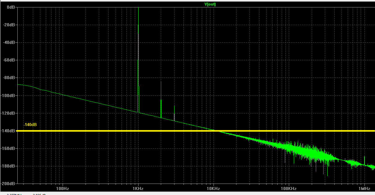

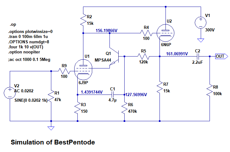

This discussion is great, but it's gone way over my head. I can't do the math to visualize what the BJT is doing between g2 and a of the pentode, but I can throw everything into SPICE and see what the voltages etc. look like.
I took F. Blohbaum's schematic from his ETF presentation and adapted it to tube models I know how to work with, namely a 6J9P model courtesy of Wayne Clay, and Adrian Immler's i4 6N6P model (for the cathode follower/output buffer). I've attached the schematic.
The results are pretty astonishing. I get 70X gain, extremely low noise, and extremely low THD (only 0.006% at 1V RMS output 1kHz, which looks far 2G2BT, if you ask me).
I'll also attach the .asc so Koonw can have a go at it, since he's better at LTspice than I am. Koonw, what do you see?
  • BestPentode+CF_00.asc

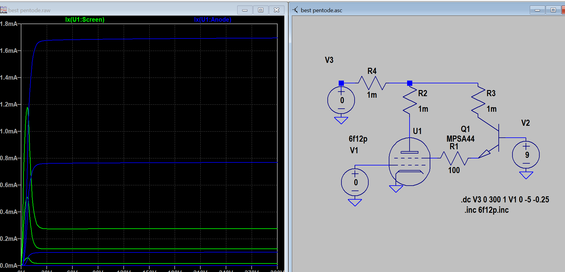

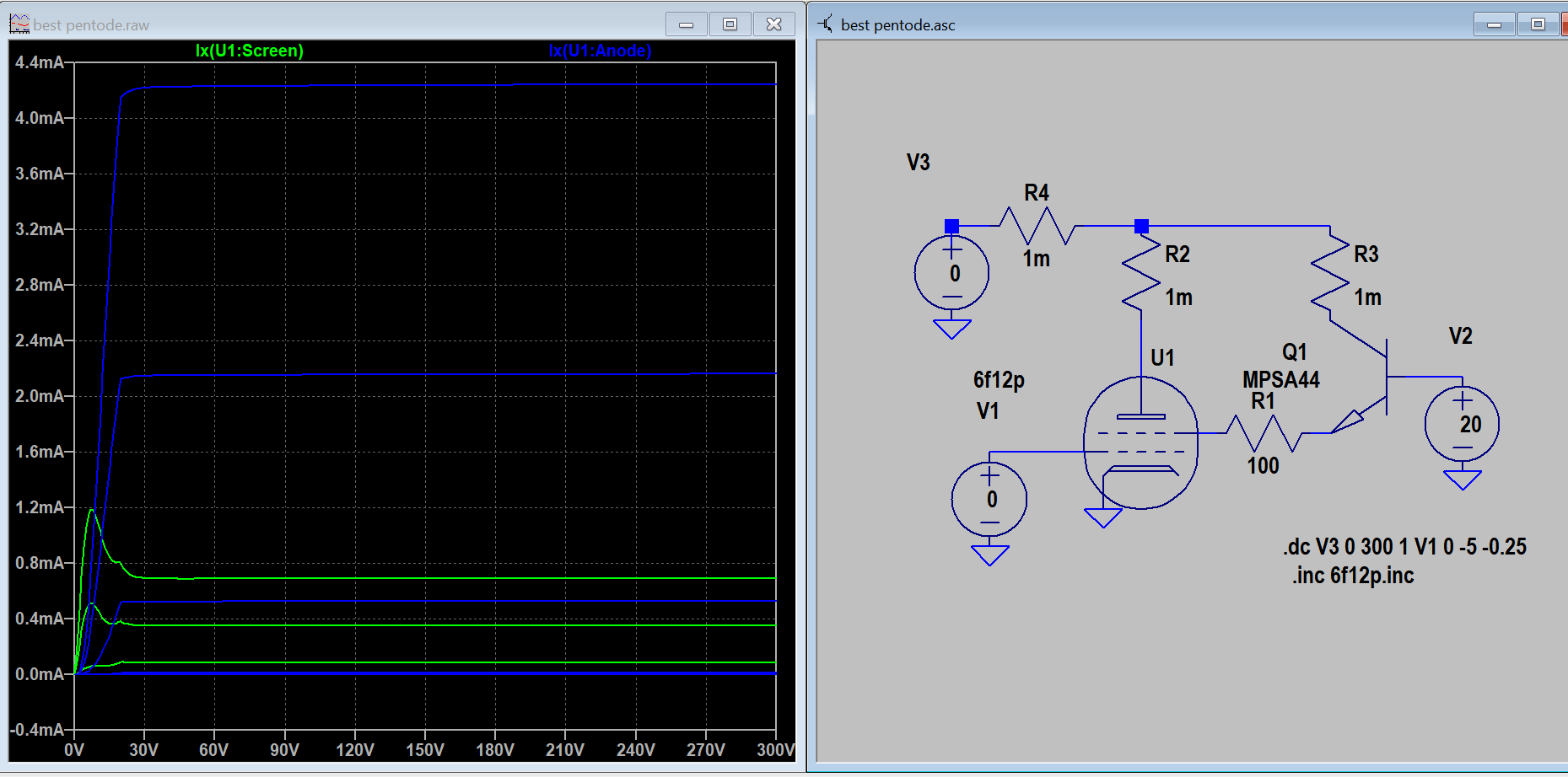

I sim the pseudo pentode, the gain seem to be doubled by looking at the pentode and screen spacing, the zero bias Ia drops by half. The zero bias Ia can reach the same as original when transistor is biased at 20V but the entire curves are shifted right by 20V, which is the behavior of pseudo pentode. I wouldn't call it "best" as it's pseudo or pretend. It maybe good when biased low for small signal, but note sure for larger signal where the Ia appears restricted.
The LTspice models I used in post 95's .asc
If you imagine it as a pentode of very very high transconductance and ignore base current (quite reasonable at beta of 100 or whatever) then the BJT becomes an active conveyor of current, with very low impedance at the G2 end and very high impedance at the anode end. Essentially all of G2 current is restored to the original cathode current stream, eliminating partition noise.
Gain of 70 implies a valve transconductance of 15.5mA/V, which sounds a little high for just under 10mA cathode current, but possible. Best noise performance will depend on a balance between Johnson/Nyquist/thermal noise, which improves with higher current, and excess (1/f) noise, which degrades with higher current. A good phono stage's noise can be dominated by noise from the source plus 47K load impedance, but takes some effort, and excess noise is a wild card by definition. If you don't need the 37dB gain, you might want to try somewhat lower cathode current.
