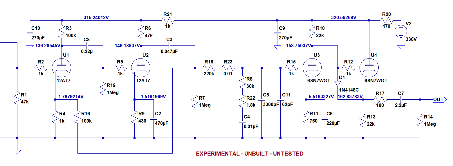

Here's a circuit that uses two cathode followers in series at the output with second half of the split RIAA network in between.
96mA per channel of plate current for a phono preamp. Well, that would require a power transformer capable of delivering 200mA plate current for a stereo version, which is about the same as would be required for a stereo PP EL84 power amp. Seems a bit excessive, but I get your point. Yes, it's possible. But is it advisable?
Hi Chris
If you're asking me to nitpick, I'd start with C1. It complicates your calculations some to not have C1, but that extra subsonic zero is a liability in a phono stage, whose input already contains large amounts of subsonic garbage from record irregularities emphasized by the cartridge compliance x tonearm effective moving mass fundamental resonance.
I could dispense with C1, but then wouldn't there be some DC on the RIAA network? Would that DC voltage carry some signal from the cathode of U1 that could interact with the filter in ways we don't want?
I have some 7.2uF metalized polypropylene capacitors I could put there. That would put the zero at 0.325Hz. That should be low enough not to interact in adverse ways at subsonic frequencies, no?
Or are you more concerned with the load 68k presents to the U2 6SN7 plate (rp = 10k or thereabouts)?
Because your RIAA eq is such high impedance (minimum 200K Ohm including R7) R16 has quite a lot of latitude, but more is still more better. Something like a 12AX7 for the first stage would scale both R4 and R16 up by maybe doubled? and reduce issues of excess (1/f) noise and (likely) microphonics.
Perhaps 12AT7 would be a better compromise than 12AX7? I was thinking so because of the 12AT7's higher gm, lower rp, but still mu of 50 or so. It should be OK run with Ip of about 1.5mA to 2mA. I've attached a schematic to show what that might look like...
However, this is just a quick thought experiment. I'd use something like a 6DJ8 for the first two stages, or even a 6GK5 coupled to a 6N6P or 5687 (lots of plate current, mu of 16 to 20). Then perhaps make the RIAA network a lower impedance version (lower resistor/higher capacitor values). Or is it just as well to keep it as is, with 30k+1.8k for R8+R22, and adjust the value of R18+R23 as needed?
R17 should be mounted very close to the socket pin, to help minimize parasitics with its capacitive load. All looks good to me.
Understood, thanks. R17 is sort of a cathode 'stopper' resistor, so it needs to be very close to the cathode pin, like a grid stopper resistor would be to its grid pin.

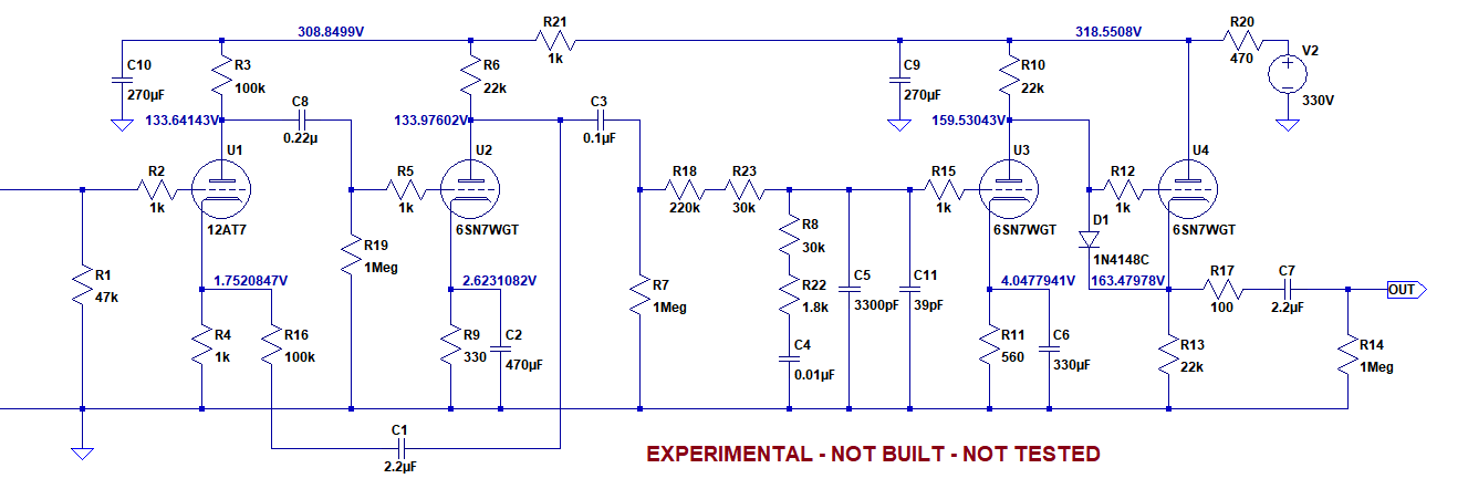

Second try --
[12AT7 - 12AT7] -> RIAA -> [6SN7 -> 6SN7-CF]
|-----NFB------|
The second 12AT7 (U2) has Ip of 3.5mA. Is that enough plate current to drive the NFB loop and the RIAA EQ?
It's so easy to get the EQ flat with this topology...
DC voltage ends at C3, so not understanding your concerns with RIAA interaction? My concerns with C1 are partly technical (see Shure's noise data here: Stereo Lab - Maximum recorded velocities on gramophone records ) and partly aesthetic (if a circuit element degrades performance, could be removed, then should be removed, yada yada).
It's trickier to design, with very significant (1.3mA as shown!) DC current added to cathode current through R4. A little easier with a 0.5mA cathode current valve like 12AX7, 6SL7, etc. But you could offset the pain some by direct coupling U1 to U2. Then the heavy DC feedback could be a stabilizing force for good. Might be tough to squeeze into a 310VDC B+ supply though.
Edit: this doesn't apply to your circuit of post #64.
Please don't let my prejudices deter you from your excellent design work. I would do some things differently, but I'm old and largely set in my ways.
All the best fortune,
Chris

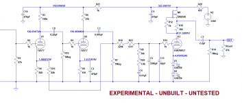

Those last two simulations (posts 63 and 64) were basically for proving the concept to myself. I think I'm sold. I've been thinking about how to refine the idea.
It seems that I want to have less current in the feedback loop rather than more, correct? Do I want >7mA of plate current in U2 to drive the RIAA network and the feedback loop, or is the roughly 3.5mA Ip for U2 as shown in post 64 a better way to go? I only understand negative feedback mechanisms on a fairly superficial level. My assumption is that more plate current through U2 will allow that stage to drive its load with greater ease, and not run into slew limiting or other nasties.
I could use less NFB around U1 and U2, allowing for more gain, and use less gain for U3. Perhaps use a half a 5687 or 6N6P, run it at Ip = 15mA with a 10k plate load resistor, with A = 12 or so. That should have a low enough output impedance of about 2k (maybe less), and hopefully still low enough THD.
I like the idea of having a high gm triode as the input tube, but those all require more plate current than 12AT7. I was thinking of something like a 5842 or 6GK5, possibly into a half a 5687 or 6N6P.
Now that we know what the topology would look like, I can imagine all sorts of variations on the basic theme.

One of the cool things about this topology is that the feedback pair will have very low THD, so the third stage is where all the distortion will happen. Keep that stage clean and the whole preamp will be very clean. LTspice predicts the version in post 64 will have THD of about 0.02% with 5mV RMS in (1kHz). Gain looks to be about 41dB in to out at 1kHz.

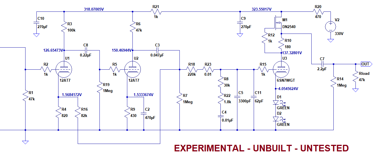

Thinking about it some more... Thinking about how to make the 3rd stage super-clean and with low output impedance, I hit upon the idea of using a 6SN7 (a very clean triode) in a mu follower with a depletion mode MOSFET as its plate load, and take the output from the source of the MOSFET (a quasi-source follower).
Yes, it will have low impedance, but no it will not be a super-strong line driver. But that's OK. It's a phono preamp. It will drive a short length of cable into a selector switch and volume control, or into a line preamp. It won't be driving a power tube or anything like that. Right?
In LTspice, the attached circuit yields 45dB gain at 1kHz, and the THD with 5mV RMS into a 47k ohm load is minuscule, just 0.0055%. THD at that level goes up to 0.01% into a 10k ohm load.
This confirms my suspicion that the U1-U2 feedback pair is very, very clean, and all the THD will come from that third stage.
I don't know. This looks really good to me. Maybe it needs a follower on the output.
Any nits to pick? I'm all ears...

The old rule of thumb for triode loading is that if your load's impedance is 4 or 5 times larger than the plate load resistor, you're fine and don't need to worry too much about it. This comes from looking at typical characteristic curves for typical audio triodes - the less the load line is skewed clockwise, the better the linearity, but a smallish rotation isn't a problem.
Slew limiting is an idea from opamps, a measure of performance under complete clipping. Drive the input with a very big zero rise time edge and count how long it takes the output to get up to some percentage of max. This tests the same mechanism that causes distortion to increase as frequency increases ("filling up all the little capacitors" as 1Audio put it on his Burning Amp video, very very highly recommended) but is not exactly the same thing. I'd suggest that a better view would be the simpler one of effects on the loadline, conceptually correct, and more direct. Anyway, in your circuit, you're driving mostly resistors.
The third stage works at fairly similar gain, signal and impedance levels as the first pair, so could be a similar construction if you wanted to for some reason.
It (finally) occurs to me that feedback could be taken from both before and after C3, simplifying the juggling act. Also you can lose R7.
All good fortune,
Chris
Before C3? That would require another capacitor, like the C1 I used in post 63. Taking feedback from both before and after C3 would put the two in parallel? I guess I'm lost.

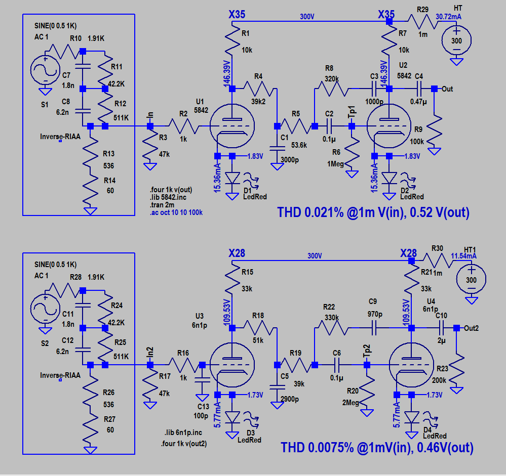

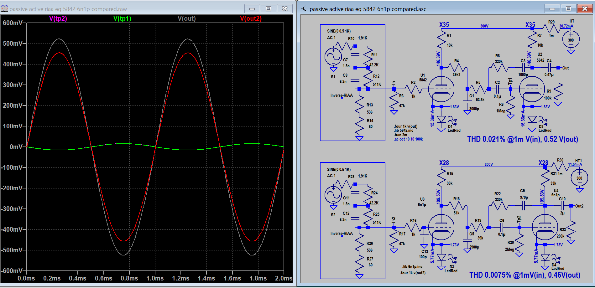

  • passive active riaa eq 5842 6n1p compared.asc

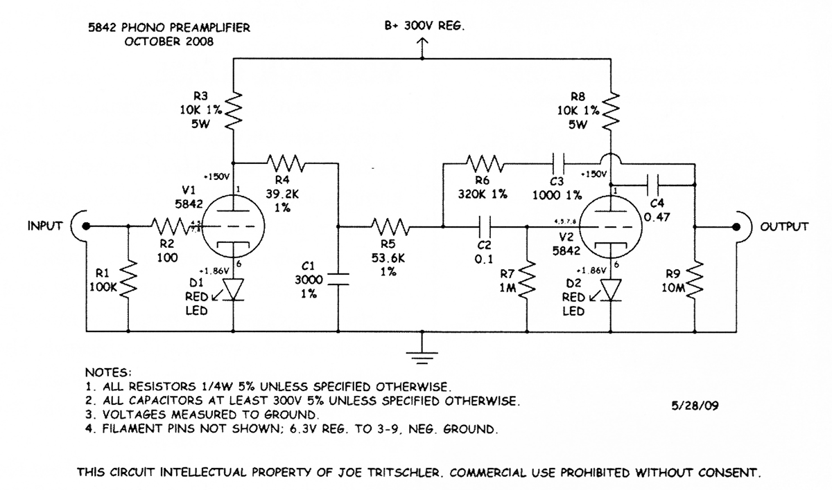

@Koonw
Thanks, I had just recently looked at that Borbely/Tritschler circuit. I forget who posted it...
The one criticism I have is that it does not address the problem of input capacitance. 5842 has moderately high mu (but nice high gm), but quite high Cin. That' a deal killer for me, I'm afraid. I'm finding that with the cartridges I use, the input tube's Cin has to be kept below 100pF.
I'm finding that you can get really super-low THD by keeping the gain down (why the 6N1P version has lower THD than the 5842 version). That's another problem for me, because I really do want a total preamp gain of 45dB, so that subjectively my records match the playback level I get from my DAC.
Otherwise, yes, that does look like a good circuit.

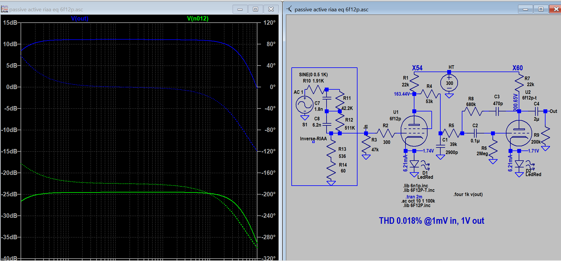

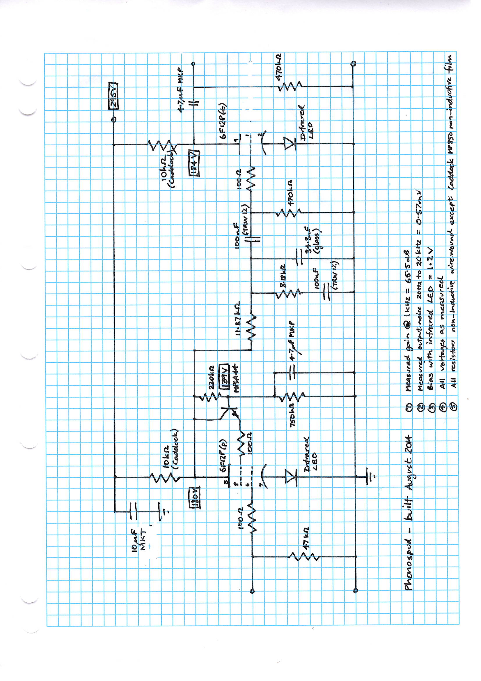

Re: BestPentode
I was thinking a 6F12P would be a good candidate, since it has a high gm RF pentode and frame grid high mu triode in one 9pin mini bottle. I did a search and found bondini's circuit using BestPentode > passive RIAA > Triode. kevinkr recommended adding a MOSFET source follower on the output. This could be re-jiggered to put half the EQ in a feedback loop around the output triode (anode follower-style).
Phonospud – sandy Muscovite Micro with a pentode first stage
557866d1467502986-phonospud-sandy-muscovite-micro-pentode-stage-epson001-jpg
I need to read more about the BestPentode. I don't understand it well enough to design my own, yet...
Disabled Account
Joined 2013
I thinking to remodel it with passive and active EQ, then no extra buffer is required as active portion has feedback to lower the output Z, right? Right now triode has 10k anode load, which can drive a lot of amps include solid state, but the gain needs to be reduced either by feedback or degeneration or just by a pot. The gain is X6 RCA riaa or 6V/1V.
Disabled Account
Joined 2013
I also think triode connected pentode has enough gain, maybe too much gain in pentode mode. What is the input capacitance due to Miller effect now? If Cg1-Cg2 is 1p, then Cmil=54x1=54p, right?
