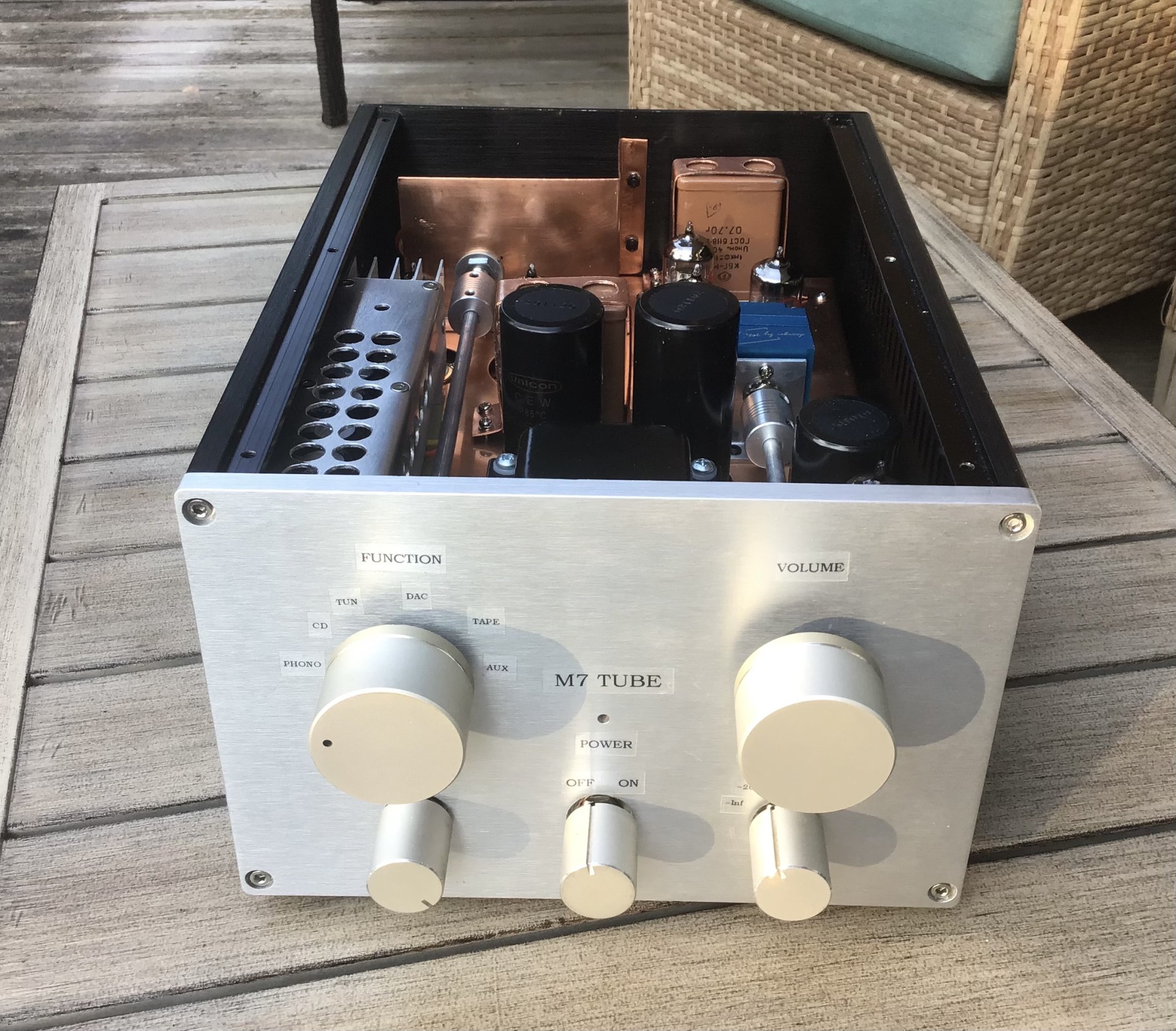

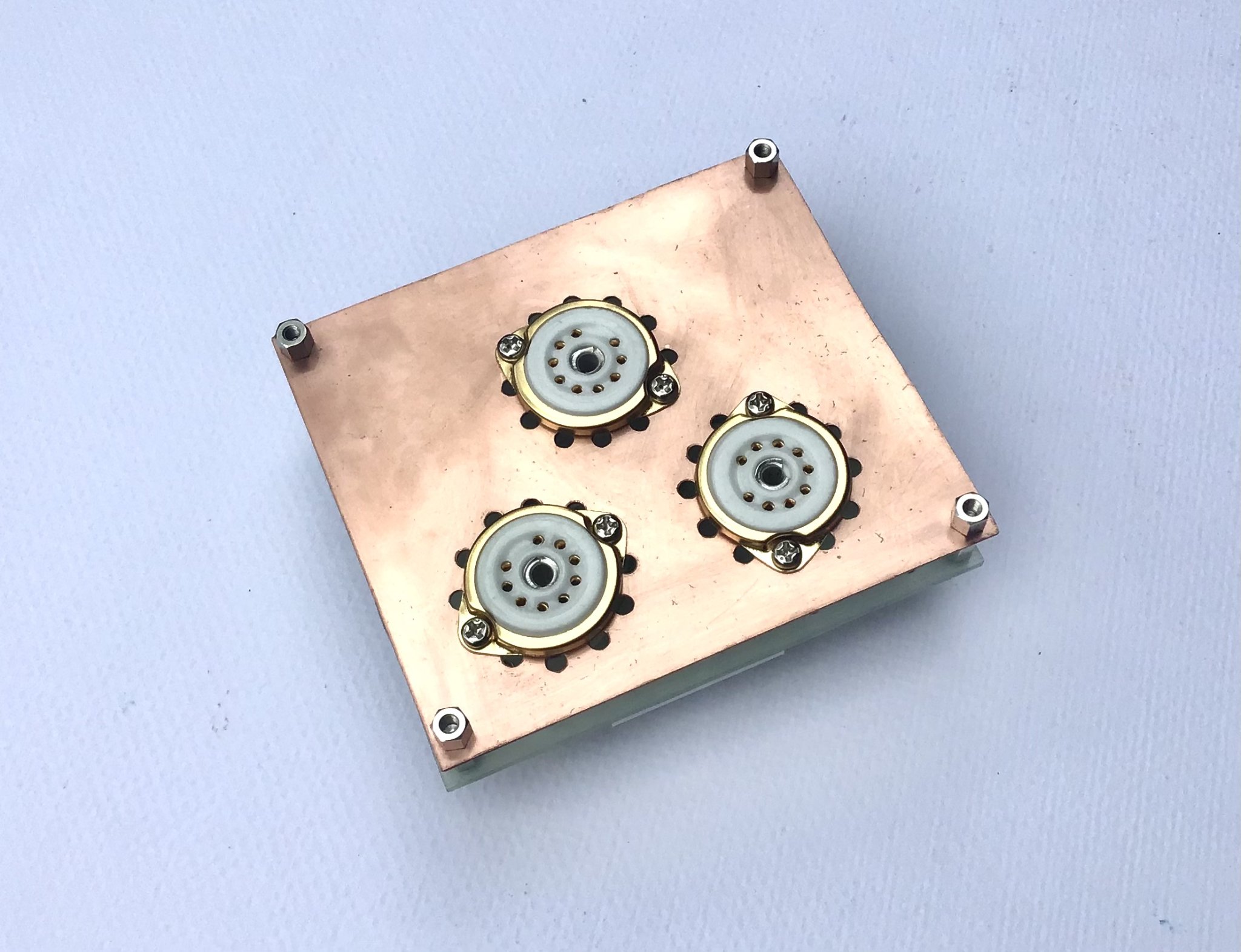

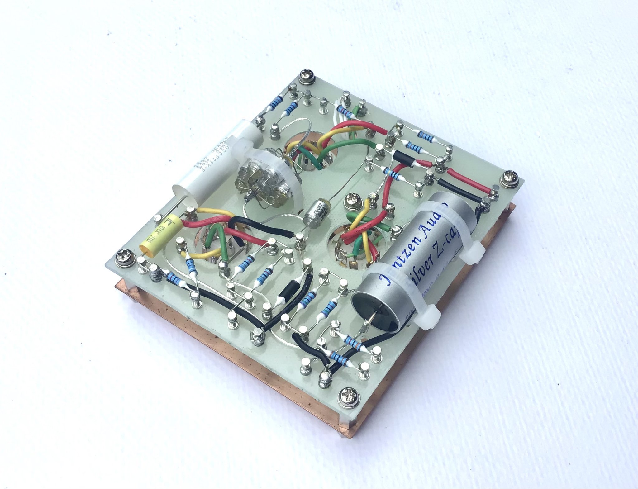

Now the final module is built. The Kondo stereo module sports a raft of silver caps. In my version, a mono module, I’ve used polystyrene caps in the RIAA and a Jantzen Silver Z-cap at the output.
My module remains untested. I should review the wiring carefully before I think of applying power to it. I expect it’ll take awhile.

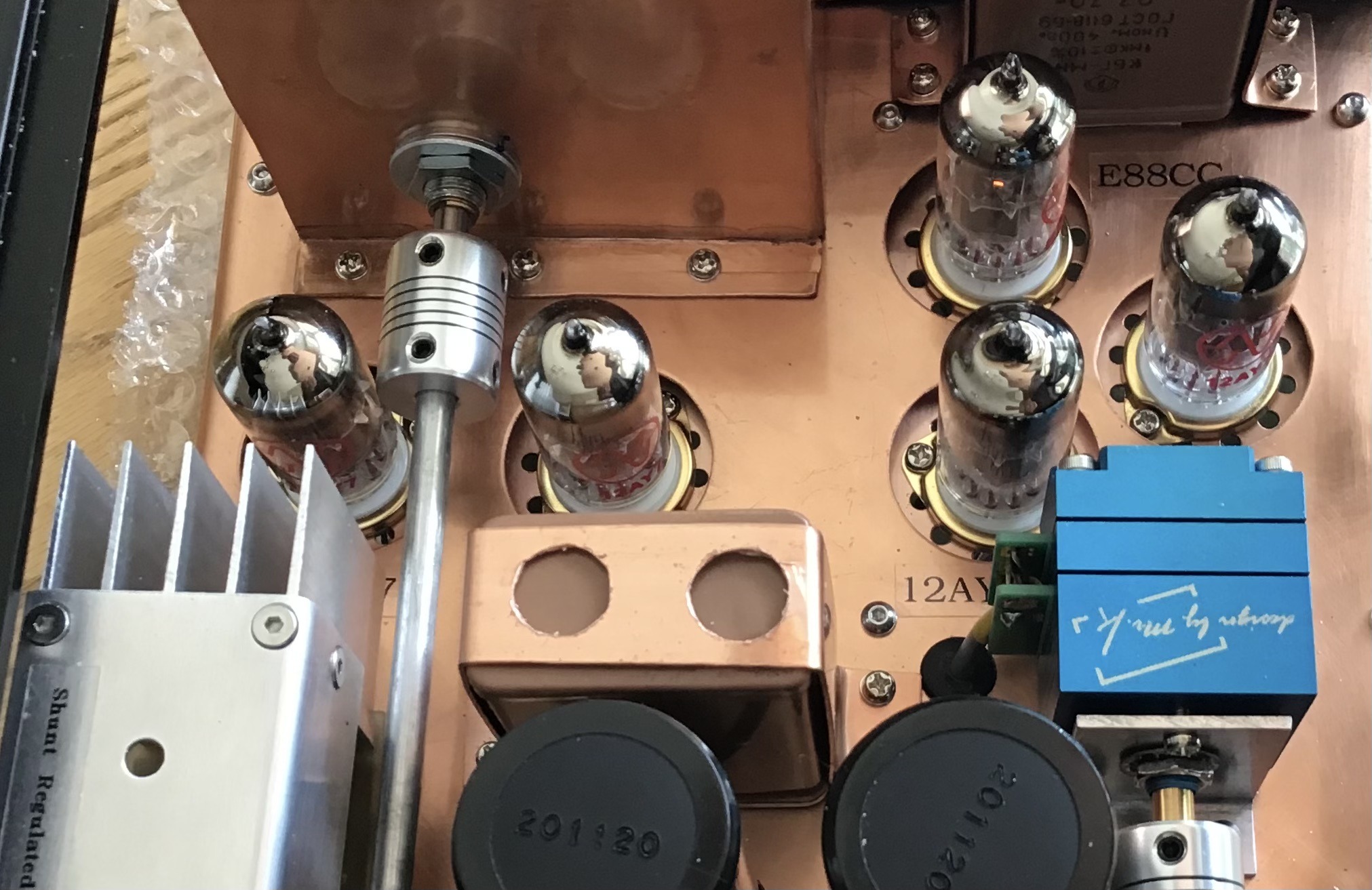

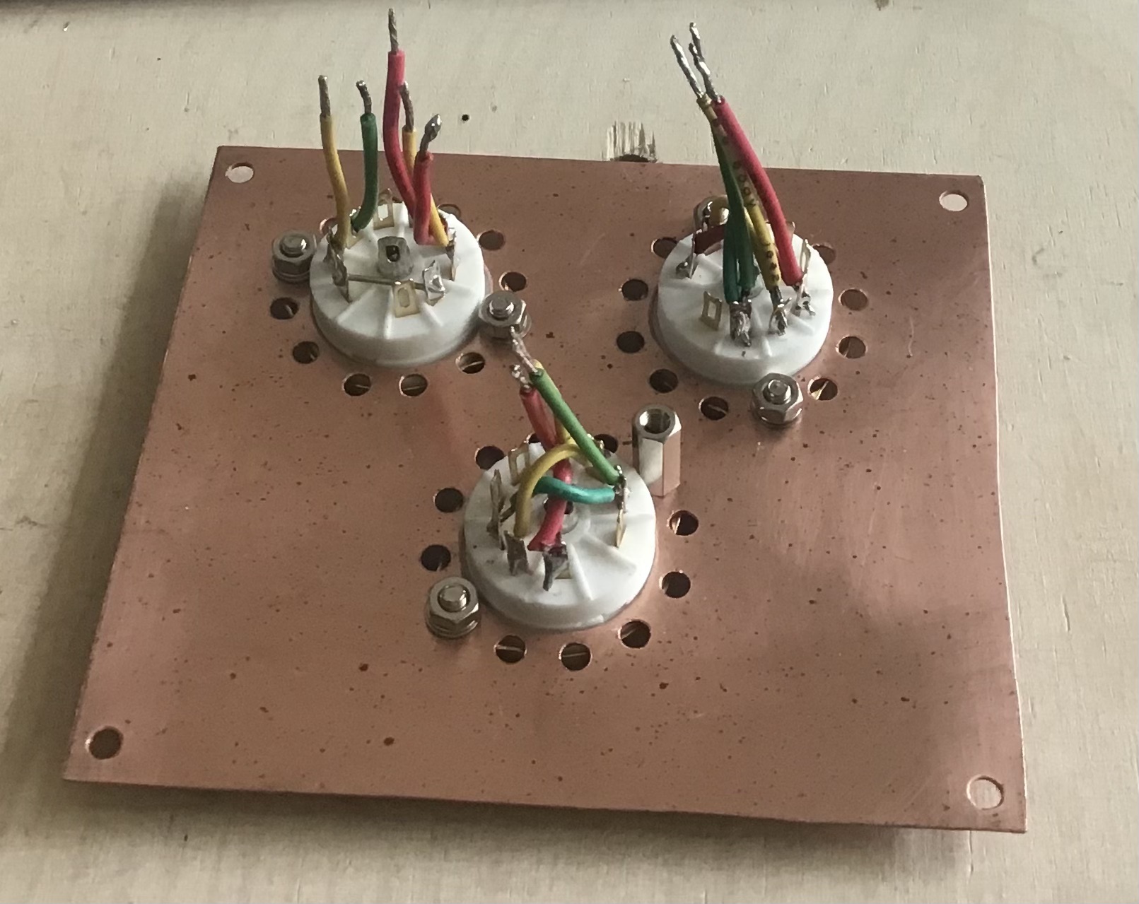

I’ve wired up the heaters and installed my recently arrived tubes from JJ.
The HT is not yet wired up. I want to leave on just the heaters, allowing everything to heat up for about an hour. The tube heaters are glowing and the voltage is set around 6V; I noticed that the heatsink on the heater supply shunt regulator is nice and warm. The heater supply filter caps were noticeably warm and I suspect this will limit their service lifetime.
Otherwise, all seems to be well so far.

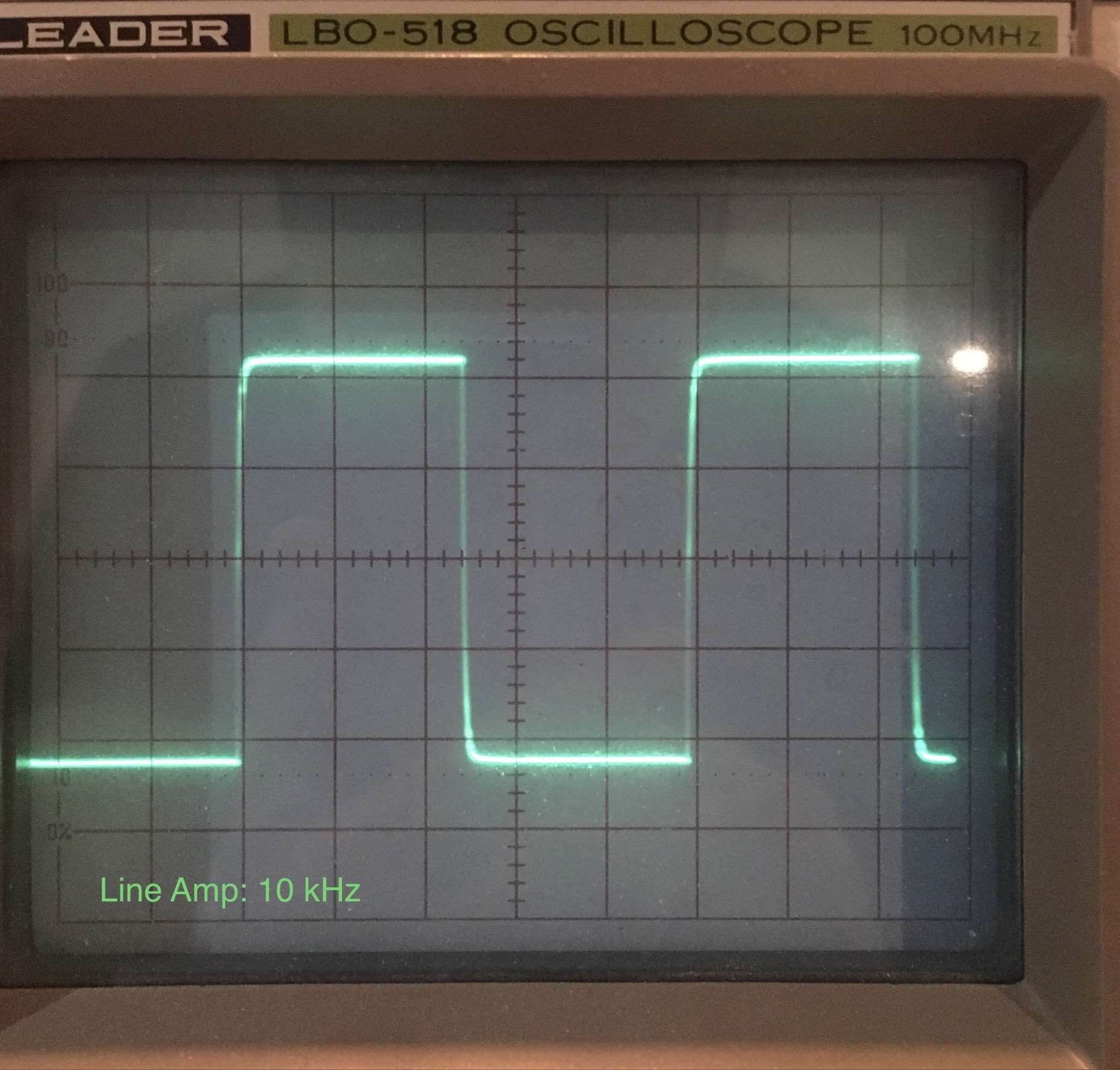

It’s been at least a year since my scope was powered up. Just for kicks I connected it up to the pre amp to have a play. No serious measurements.
The HT power supply voltage to the front end of the phono was very clean, thankfully. The phono amp produced a very distorted square wave, as would be expected with a non-flat RIAA filter. On sine waves it produced, well, sine waves. All the way up to at least 100kHz. The bottoms of the sine waves were starting to distort when the output was above 10Vpp, getting noticeable above 15Vpp. There was some h.f. hash, sporadic but I couldn’t trigger the scope on it and it was happening only once in a few minutes so not much chance to investigate.
The Line Amp produced nice looking square waves. Attached image at 10kHz.
Looking at the amplitude, it was possible to confirm proper operation of the selector switch, attenuator switch and the volume control.

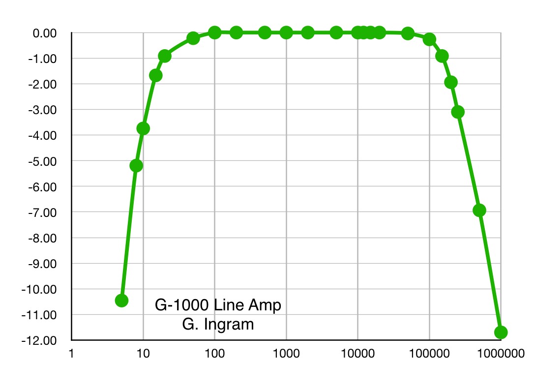

I measured the freq response of the Line Amp. Not perfectly accurate, just using a signal generator (+/- 1V O/P) and scope, no load. It looks pretty close to the manufacturers published spec (-3dB at 8Hz and 280kHz). The low end cut off is determined by the input cap (0.022uF) and grid leak (1M).
The line amp has a prodigious output swing if it wants, so it could serve as a direct input to a unity gain power amp such as the Pass F4.

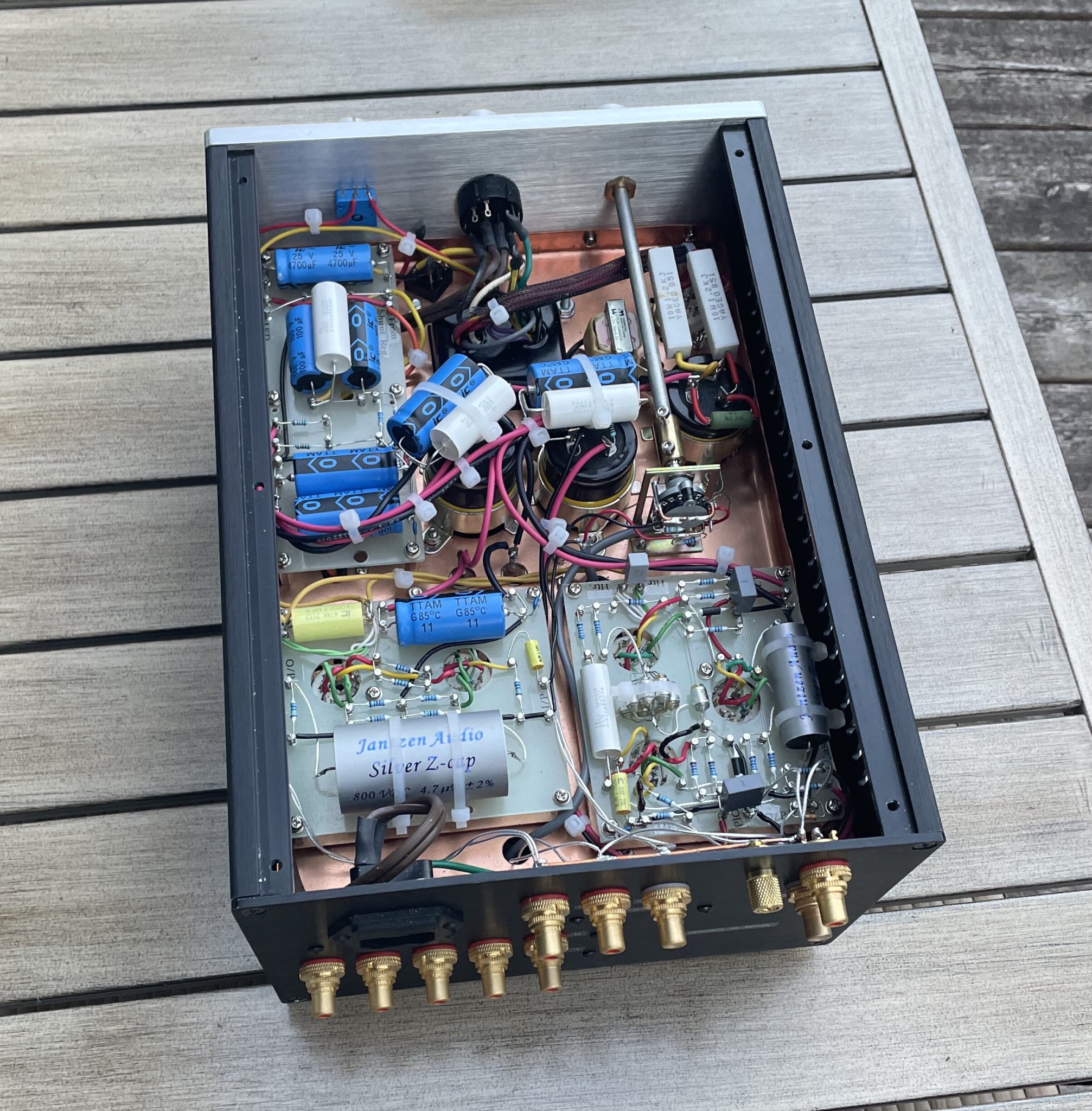

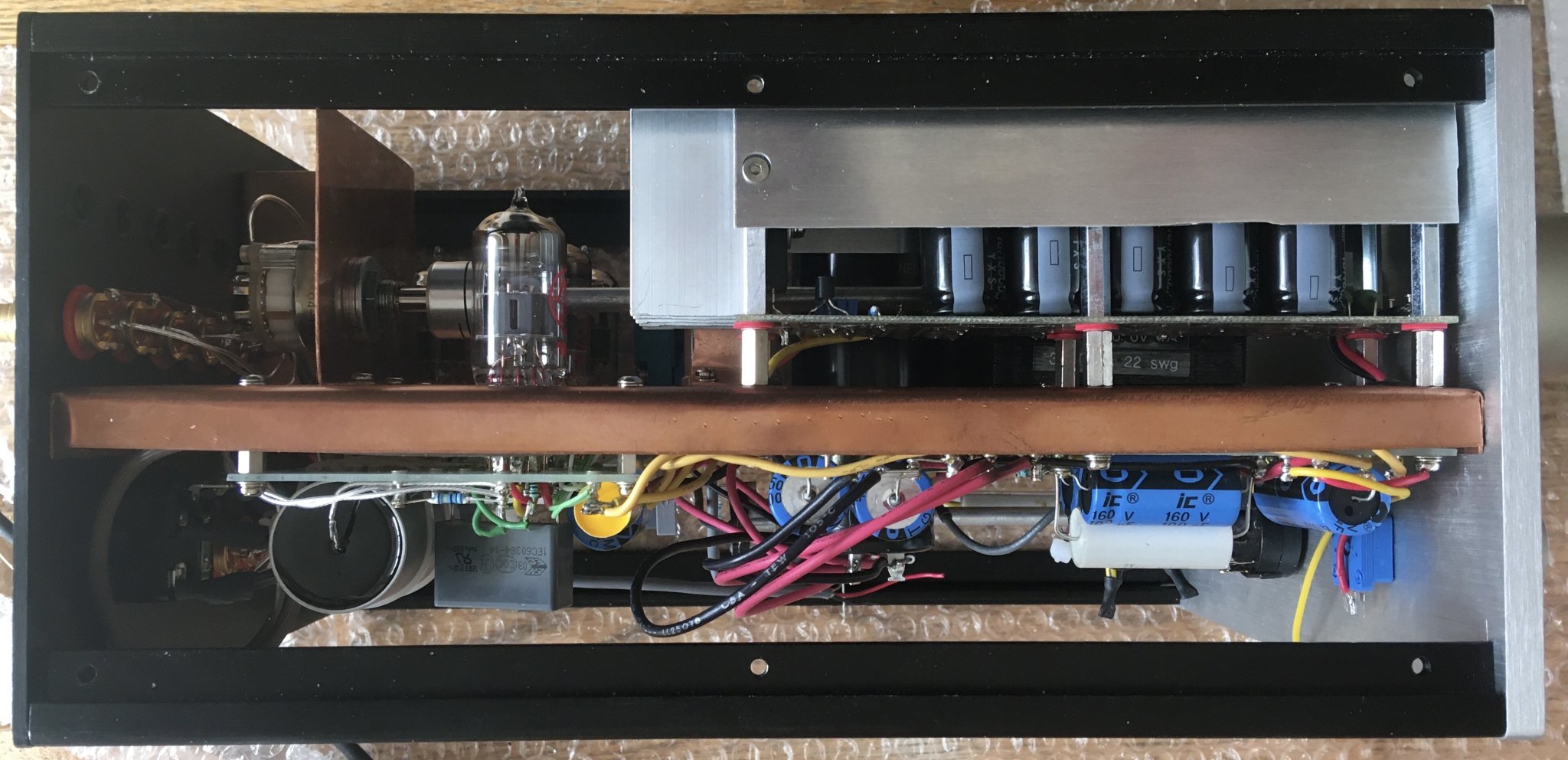

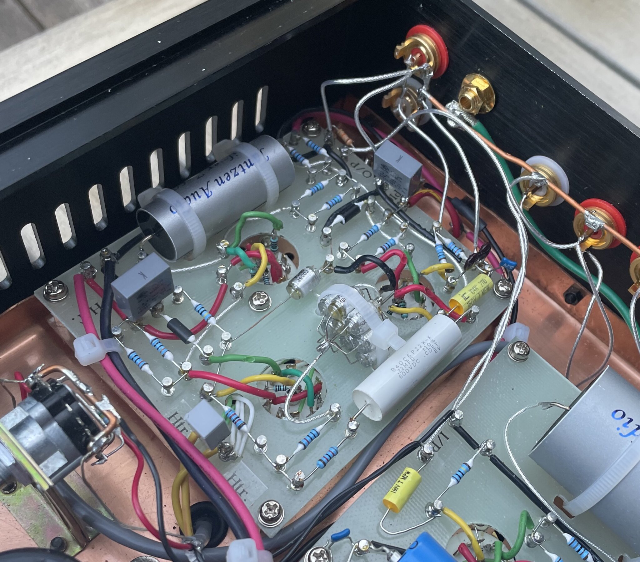

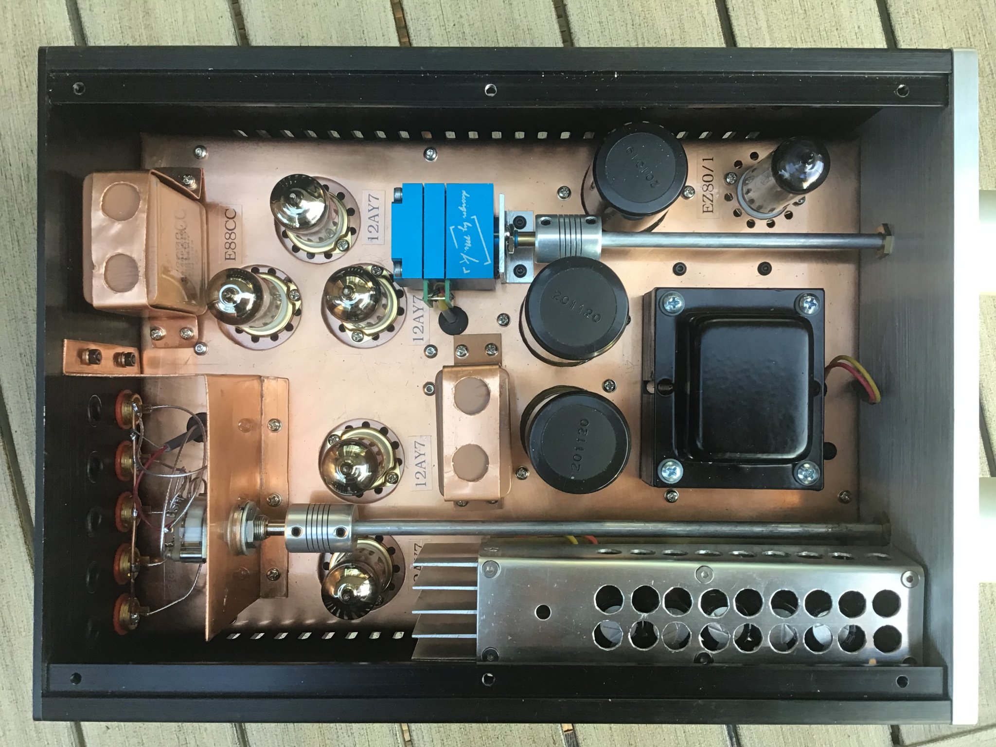

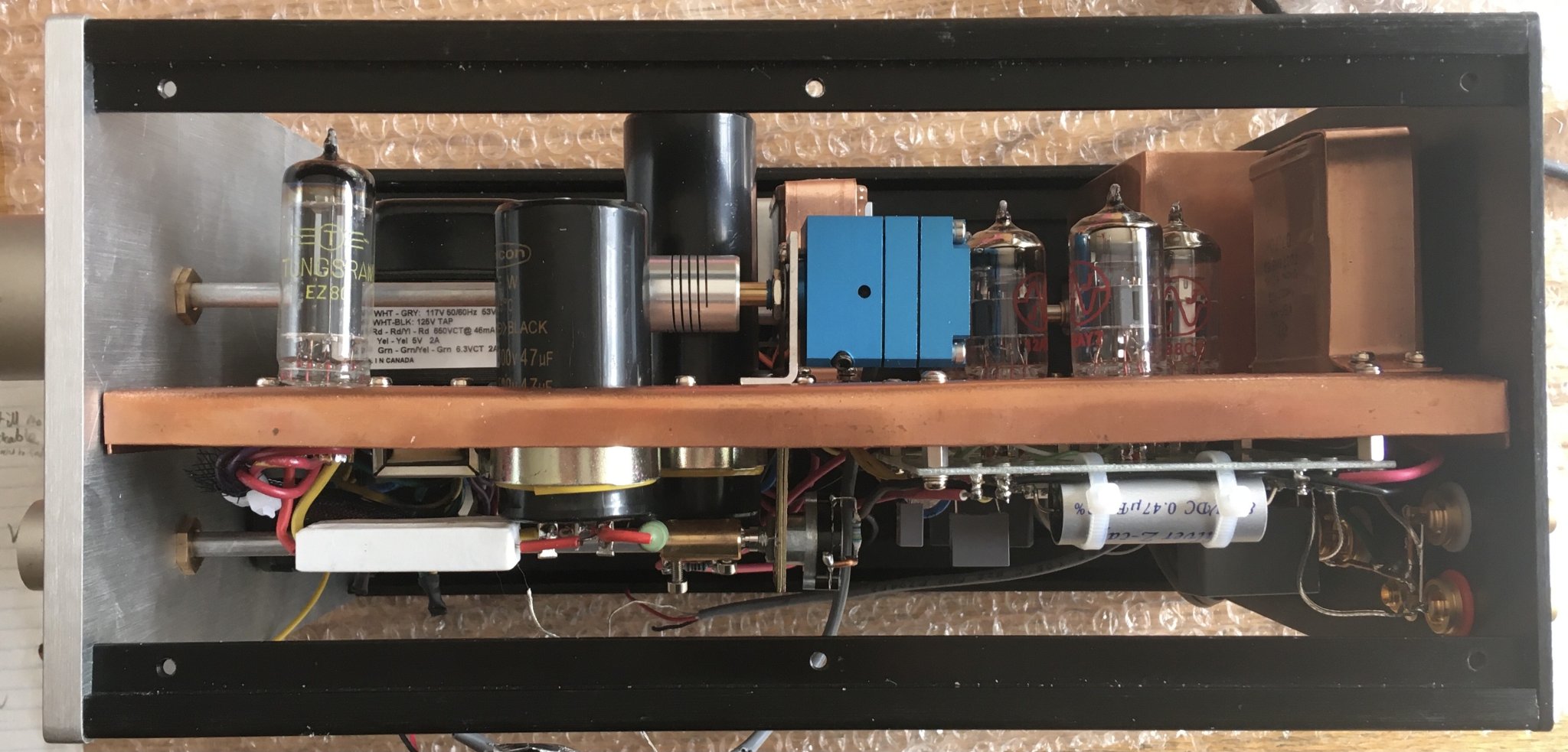

Some underside photos of what may turn out to be a finished state, we’ll see. Working on it has been made easy by fitting the bottom cover, complete with rubber feet, to the top of the chassis enclosure and sitting the unit on the bench upside down.

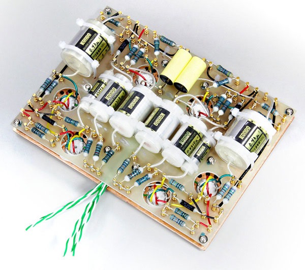

Also attached an image of the commercial M7H that has served as part of the inspiration.

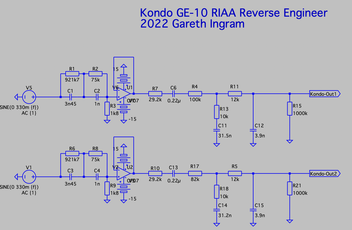

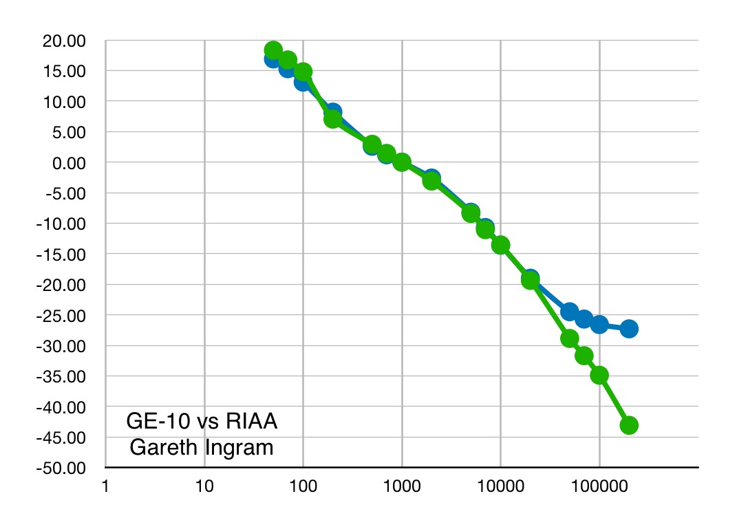

RIAA Accuracy

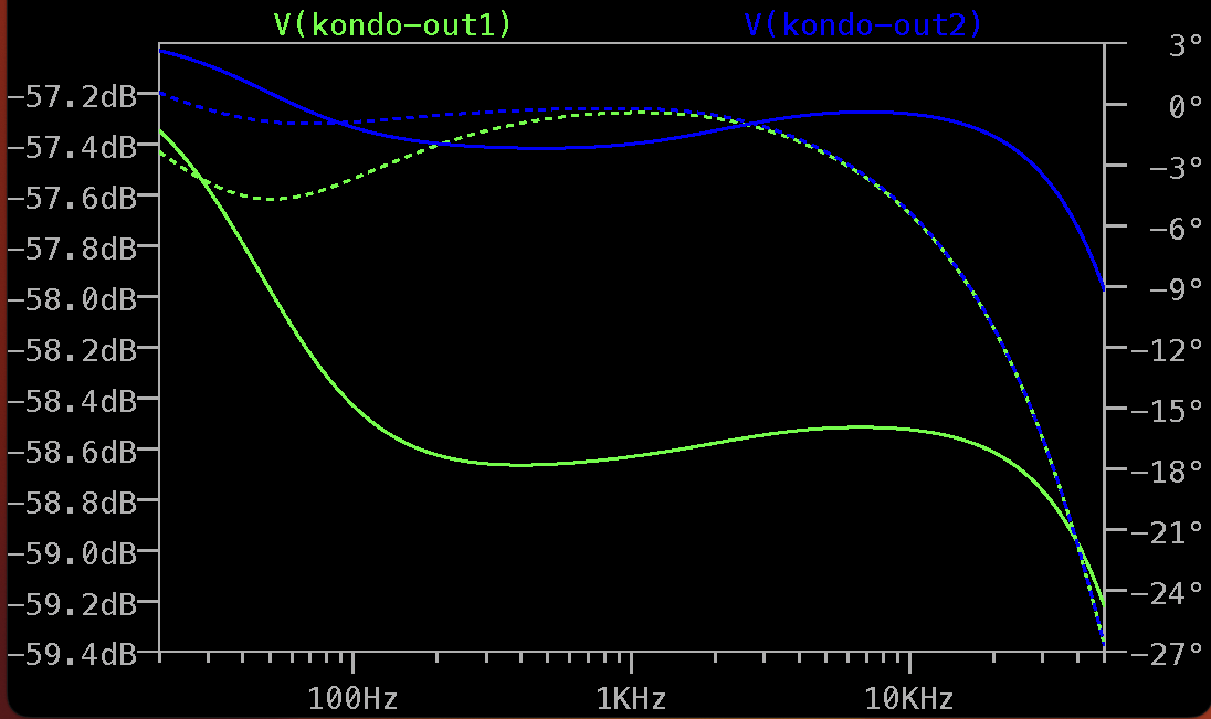

Much has been written about the non-flat RIAA response of the original M7 and I was curious to see whether the latest from Kondo's company had corrected this or if it was a House Sound to be preserved.
When I ran a Spice simulation I found that it was pretty flat, assuming that the source impedance was vanishingly low. In other words, a kind of text book design.

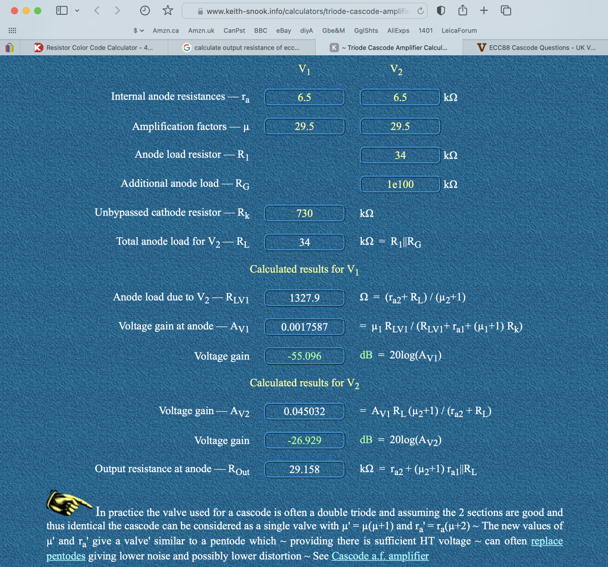

But the tube phono has a finite drive impedance for the RIAA network. The output impedance from the E88CC cascode is not going to be that low. I used an online calculator to save me the trouble of calculating it myself (ref: Keith-Snook) which provided an Rout of 29,158 Ohms. That's not vanishingly low. Re-running the Spice simulation shows this upsets the RIAA conformance.
Did the new design team at Kondo make a mistake ? Were they aiming for flat and didn't account for this impedance ?
In the end I decided to adjust the value of the first resistor in the RIAA filter, reducing it from 100k to 82k to compensate for the driving impedance. From simulations this should provide much better RIAA accuracy. My measurements were limited in accuracy but the results look fine and they sound fine.
