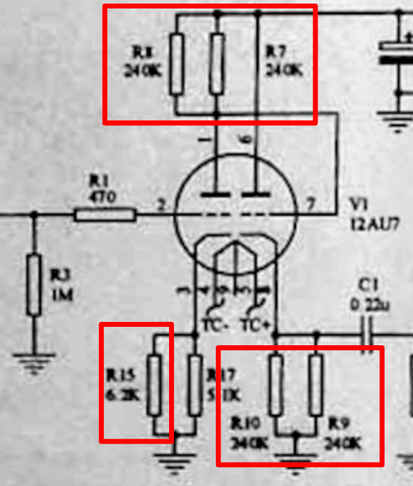

Hi All, first of all - thanks to al of you for valuable contribution. I have two questions as I am starting this build.
Question 1
I have spoted over internet some inconsistencies in schematic diagrams. Wast majority of them is showing 250kohm in anodes and 2nd cathode and 8k2/5k1 in 1st cathode. HOWEVER I seen one schematic that claims to be also genuine where I see 240kohm and 6k8/5k1. This is only one though, additionaly schematic claims 12AU7 that is wrong tube here in my opinion. So I guess it can be wrong (chinese fake or so). Would like to make sure correct values are 250k and 8k2/5k1 assuming tube 12AY7. Are they?

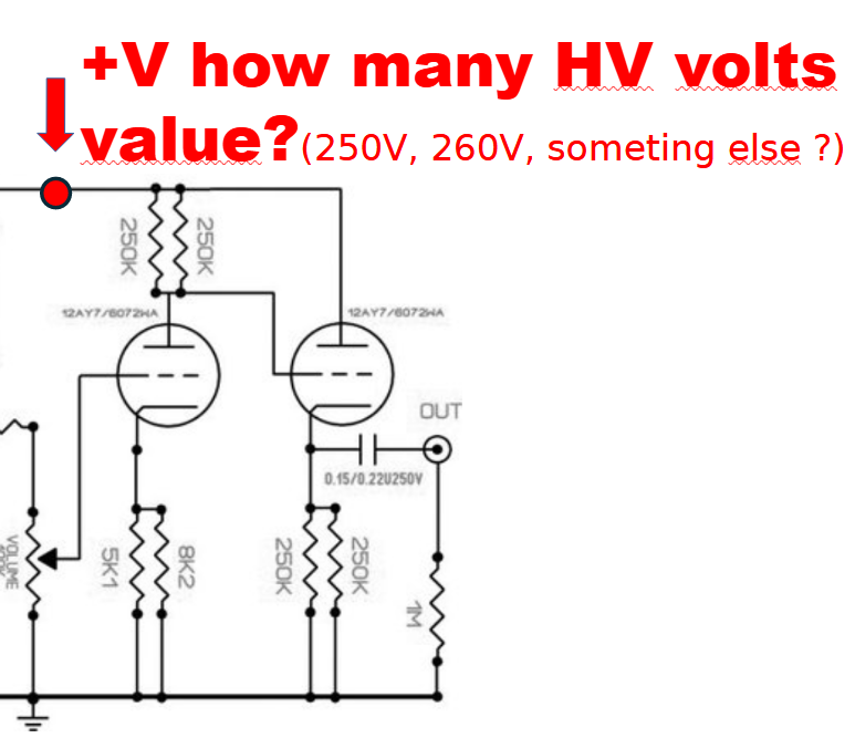

Question 2
What is correct HV pover supply value in the point I've marked on the schematic? Aain - some information noise over web. Some says 250V another 260V, I seen 225V or 248V as well. I am using quite "hi-tech" 😉 , complex, regulated and very good in therms of ripple rejection, MOSFET based power supply, so I can set voltage up to 0,1V as I want. Just need to know what is correct value, please?
I have seen over the threat that @Bigun was deeply on the topic. @Bigun - may I ask your assistance here, please?

Well, right now I'm away on travel and my 'notes' are back home. My memory is that I was aiming for ~260V for the HT at the input to the circuit (see post #100). I will need to check my notes if it's not in the thread already. Nevertheless, I don't think +/-10V is going to be material to the results and you might shed some light on this yourself by reporting on any possible changes in sound with your adjustable supply. A complex (your description) regulated supply though is a departure from my clone and that alone means you are impacting the circuit behaviour in ways that go beyond the choice of HT voltage.
@Bigun thanks for your reply. Are you implying, that power supply (let's leave voltage topic aside now, say it will be 260V) can impact preamp performance? If so, what would be a potential reasons for that? Different regulated power supply I am using output impedance? Current efficiency? Something else?

The amplifier circuits do not have infinite PSRR, meaning that the power supply behaviour has some impact on the signal. And the power supply does not have zero output impedance, meaning that it can be affected by the current drawn and any signals on that current. It stands to reason that there can be an interaction between them - the power supply and the amplifier circult and it all works in unison.
Different power supply designs will have some impact, it maybe inaudible of course.
Almost all practical voltage regulators work with negative feedback and the output impedance is a function of frequency. Stability of the feedback loop is a function of the regulator circuit, its implementation and load etc. Much has been said on this topic by people with more experience and knowledge than I have so I won't try to say too much here.
The point I want to make is that you have modified the circuit, taking your own path. That's perfectly fine, it just isn't the circuit that this thread was created for and so I can't guide those aspects. I studied the choices made by Kondo and Ashizawa because they had their own idea about what the power supply should be. The design, choice of parts, brands, construction - all maybe important. I have taken the path of trusting their decisions and hence I have been careful in these details of the implementation of the power supply in my project.
