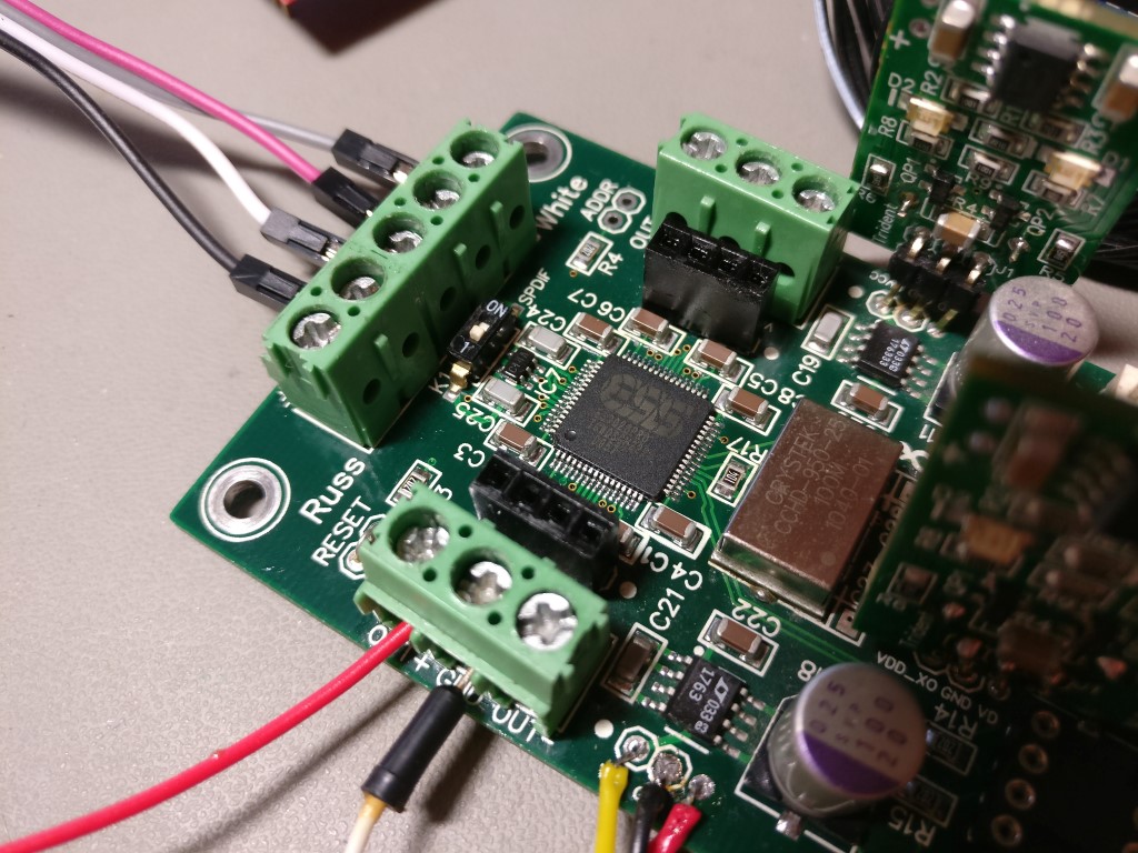

I never bothered to ask the seller about the thermal pad since the chip was working fine and I wasn't really expecting to get a useful answer anyway.. I have no doubts that it is an ESS chip, it's probably just an "early model".
I ordered one more such chip from the same seller (before the whole thermal pad issue came up) and the one that got here had the thermal pad and displayed the proper identification code. It now lives on a (very happy) friend's upgraded Buffalo II.
