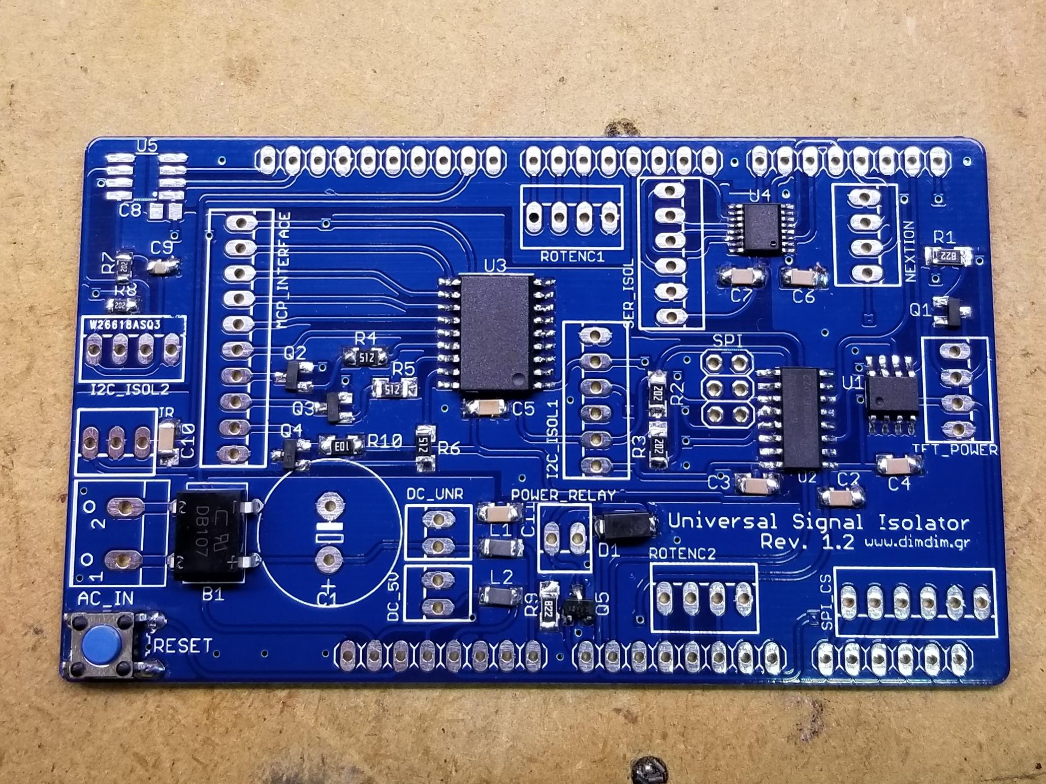

Almost done with my shield! Waiting for ADUM1250. 4.3" TFT on the way. DUE waiting for instructions...

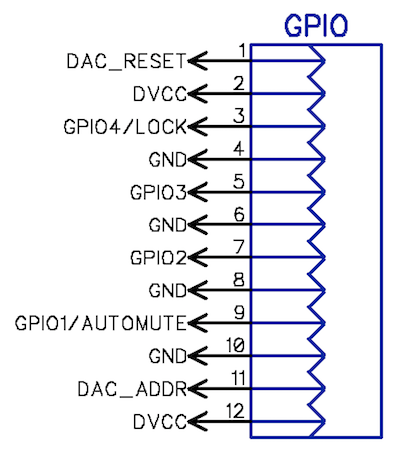

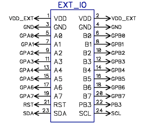

Dimitris, I'm a little confused. On the BIIIse Pro ES9028, do I connect I2C to the header (SDA/SDL and GND) or to the GPIO pins?
Waiting for my TFT screen.
Thanks!
Thanks!
If things are like they were on the BIIIse, it's the same, the pins are connected in parallel. Don't forget to also get 3.3V for the isolator plus a signal from the lock LED pin.
Yes. Also don't forget the +3.3V.
Right. I figured I'd snag 3.3v from the DUE. I'll be powering the DUE with 9v through its DC in jack.

The 3.3V must be "clean", so it can't be from the DUE, it must be from the DAC's side.

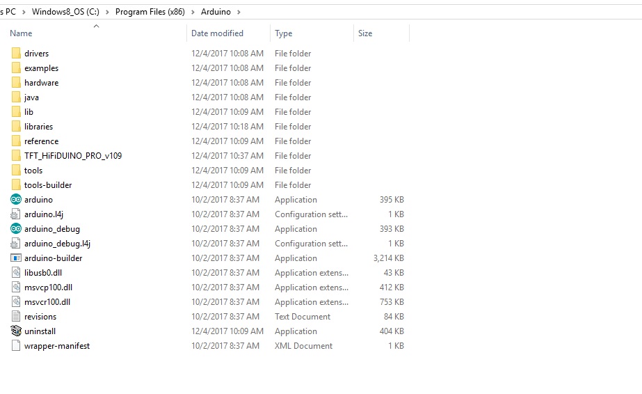

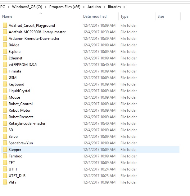

Is there a specific version of Arduino software I must use with your code? I downloaded 1.8.5 and it gives me fits about DUE. I installed the updates to add DUE to the list of boards.
I get "error compiling for board arduino due (programming port)."
I always use the current IDE so 1.8.5 will do just fine.
I'll need to see what errors you are getting to tell you what's wrong / missing.
You should start by putting the necessary libraries in the folder C:\Users\<your user name>\Documents\Arduino\libraries
OK I started over. Duh!
Now I just get this
Arduino: 1.8.5 (Windows 10), Board: "Arduino Due (Programming Port)"
sketch\Wire.cpp:26:19: fatal error: twi.h: No such file or directory
#include "twi.h"
compilation terminated.
exit status 1
Error compiling for board Arduino Due (Programming Port).
