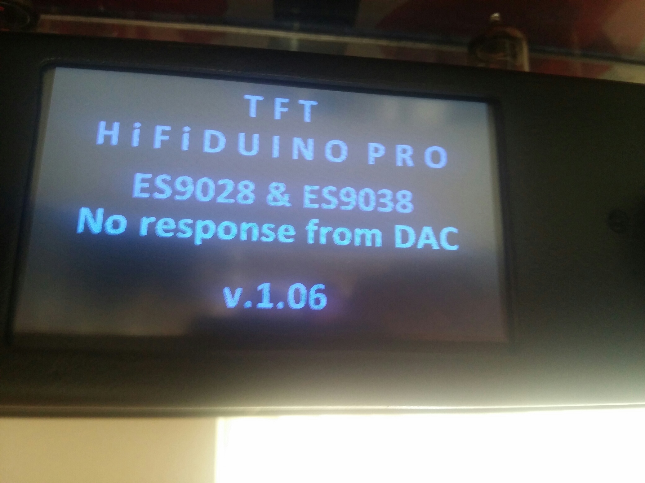

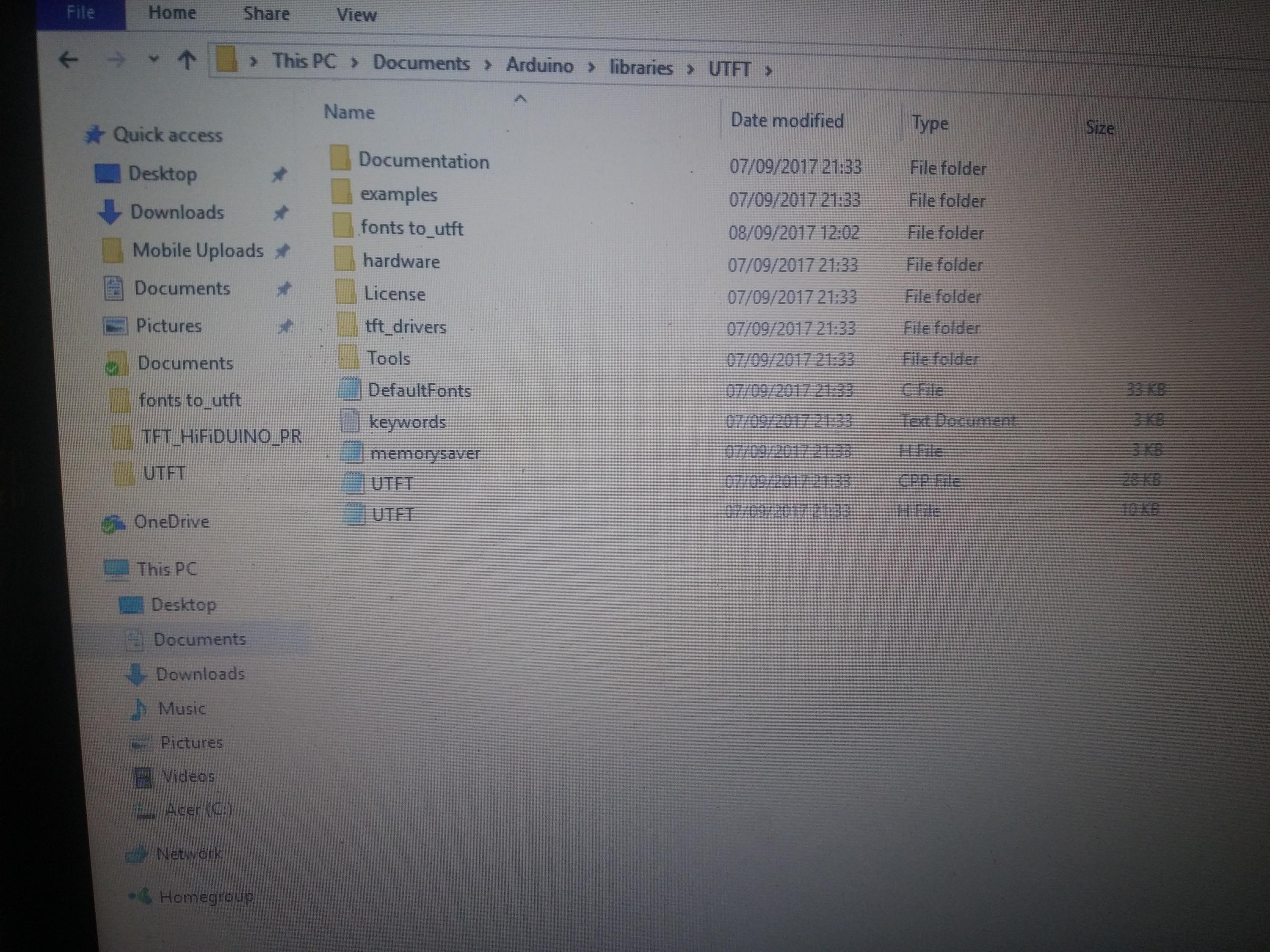

I have also borrowed another laptop tried installing a fresh arduino program and re downloading all the files.
I get exactly the same error.

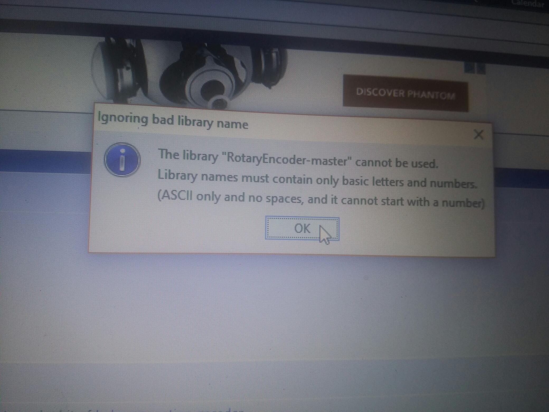

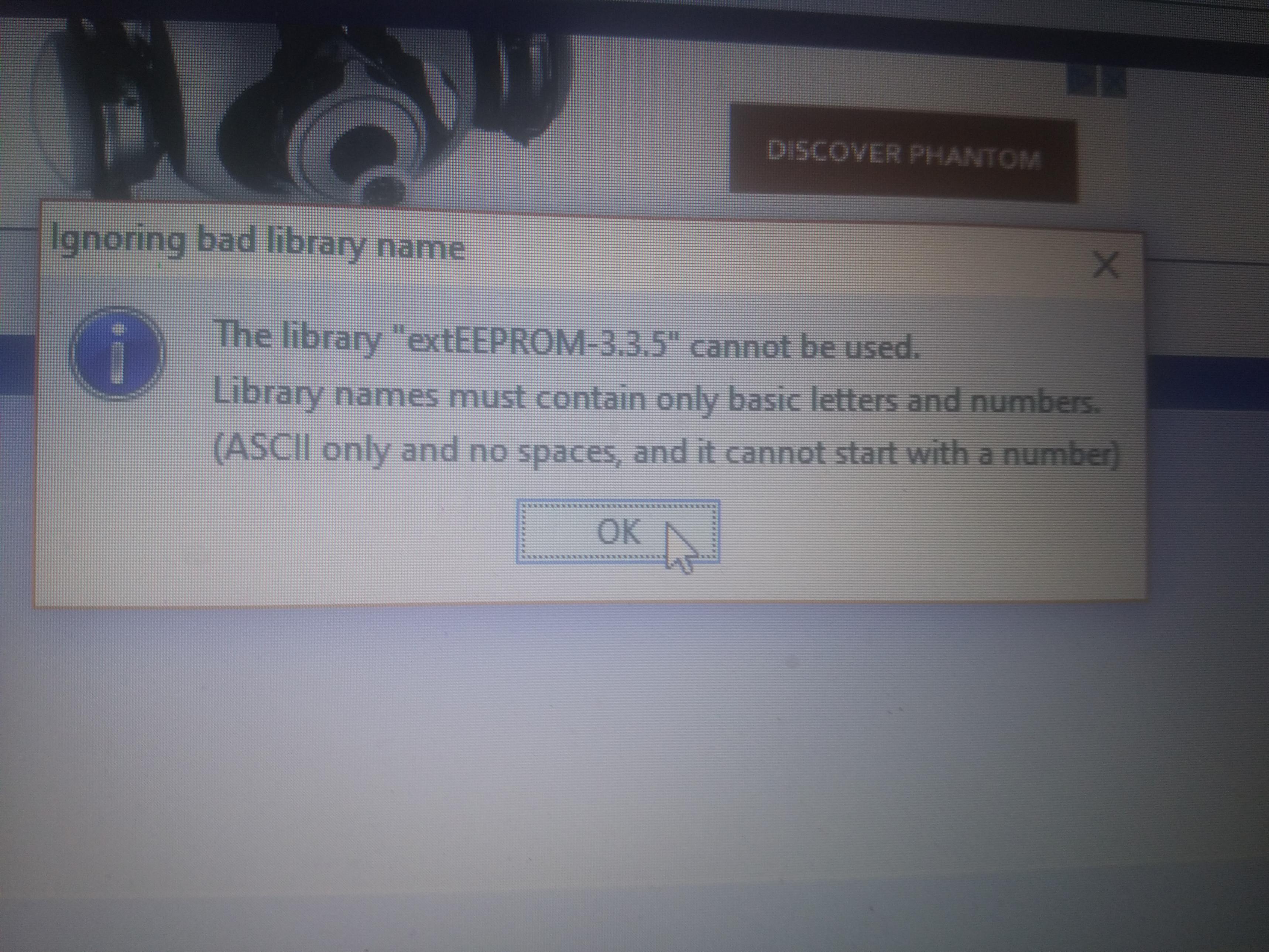

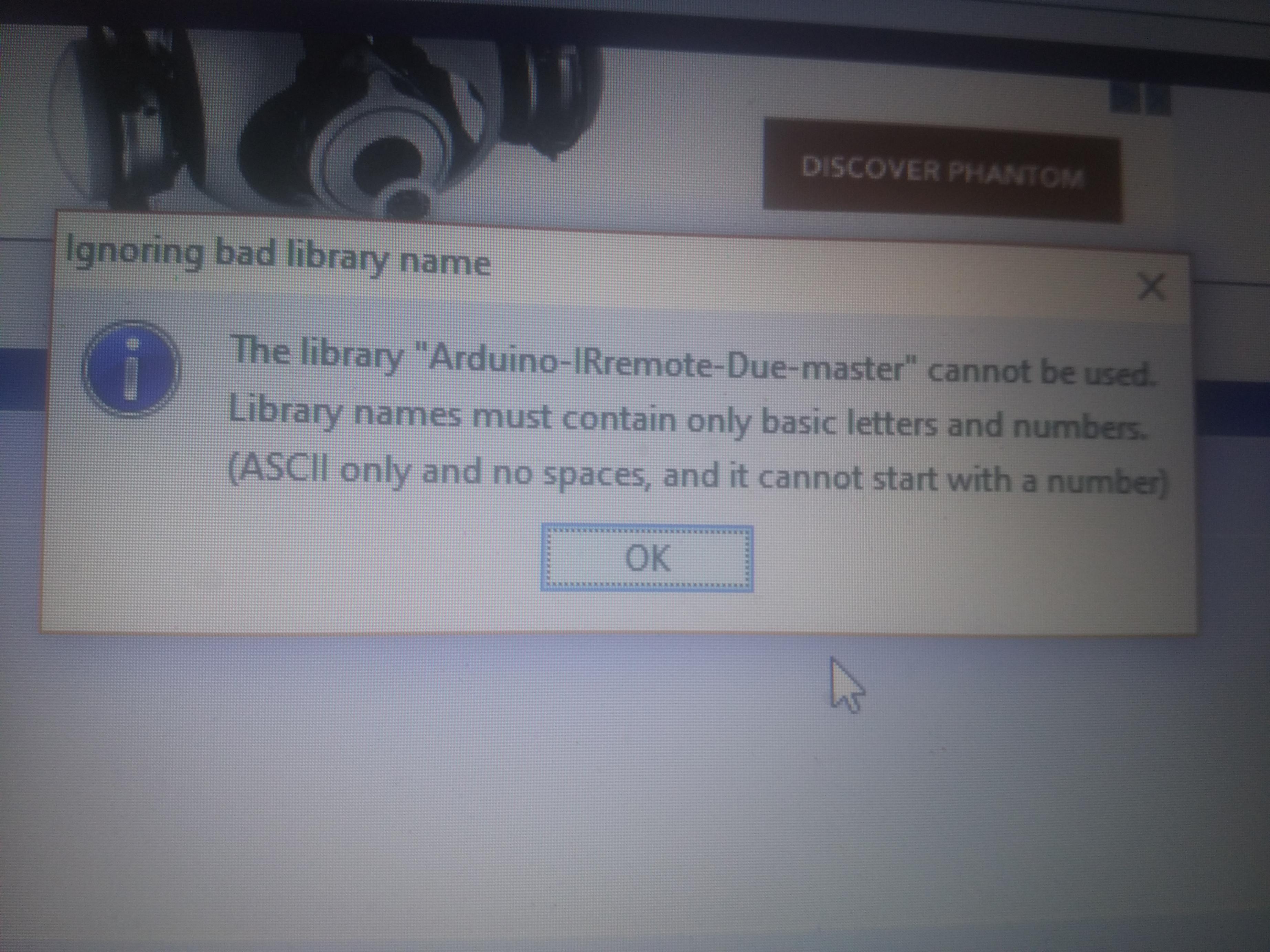

I am now getting this come up on my computer screen when I open Arduino programmer.
This is something new I just think ive coppied files too many times trying to get it to work.
THANK YOU.
THANK YOU.
From your compiler's output at #41 it looks like the only problem is that you haven't put the font files in the proper directories.
All the necessary fonts and bitmaps are included in the ZIP that you downloaded from my blog. The font file in the folder "fonts to utft" should go into your UTFT library's directory and the font files in the folder "fonts to utft_dlb" should go into your UTFT_DLB library's directory.
The error you're getting in #43 is a classic. The IDE doesn't like the dashes in the folder names. Just rename the folders substituting underscores for the dashes.
You can safely ignore the warnings that you are getting in the compiler's output. You only need to worry about the errors.

It appears that you still have not put the fonts in their proper folders.
For example, you should copy the file "Shruti_Bold_num_48x70.c" to the UTFT folder that you are showing in your picture.
You should also copy the other font files found in my zip to the UTFT_DLB folder.
Having extra pull-up resistors won't hurt, not having any will, especially on the isolated side of the shield.
Double check that you haven't reversed the SDA/SCL lines by accident.
Connections are fine and continuity from shield to pins on es9038pro.Having extra pull-up resistors won't hurt, not having any will, especially on the isolated side of the shield.
I am going to make other shield and re-try.
when I connected this shield through 5v DC input for the 1st time I used my old 5v DC psu pcb which was powering my Arduino mega but when I checked the voltage it was giving out 8.8v DC.
It was only connected for a few minutes before I noticed but think it may have blown a chip.
U1 TFT chip was not installed at the time though.
I also do not get 3.3v at pin 1 of TFT so connect this wire to pin 2.
On Q1 I get 2.8v left hand pin,3.3v right hand pin but nothing on output that feeds to TFT pin 1.
If you fed the board with 8.8VDC with U2 soldered on for several minutes, it's most likely gone. That would definitely explain why you're not connecting to the 9038.
Yes psu pcb is meant to output 5v Dc it was only connected shortly soon as I connected it I checked voltage incase it was like 6v or something was not expecting 8.8v.If you fed the board with 8.8VDC with U2 soldered on for several minutes, it's most likely gone. That would definitely explain why you're not connecting to the 9038.

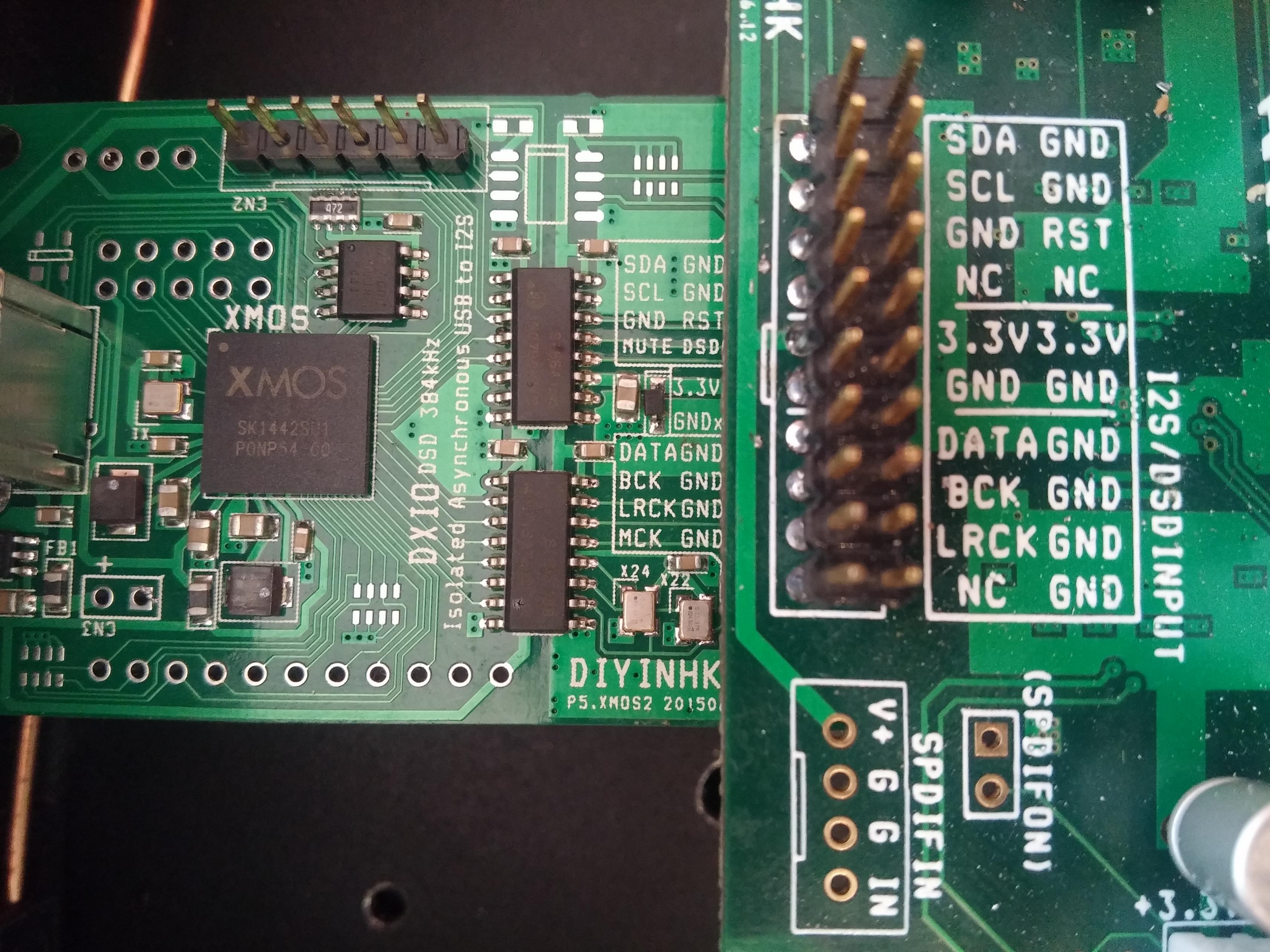

Hi Dimdim
This is a photo of my DIYINHK es9038pro dac connected to xmos pcb.
will I just need to cut SDA,SCL lines to xmos pcb.
The new DIYINHK xmos pcb I have ordered is xmos 768khz DXD XU216 none isolated.
If you know that your new XMOS board will have software that is meant to control the 9038, you should definitely isolate the I2C pins.
If the XMOS board is just a "general purpose" one, with no special firmware, it's OK to leave the I2C pins intact and just connect your Arduino in parallel.

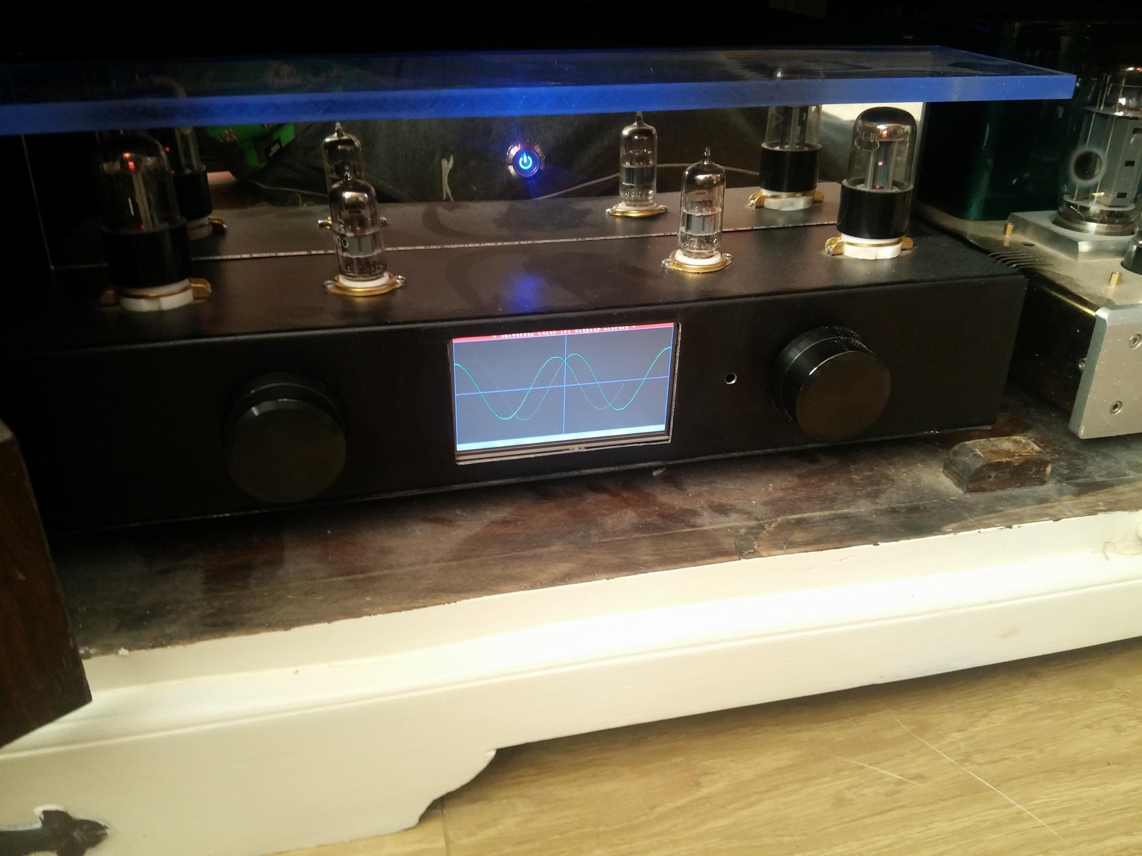

Thank you Dimdim my display looks great and mostly works really well.
New code is loaded I have changed 0x48 to 0x49 plus I managed to program arduino for my remote.
The only problem I am having is my display is displaying different sample rate its displaying PCM 96KHZ all the time when my computer is saying PCM 8467kbps /176400 or 192kbs/44khz for example.
I have a portable dac I plug in to test and this displays the correct sample rates.
This happens when I play through JRiver, foobar or Tidal HIFI and on different computers.
Thanks Dave.
Thanks Dave.
Hi there Dave,
SR is calculated by reading the current DPLL value and doing some math involving the 9028/38's clock. Should I assume that your clock is running at 100MHz?
Can you post the serial port's output while you are changing sampling rates?
Hi Dimdim clock is 80MHZ on the diyinhk es9028/38s pcb could this be my problem.
sampling rates on my display seems to stay mostly the same 96khz sometimes on Tidal it changes to 48khz but then goes back to 96khz.
