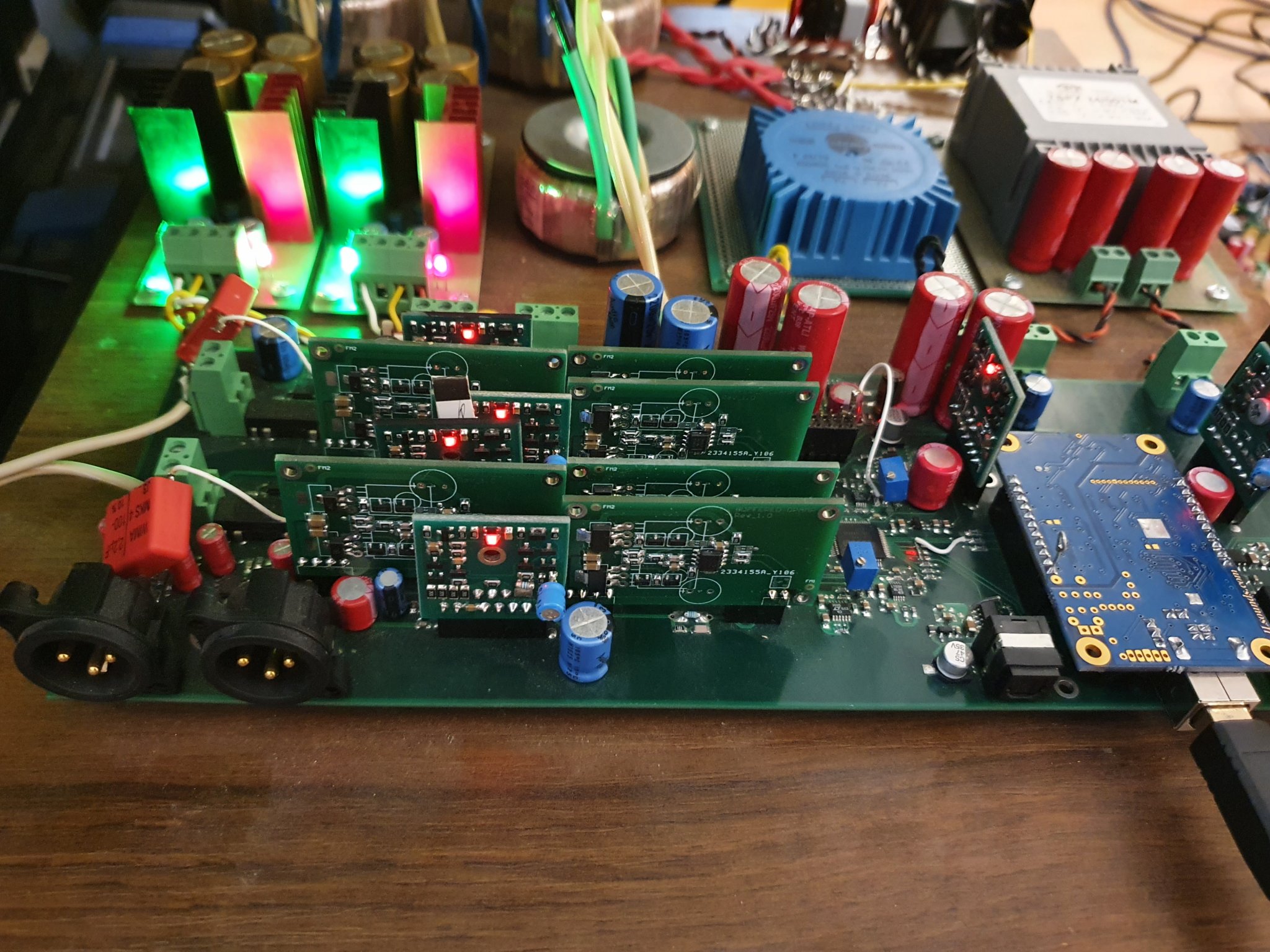

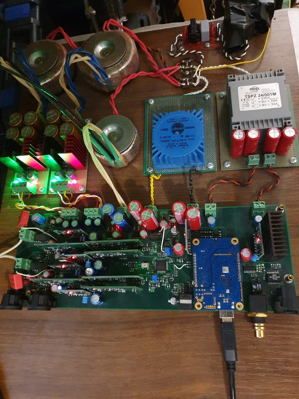

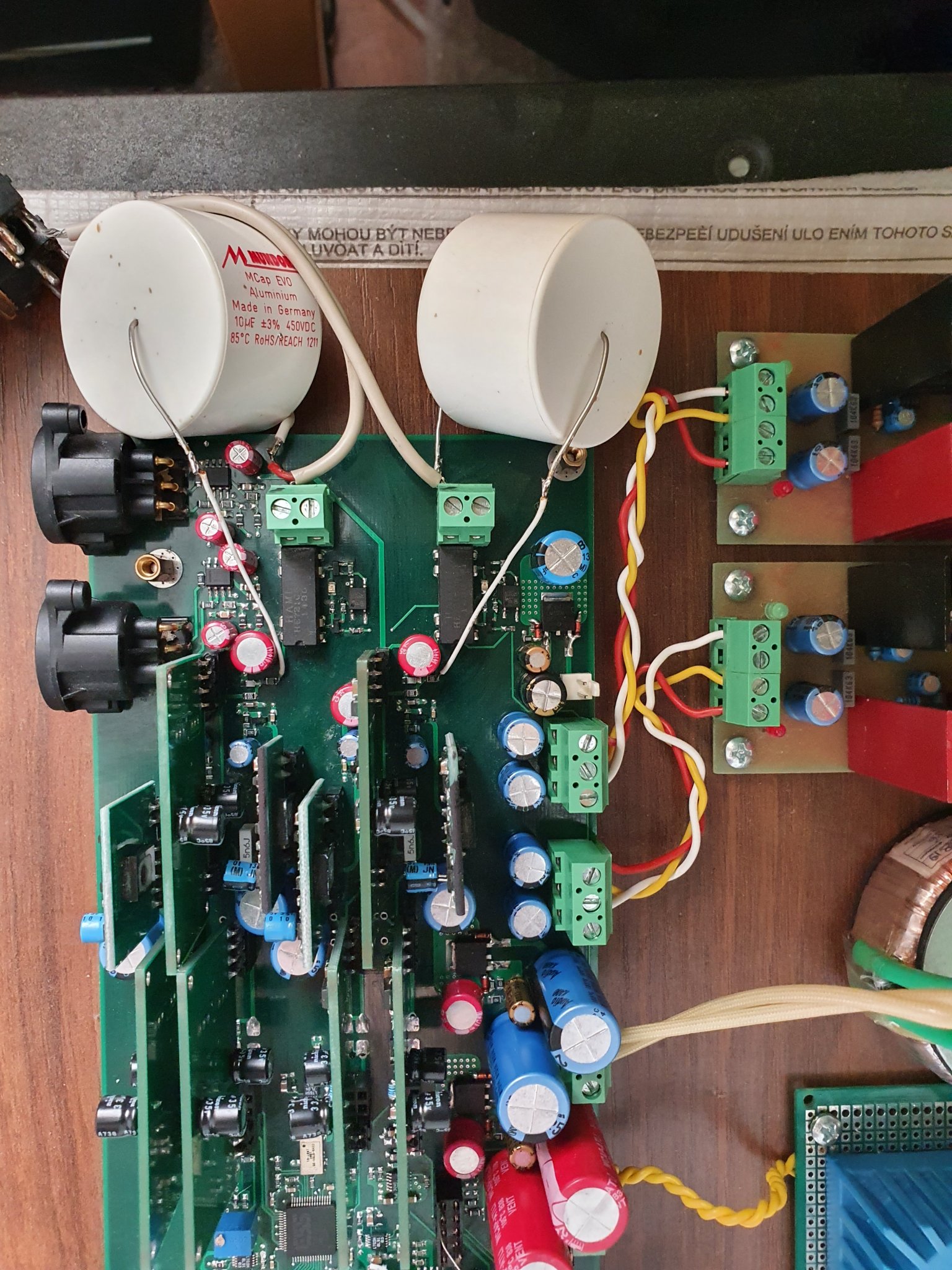

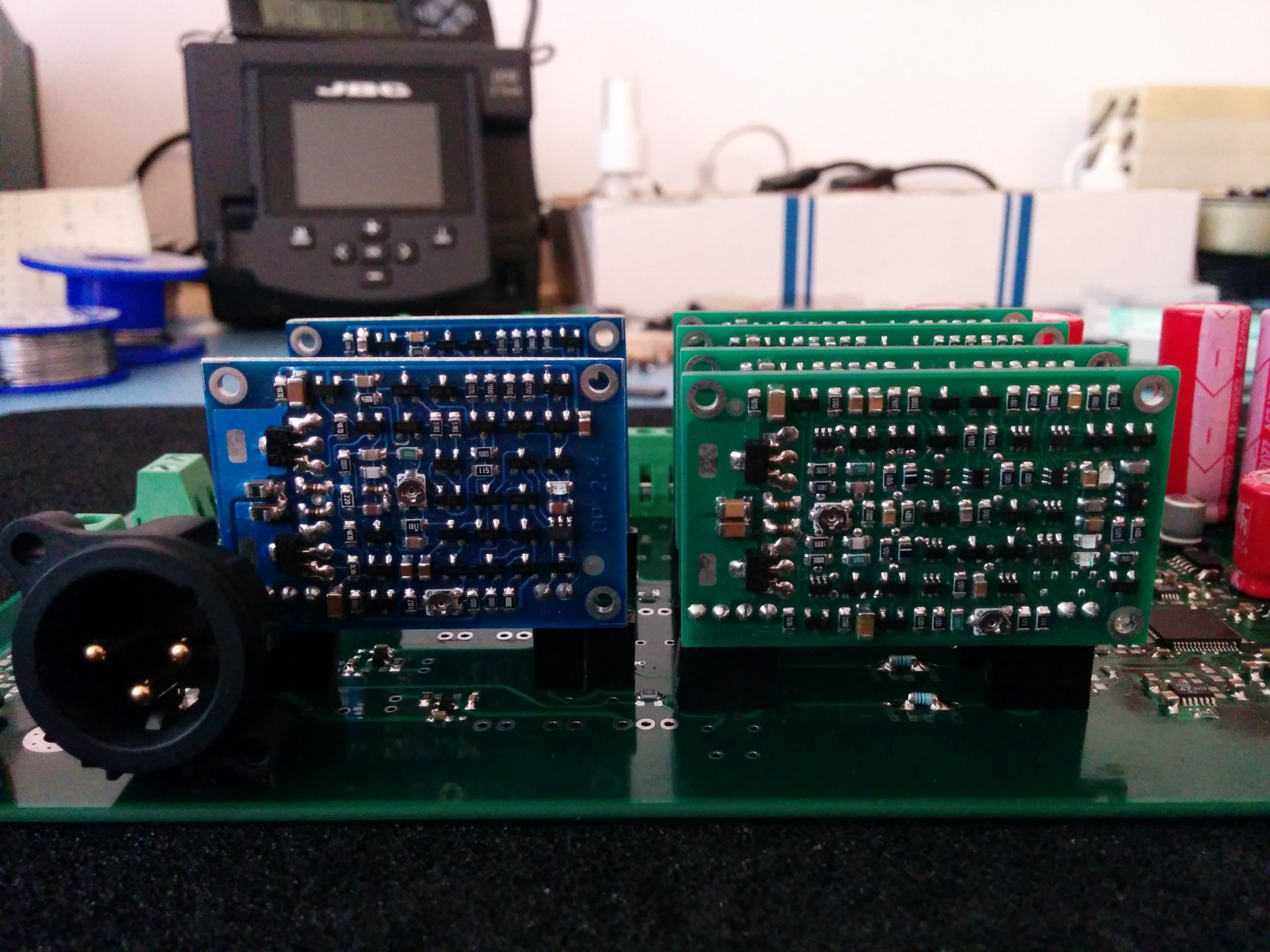

sercan85,
Nice looking pictures. Hope it would be okay if I ask a few questions 🙂
1. What regulators power AVCC_L and AVCC_R?
2. Wondering what you are using for MCLK source?
3. What DPLL settings are typically used?
4. From the pictures it looks like op amps are AD797?
Thanks,
Mark
Dear mark;
1- ı using for avcc lt3045 0,56uV noise 3,3v regulator from diyinhk, I did4 quad lt3045 0,4uv regulator for my project but bealive me 2cuoz pcb panasonic capacitors wima capacitors more expencive from diyinhk... 😀
2- İ using crytek CCHD-950-25-100 for mclk, but i see on mouser CCHD-950X-25-100 only different temp. X version 0-85c ı can use it other project.
3-DPLL setting high mode for es9028pro but my old dac es90218s need to highest bcoz when i play 192khz or 352khz if dpll low i have lock problem... But 9028pro so good 😉
4-AD797 is amazing for ess dac... bealive me i spen so much money for opamp, i try many opamp and always turn back AD797....
thanks

Dear Sercan85,
I am sorry to hear you spent so much money on opamps. If you find AD797 to sound best, it means you have other problems with the dac, in that case the wrong opamp can sound best. Power supplies would be the most suspect IME, that and some very low-level RF leaking from the dac outputs that gets into the opamps.
The clock you have is a good one for asynchronous operation, but synchronous (some people call True Sync) sounds better in almost all cases. Hard to make synchronous work well with Sabre dacs though.
Also, being able to set DPLL to 1 in asynchronous mode would sound best, but clock signals need to be very clean and low jitter. When I experimented with USB boards I did try diyink, but found JLsounds I2SoverUSB to have less jitter.
No matter the above though. The most important thing is that you like the dac and are happy with it. The case looks very nice, wiring and layout is neatly done. Congratulations on completion of a nice looking dac 🙂

Probably not the source of jitter issues. Both diyihk and JLsounds USB boards use galvanic isolation, and both use NDK SDA clocks. I assume the difference in apparent jitter performance comes from more subtle implementation details, including layout.
I dont use op amps in my dac but my son likes burson op amps in his dac.
Hmm. Dacs like Sabre and AKM's new AK4499 are specifically designed to work and sound best using specific op amp I/V conversion. IME, if they don't sound really good using OPA1612 or OPA1611 then it means there are other problems with the dac that need attention.
Unfortunately, op amps are easy targets to swap in and out which tends to make people focus attention on how op amps change the sound. It happens when op amps are not the real problem that needs fixing.

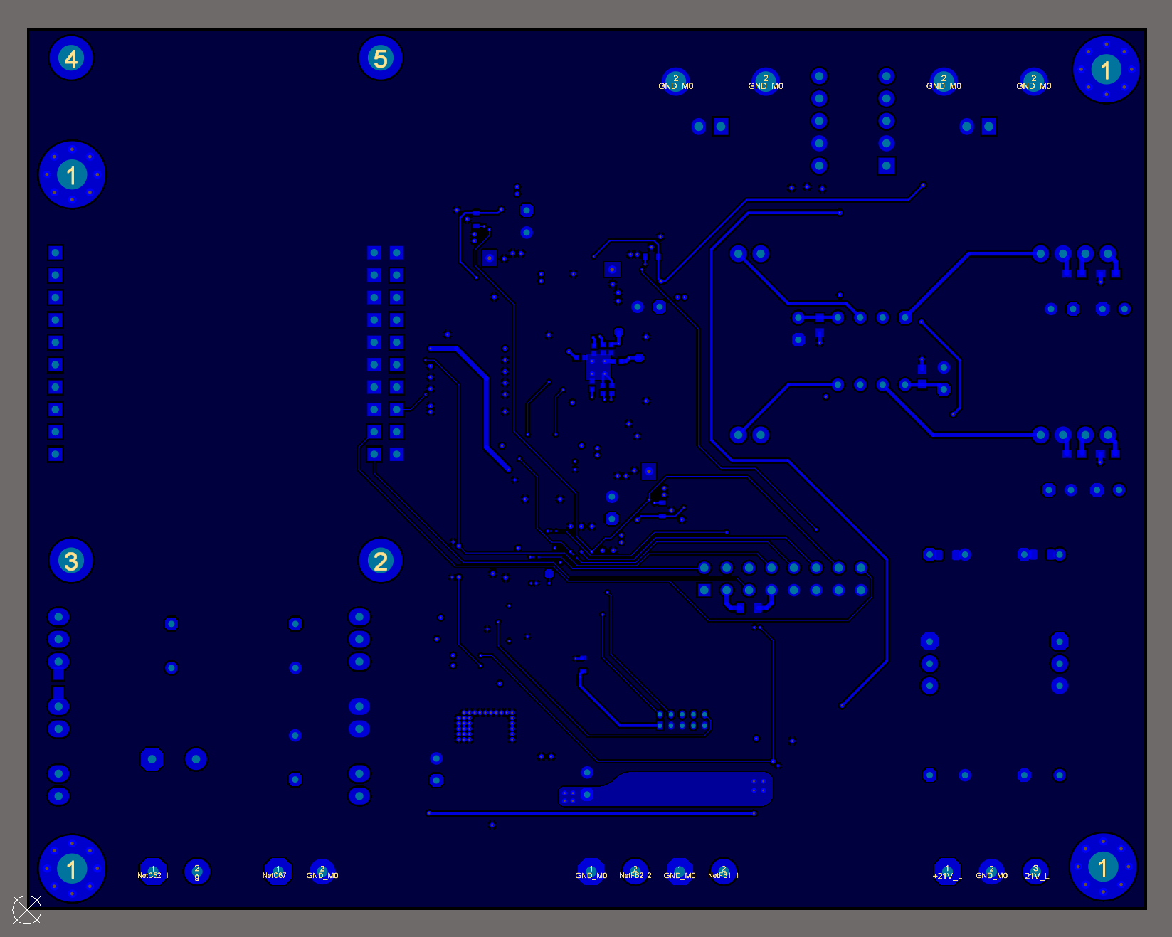

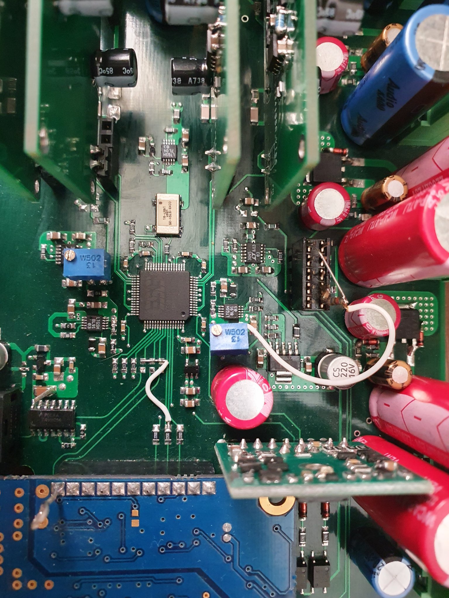

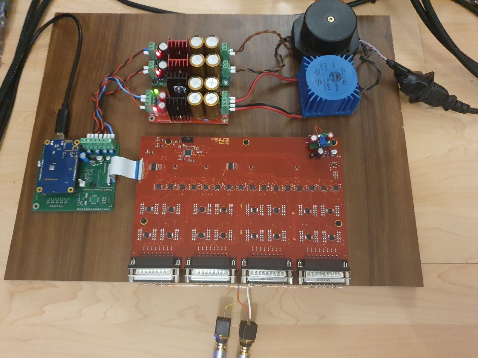

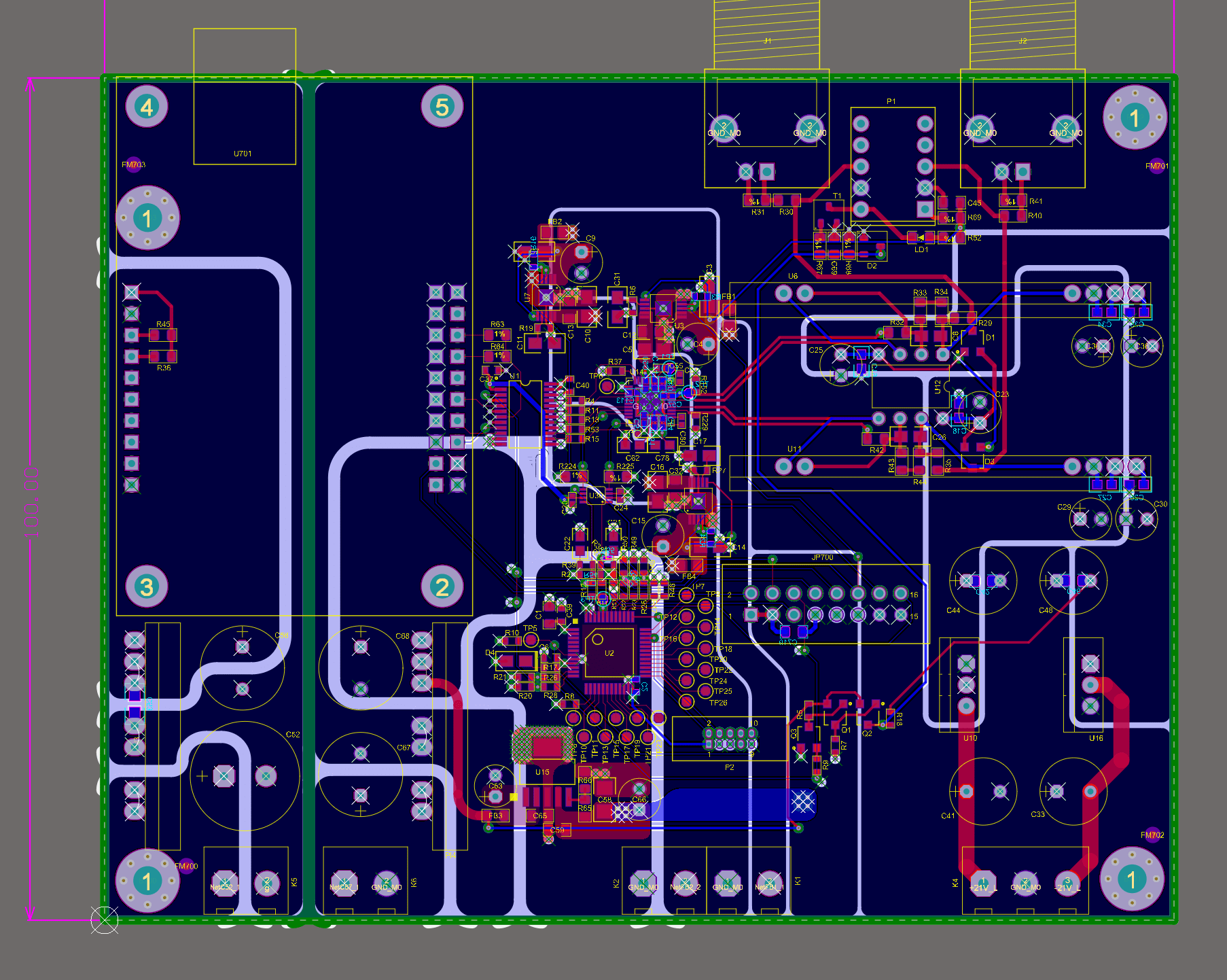

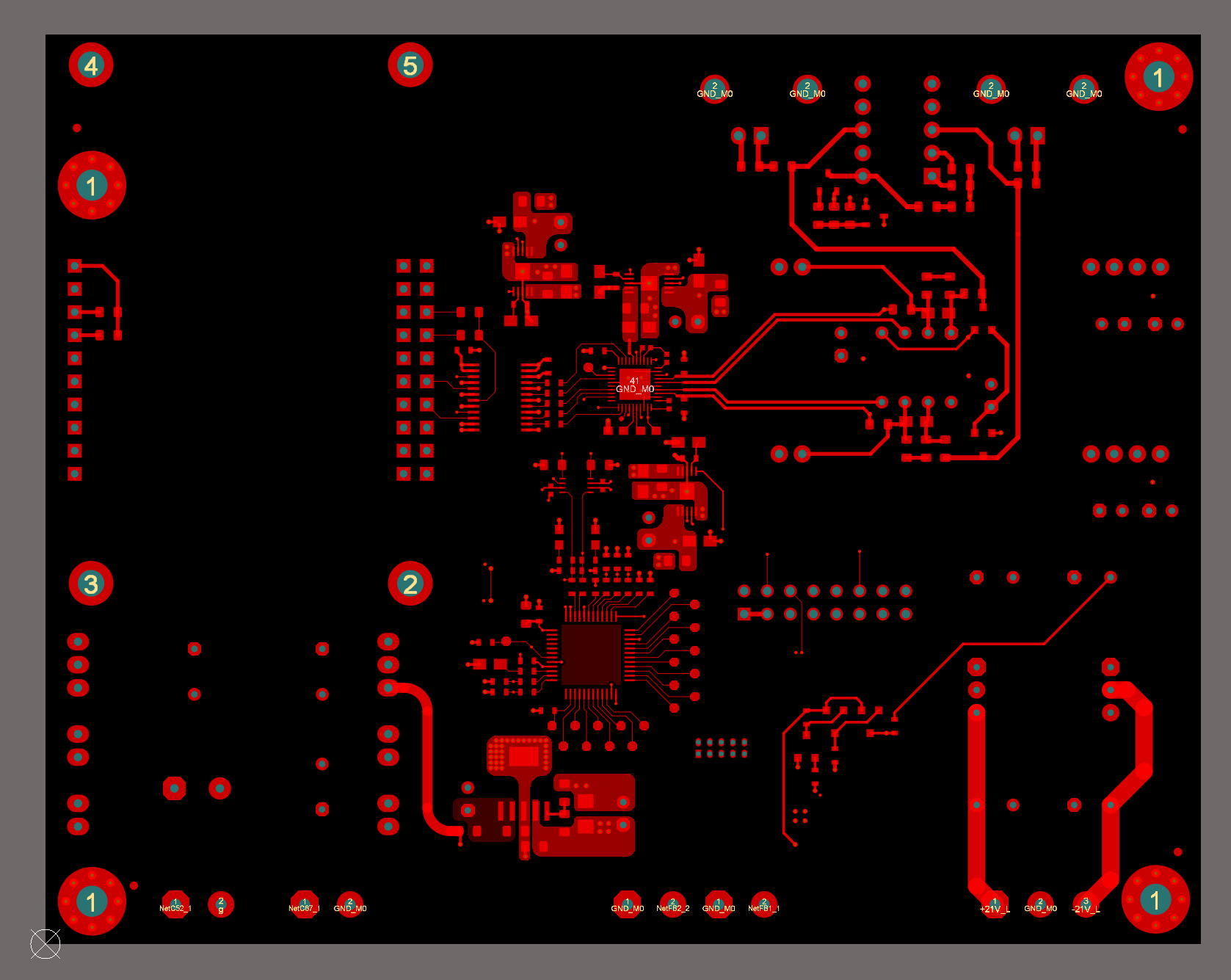

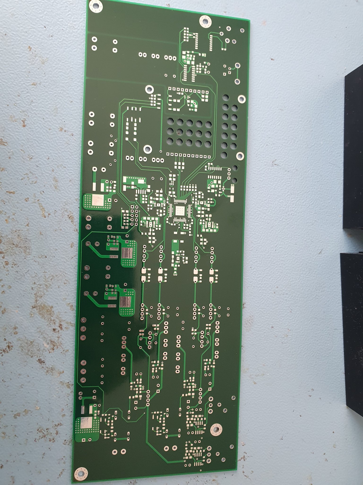

Here is some update from my ESS DAC Project.
Four layer PCB with 50ohm impedance for digital signals and 75ohm for SPDIF.
For now the DAC works in HW mode with USB XMOS. It also works with SPDIF input (configuring with one jumper, soldered manualy on the board).
I prepare all parts (MCU, Display, remote control, izolation board) for software control, but didn't have time to test it...

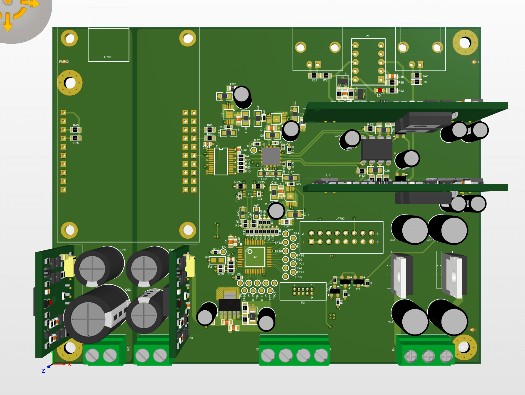

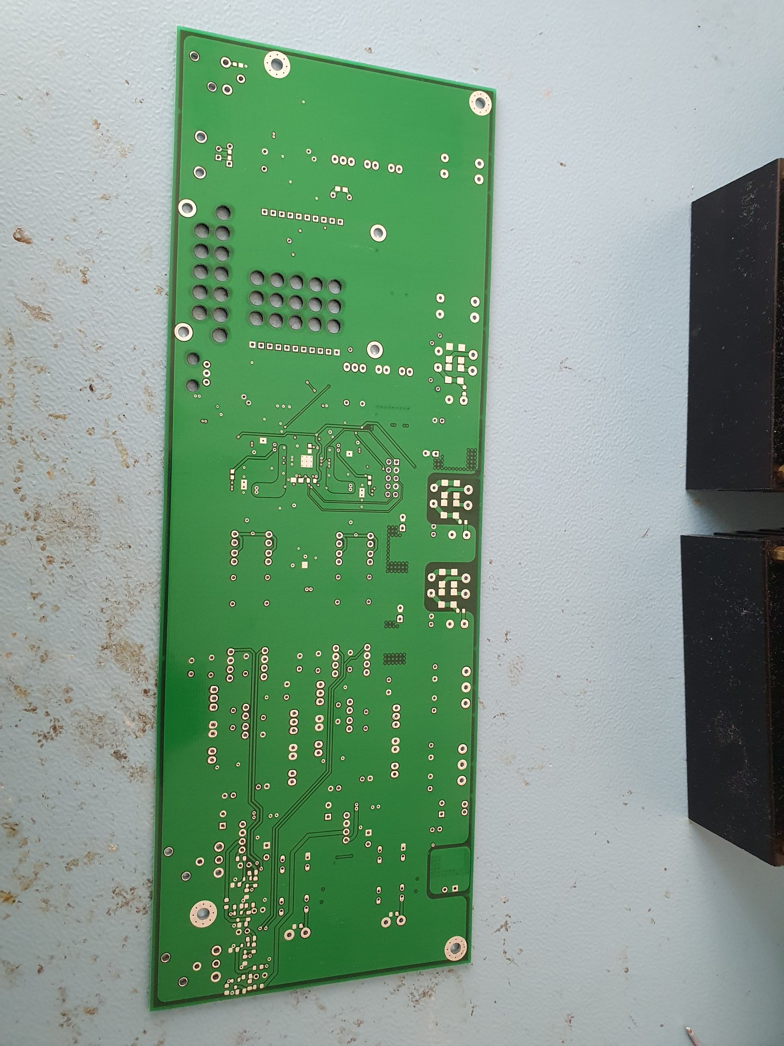

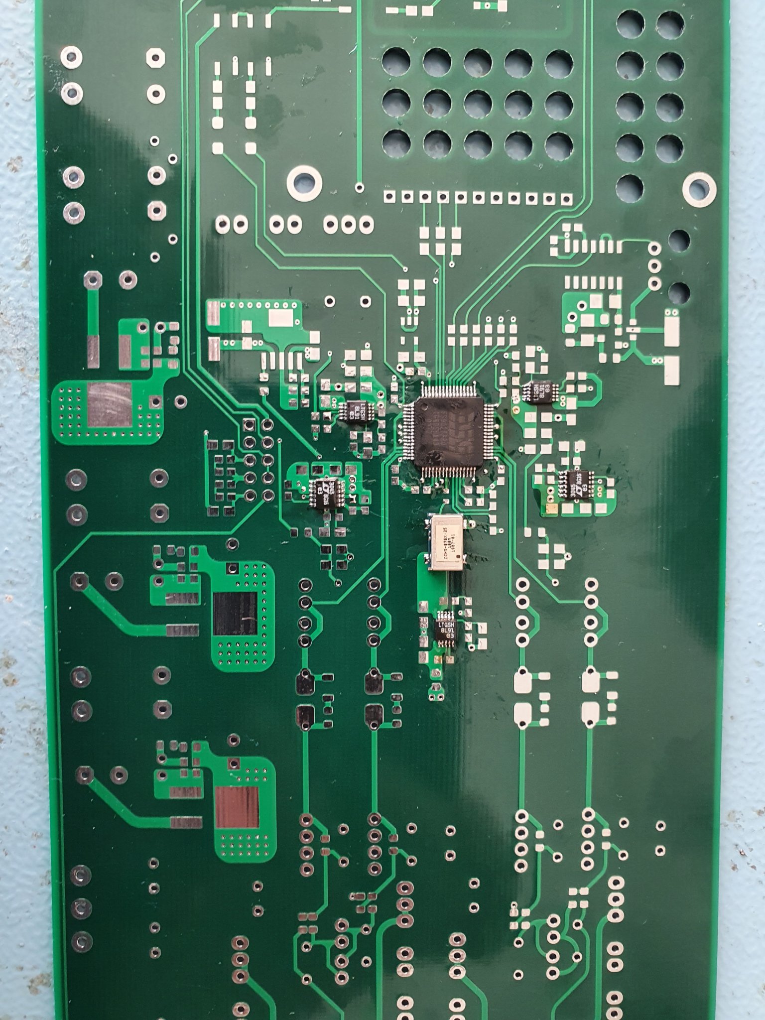

I continue with the next flagman DAC CS43198.
Here is first prototipe with 16 stereo dacs. Total of 32 chanels (16 in paralel for left channel and 16 for right channel).
I also draw new board with single CS43198 and option for integral or discrete opamp.
